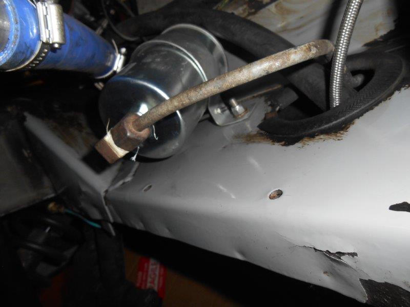

New fuel filter and stainless steel fuel line above
Does someone already tried to replace the hard line by the stainless one from John H? Looks like very difficult to replace it? Not so easy to do it.

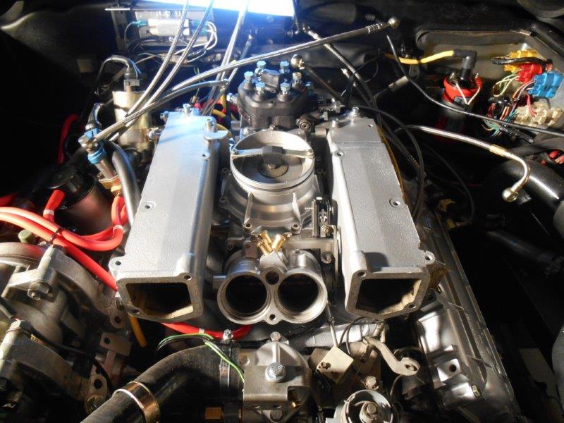

Kjet into the engine bay.

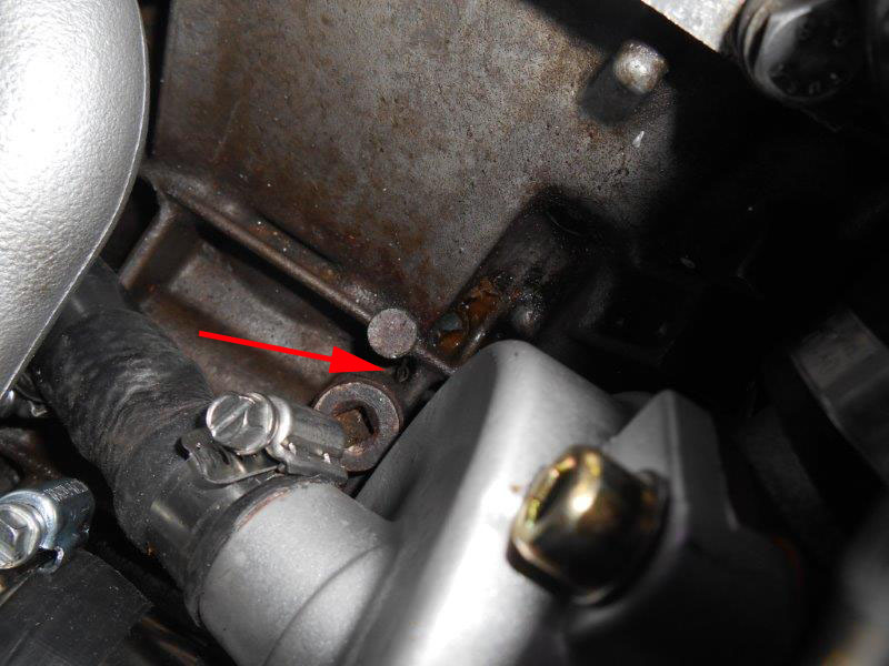

And, of course there is something wrong… I lost a small pin down there… (and a small lamp)
So, I had to remove some parts to get it back.
Everything back in place

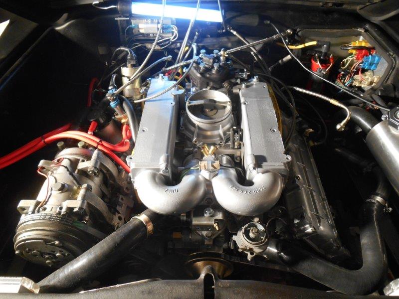

It all looks good enough to eat - can't wait for the video of its first start!

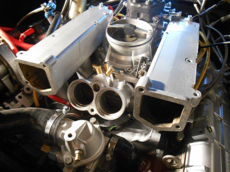

Looking at DSCN3446, is that short copper air pipe a mod? Isn't that where the longer Pipe of Agony goes in?

Postby Domi » Sun Mar 27, 2016 9:06 pm
Horsebox wrote:Looking at DSCN3446, is that short copper air pipe a mod? Isn't that where the longer Pipe of Agony goes in?
Everything is original, no modification here.
Postby Horsebox » Sun Mar 27, 2016 9:27 pm
I think some guys in the US have it this way. Mine doesn't have the short copper pipe, just a hole and sealing band. The entire 30cm of metal tube just snugly pokes into the hole.
So you just use rubber tube to connect from that short tube to the idle speed motor? Sounds much better to me. Wish mine was like that!

Postby Domi » Sun Mar 27, 2016 10:09 pm
Horsebox wrote:So you just use rubber tube to connect from that short tube to the idle speed motor? Sounds much better to me. Wish mine was like that!
Yes indeed :)

Postby jamesrguk » Mon Mar 28, 2016 7:57 am
Horsebox wrote:....Looking at DSCN3446, is that short copper air pipe a mod? Isn't that where the longer Pipe of Agony goes in?
I have had a couple of later style volvo intake units and they both have a small copper pipe permanently fitted, to which you then join to the idle speed motor with a rubber pipe joint.
The dmc set up with the o-ring nonsense must be responsible for the majority of vacuum leaks.
