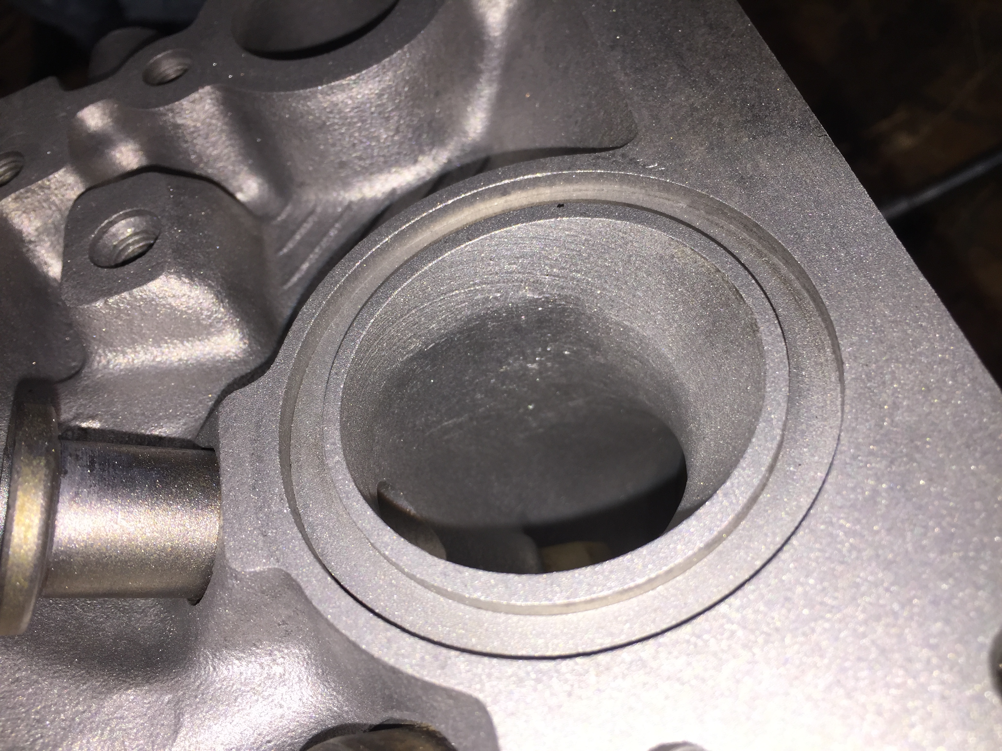

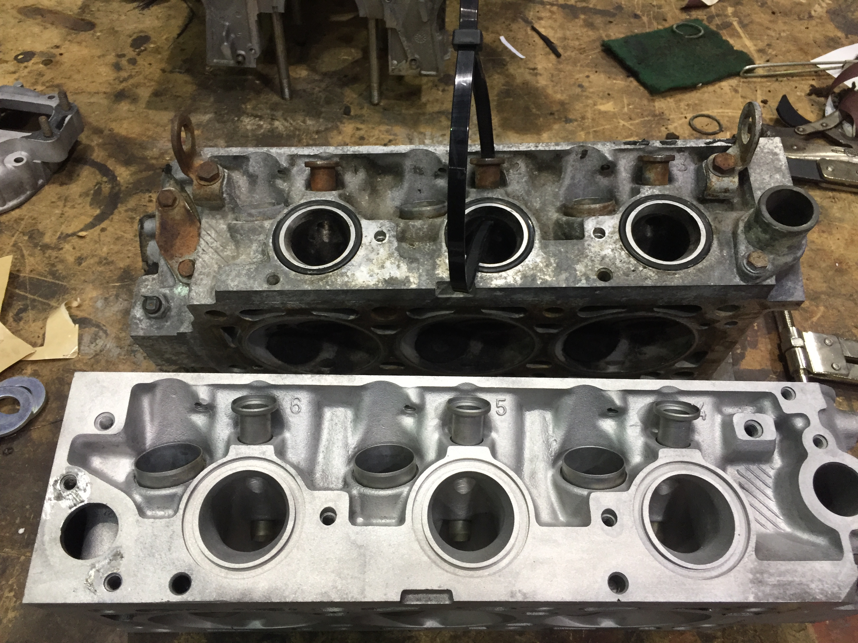

Postby DJK73 » Mon Oct 03, 2016 1:16 pm
Just thought I give an update on the Volvo I got off eBay
I've taken out the engine and sold the remainder of the car.
I then started to dismantle the engine, at first I was just going to clean it up, but it has turned into a full rebuild!!
The engine is now in component form and I'm cleaning all the parts, I've decided to some mild head work (just remove the bird shit casting lines) and imperfections
I've got new starter,alternator,cams,rockers,chains,tensioners,guides,bearings,seals and gaskets, I also managed to get a sandwich plate, and sump. I can now keep my original D engine as a good working spare and upgrade to the Volvo.
Thought I would share pics
