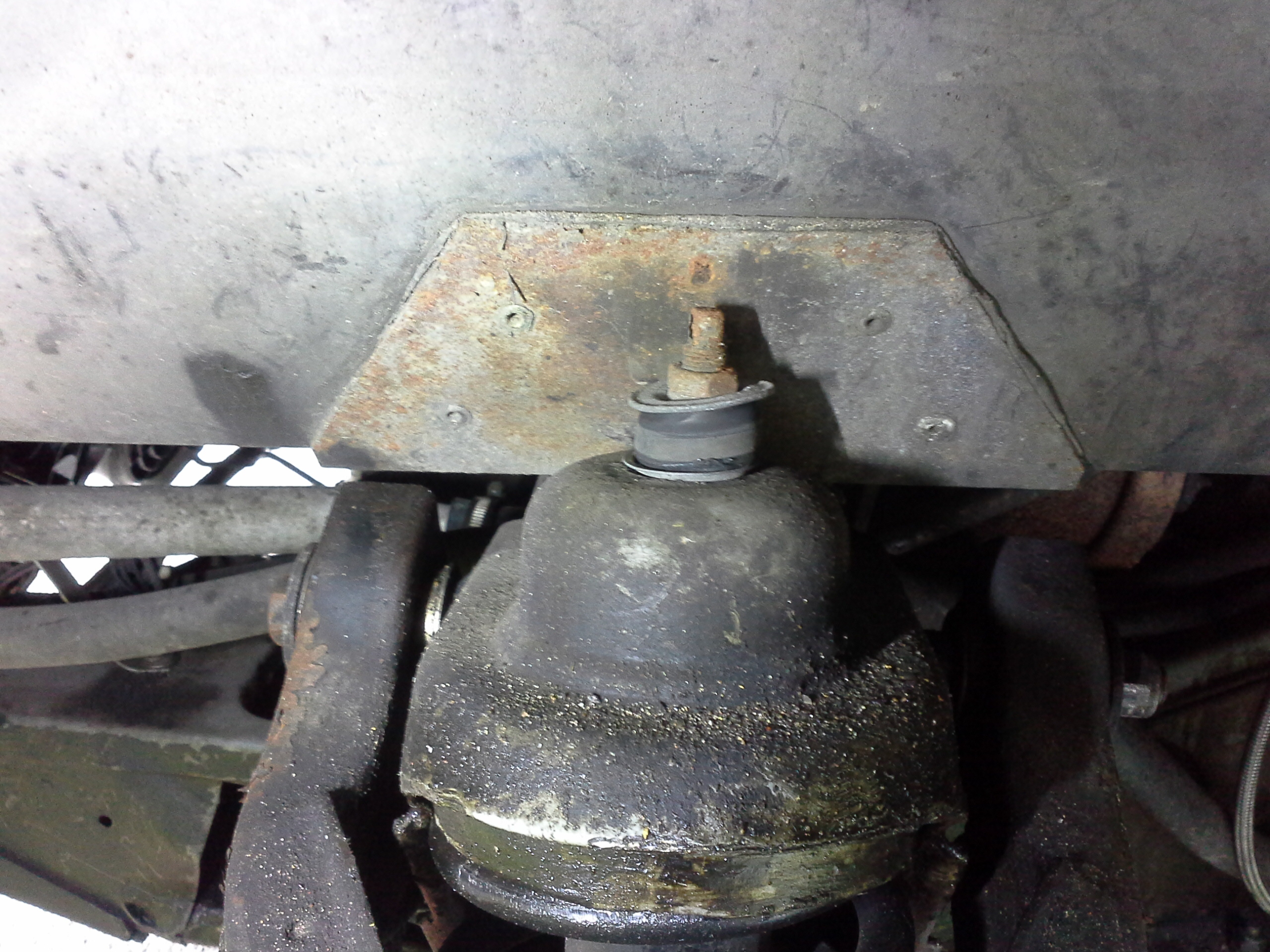

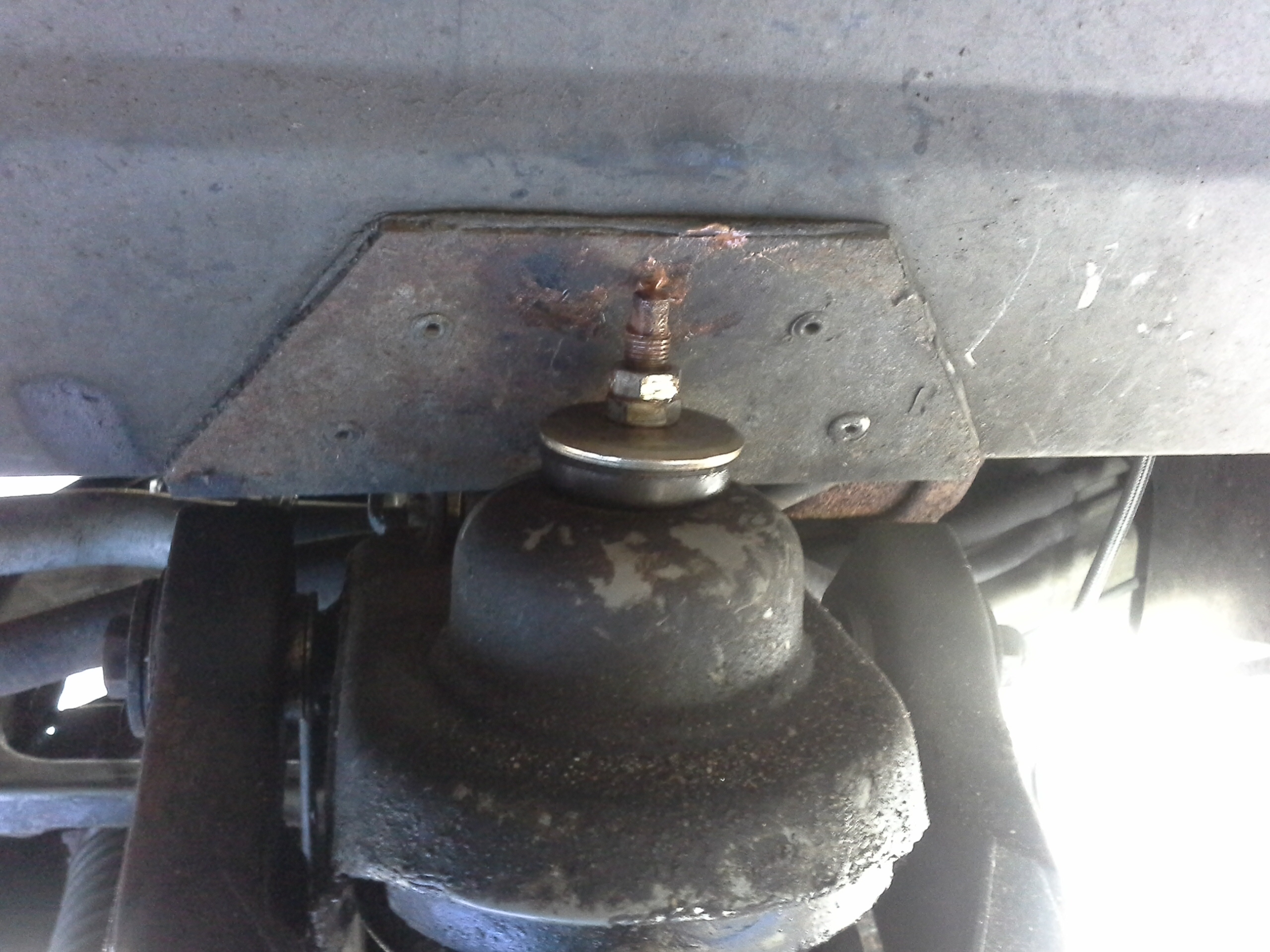

Postby andyd » Sun Oct 22, 2017 10:09 pm
Interestingly (or maybe not) I see the plates above my shocks rivetted to the tub are not common. Early tub thing?? The threaded bits of the shocks dont touch the tub, but they are really close!
Cant get the nuts and top rubbers on with the shocks in final position.
Precision engineered huh?!
A
