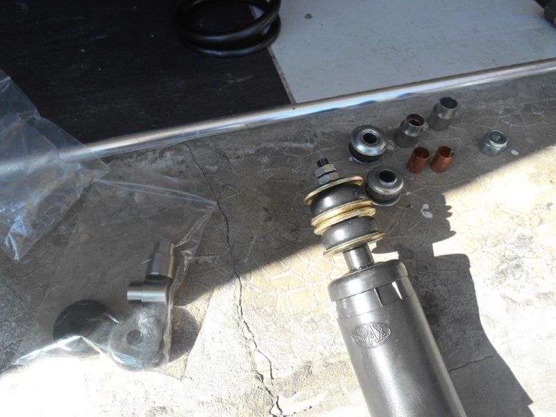

Postby Domi » Sat Oct 14, 2017 1:37 pm
I just check the store page, and it looks like it does mount like this:
Sans titre-2.jpg (145.09 KiB) Viewed 5097 times
So, it it does I have everything I need.
I thought it was like the old one. 4 by shock.
Posts: 1004
Postby arranj » Sat Oct 14, 2017 2:41 pm
Yes, 2 per shock, it’s the same as the rear ones now, these are much larger bushings.
