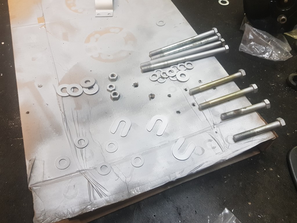

Its been a while since my last update, progress has been slower than I would have liked but Im getting somewhere now, there has been a lot of refurbing stuff and a few cockups on the way, I started off by refurbishing bolts and washers...
20190208_135228 (Medium).jpg (210.8 KiB) Viewed 4302 times

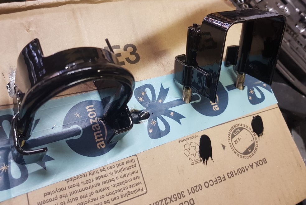

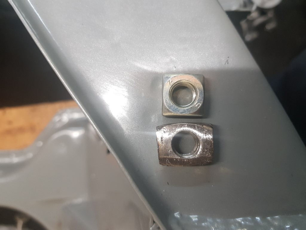

I also had to extend the nut serts that fit in the frame as they spun when a bolt was turned in them..
20190208_233813 (Medium).jpg (140.44 KiB) Viewed 4302 times

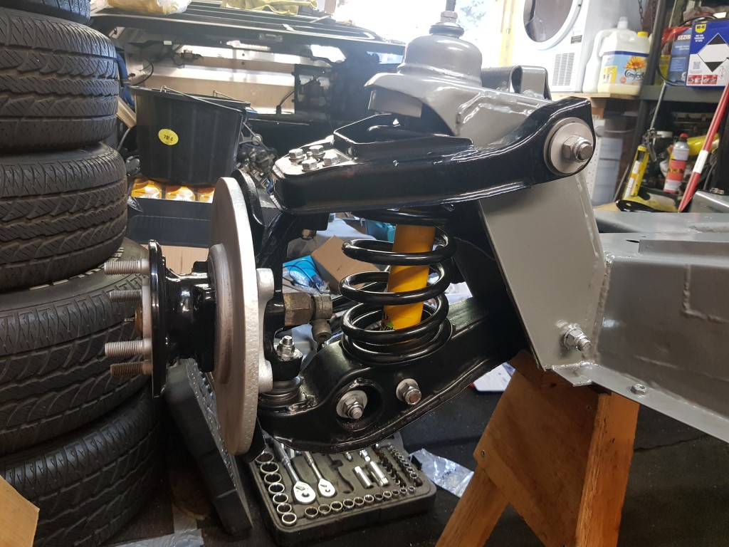

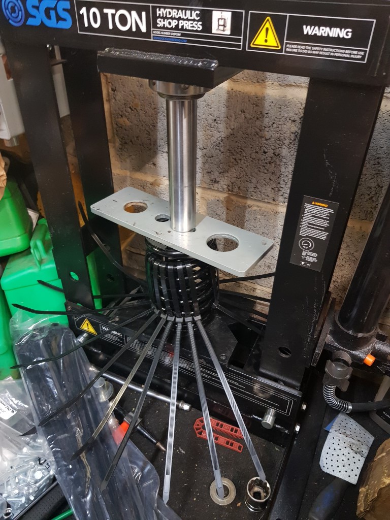

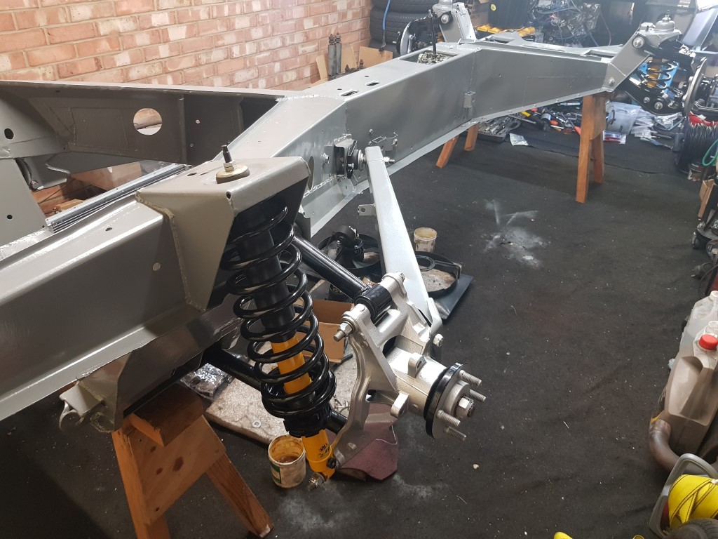

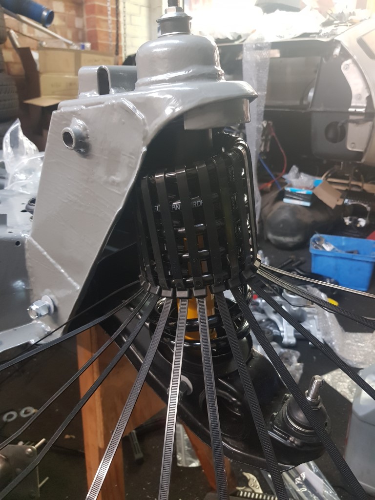

I then went onto suspension Assembly, I adopted the Dan Stacey Spring compressing technique which luckily didn't go wrong ! lol
20190204_140916 (Medium).jpg (294.48 KiB) Viewed 4302 times
20190206_132336 (Medium).jpg (218.09 KiB) Viewed 4302 times

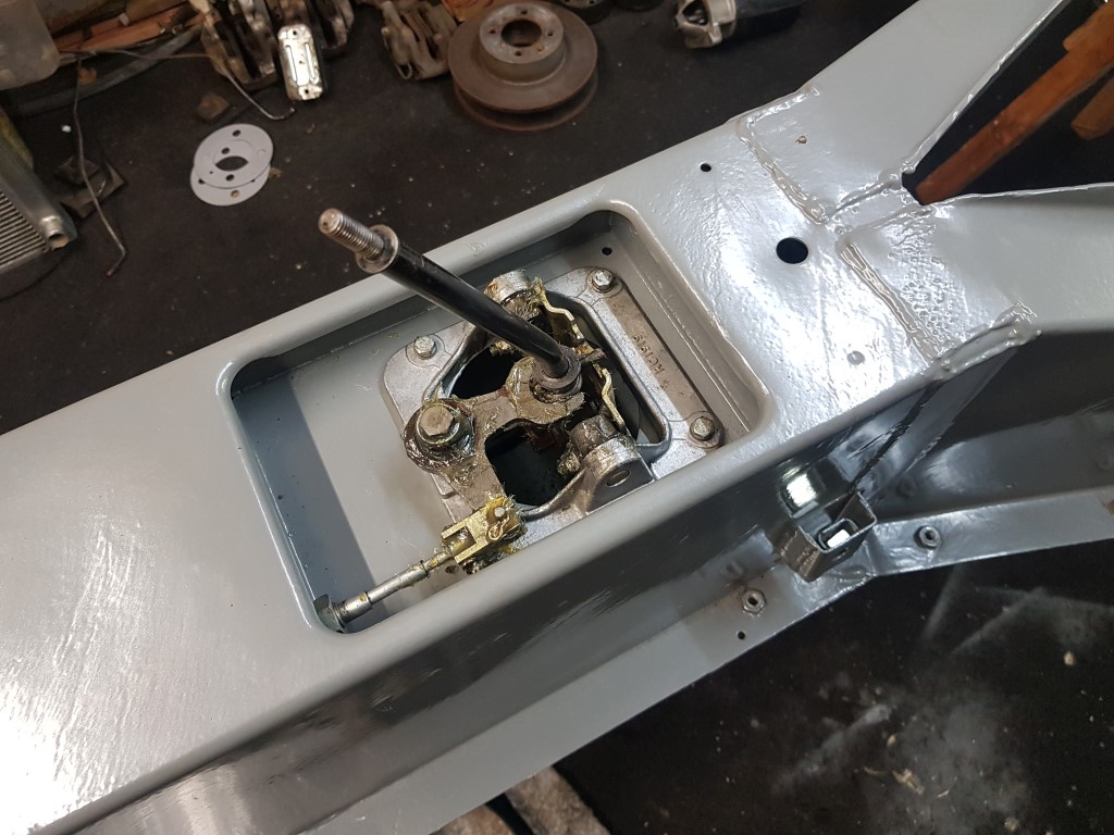

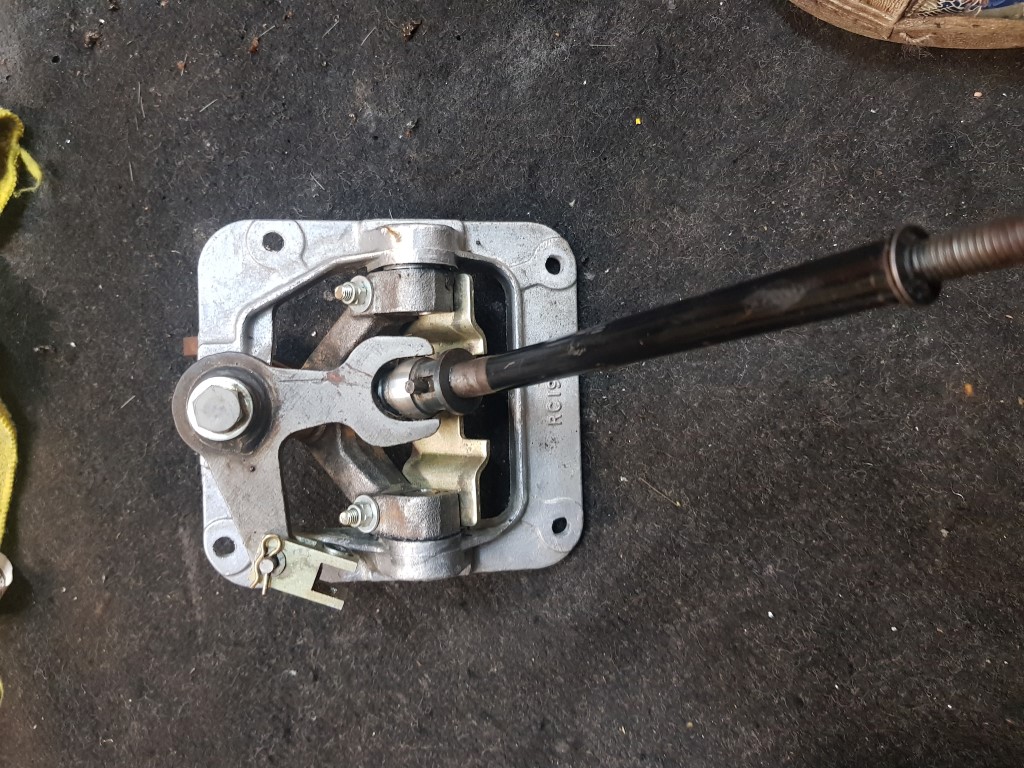

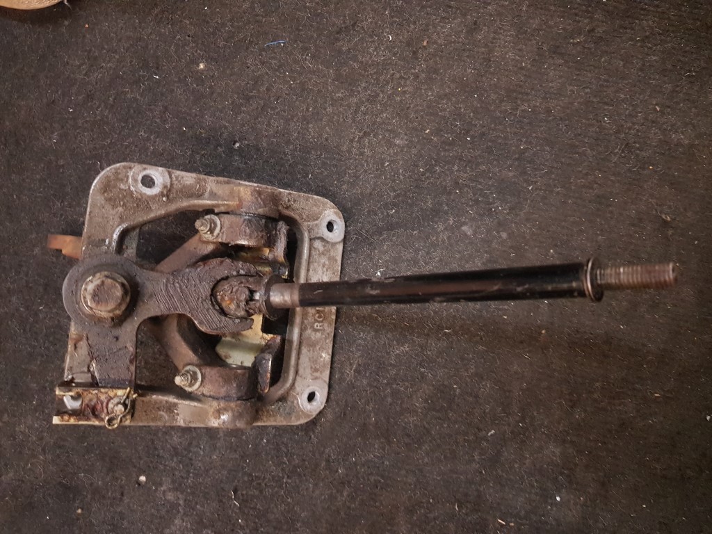

Cleaned up the Gear Shift..
before
20190211_112603 (Medium).jpg (272.16 KiB) Viewed 4302 times
after
20190211_113206 (Medium).jpg (306.28 KiB) Viewed 4302 times
this was followed by a regreasing and installing along with the now straight gear linkage which also now has all new bushes and pivot bolts, whilst we are on the subject of transmission, by gearbox has been gone through by a company Alex uses and they found no faults at all so it must has been the bent linkage/bad adjustment causing my gearshift problems, the gearbox is now all back together with a complete new sill kit installed so this should be good to go.

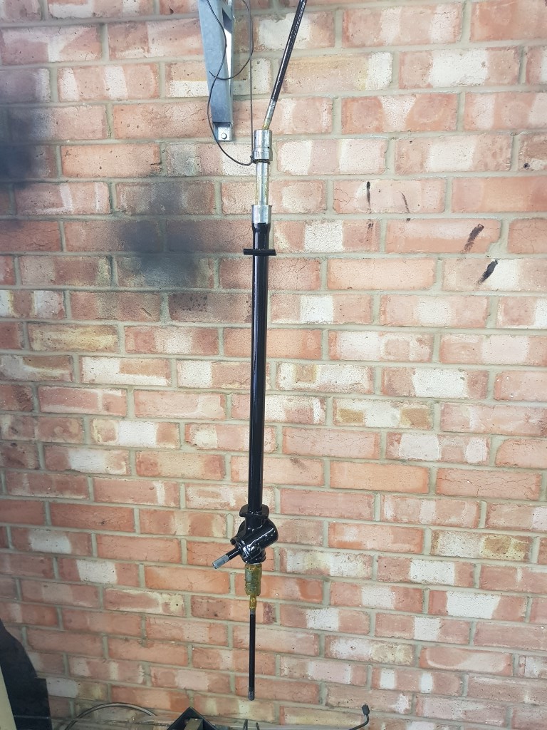

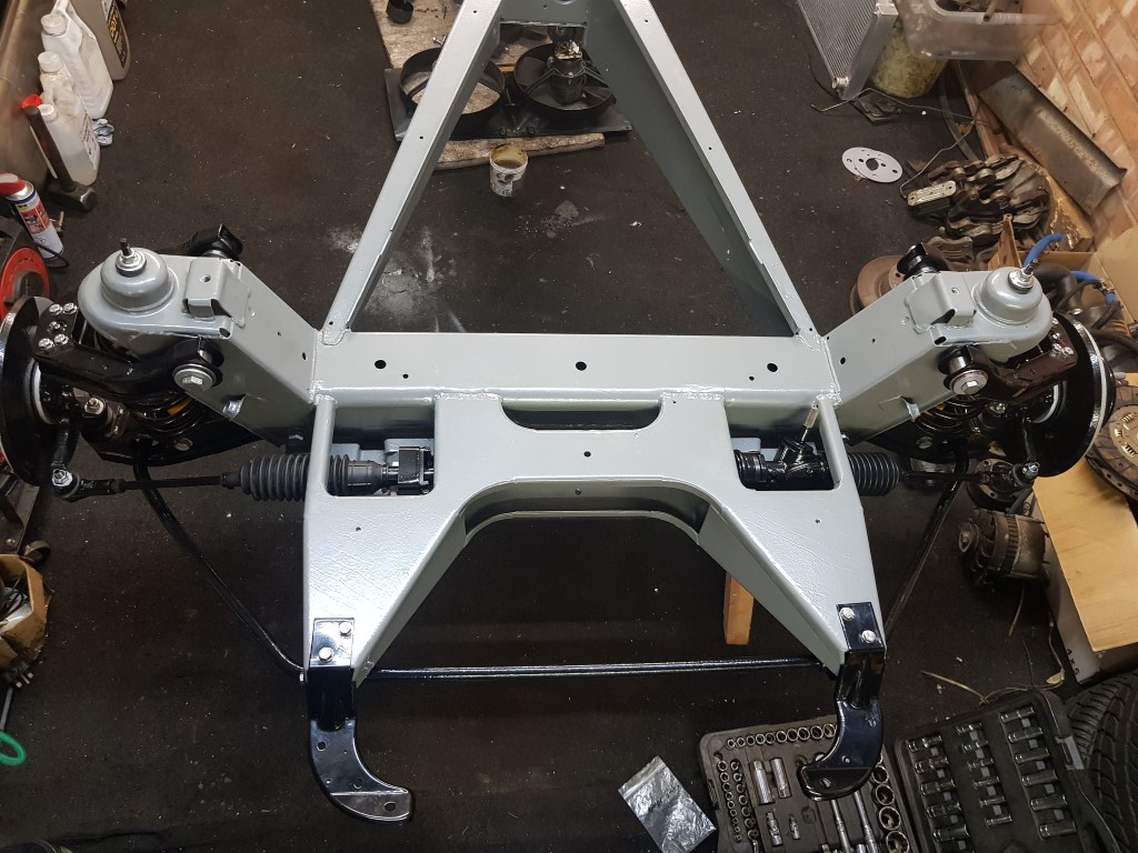

the steering rack has been refurbed however the coat of paint they applied was very thin so i rubbed it back and gave it a coat of POR15, superb stuff i must say ...
20190213_140200 (Medium).jpg (302.14 KiB) Viewed 4302 times

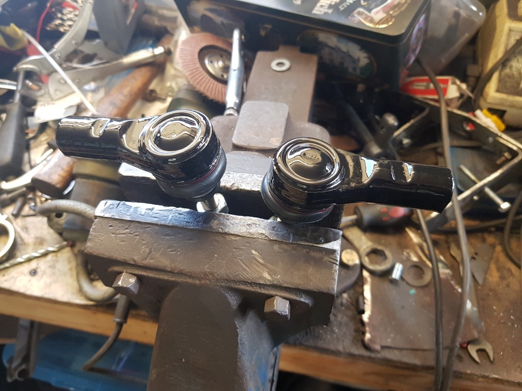

did the new track rod ends and new brackets too..

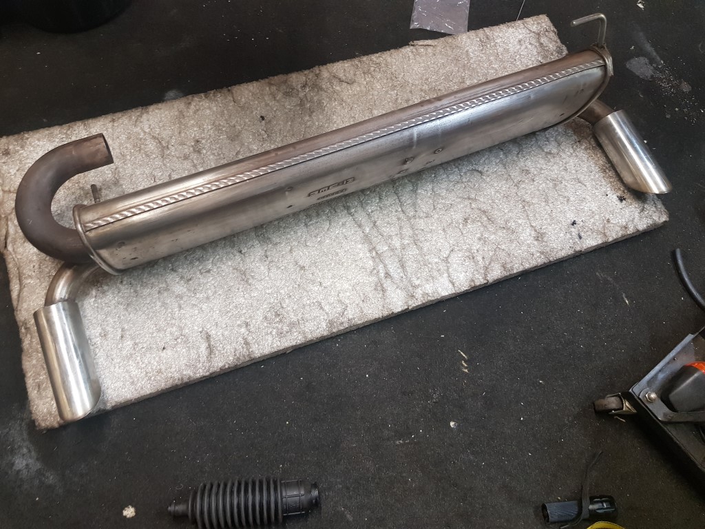

In between all this i had an ebay bargain too...
20190214_122227 (Medium).jpg (270.93 KiB) Viewed 4302 times
that gets rid of my old pea shooter exhaust !

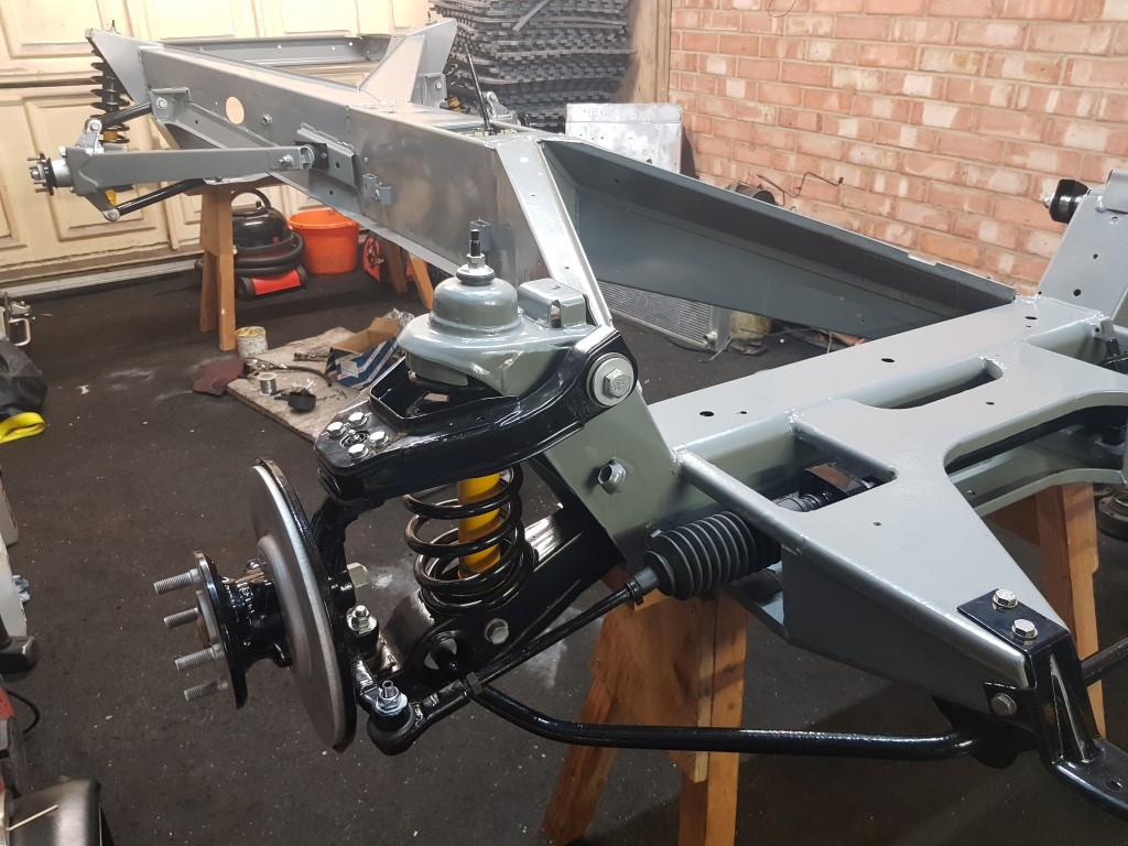

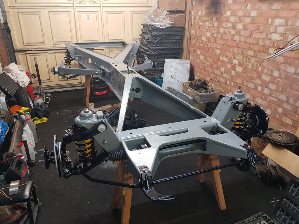

So we come on to what it looks like today...
20190225_123808 (Medium).jpg (279.78 KiB) Viewed 4302 times
20190225_123819 (Medium).jpg (237.65 KiB) Viewed 4302 times
20190225_123827 (Medium).jpg (244.13 KiB) Viewed 4302 times
20190225_123913 (Medium).jpg (234.9 KiB) Viewed 4302 times
20190225_123853 (Medium).jpg (212.92 KiB) Viewed 4302 times
20190225_124116 (Medium).jpg (248.32 KiB) Viewed 4302 times
