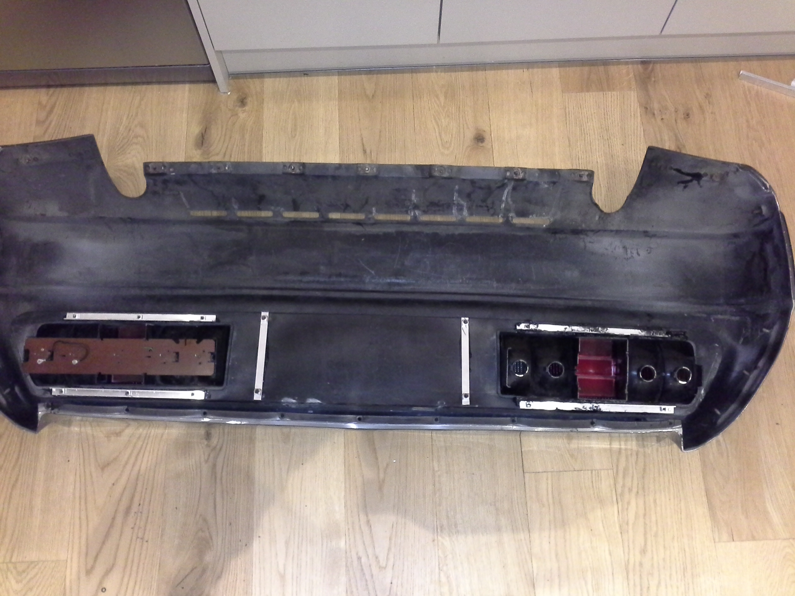

In order to sort the wiggly fascia I used a heat gun and G clamps to get it reasonably into shape:
(Not too bad from the outside eith the lights fitted admittedly)
During, after the first ten quid heat gun literally went on fire on first use and started spewing flames!! :shock: :lol: that was a surprise anyway! New one's on the floor.
Drilling square holes for the captive nuts...
To make 4 of these
I also repaired the split inner fascia with a length of angle ally with more captive nuts. Thank God for the square drill- filing all those squares would have been a right pain in the arse... :|
Then black bond n seal adhesive, and nipped the nuts down till it was cured. Bingo (maybe)
(Behold the C5)
Re: vin 814

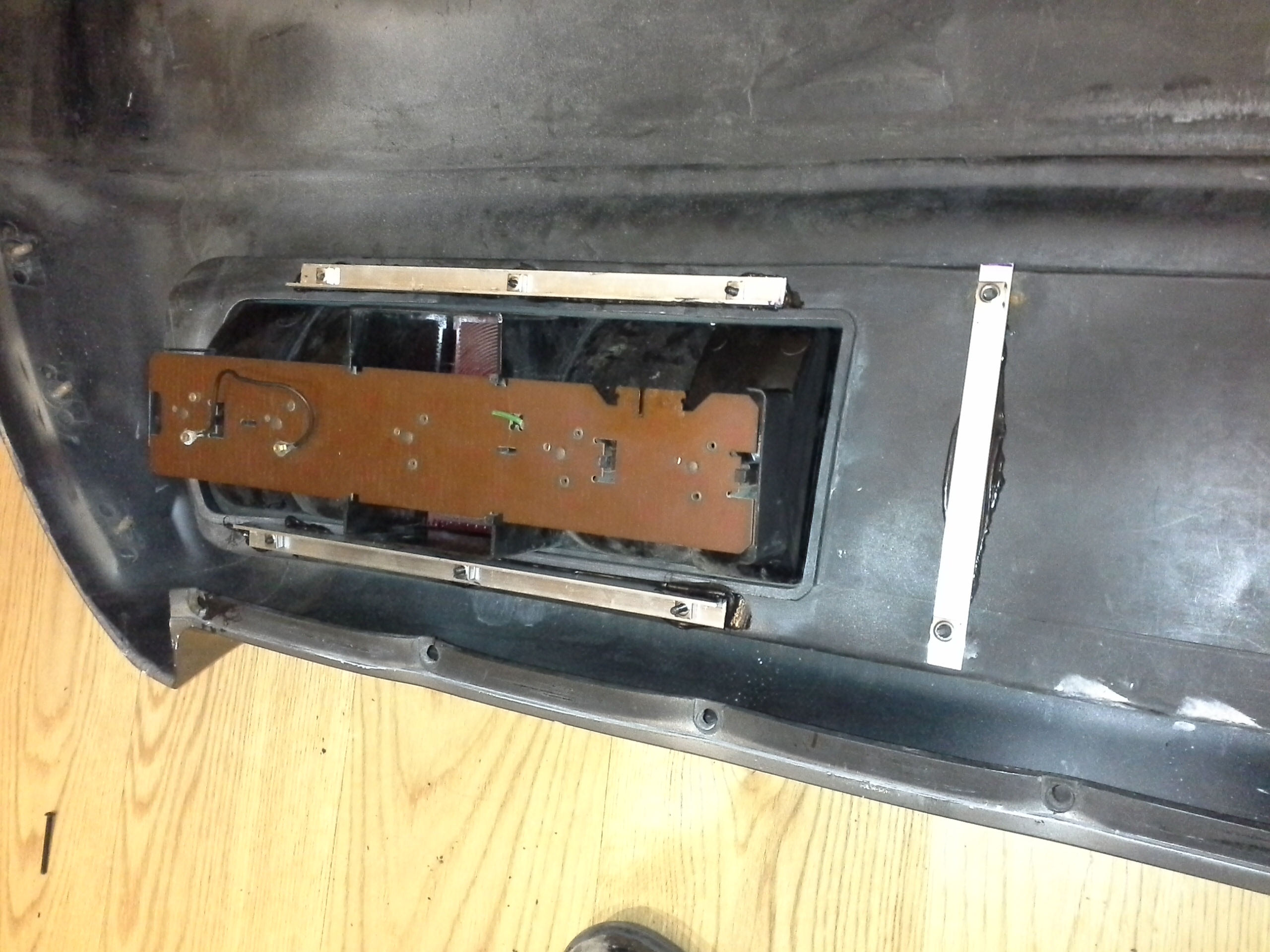

Postby andyd » Mon May 13, 2019 11:16 pm
Mating the inner and outer, it looks now like the outer PU fascia has shrunk over time, and maybe this has helped bow and split the inner. Either way, the centre 3 bolts line up, but they get progressively off centre as you go out, meaning heat gun, clamps and probably Dremel. I may fit an ally strip over the painter fascia, to sandwich it. So, (Inside angle ally)-(inner fascia)-(outer fascia)-(ally strip).
Anyway I sandwiched the rear lights plates with lots of bond n seal, and let it cure. In the morning, bolts csme out, lights out, bars stayed in place. Like all things on a D, it kind of "fits where it hits", but 10 of the 12 bolts go in easy, and the other 2 will get a fettle. Result.
Also made plates for the rear bezel and splodged them in.
(So, guess which side I did first...? Lots of swearing, on the first time...)
So that seems ok. I'm getting competent at getting the fascia on and off, and its nice not to give too much of a fuck about it as I'm doing all this to get it painted. It even lines up ok I think?
