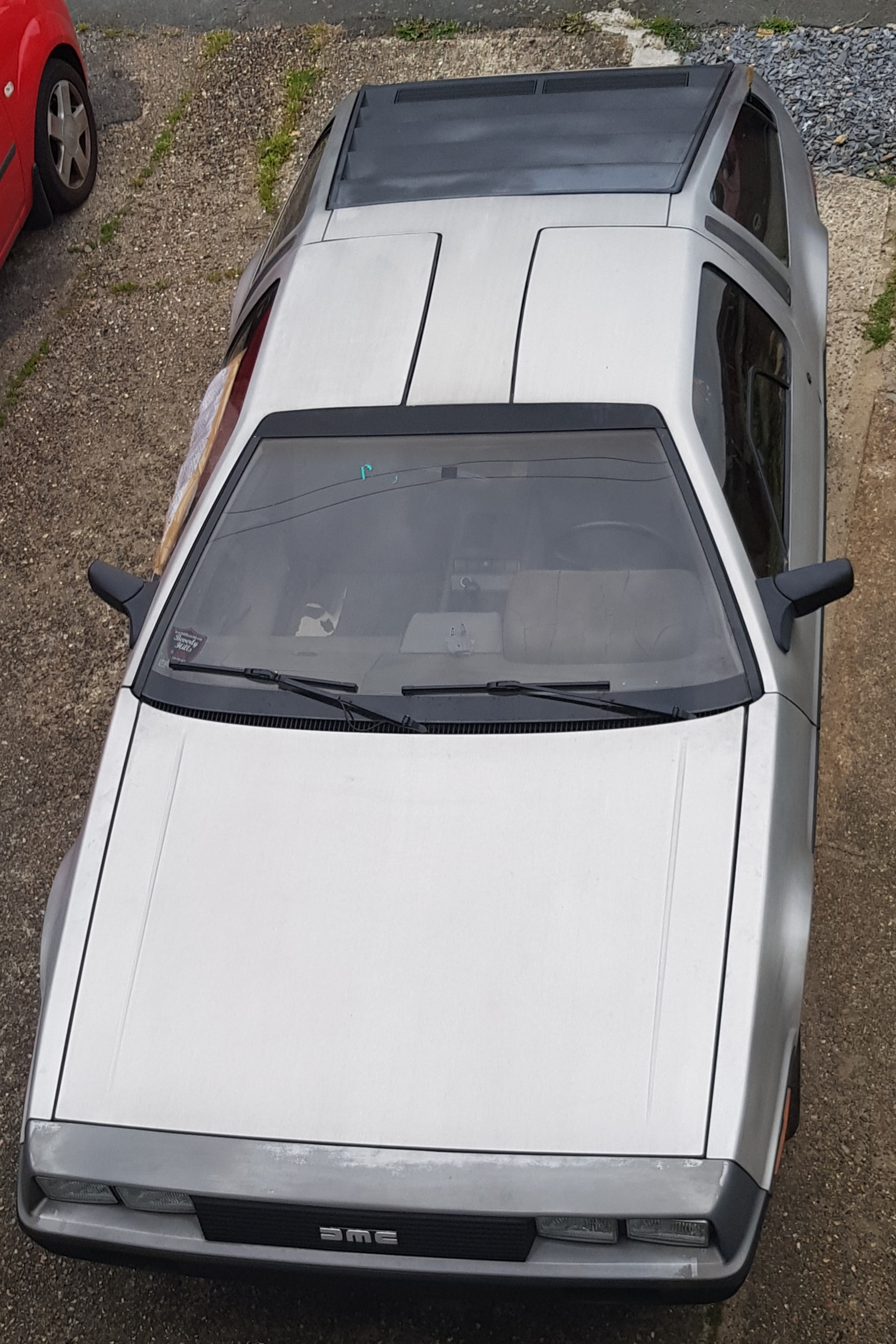

Brakes have now been bled and golly gosh they work lovely. Yay! Gotta be careful till the pads are worn in.
The handbrake, what a POS that is. Ive got it now so pretty much the full pad touches the disc. I cant roll the car on the drive but will it be good enough to pass the MOT, we will see. I had to file down 1 pad on each side (the inner ones) and adjust the cable on one side. I can now honestly say i am a master at removing the handbrake and reattaching it.
So all thats left now is the fog light. Im about to start a new job tomorrow so its looking like i wont get round to that till next weekend. I may find some time during the week but doesnt matter as I wont put the car through an MOT till the first pay day anyway.
So the car will be attending the october meetup as long as it stays running :D
