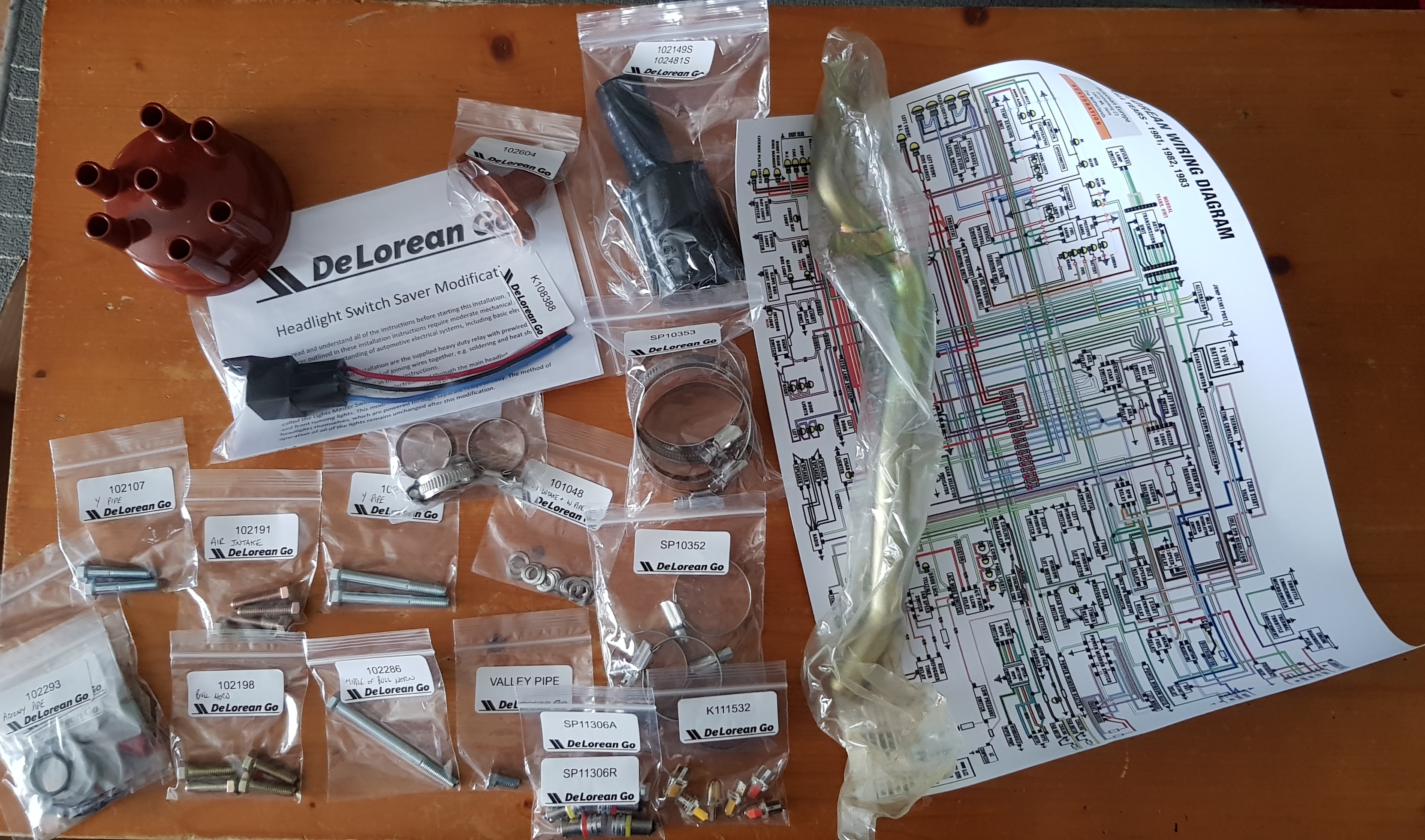

Hopefully i now have everything i could need whilst im in there. Im sure some will point out im missing something. I have mike ward approved spark plugs en route and already have the appropriate HT leads. The air intake O rings/gasket kit obtained as well as an agony pipe O ring and the ones under the Y pipe (which im hoping i wont have to disturb but you never know). I will be replacing the bolts for new too. Also went with silicone hoses for the back of the water pump and will very likely just change that heater pipe careless of the originals condition.
Of course the whole reason for going in there is to just change the distributor cap/rotar arm area buts its probably overdue to check the VOD anyway. No idea if the PO ever went in there and i know i never have.
A few other little bits and pieces bought too. Easy fixes so if ever i get frustrated i can change some LEDs and feel like ive accomplished something :lol:
The wiring diagram will need laminating too.
I have to admit, im not really looking forward to this but im sure i will be fine considering some of the jobs ive already done. Ive been soaking the bolts for a couple of days to help prevent snapping too and will take my time with those. Thats one scenario i dont want here.
