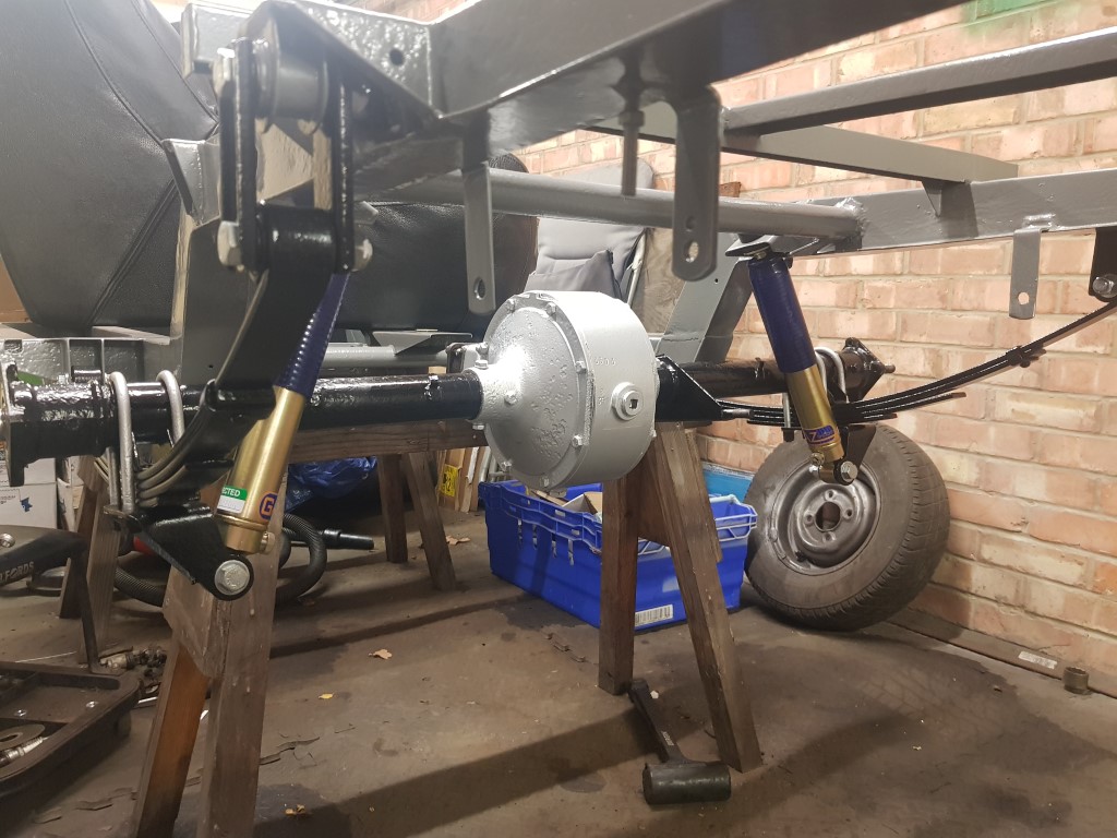

Hi All

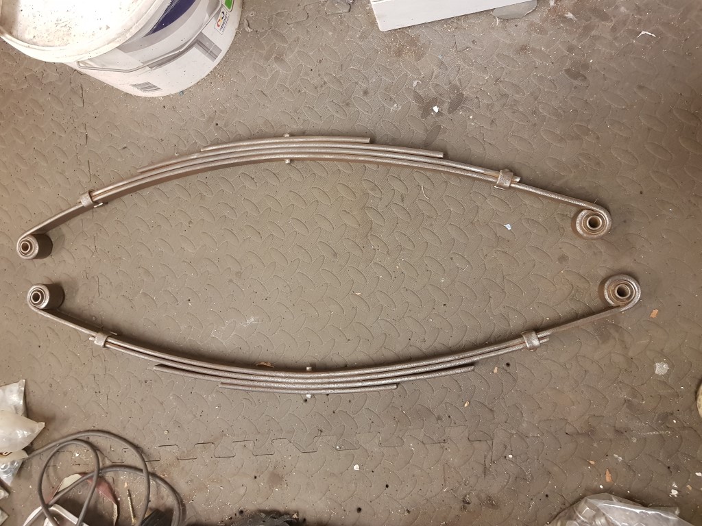

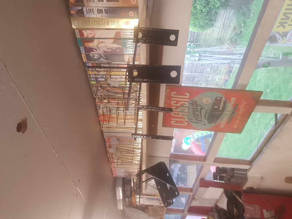

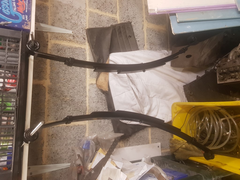

Sorry for the gap in posts, work has been continuing on the Supervan, so carrying on from the last post I did, now the chassis is back, I started refurbing all the running gear, starting off with the rear suspension components...
All of the rear leaf springs, brackets and shackles have been cleaned up and painted...
20201024_164616 (Medium).jpg (239.3 KiB) Viewed 22685 times
20201024_165931 (Medium).jpg (200.92 KiB) Viewed 22685 times
20201024_172353 (Medium).jpg (251.42 KiB) Viewed 22685 times
20201025_110151 (Medium).jpg (216.47 KiB) Viewed 22685 times
20201025_110158 (Medium).jpg (192.99 KiB) Viewed 22685 times

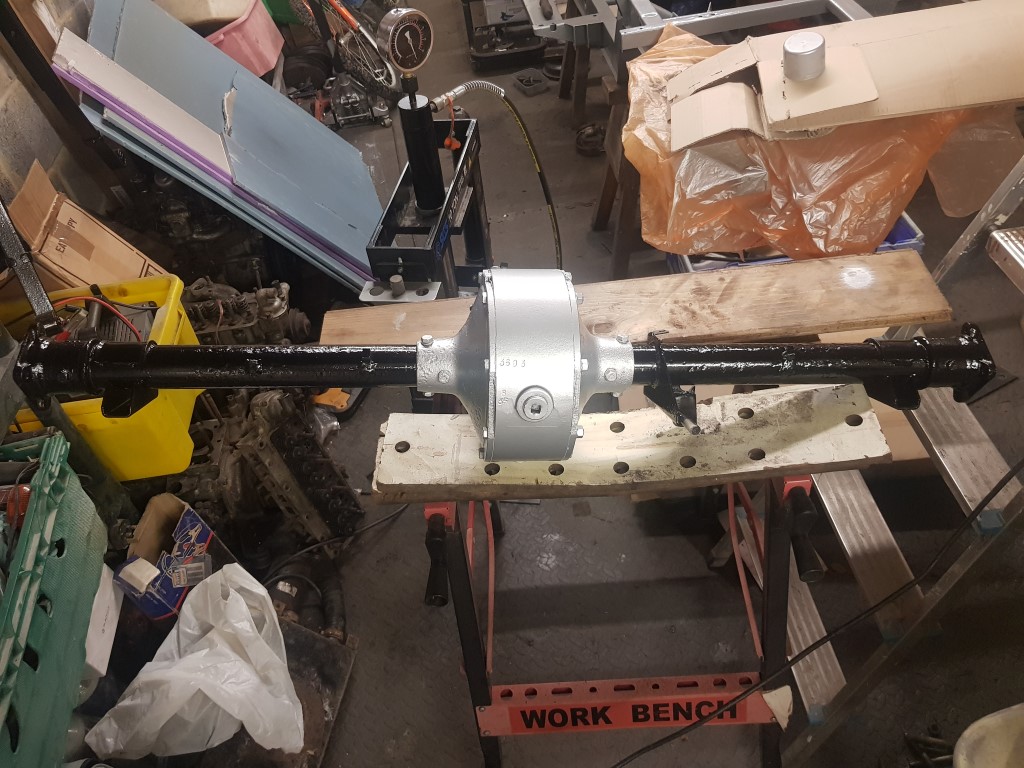

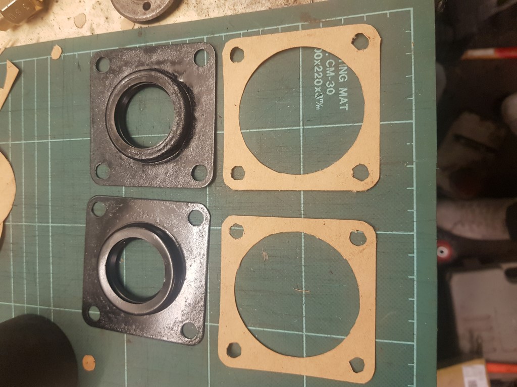

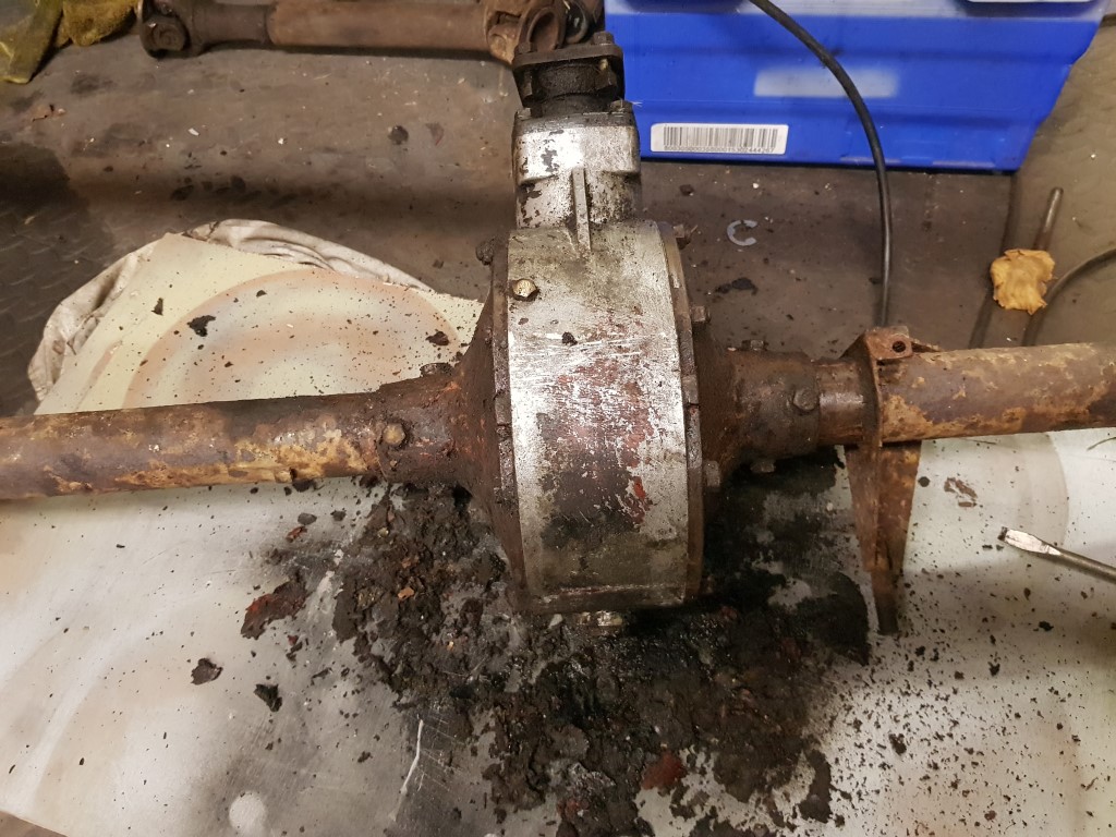

Next up was the rear axle, this has had a complete strip down with all new sills and home made gaskets as these aren't available, to start with was to get all the years of gunk off it ...
20201027_223556 (Medium).jpg (231.14 KiB) Viewed 22685 times

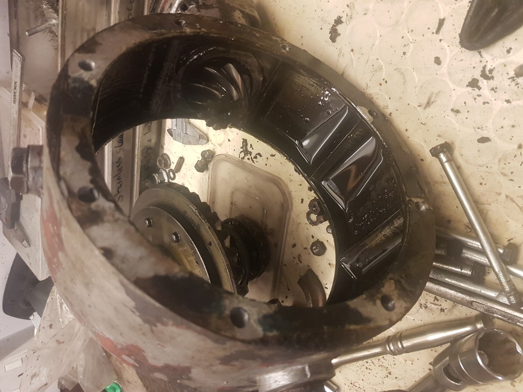

this is what i had after cleaning ...
20201111_213531 (Medium).jpg (202.26 KiB) Viewed 22685 times
then it was all stripped ...
20201114_212954 (Medium).jpg (293.42 KiB) Viewed 22685 times

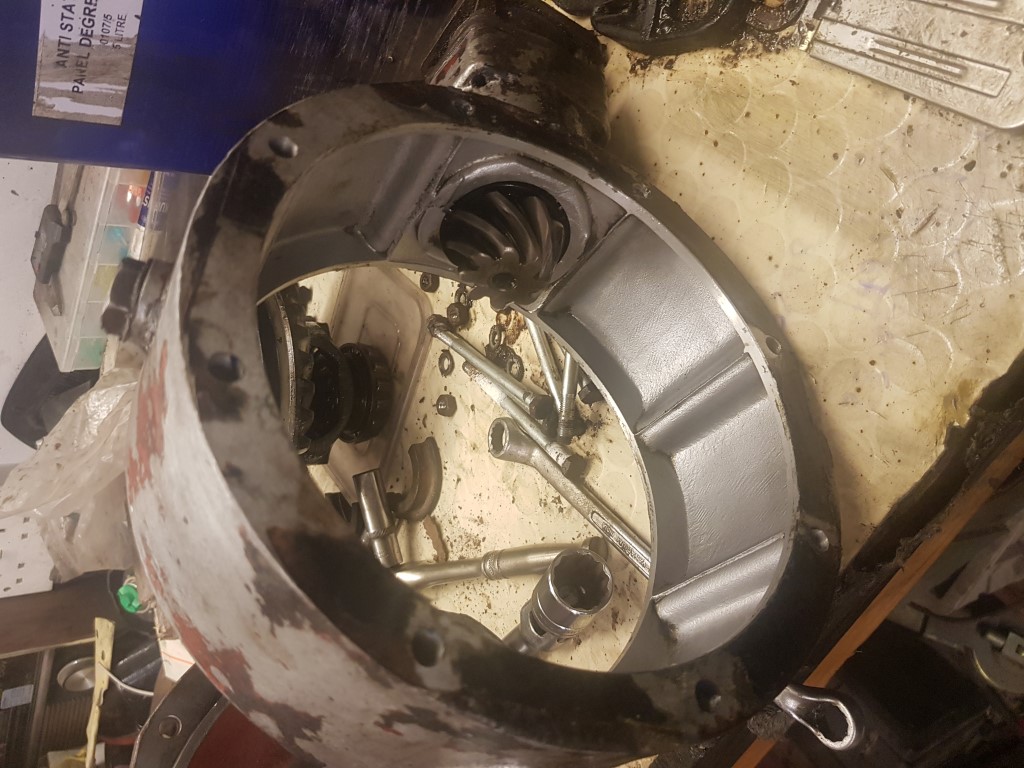

and cleaned ...
20201114_214424 (Medium).jpg (191.18 KiB) Viewed 22685 times
20201114_214456 (Medium).jpg (217.75 KiB) Viewed 22685 times
20201114_214942 (Medium).jpg (229.48 KiB) Viewed 22685 times

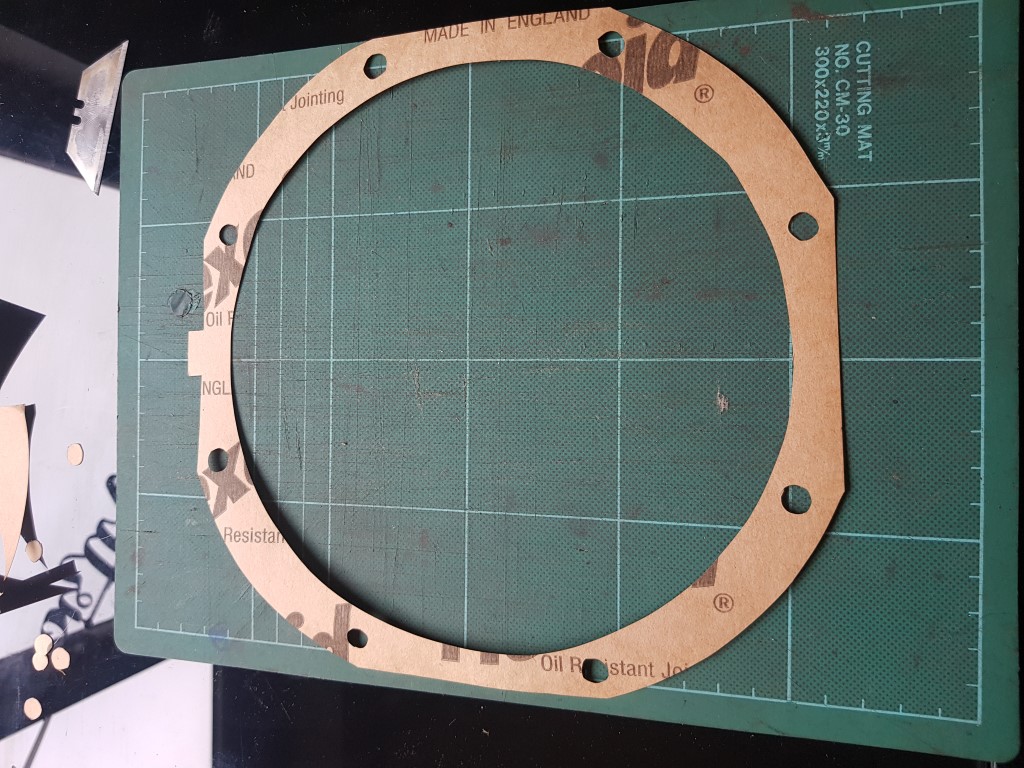

New gaskets hand made...
20201121_115630 (Medium).jpg (276.34 KiB) Viewed 22685 times
20201212_223435 (Medium).jpg (210.17 KiB) Viewed 22685 times

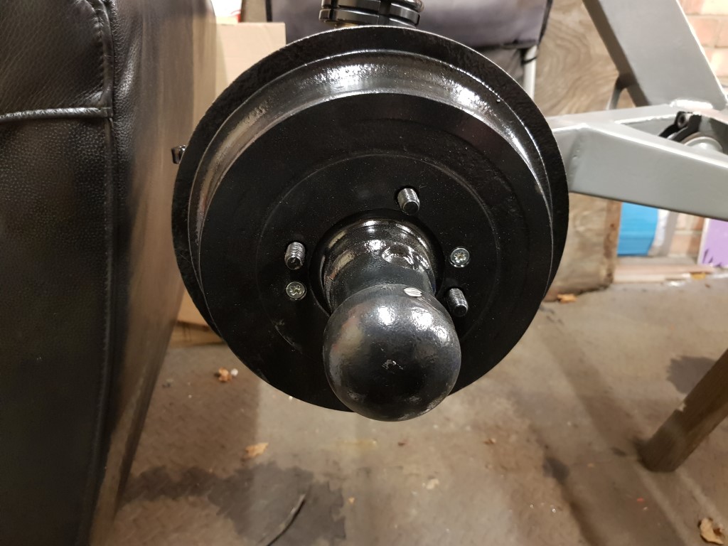

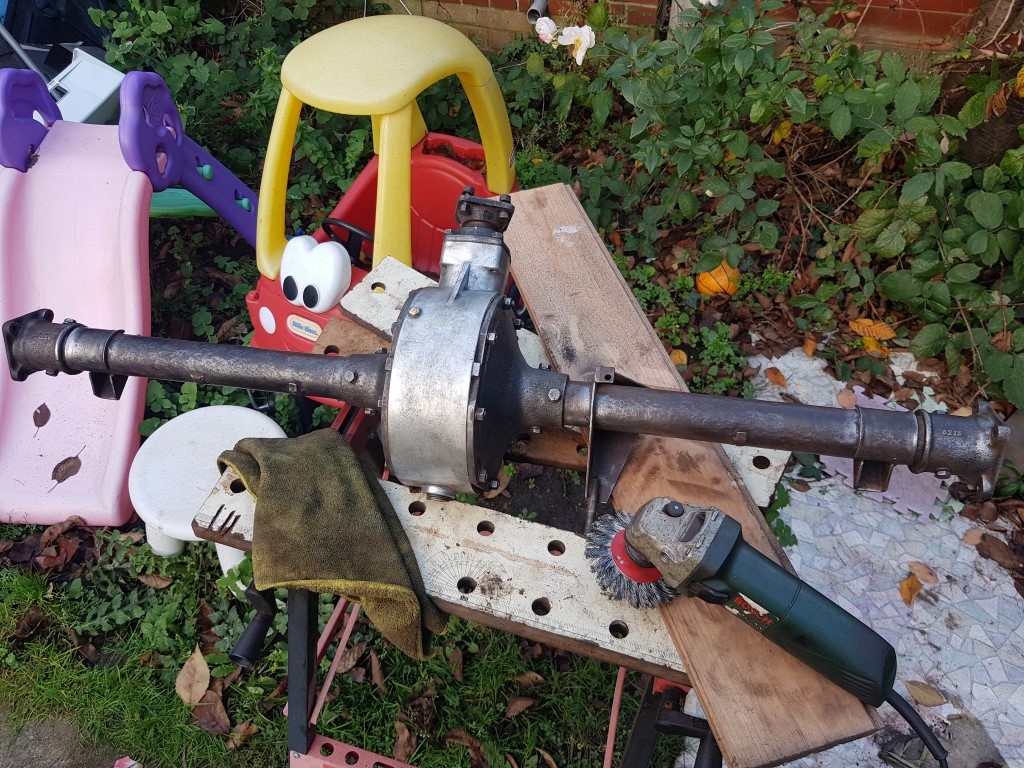

then the axle was put all back together with new sills and outer bearings, then a good wire brushing...
20201128_144357 (Medium).jpg (375.53 KiB) Viewed 22685 times
then painting...
20201201_220046 (Medium).jpg (218.47 KiB) Viewed 22685 times
this was all then fitted to the chassis along with new Gaz rear shocks ...
20201206_233446 (Medium).jpg (193.08 KiB) Viewed 22685 times

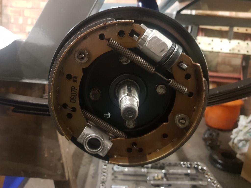

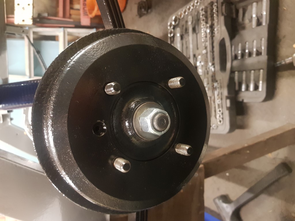

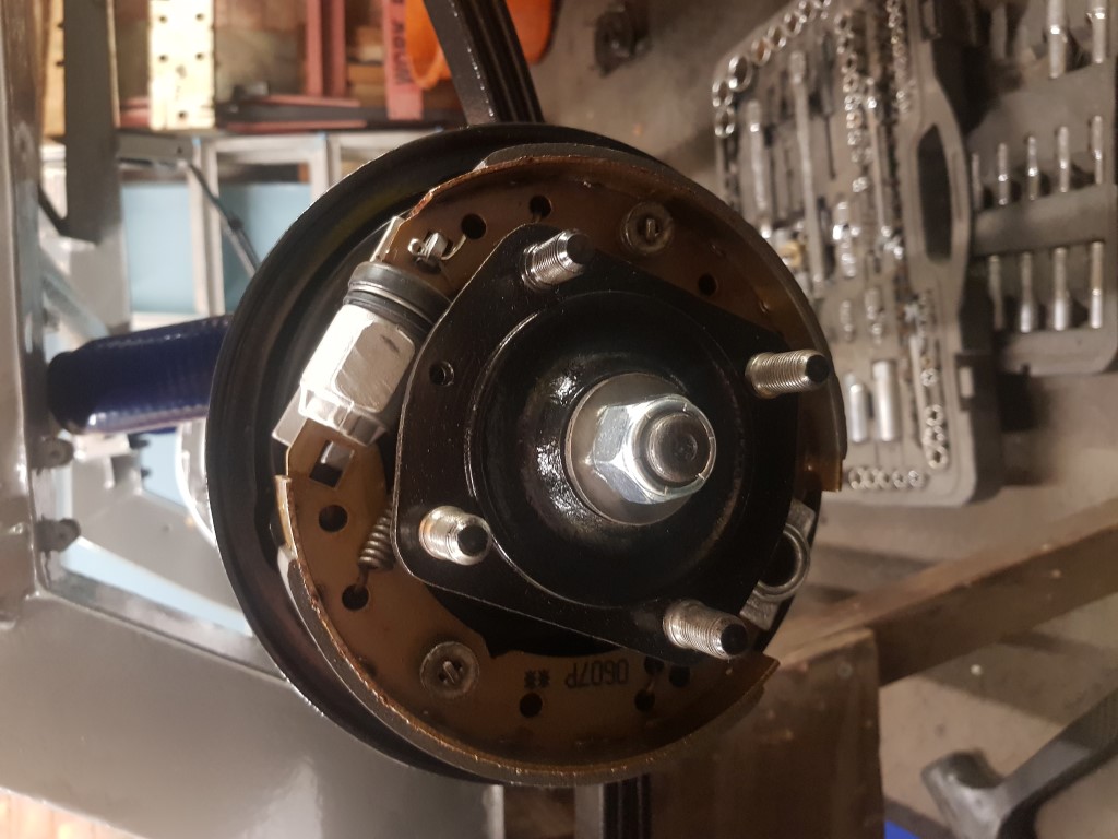

All the other axle components have also been refurbed and all new brakes fitted ...
20210104_162849 (Medium).jpg (139.01 KiB) Viewed 22685 times
20210104_165330 (Medium).jpg (152.66 KiB) Viewed 22685 times
20210104_165357 (Medium).jpg (150.9 KiB) Viewed 22685 times

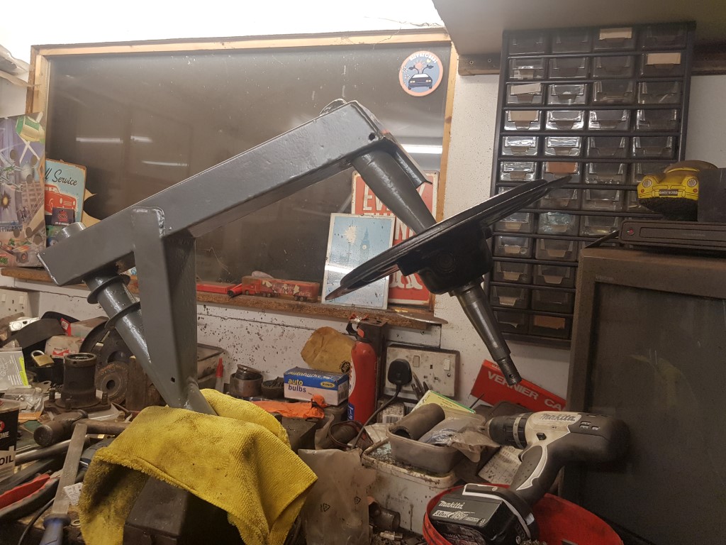

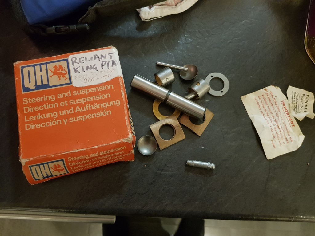

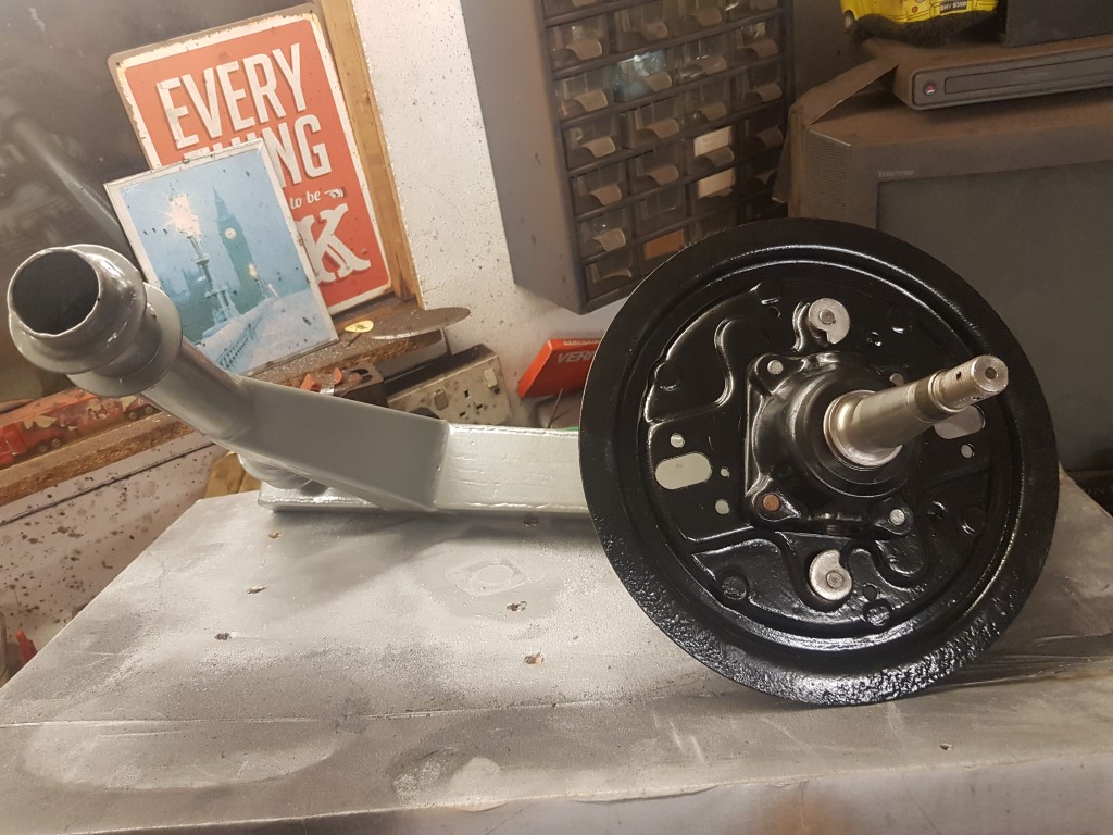

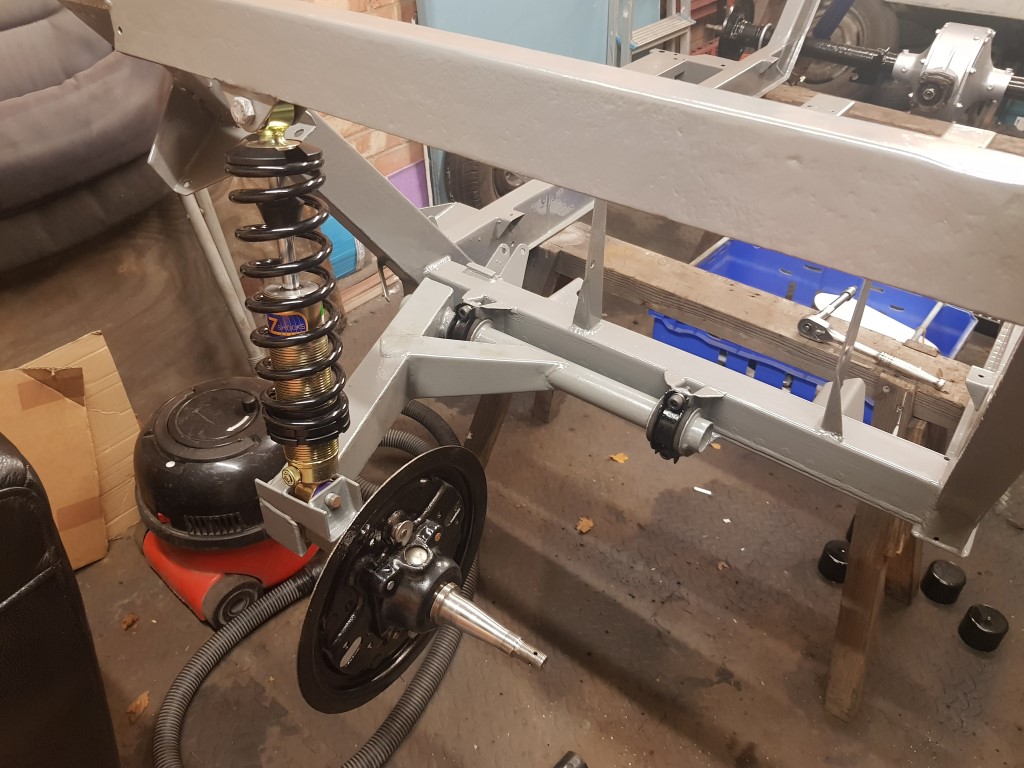

I then moved onto the front A frame, this was all galvanised and powdercoated with the chassis but all the components that go on it had to be refurbed, a new king pin was fitted too...
20201211_184403 (Medium).jpg (171.62 KiB) Viewed 22685 times
20201220_205650 (Medium).jpg (242.18 KiB) Viewed 22685 times
20201220_213731 (Medium).jpg (238.27 KiB) Viewed 22685 times
this was then fitted to the chassis along with a coil over adjustable front Gaz shock...

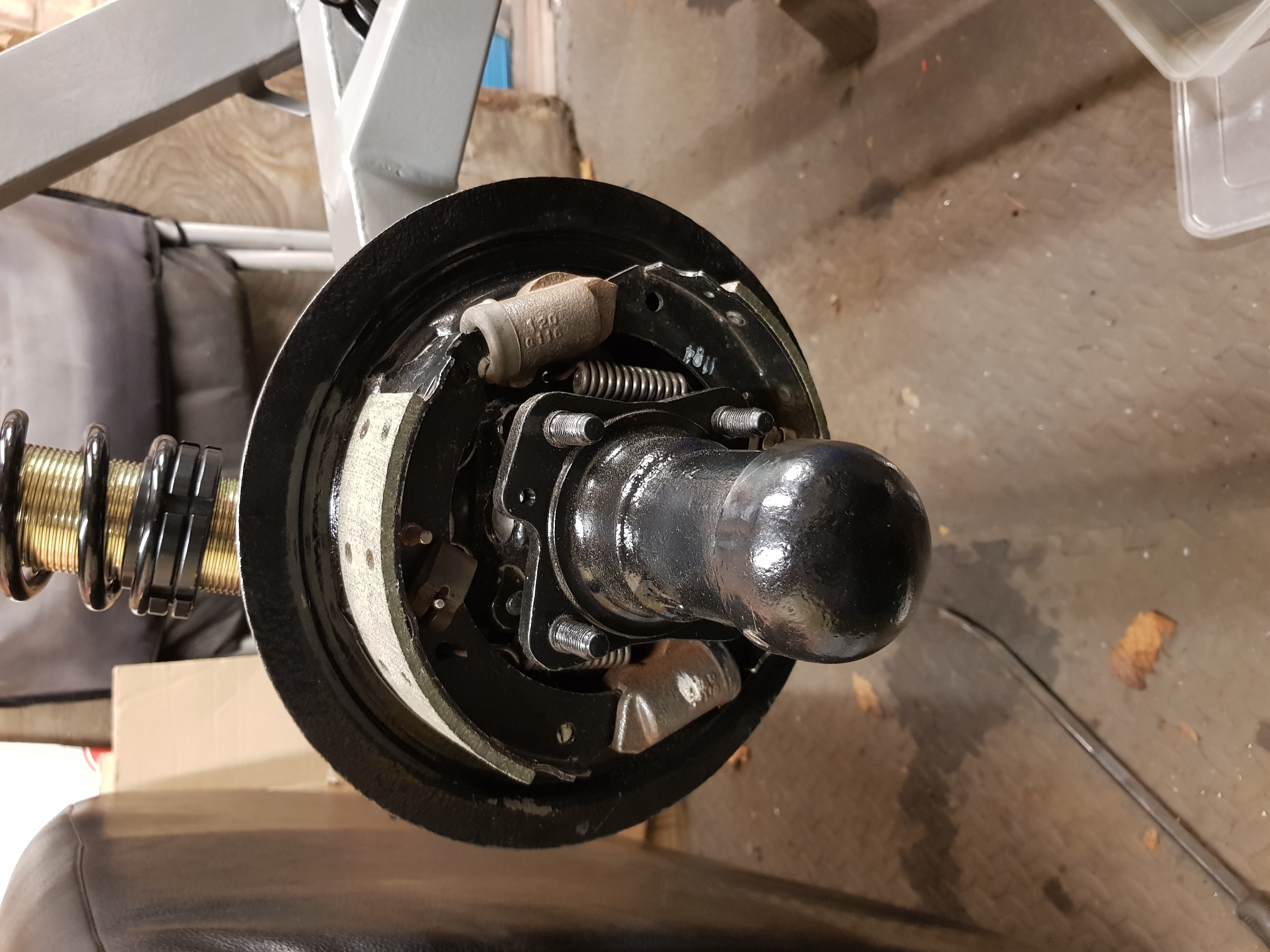

All new brakes and refurbed drum fitted ...
20201228_163102 (Medium).jpg (153.93 KiB) Viewed 22685 times
