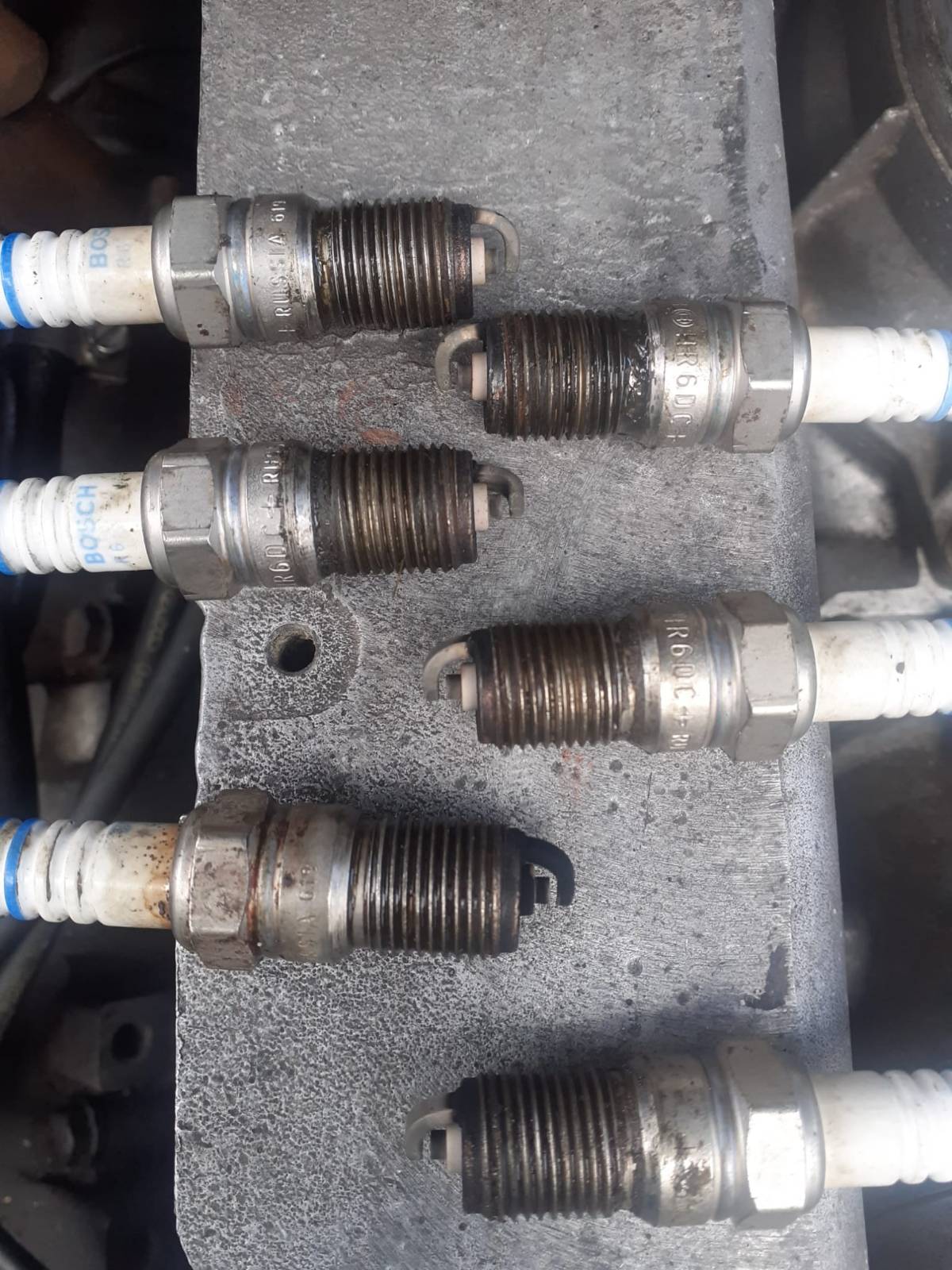

A while back, slightly rough idle deteriorated to intermittent misfire, so the plugs showed:
Corresponding as you look at it from the rear fascia.
Noting rear left is sooty, I replaced them. That plug also showed sign of having been wet/ bit crusty. So it could be that.
Cleaned refitted, seemed better, then returned. I had injectors, so as a quick query tried a new injector. Ran ok, as soon as it got hot, it was perfect, and has been grand ever since.
Time to do the other 5 injectors. Also have a rotor and dizzy cap to try. Needs an oil change anyway...
