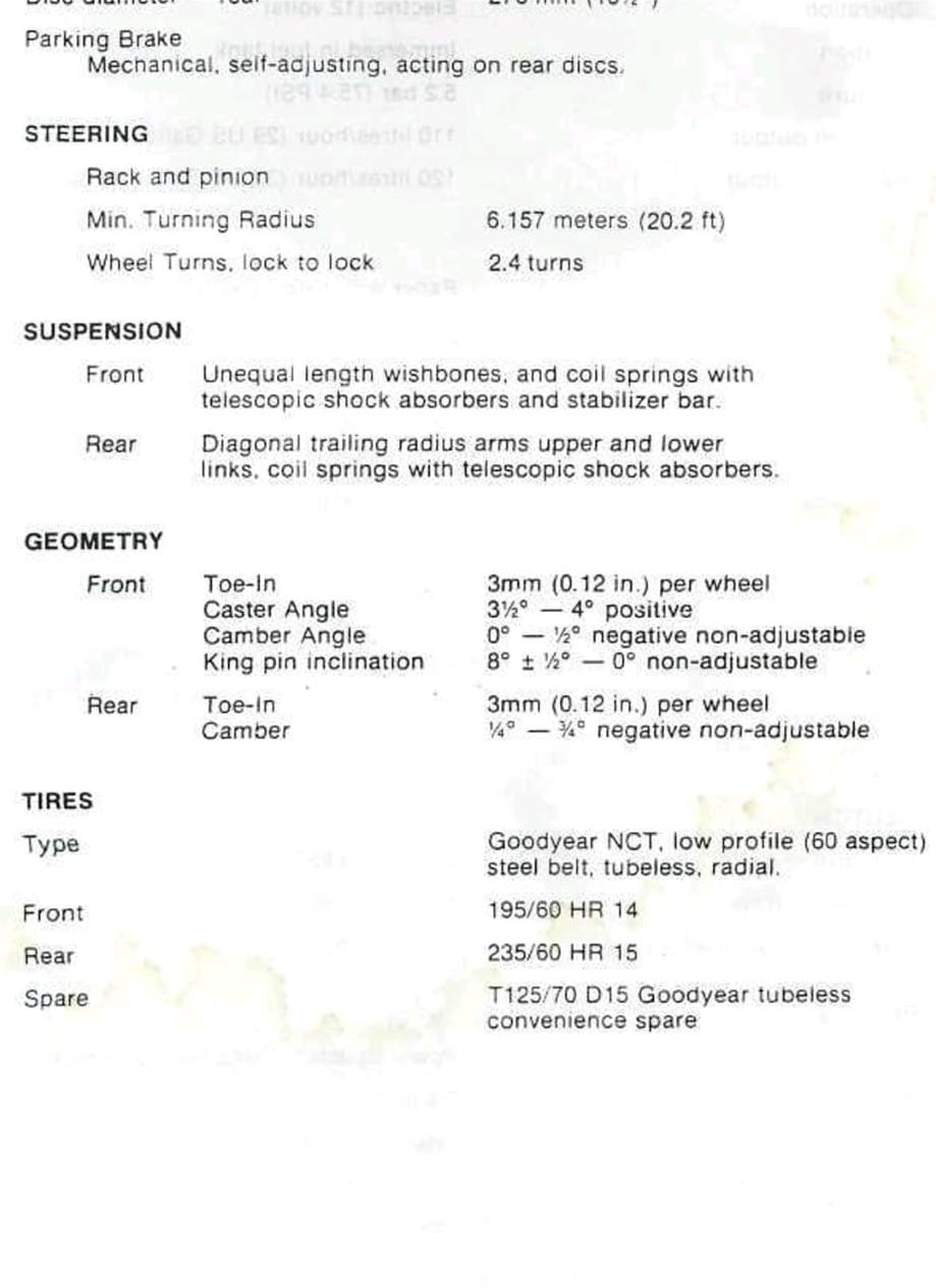

(3) Spoke to the guru of alignment, Nick T, who sent me the very helpful attached settings sheet and much excellent advice.

- A 4 wheel Hunter alignment is all well and good but it's not a patch on an old boy who's been setting up race cars for 30 years, and will sort out your ride heights, corner weights and dampers as well as which way the wheels are pointing.
- My new Spax settings are STIFFER at the front (16 clicks clockwise from minimum) and SOFTER at the back (4 clicks clockwise from minimum). An interesting change from the standard 7/7 F/R we'd all been running at for years? Might be worth others trying this and reporting back.
