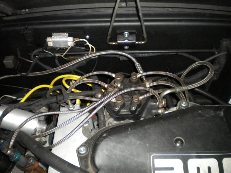

Postby tourettes tony » Wed Aug 25, 2010 8:30 pm
heres my set 6 years on
fuel lines (Medium).jpg (73.71 KiB) Viewed 6991 times
