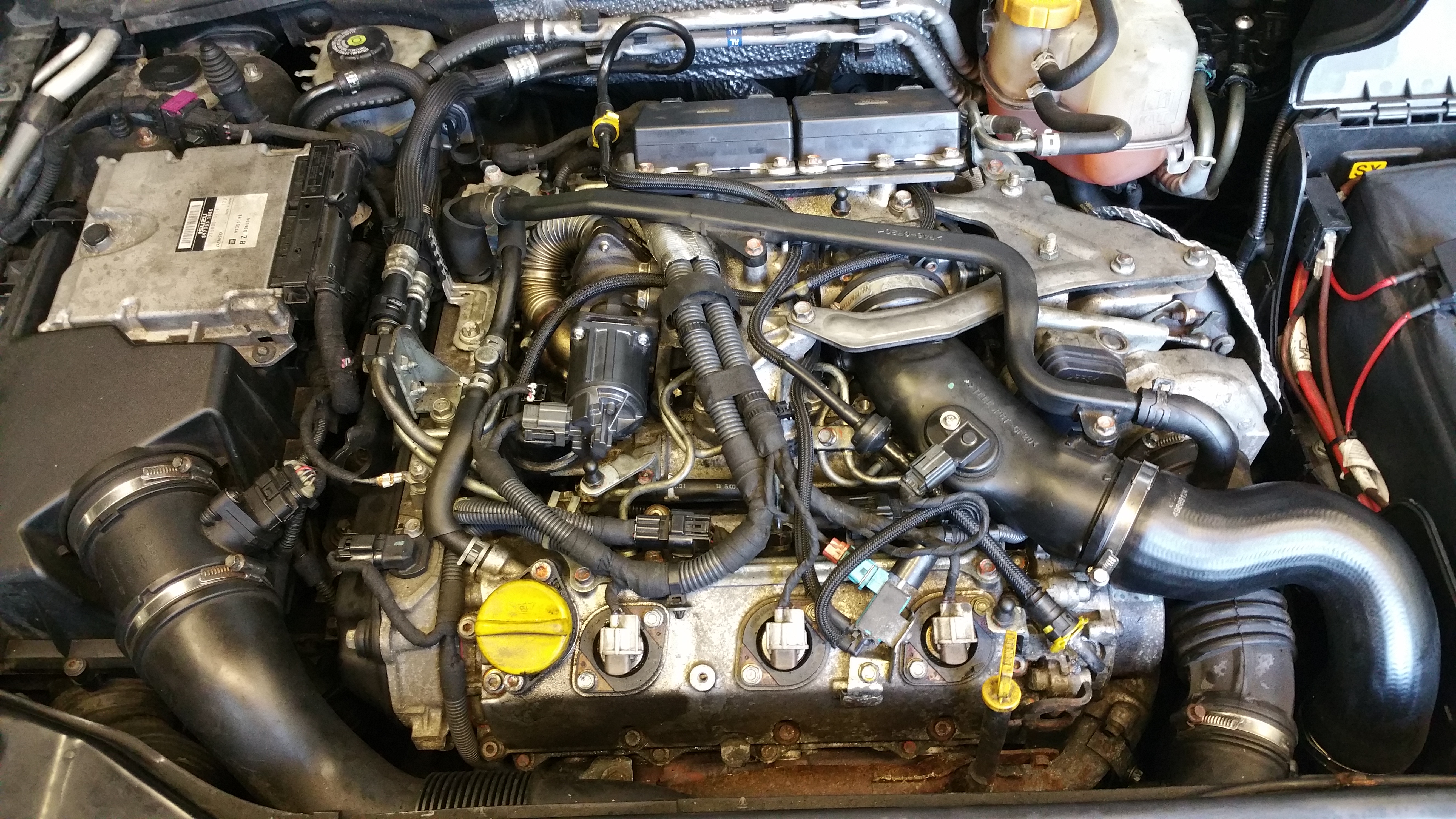

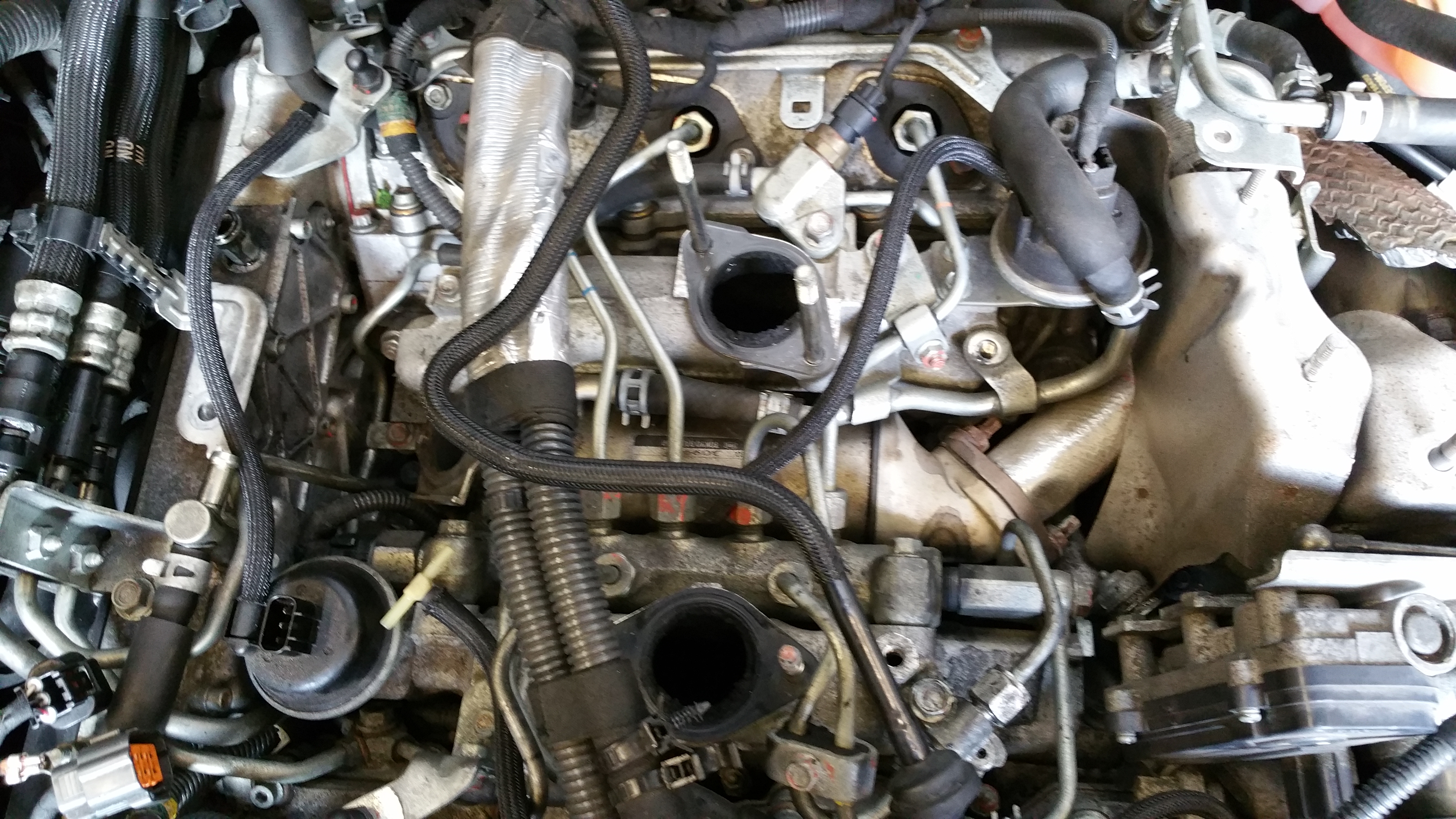

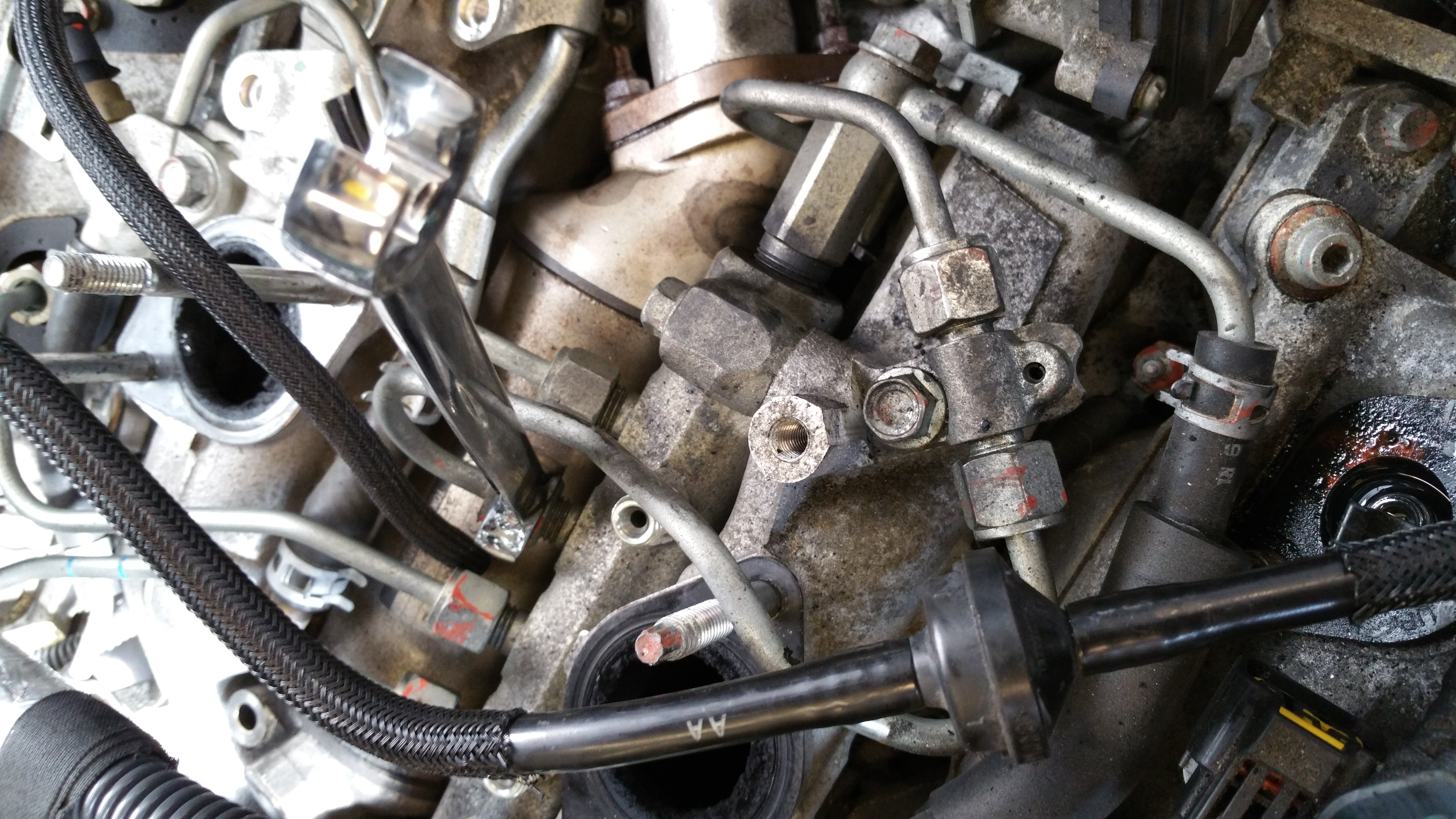

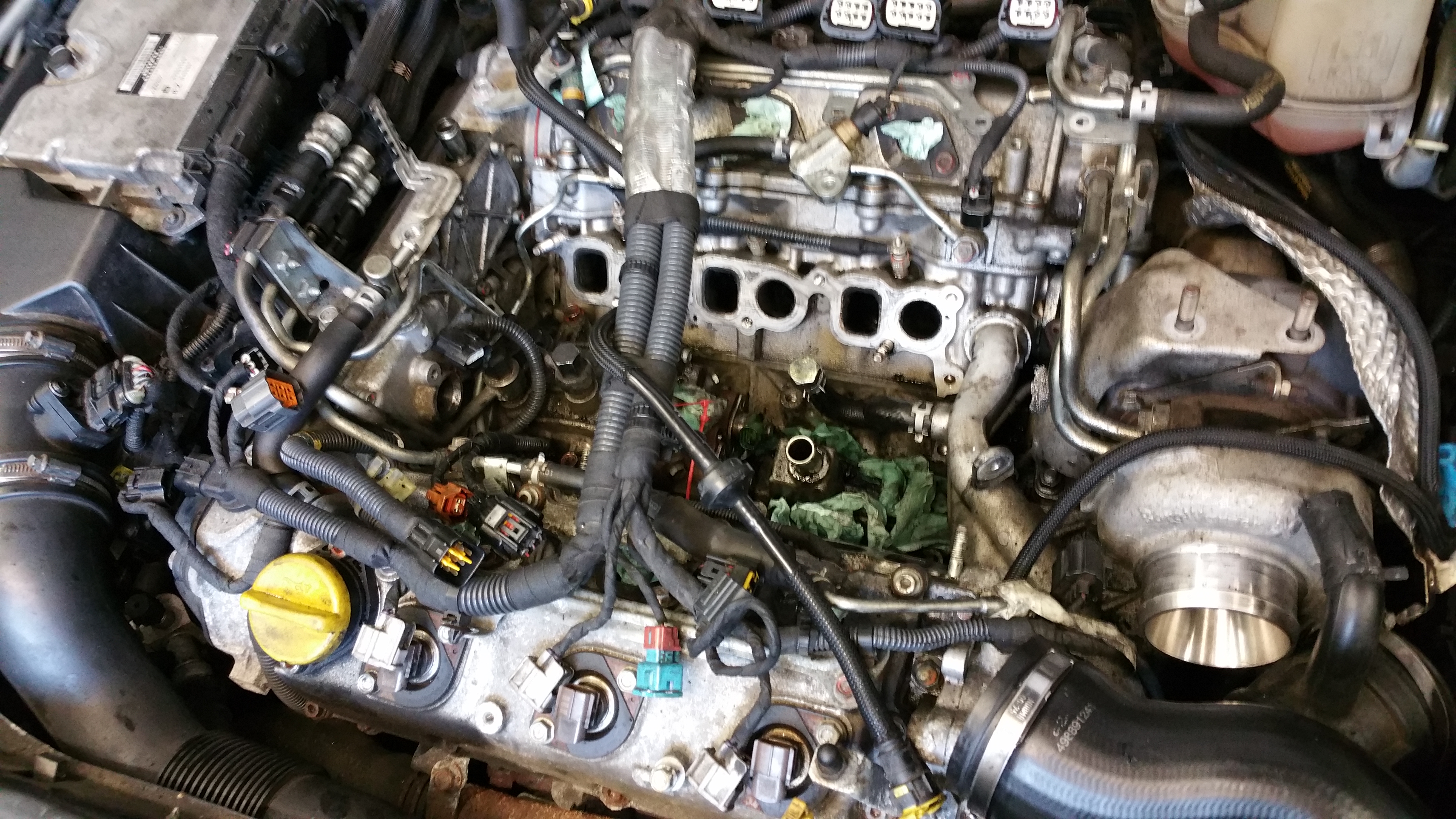

I went back in the "Vectra" valley last weekend, a bit further to change the Suction Control Valves in the Denso diesel pump (a common problem)....
Pictures don't include the removal of all the injector pipes, common rail, electric turbo variable vane actuator and all electrical wiring loom connectors. .
Car passed the MOT and the emissions were "trace" ie detectable but not registered ie less than 0.01 smoke density :)
My back is just recovering !
Hopefully I can move on to Delorean stuff during my Christmas break. ...
New suction valves installed (the red and green bits)
Swirl valve manifolds out. A real valley!

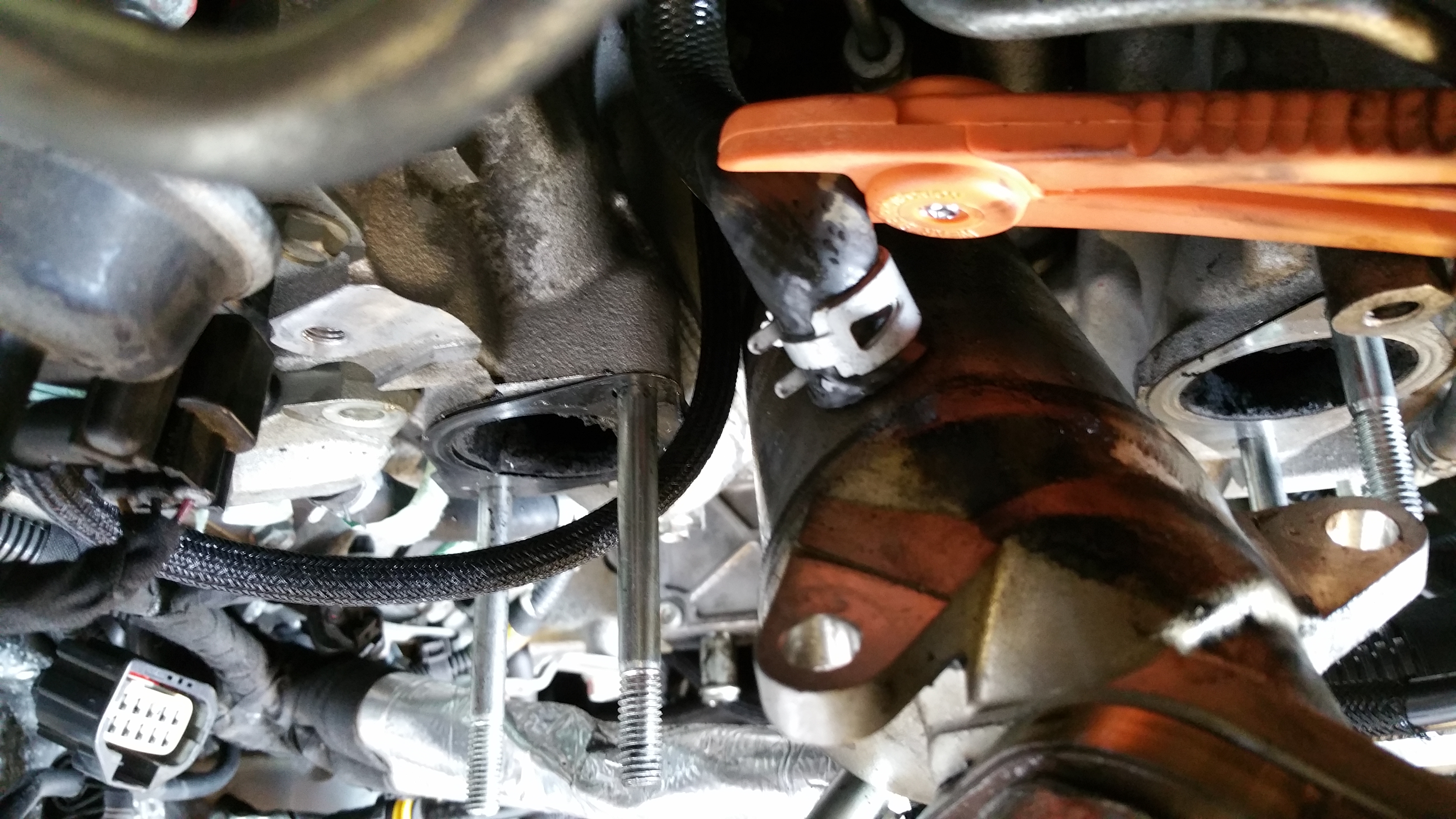

Egr cooler pipe... my chuffing back. .
How the chuff did I get the egr intercooler out!
Still not in there
