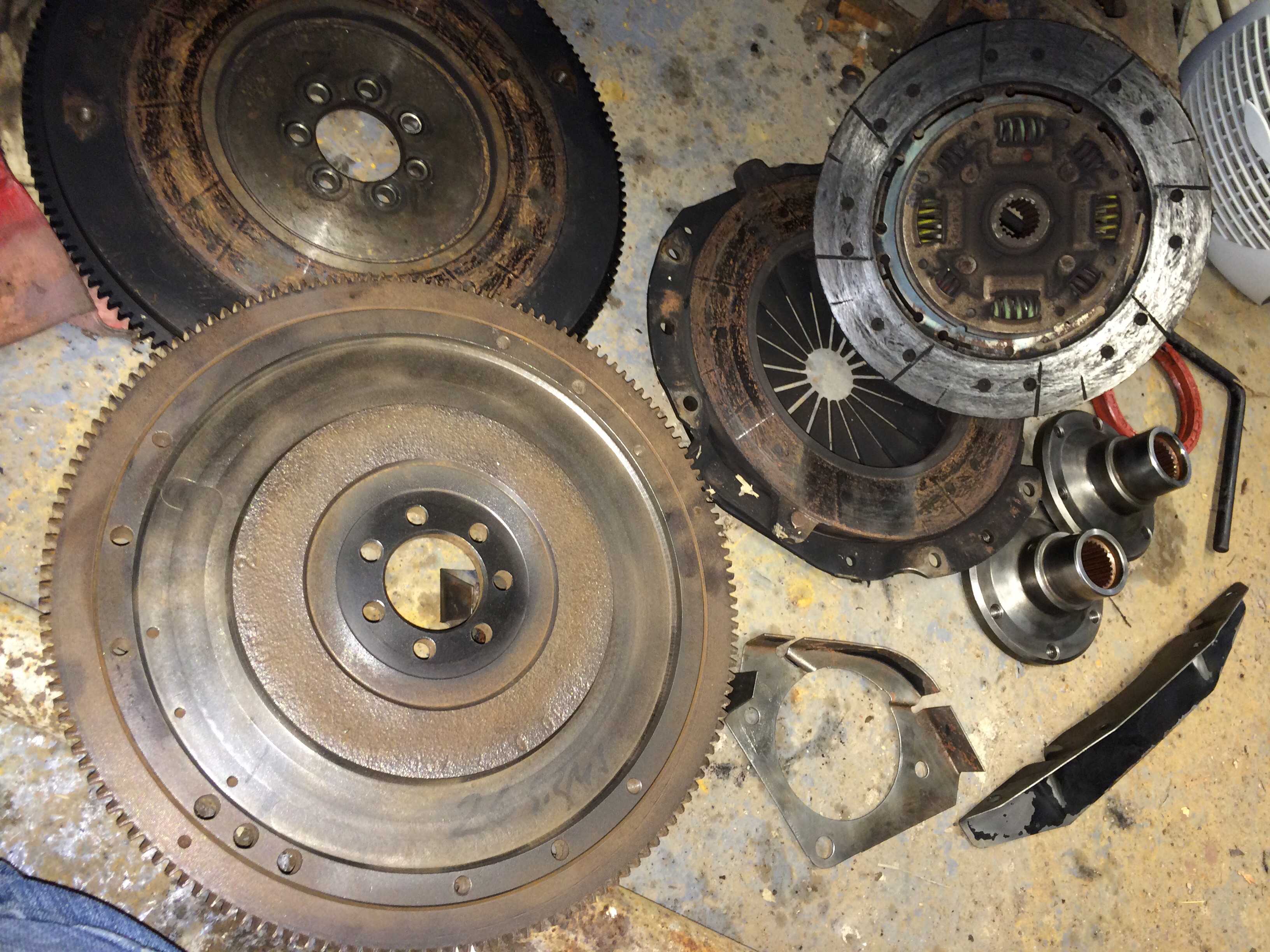

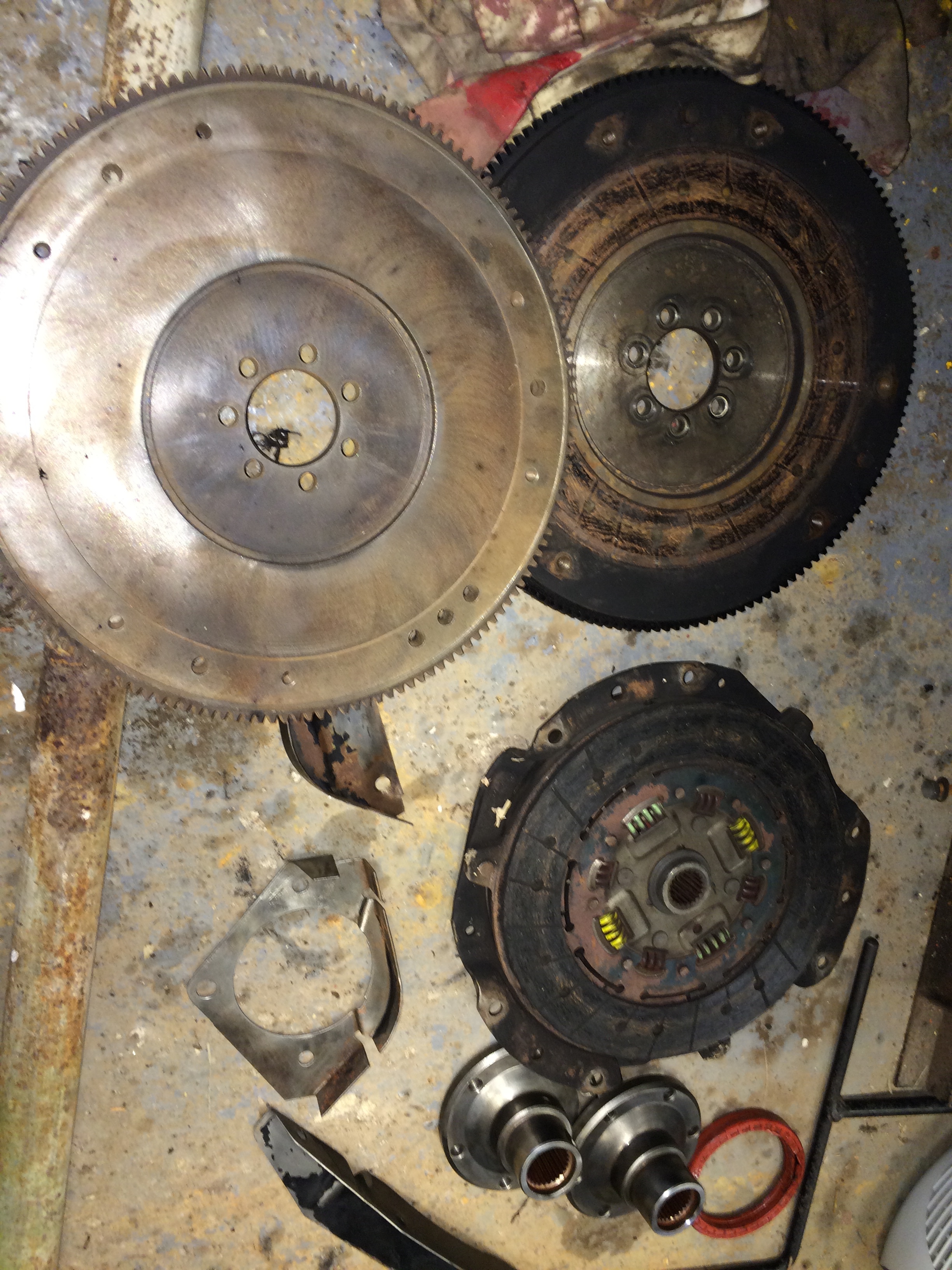

Lightened Fly wheel
lightened fly wheel

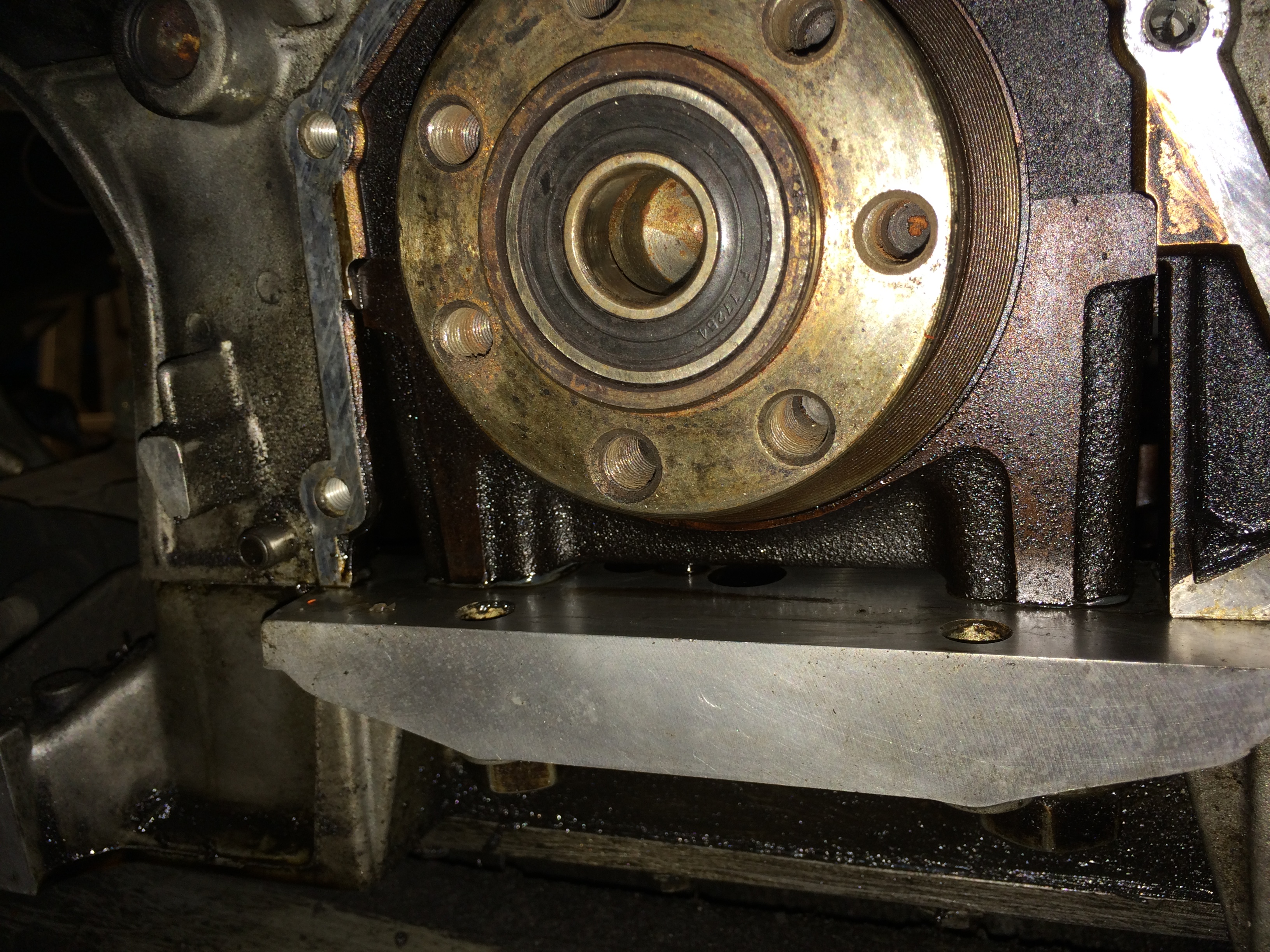

Engine Without seal plate.
lightened fly wheel
another view of engine.
Engine rear

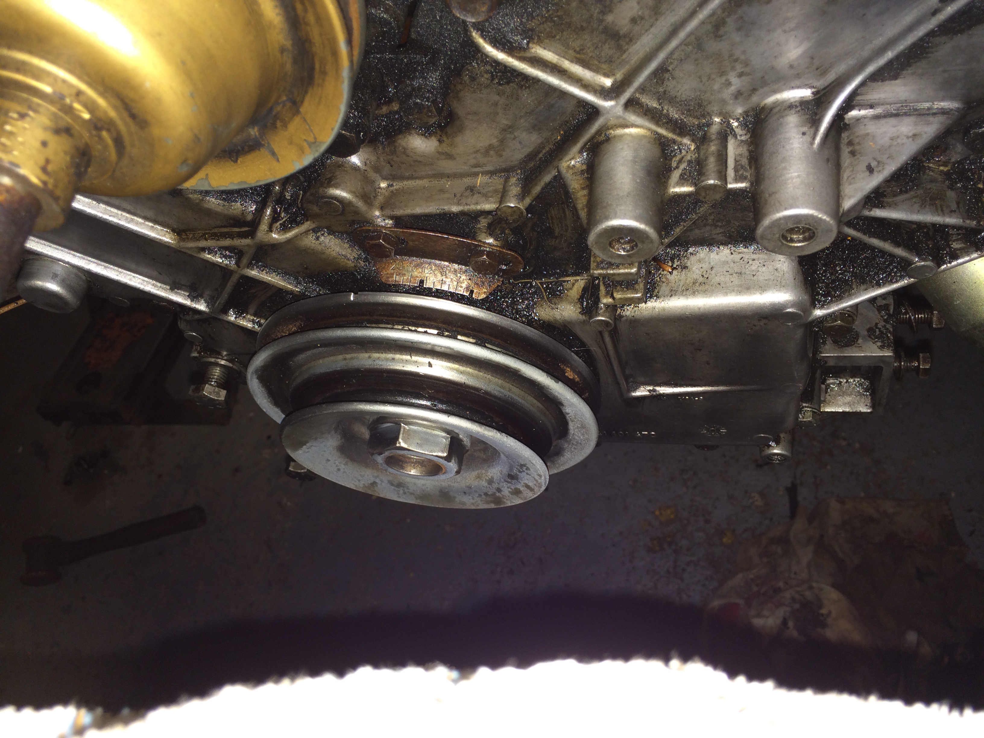

Front of Engine - other seal I am replacing
engine front

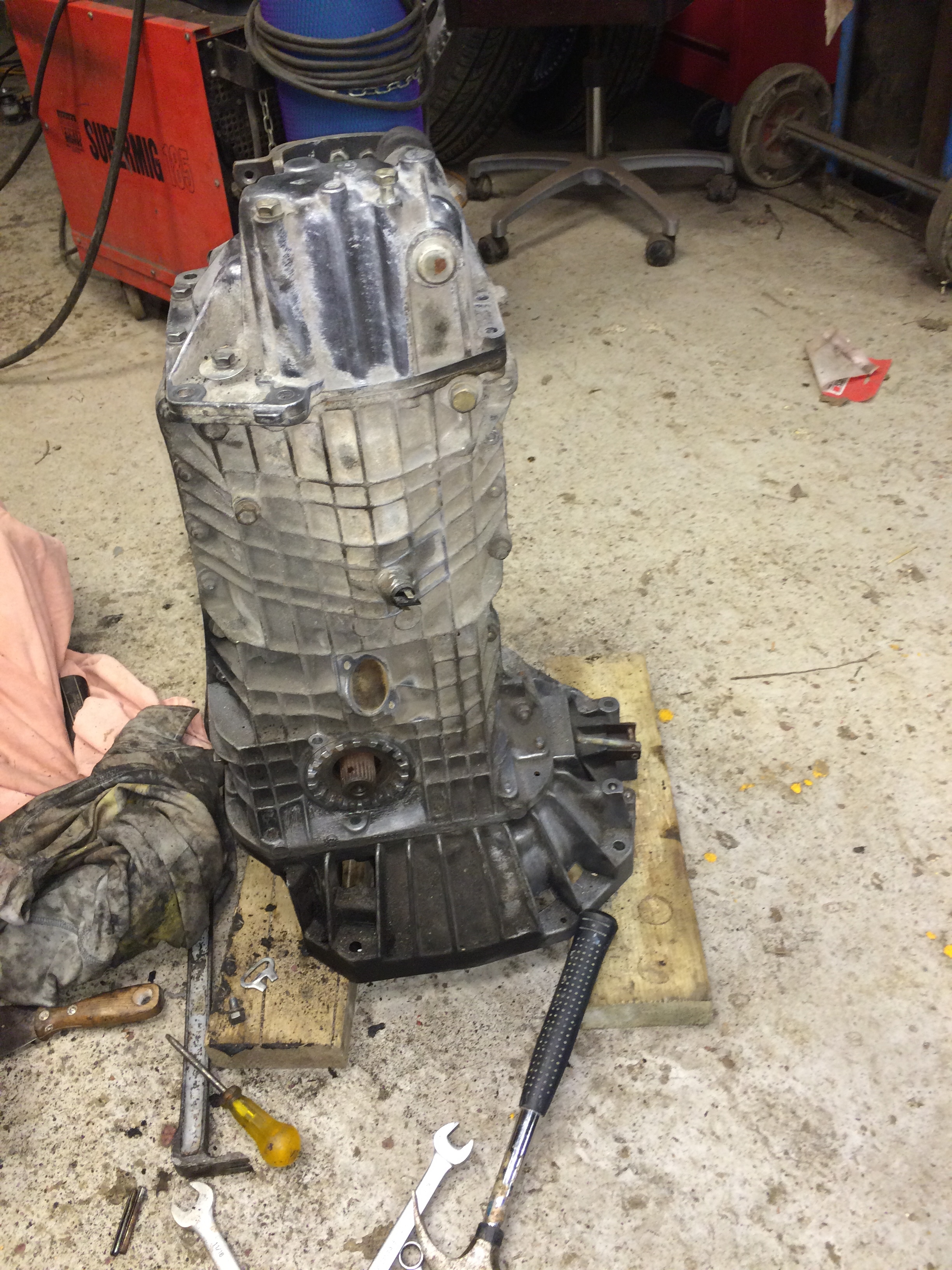

gearbox out for cleaning and diff seal replacement.
Gearbox

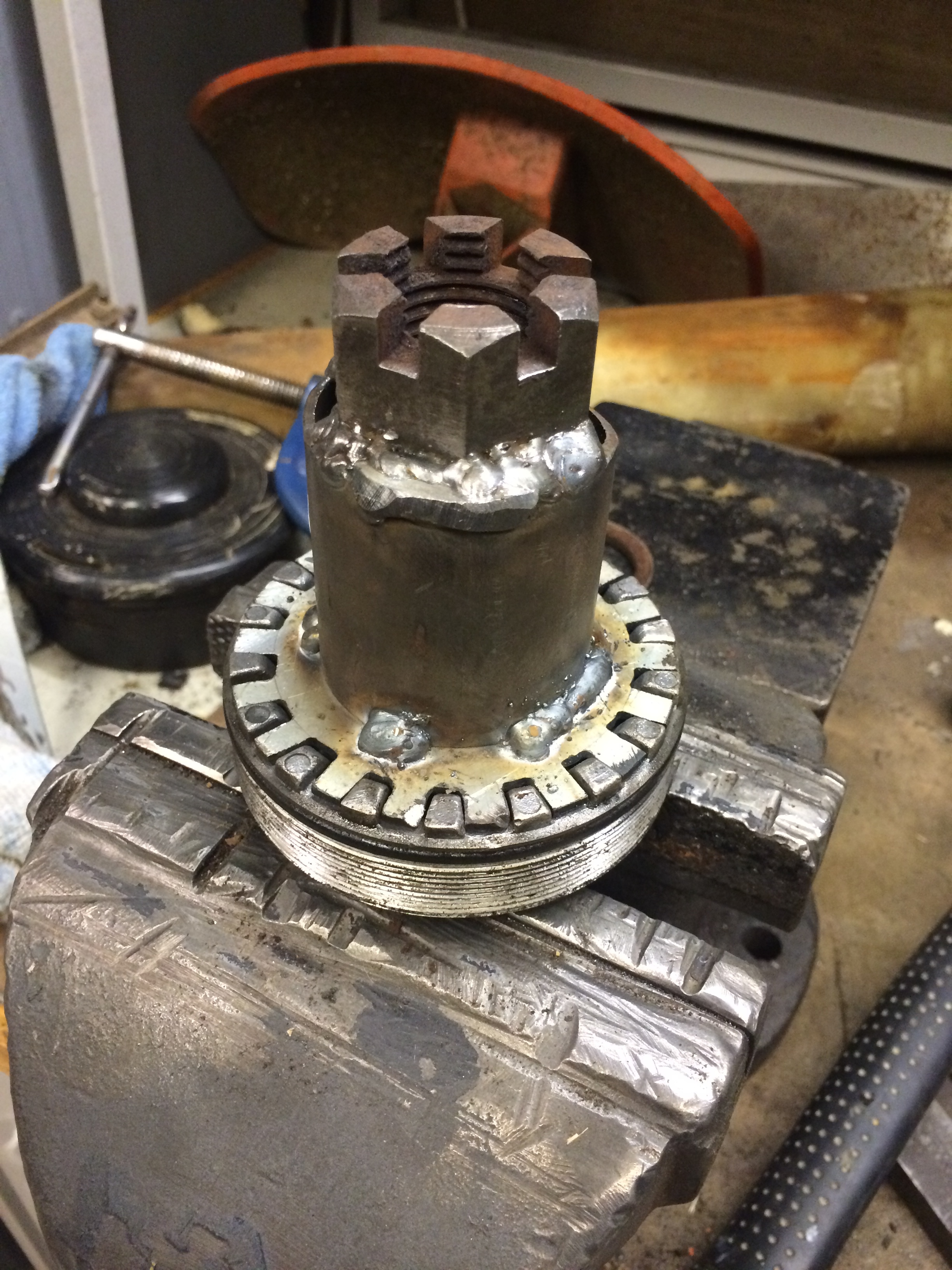

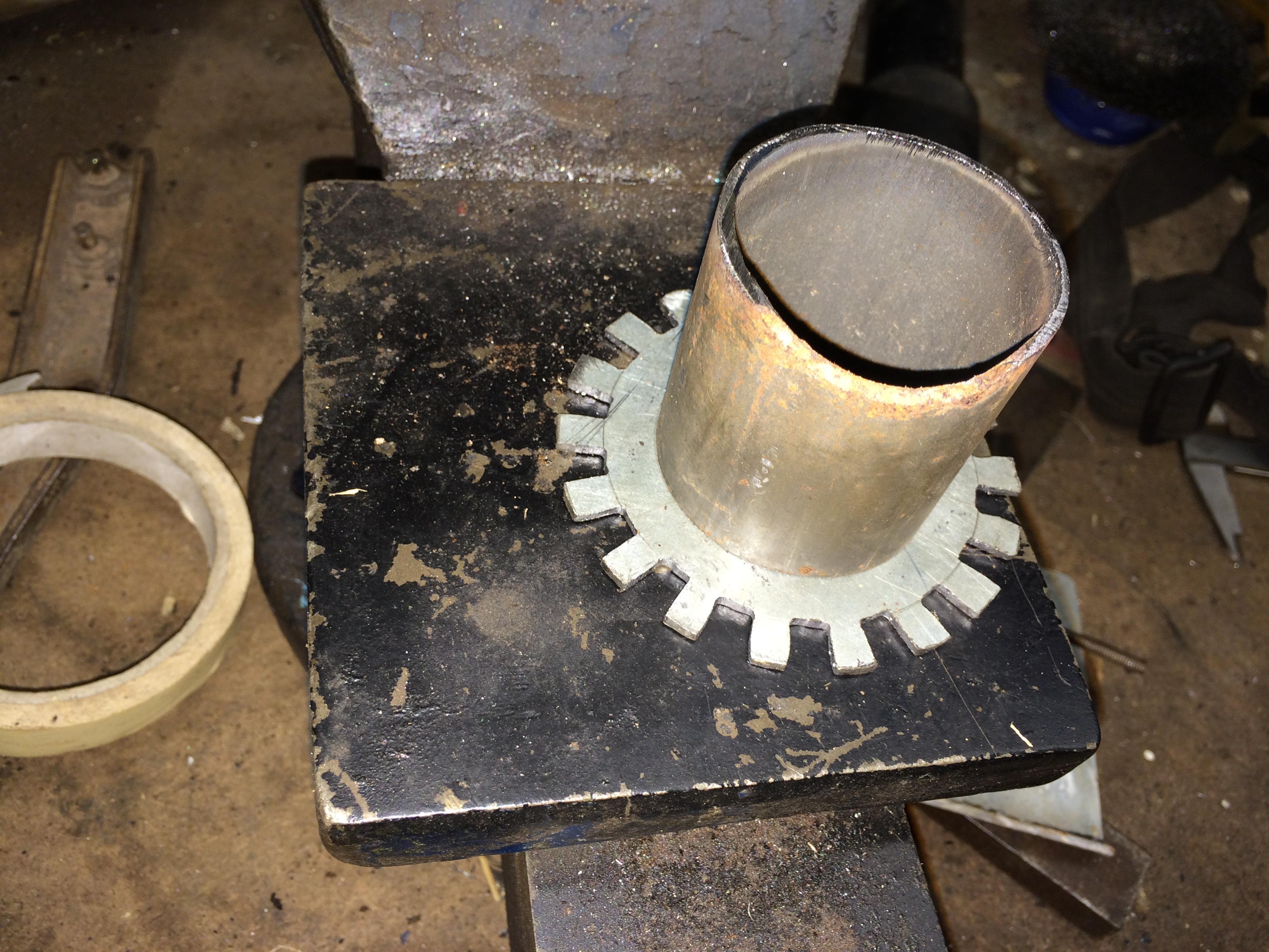

Making the tool to remove the diff nut.
making the tool
finished tool.
finished tool

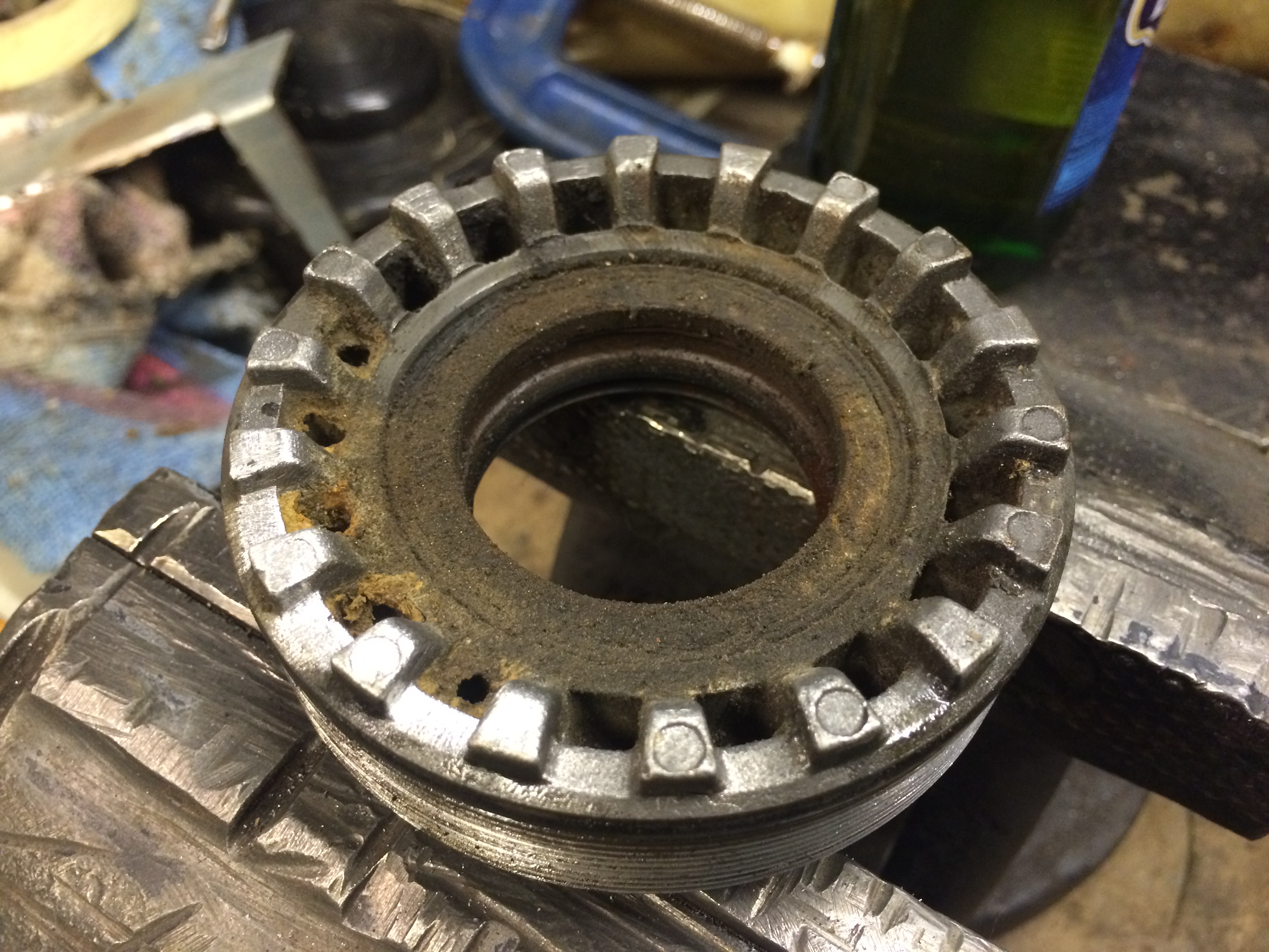

diff nut awaiting replacement seals... just need to order them and speed sleeves now.
diff nut
the tool will be available for anyone to use once i have my gbox back together. Admittedly it is not as professional and pretty as the photos i have seen of Darrens. but it works, and did not damage any of the castles.

Another pic of the lightened flywheel going on.
