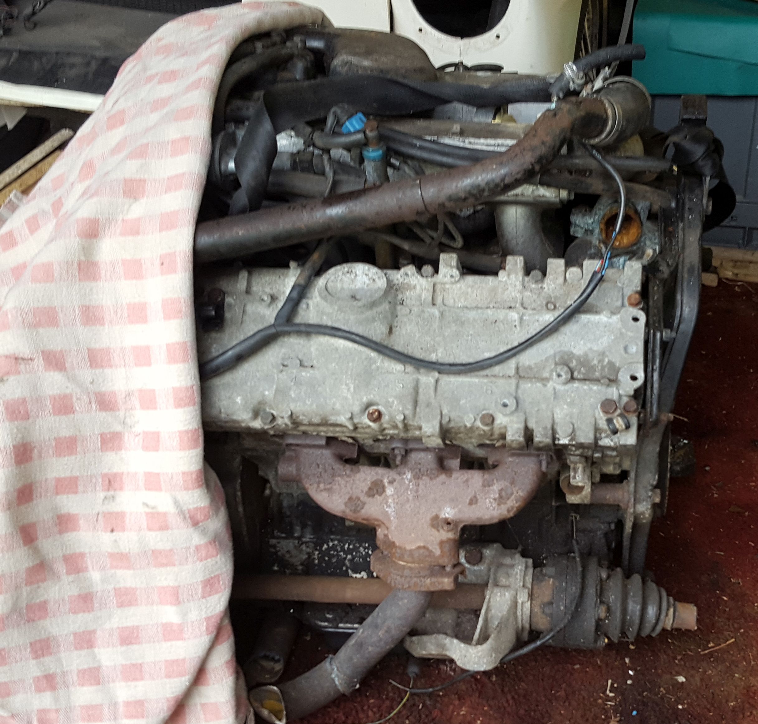

Look what Mec found on Flea bay. 2.8 PRV6 from a Lancia Thelma, with K-Jetronic fueling. Unfortunately we think it maybe fucked as we done a compression test on 2 cylinders that we could get to easily and nothing registered on the gauge. So when i get time I will remove the fueling and inlet manifold and test all 6 cylinders without and with pouring a little oil down the cylinders to see if that improves anything and maybe prove my suspicions correct??? The block is solid though and the fueling is complete. More acquired shit for club spares

I had a great morning with the monkster picking this up this morn :mrgreen: totally found by chance and this opens up a new car for us to search for with this engine, the late 80s Lancia Thema :thumbsup: :thumbsup:

I have fueling bits from a Thema in the box of bits I got last year. Some small differences from the DeLorean and Volvo variants, but so far I've done nothing with the bits I have other than take inventory. I don't have the complete setup though as it came mixed in with some 262 and Renault Alpine bits.
