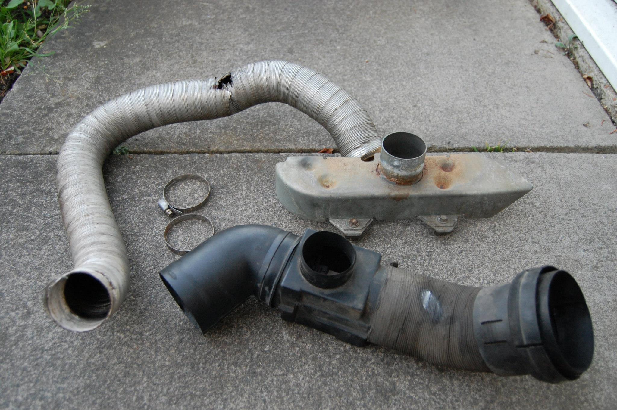

Re: Performance air intake
PostPosted: Fri Nov 02, 2018 5:58 pm
by MikeWard
eric wrote:What do I do with the other end of the rusty pipe ? just remove totally and leave a hole.... This explains why I had so much trouble trying to fit with the existing fitting in line :)
Remove everything you see here.
OE air intake.jpg (401.8 KiB) Viewed 5032 times
PostPosted: Fri Nov 02, 2018 7:28 pm
by eric
Super thanks, quite a space saving :)
