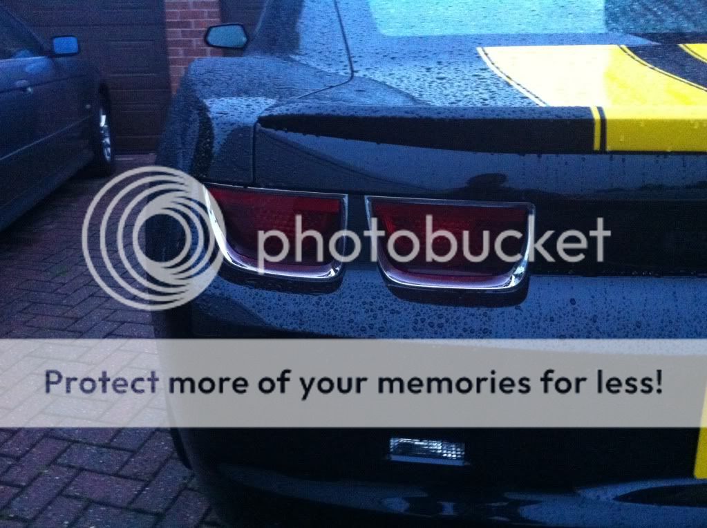

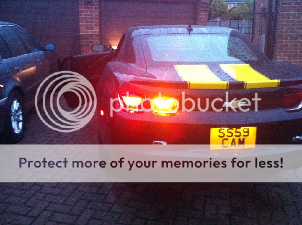

Postby bandit » Fri Jul 12, 2013 7:59 am
Nothing much to it Dan, mines about the same, pair of repeaters on the wings. Loads use self adhesive LED's now, quick & simple. A rear fog of some sort & just amber bulbs for rear indicators. Mine still has red lenses, but they show up amber when lit.
