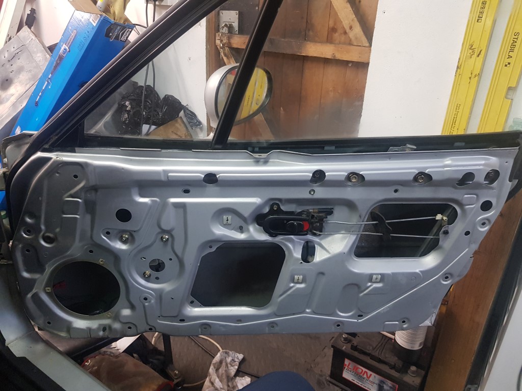

The drivers side window on the car doesn't work, this was in the advert so was always on my to do list, so I took the door card off and this is what i found...
20191002_215318 (Medium).jpg (228.42 KiB) Viewed 9311 times
Someone has been here before and attempted to repair the regulator with wait for it ... push bike gear cables !!! ...

So its safe to say this regulator is going in the bin and a new/2nd hand one will go in once i find one (which i think i have ;) )

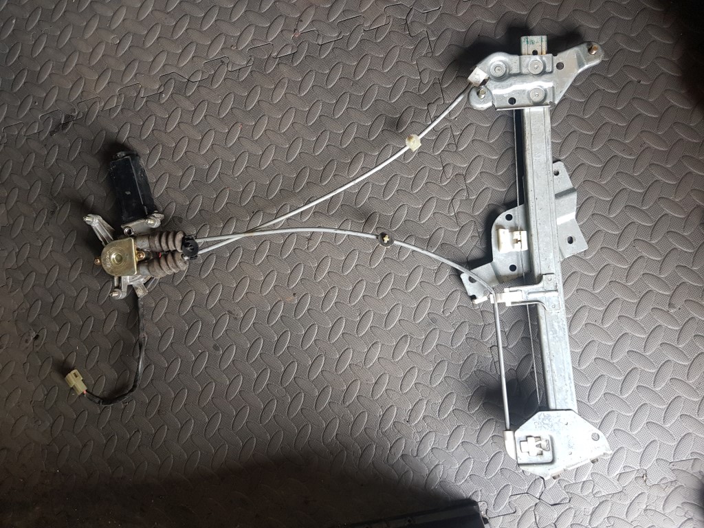

A few updates for you over the last week, i picked up a 2nd hand window regulator to replace the bodged one that was in the car, this was a massive £35 so very good value in my opinion...

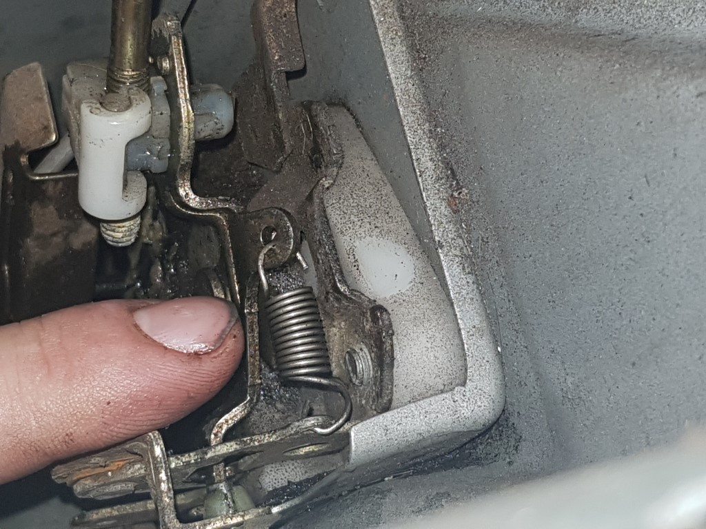

Whilst i was in the door I sorted out door lock too, it didn't work properly, this turned out to be a snapped return spring which was laying on top of the lock, i nicked a coil out of the spring and bent it into a hook shape and reattached it, a nice free fix ..
20191004_110730 (Medium).jpg (263.21 KiB) Viewed 9218 times

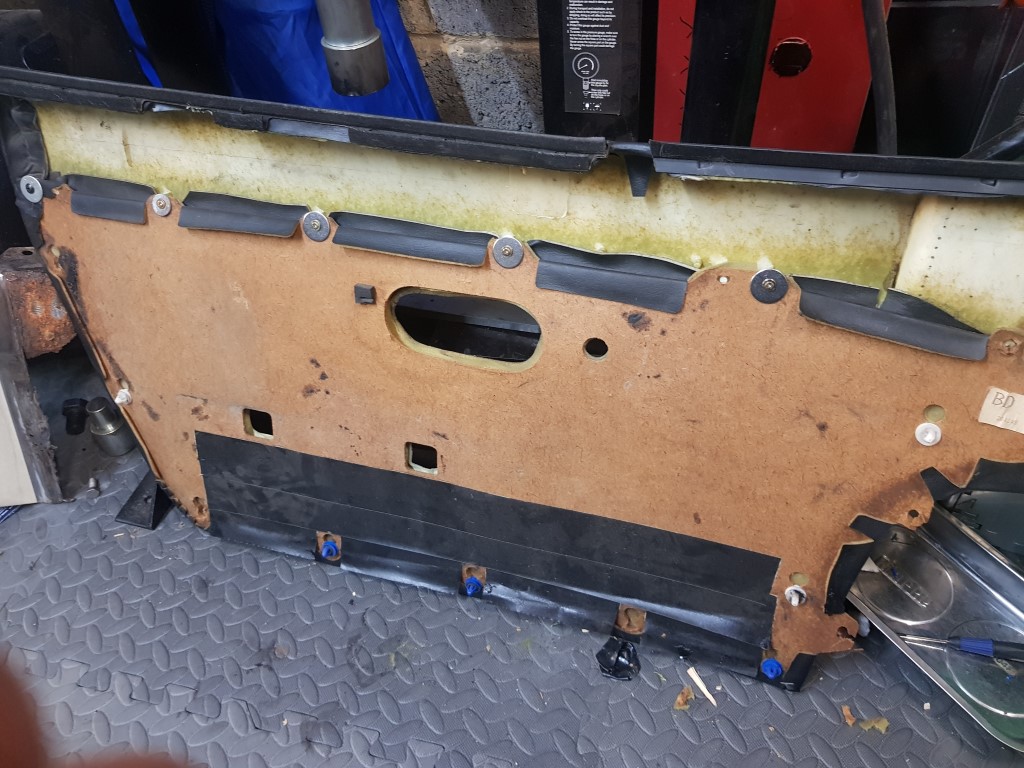

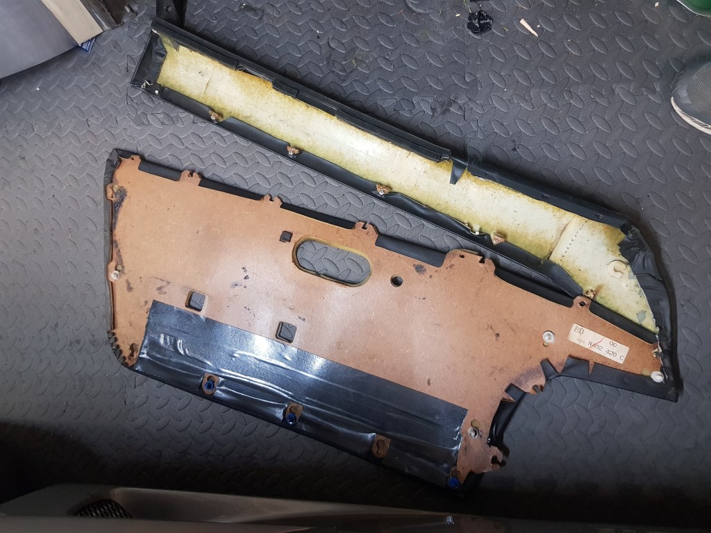

Also when i took the door card off it was pretty much in half...
20191006_221831 (Medium).jpg (222.34 KiB) Viewed 9218 times
So this was easily repaired with some oversize washers
20191006_222920 (Medium).jpg (214.53 KiB) Viewed 9218 times
I then cleaned all the black sticky stuff off the inside..
20191006_235931 (Medium).jpg (217.98 KiB) Viewed 9218 times

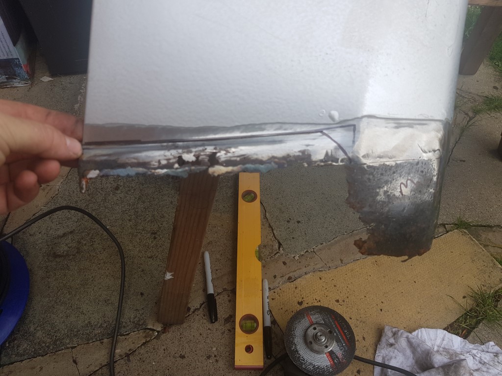

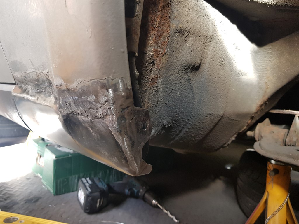

and put everything back together, the window and lock are now working great, I then turned my attention to the rusty wing, I was just going to replace it, however with this being a budget project I thought Id have a go at repairing it 1st , here's the wing before...
20191008_145539 (Medium).jpg (221.71 KiB) Viewed 9218 times

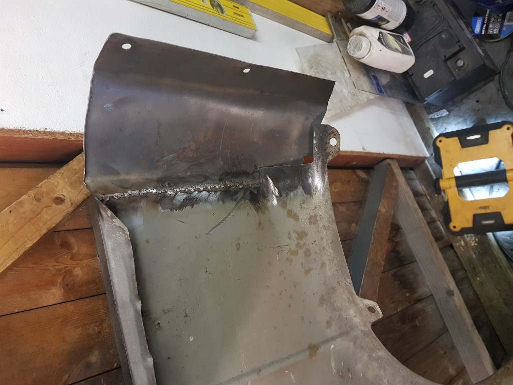

I cut it back to good metal and started making a panel...

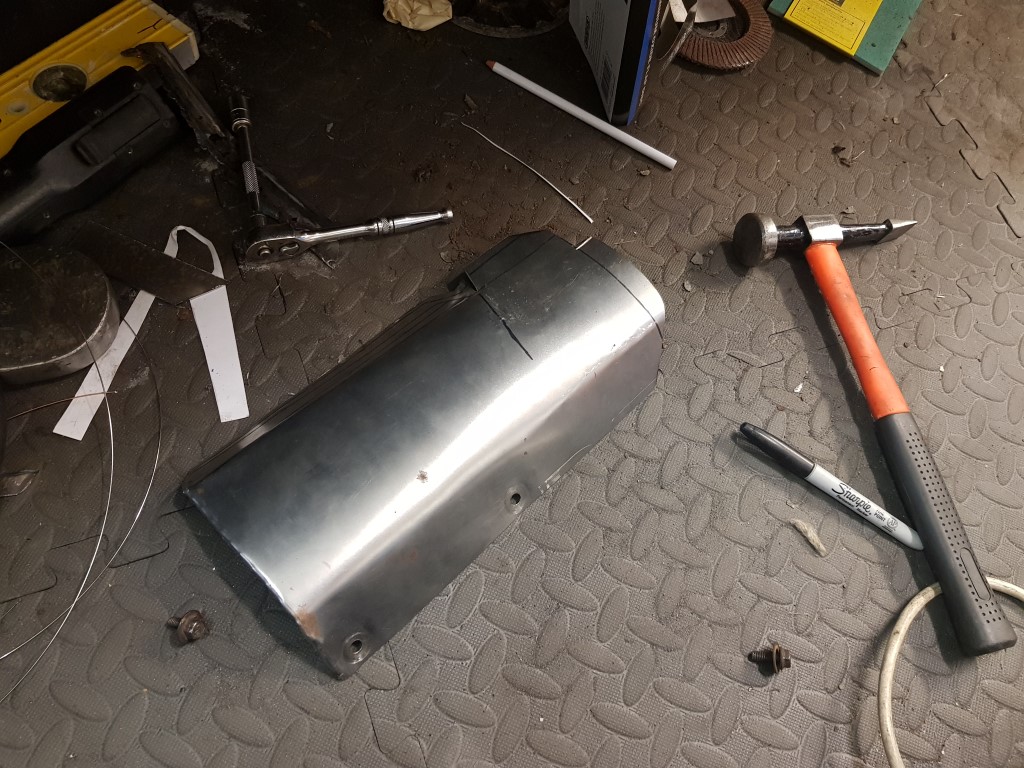

20191008_201637 (Medium).jpg (93.43 KiB) Viewed 9218 times

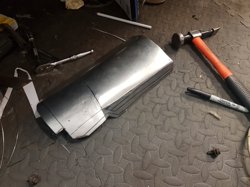

this then turned into this ...
20191008_213351 (Medium).jpg (241.66 KiB) Viewed 9218 times
20191008_213357 (Medium).jpg (237.43 KiB) Viewed 9218 times

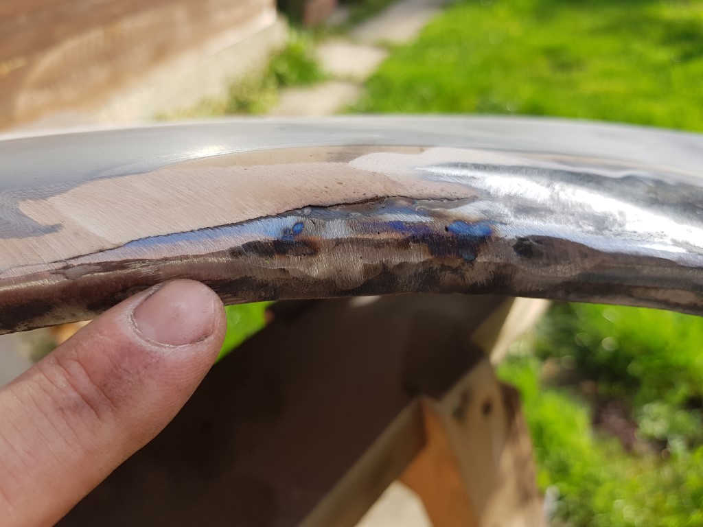

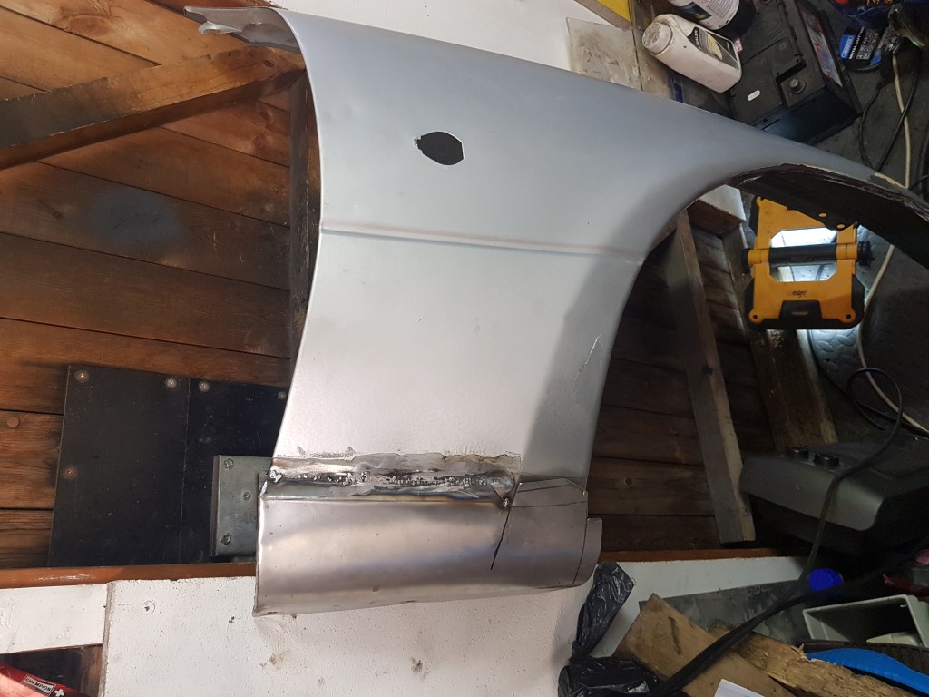

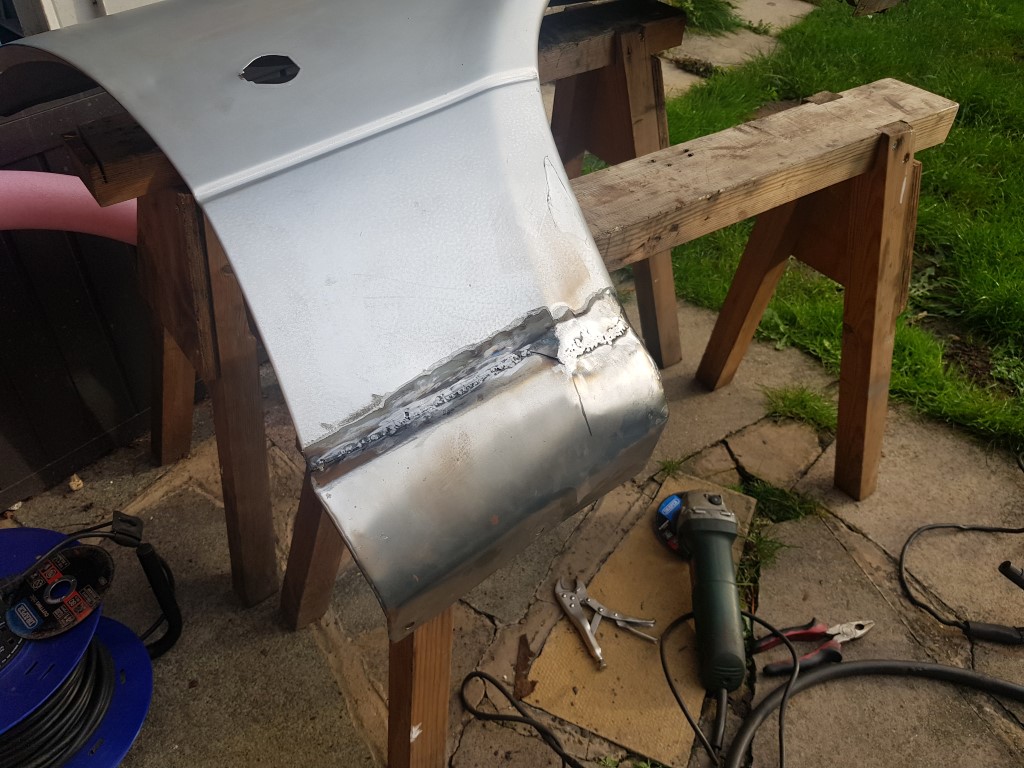

I welded the 1st "curved section" from the back so there would be minimal dressing needed on the front groove
20191008_220156 (Medium).jpg (166.3 KiB) Viewed 9218 times

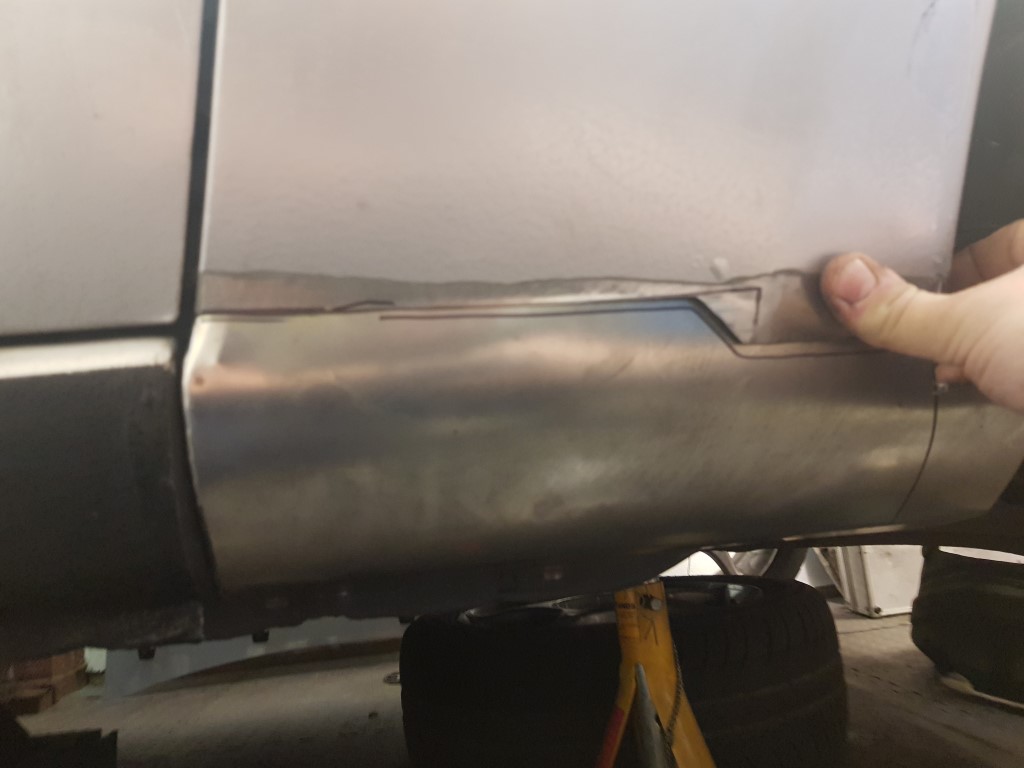

the other section I welded from the front as this bit is flatter and has to curve in a different way..
20191008_220332 (Medium).jpg (186.12 KiB) Viewed 9218 times
20191009_093411 (Medium).jpg (237.54 KiB) Viewed 9218 times

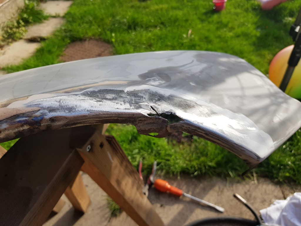

there was also this hole hiding under the filler..
20191009_095611 (Medium).jpg (194.37 KiB) Viewed 9218 times
I had to weld a plate in from behind as the metal was so thin, there was also a small rust hole a bit further round the arch, this was small enough to weld up ..

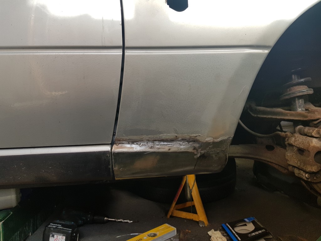

finally this is the wing test fitted back on...
20191009_104734 (Medium).jpg (134.11 KiB) Viewed 9218 times
20191009_104746 (Medium).jpg (206.71 KiB) Viewed 9218 times
Its by no means perfect but a lot better than the previous repair, It bolts into the original holes now as least !
It will require some filler, hopefully this will make the repair look nice and tidy, we will see i guess, this will be the next step. on we go, Hopefully another update coming soon ;)
