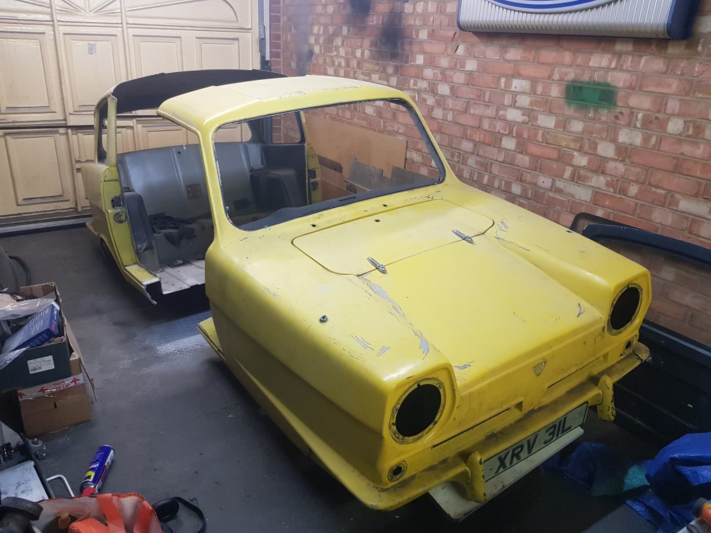

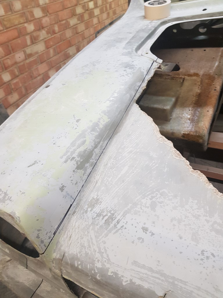

Shortly after we got back from our Norfolk meet, i decided to do something with the saloon, I had a deal going with a guy local to me in Chelmsford who deals in Regal parts, he wanted a regal front end cut above the windscreen to turn into a photo booth for the Only fools and horses shows he does,
(he was trying to buy the saloon off the guy i got it from but i beat him to it) so i did a deal with him for my front end cut above the screen for another front end cut below the screen and some parts my way ...

I must add i DIDNT want to do this !! but needs must

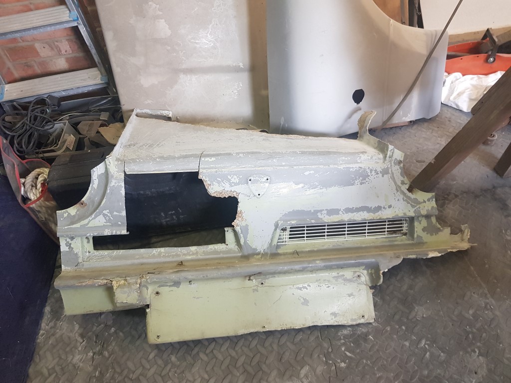

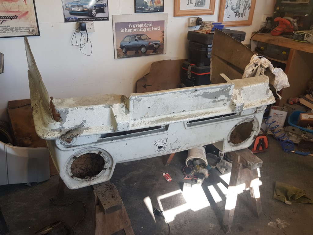

Before the Front end went, i had to cut off the inner air vent section which i need for the van
20200318_212157 (Medium).jpg (183.45 KiB) Viewed 8964 times

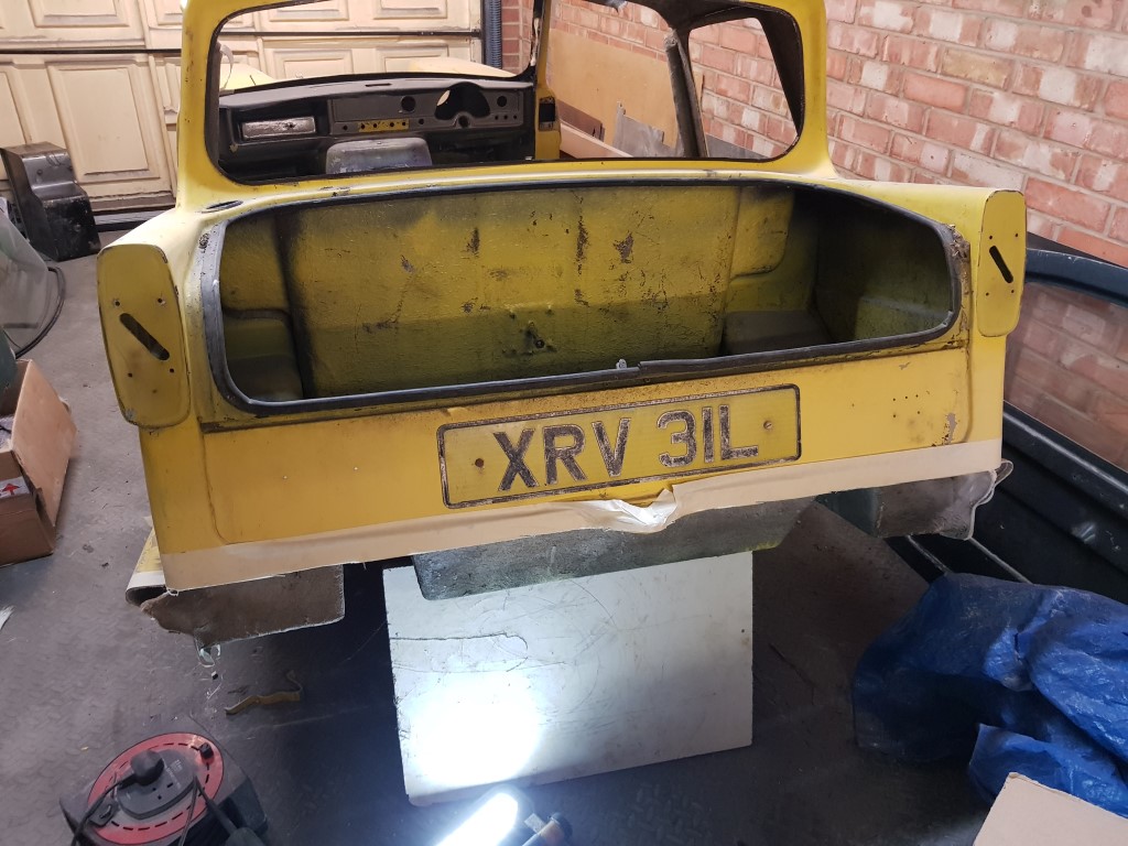

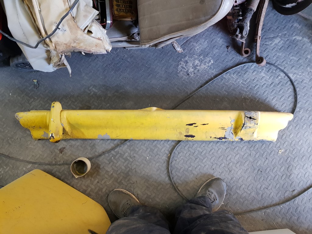

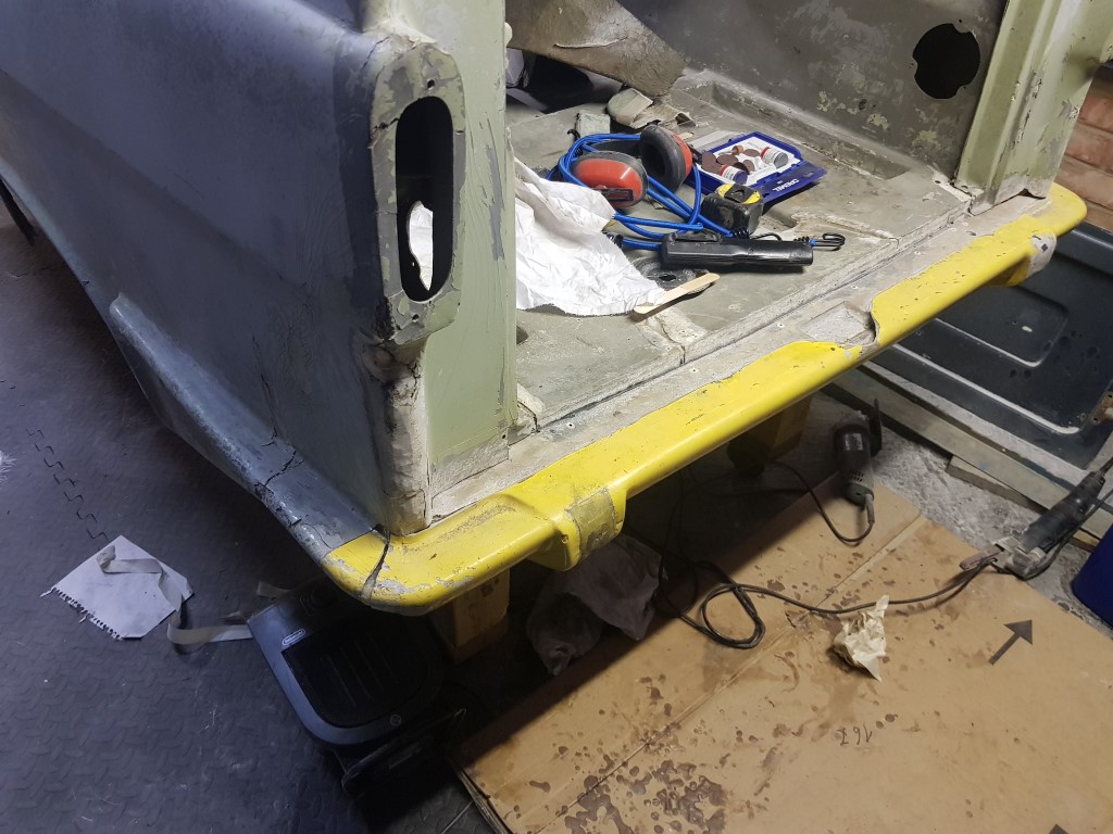

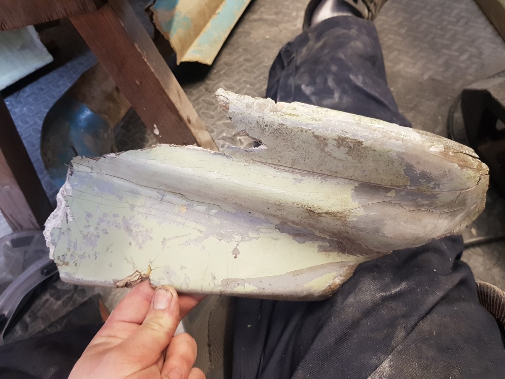

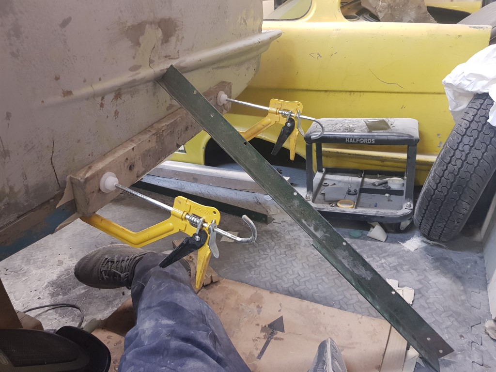

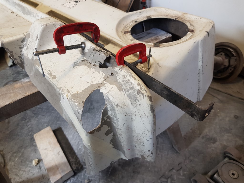

I then cut off the rear bumper section off the saloon shell which i need for the van, this is pretty much identical barring the number plate light mount in the centre and also the saloon rear bumper is not as deep, but the way i cut it off, i included part of the inner bumper so this made it deep enough to use on the van..
20200320_154128 (Medium).jpg (195.7 KiB) Viewed 8964 times
20200320_154135 (Medium).jpg (222.08 KiB) Viewed 8964 times

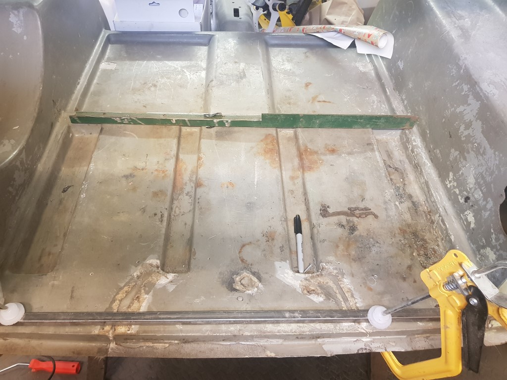

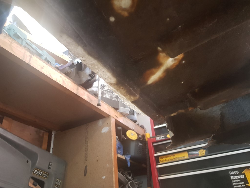

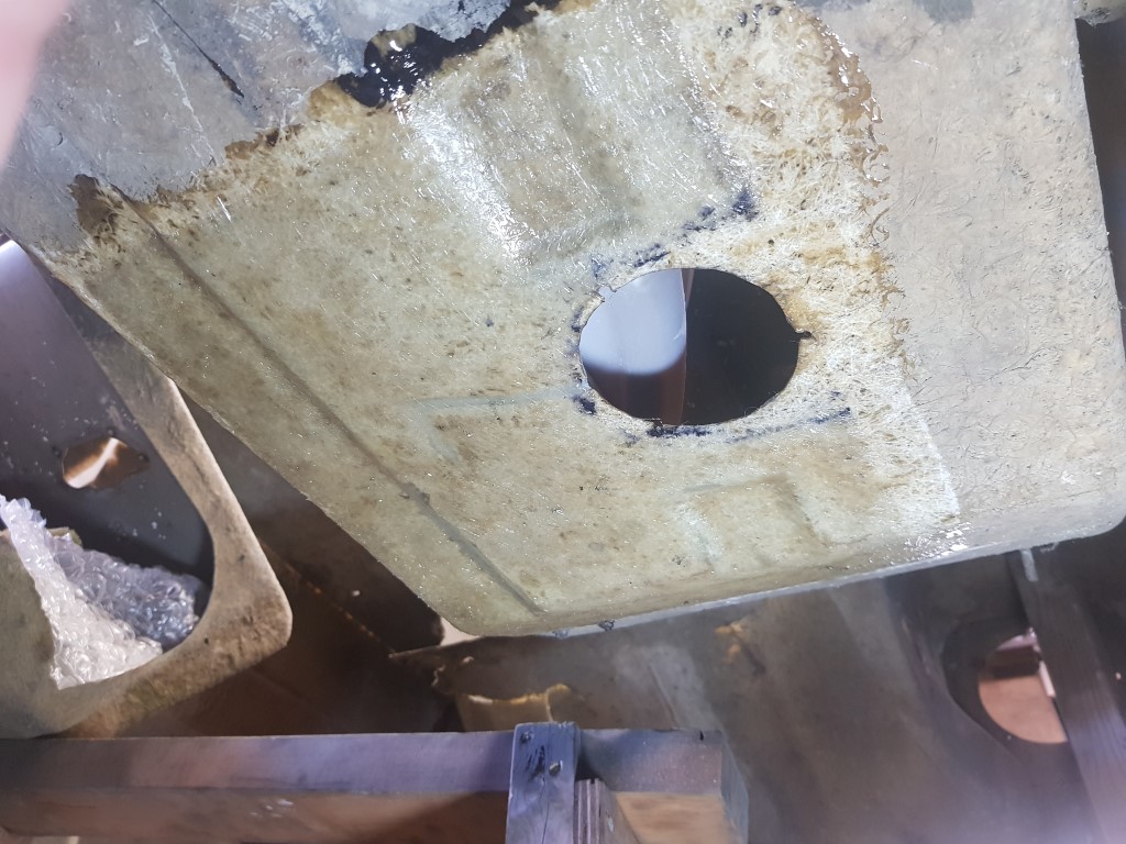

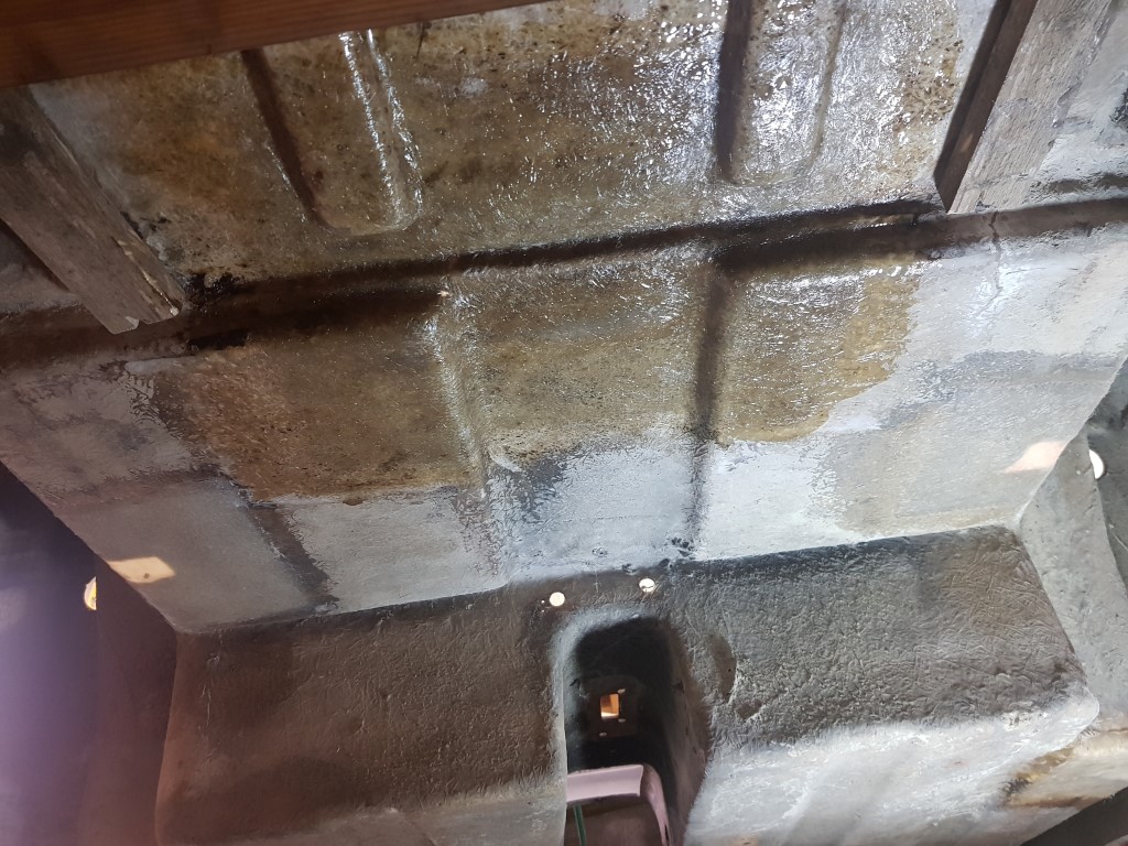

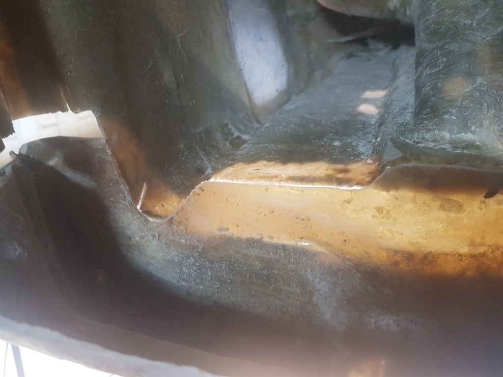

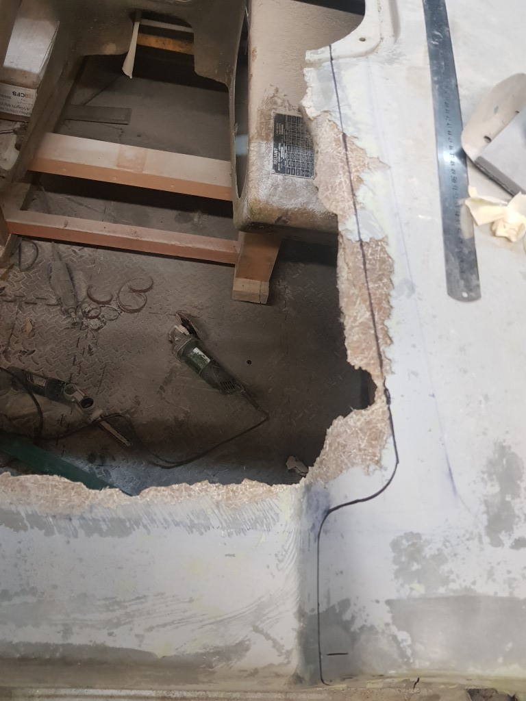

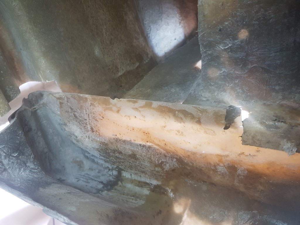

Before i could fit the rear bumper i had to repair another area of the rear floor area, this is the area in the following pic under the furthest metal brace in...
20200319_131953 (Medium).jpg (199.73 KiB) Viewed 8964 times
from underneath ...
20200319_144009 (Medium).jpg (253 KiB) Viewed 8964 times

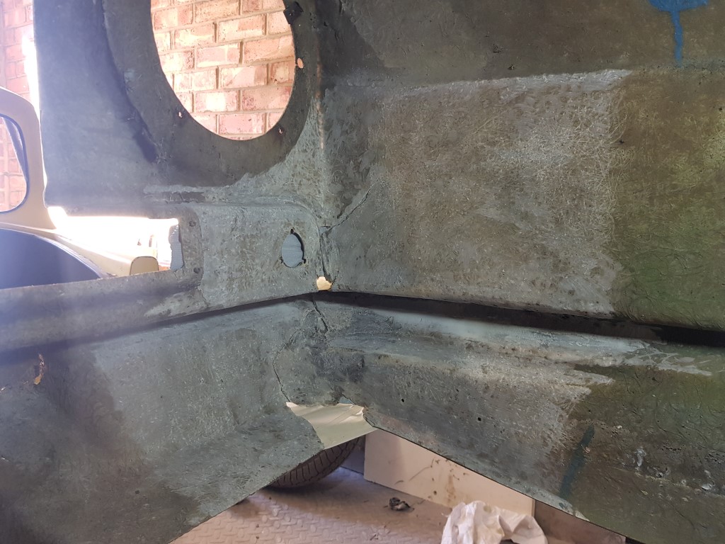

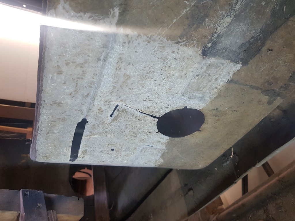

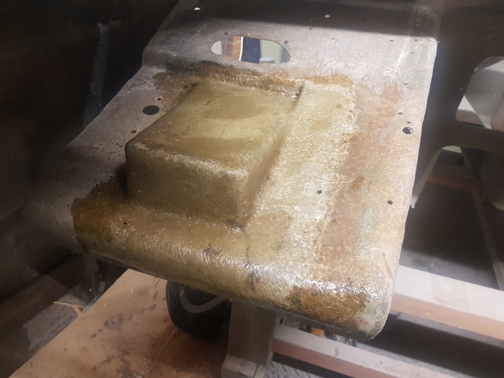

I also put extra renforcement on the lip of the floor...
20200320_092258 (Medium).jpg (127.76 KiB) Viewed 8964 times

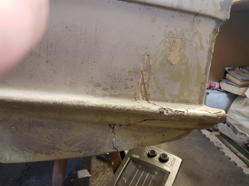

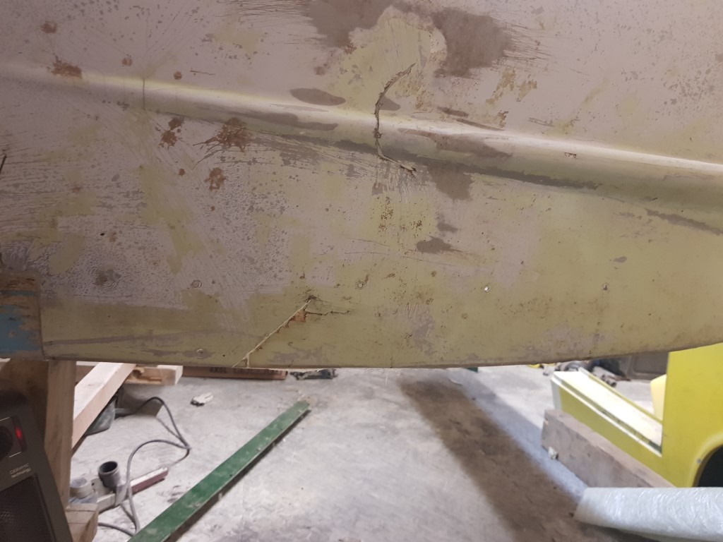

I then repaired the passenger side lower side panel...
20200320_113550 (Medium).jpg (134.79 KiB) Viewed 8964 times
20200320_113556 (Medium).jpg (175.69 KiB) Viewed 8964 times

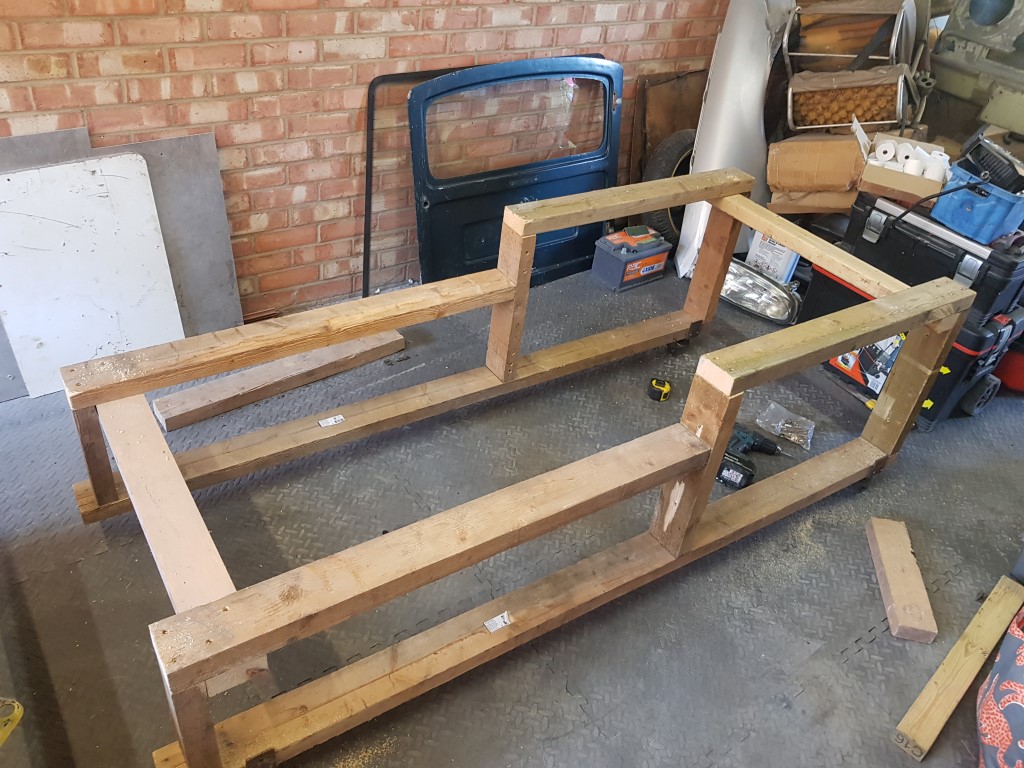

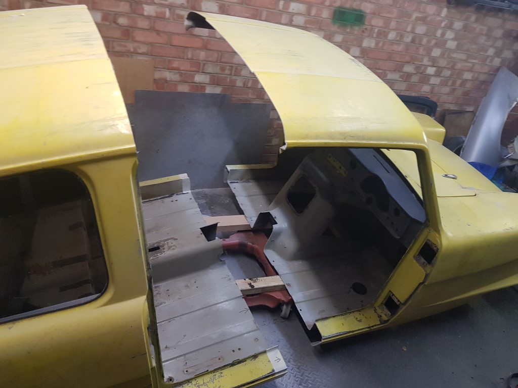

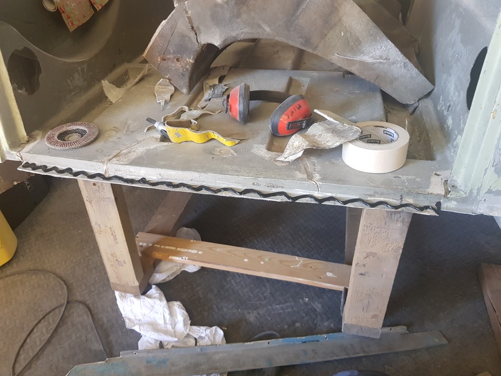

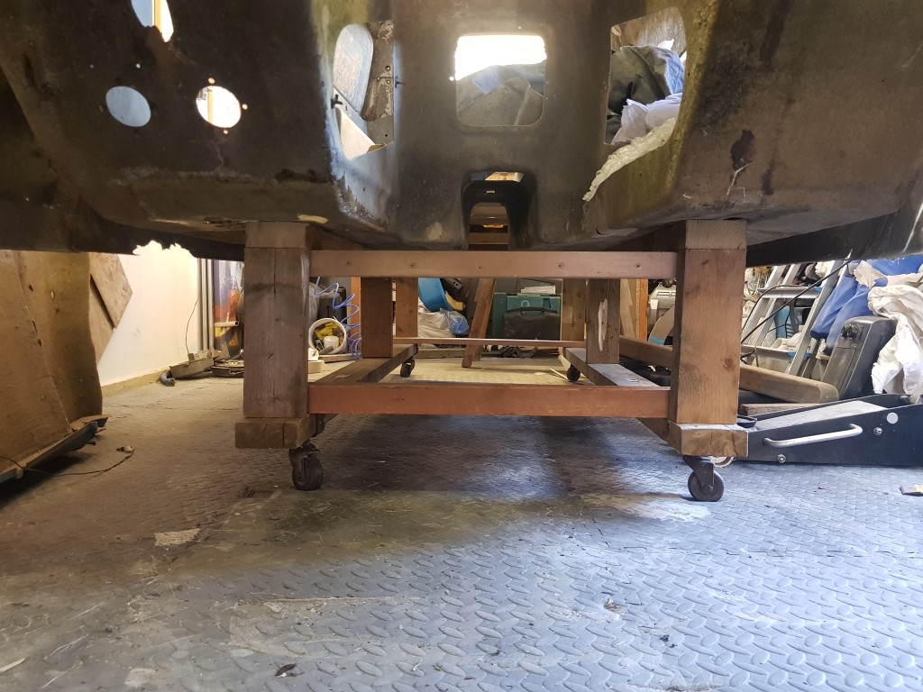

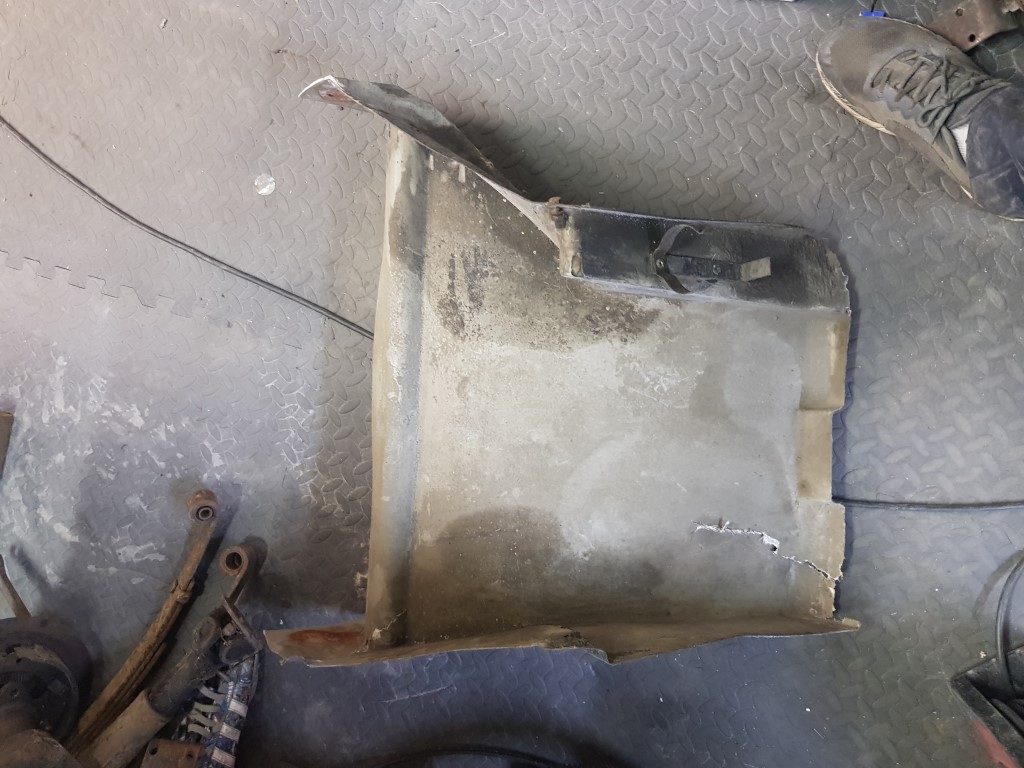

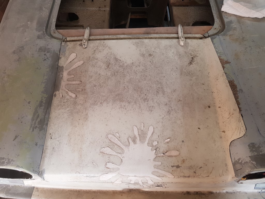

I then jumped to the drivers front floor, this needed a repair which i wanted to get done so i could get the shell of the 2 tressels it was perched on and onto a custom made frame on wheels so it can be moved around, heres the floor...
20200321_155713 (Medium).jpg (201.48 KiB) Viewed 8964 times
20200321_170043 (Medium).jpg (206.1 KiB) Viewed 8964 times
Heres the frame ...
20200323_133532 (Medium).jpg (270.59 KiB) Viewed 8964 times
20200323_153827 (Medium).jpg (211.23 KiB) Viewed 8964 times

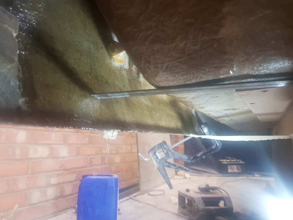

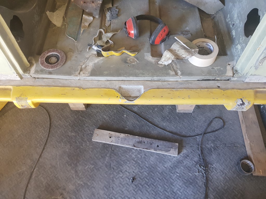

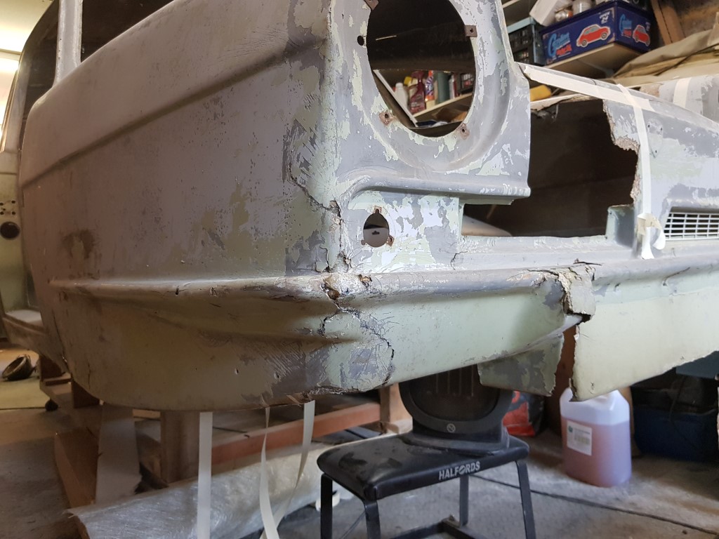

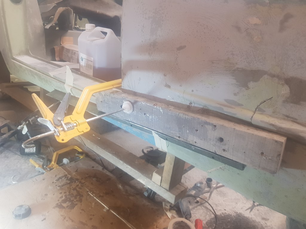

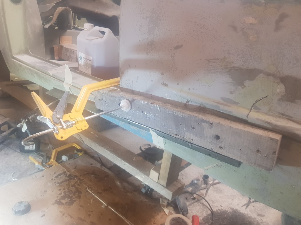

So then back to the rear bumper, now the shell is on the frame its much easier to manouver to get to the different areas, 1st off, i glued the rear bumper onto the floor lip...
20200325_122951 (Medium).jpg (218.62 KiB) Viewed 8964 times
20200325_123109 (Medium).jpg (246.14 KiB) Viewed 8964 times

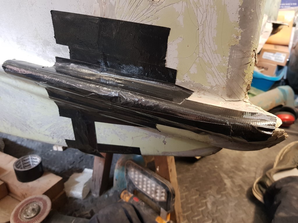

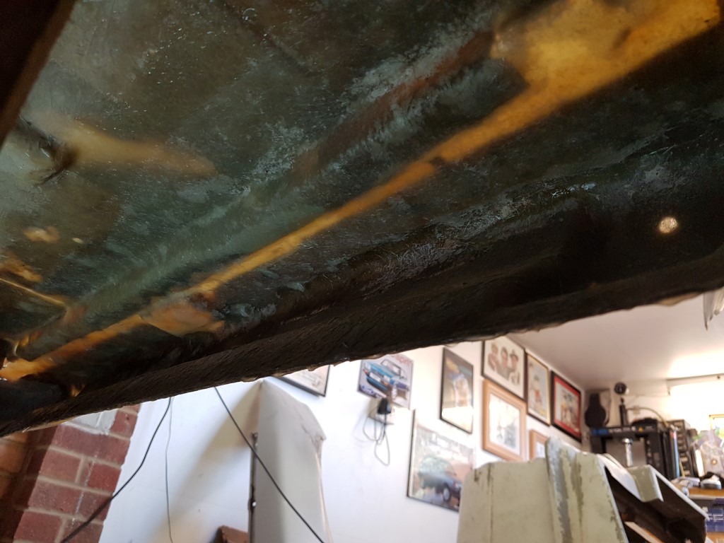

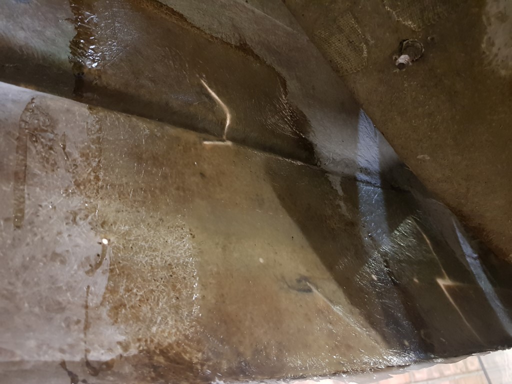

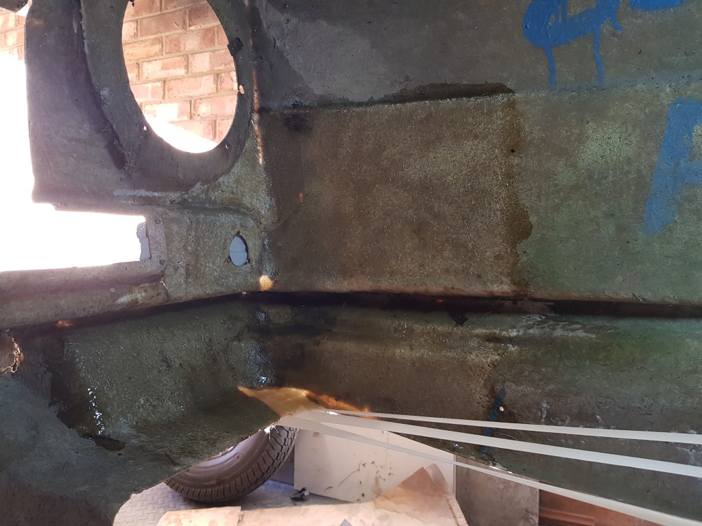

this was clamped between a piece of wood and angle iron until it set, then i started the fiberglass from underneath, the saloon bumper inner was square on the corners so i had to shape this is situ...
from this..
20200326_122721 (Medium).jpg (192.79 KiB) Viewed 8964 times
to this...
20200326_124448 (Medium).jpg (148 KiB) Viewed 8964 times

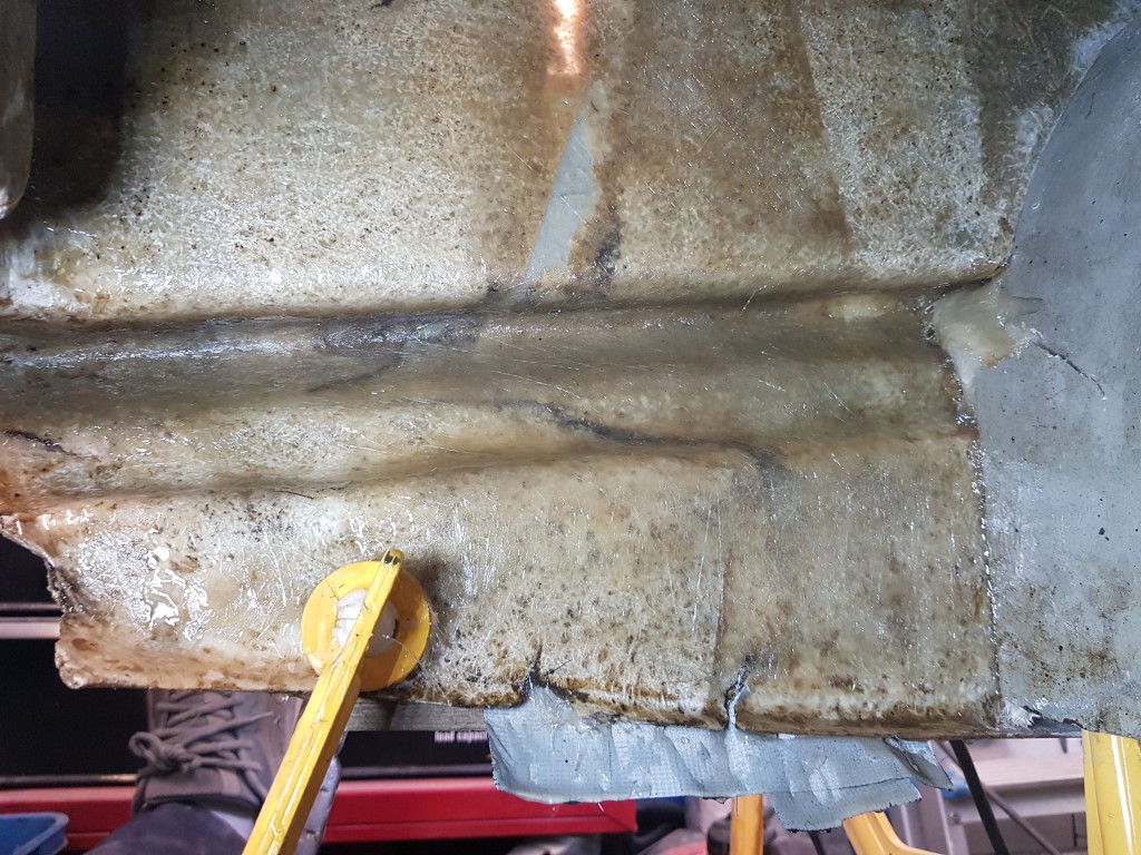

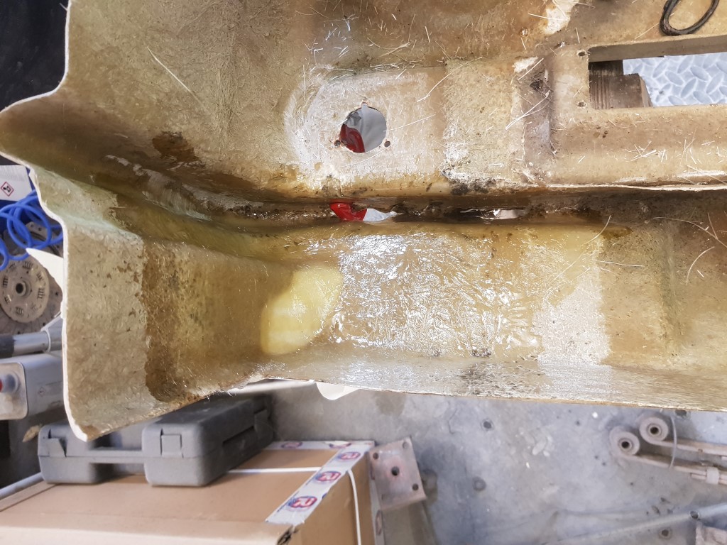

then it was all fibreglassed...
20200326_155334 (Medium).jpg (192.93 KiB) Viewed 8964 times
The corners on this were particularly hard to get level but its not to bad...
20200327_202011 (Medium).jpg (192.19 KiB) Viewed 8964 times
The rear bumper and floor area are not very very strong and just to make sure i actually sat on it and it took my 17st no problem, so when its on the chassis with the support frame underneath its not going anywhere.

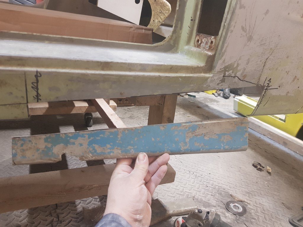

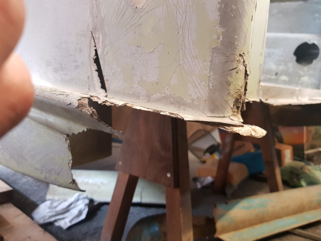

I then moved onto a sill repair on the drivers side ...
20200328_163115 (Medium).jpg (172.33 KiB) Viewed 8964 times
20200328_232353 (Medium).jpg (153.61 KiB) Viewed 8964 times
20200328_232422 (Medium).jpg (127.36 KiB) Viewed 8964 times
20200329_001018 (Medium).jpg (160.89 KiB) Viewed 8964 times

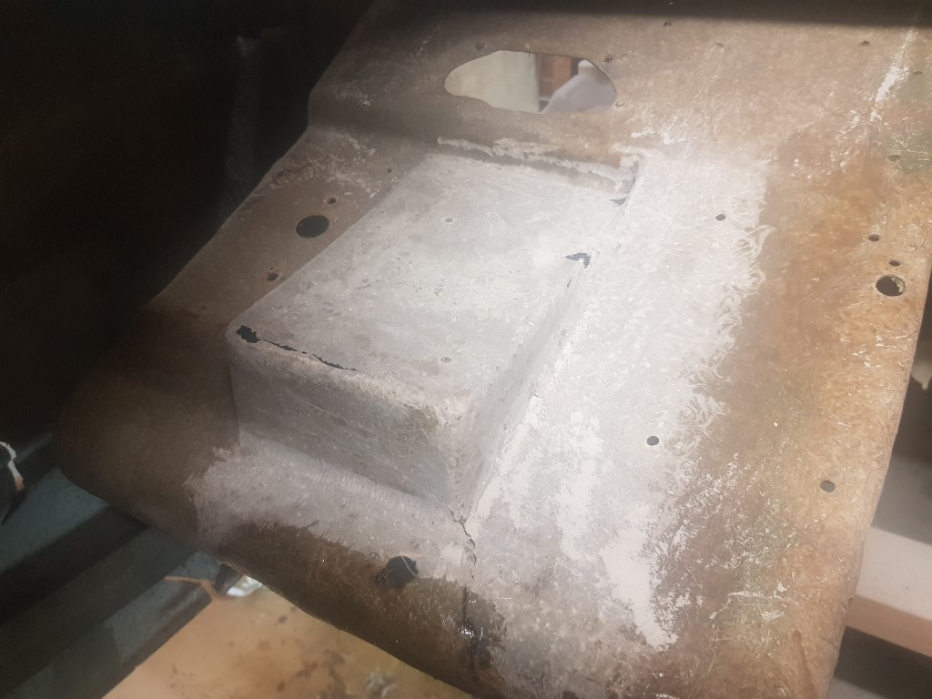

So carrying on from the last post, after the sill repair i did another front drivers side panel repair and also a battery and foot well repair...
20200328_232427 (Medium).jpg (114.63 KiB) Viewed 8961 times
20200328_232514 (Medium).jpg (152.67 KiB) Viewed 8961 times
20200329_000317 (Medium).jpg (154.04 KiB) Viewed 8961 times
20200329_003512 (Medium).jpg (191.8 KiB) Viewed 8961 times
20200329_025712 (Medium).jpg (145.27 KiB) Viewed 8961 times
20200329_025746 (Medium).jpg (170.8 KiB) Viewed 8961 times

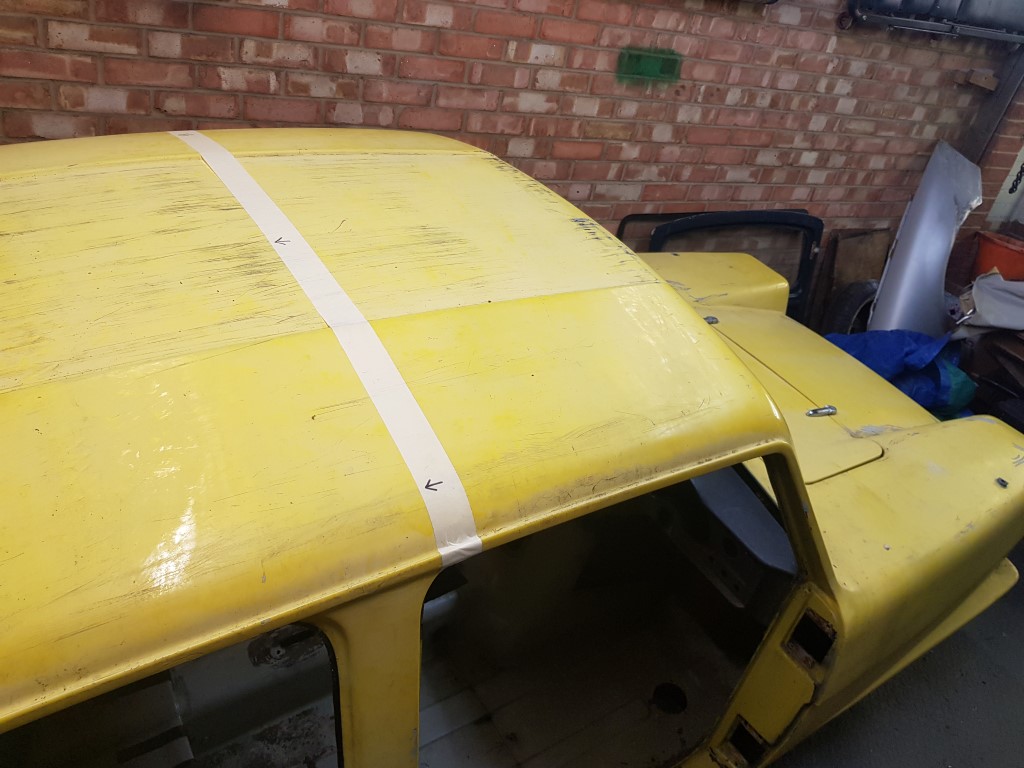

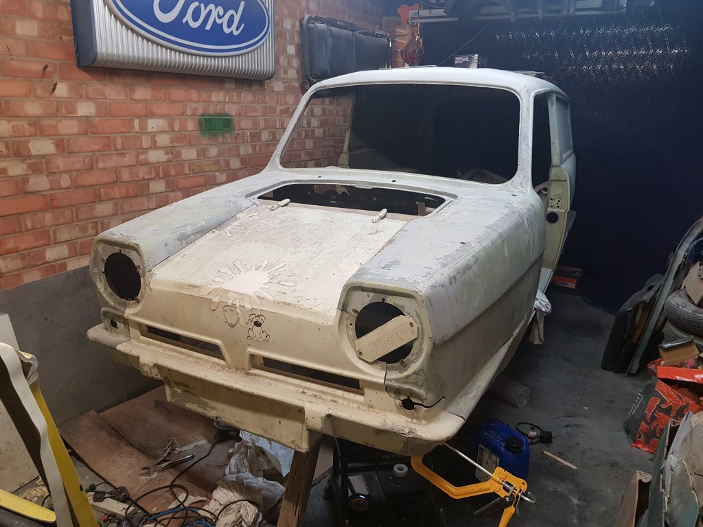

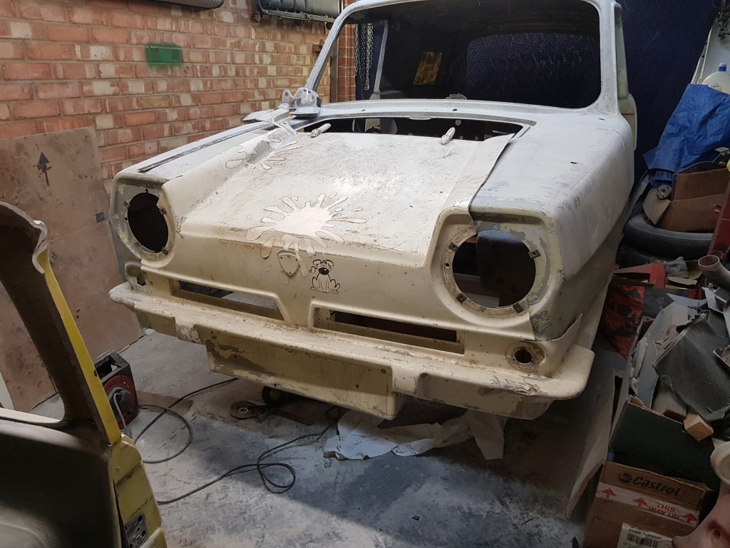

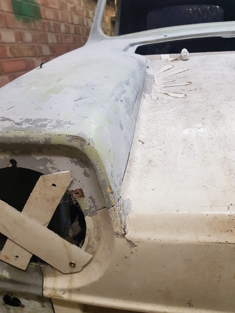

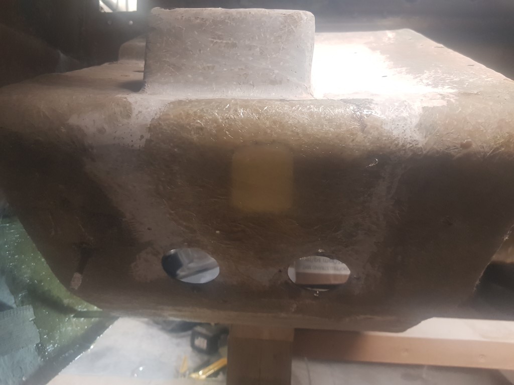

So then comes the main event... THE FRONT END :shock:
Initially i was going to put in as little as possible to maintain the front end strength, but as a lot of the damage was so close together i later decided to put the front end on as one, this would make for a neater job and less joins, first though the new front end I traded mine for needed a repair, heres the new front...
20200325_125543 (Medium).jpg (232.51 KiB) Viewed 8961 times
you can see the damage on the corner,
this was repaired 1st to make sure it was strong and the right shape...

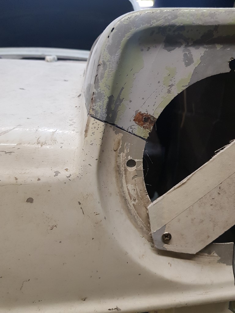

Also before fitting the front end i had to repair the drivers side front corner of the van so its also strong and the right shape...
20200325_152245 (Medium).jpg (232.13 KiB) Viewed 8961 times
20200325_161519 (Medium).jpg (226.6 KiB) Viewed 8961 times
20200325_171442 (Medium).jpg (206.7 KiB) Viewed 8961 times

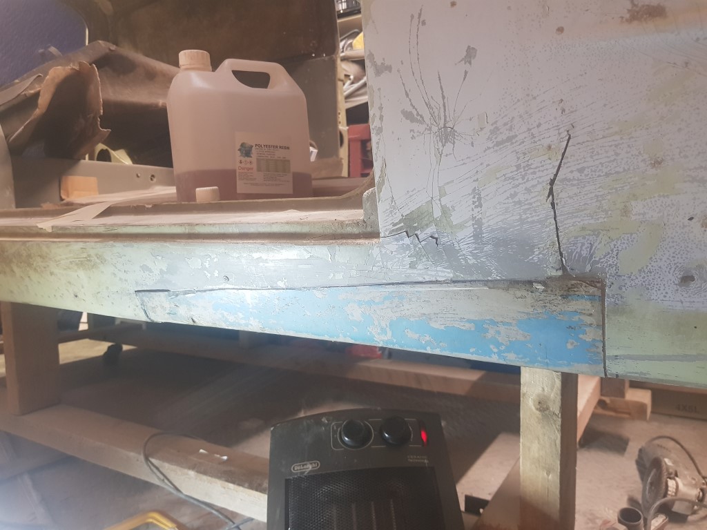

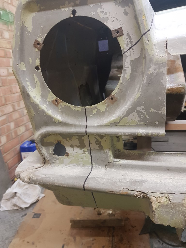

this looks a little rough atm but is very strong... so the main front ...

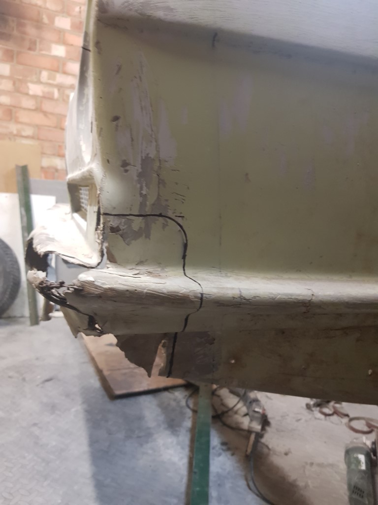

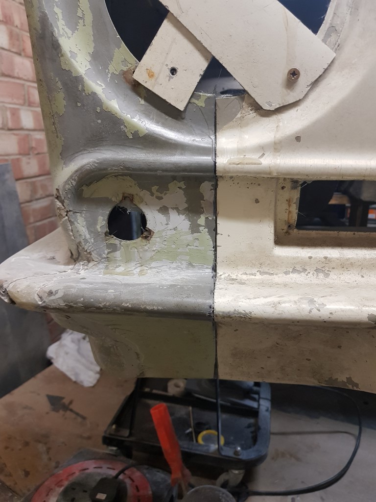

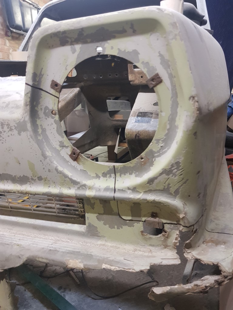

here are the planned cut lines ...
20200330_003317 (Medium).jpg (199.49 KiB) Viewed 8961 times
20200330_003325 (Medium).jpg (181.5 KiB) Viewed 8961 times
20200330_003338 (Medium).jpg (174.12 KiB) Viewed 8961 times
20200330_003347 (Medium).jpg (184.82 KiB) Viewed 8961 times
20200330_003355 (Medium).jpg (128.14 KiB) Viewed 8961 times

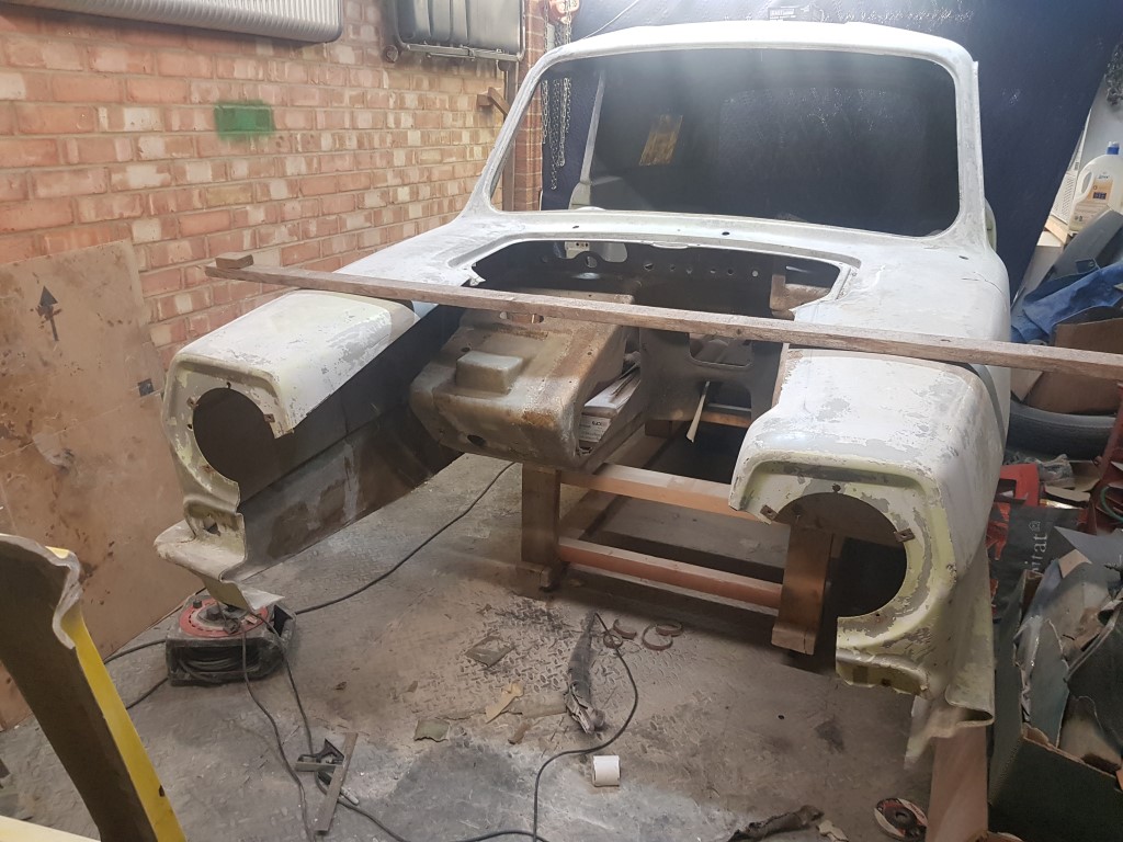

So a BIG deep breath and..
20200331_123806 (Medium).jpg (214.68 KiB) Viewed 8961 times
20200331_123824 (Medium).jpg (233.44 KiB) Viewed 8961 times

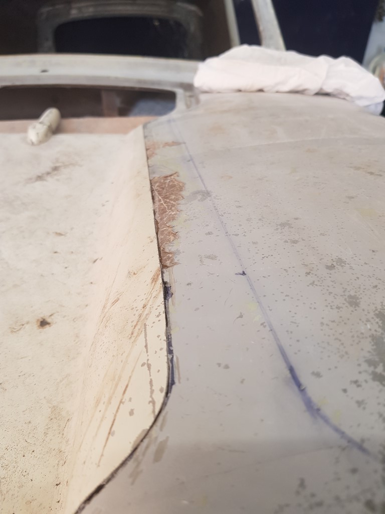

1ST test fit ...
20200331_182005 (Medium).jpg (240.64 KiB) Viewed 8961 times
then cut to fit ...

So there you have it, im really pleased with the front end, there is still some more to do but im over the hump of the fibre glass work now :dance: :dance:
