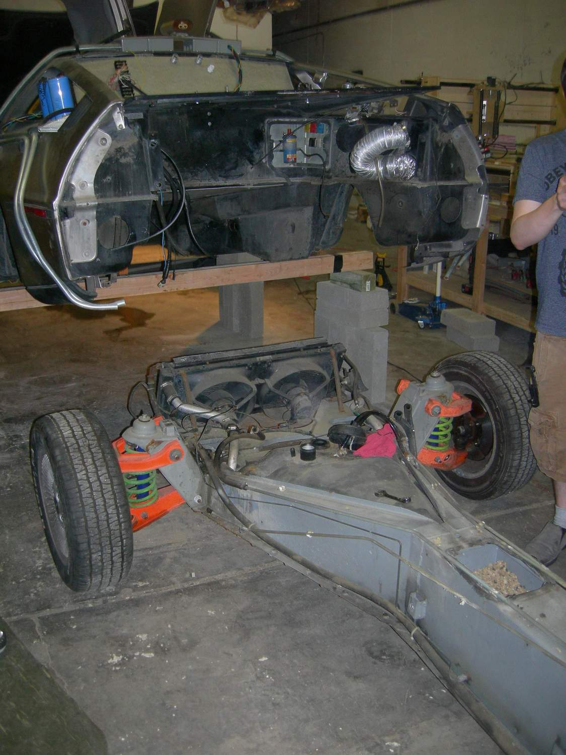

Local owner Buddy (aka nullset on dmctalk) had purchase a second DeLorean a couple of months ago. You may remember it as being the bad BTTF replica that had been sitting outside a gas station for 6 years. (insert dmctalk link here ;) ). He shipped it to Freeside (a communal hacker workspace he is a member of, in downtown Atlanta)
He needed to separate the body from the frame to repair a problem with the fuel lines at the accumulator. So seven of us turned up to help. Final result.....

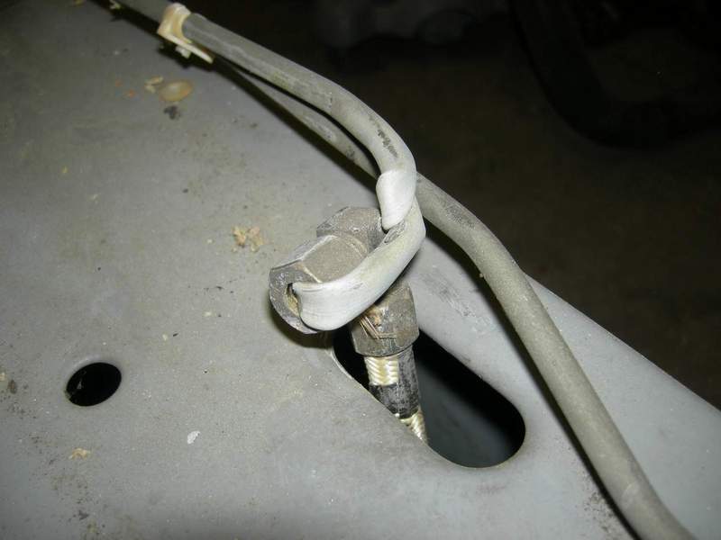

Operation successful, and the repairs can commence. This is what started it all an forced the body removal :shock:

Thanks for the pics Dermot, keep us posted on that!!...chassis look ok everywhere, whats the plan?
Glad you found the track rod ends ok!
Re: Freeside-Tec - USA
Postby Dangermouse » Mon May 02, 2011 5:59 pm
The chassis is surprisingly good. Once he gets the frame cleaned and the fuel lines sorted out, he's going to spray/powder coat those lovely neon suspension components.

Thanks for the pics DM
How the hell did that fuel line get so twisted !!

bozzzy wrote:Thanks for the pics DM
I think it got caught in the time-space continuum during it's last time travel.
Either that or Buddy was trying to separate the union from underneath, which is supposedly impossible. The recommended way is to cut the flexible line and splice in a new piece.
