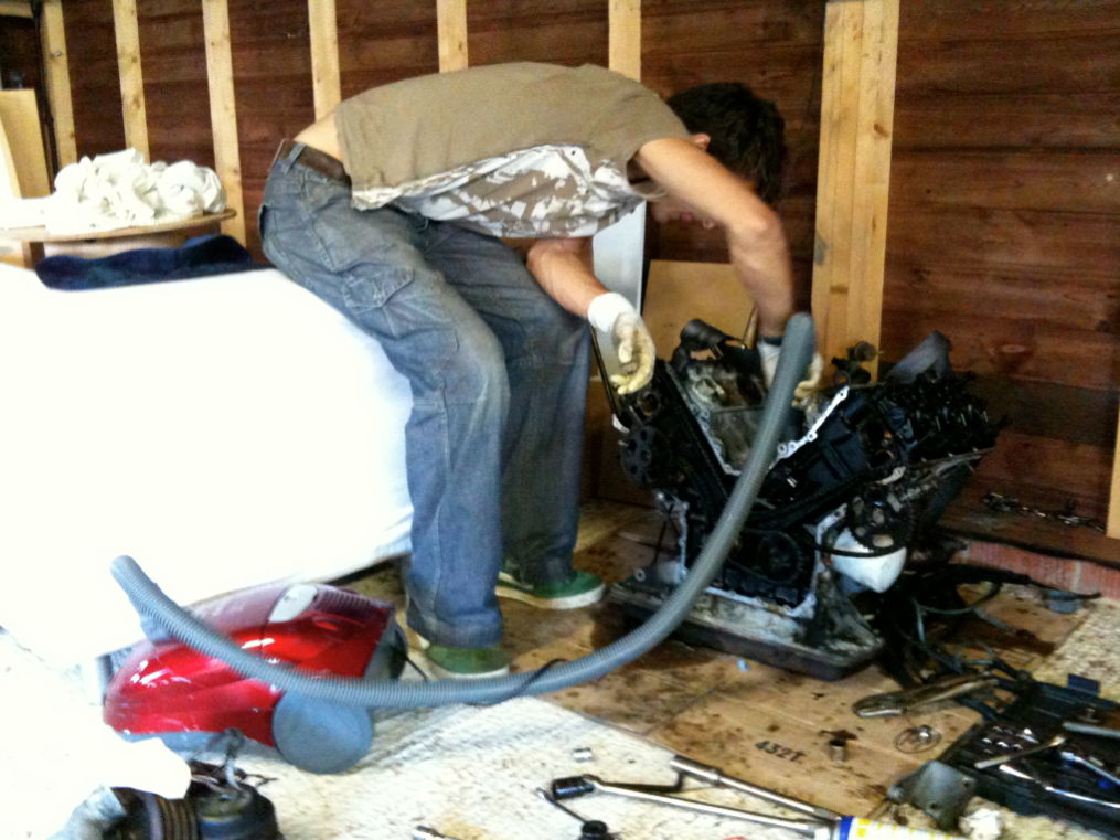

We made a start today. We stripped everything off the Volvo engine and got the cams out ready to be sent away. The main pulley was the hardest thing to get undone, but eventually it came loose. We had to disturb the head bolts, so I am guessing we can't just re-touque them, its new head gaskets now...
Got the waterpump and piping out ready to put the D stuff in, I left Gez with a filthy valley and rocker covers to clean up. Also got one of the exhaust manifolds off without breaking any studs.
Gez even got his hands dirty!
Dyson with death:
