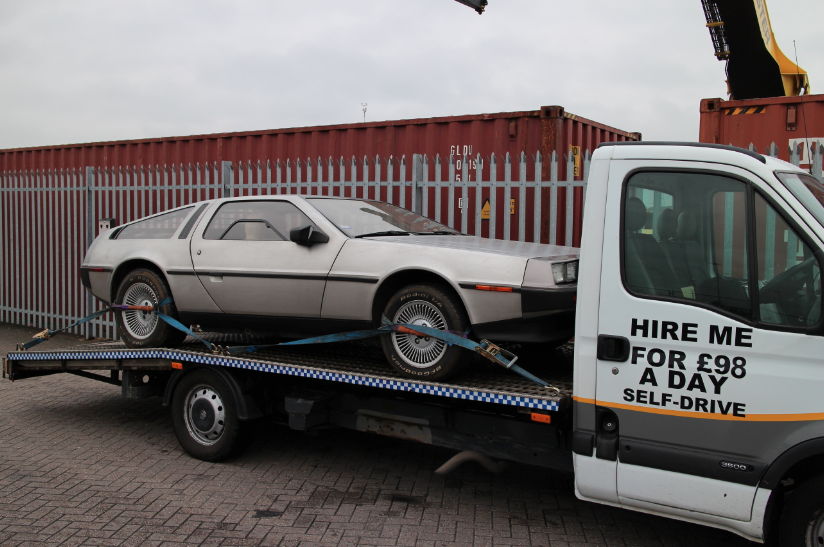

Ryan, have you looked at a self drive transporter? Sam went this route to get his car up to Norfolk in March, I believe it cost him something like £150 for a weekends hire.

I havent really looked at a self hire one really. I looked a little when i was going to collect the car from the dock but i had to throw down £600 as a deposit which i wasnt comfortable with.
Can anyone recommend a company i can look into? I agree £150 would be great value for money

I hired one to pick up my D back in 2014. They were near Colchester, not sure if they still do them or not but worth a call:
Call Lee on 07702468729 / 01621928305 Or Mike on 02036517528 / 07707056133
