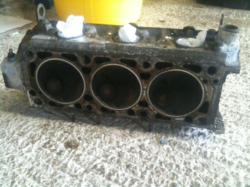

TT came over yesterday for Headgasket-Tec. Unfortunately I had no sugar to put in his tea which resulted in even more swearing than usual. I counted 14 'F*ck it's and 18 'c*nts' before I was also infected with tourettes and started swearing as much as he was.
But Headgasket-Tec was a success, the reprofiled cams are in and the tappets are tightened. TT seemed to think that the low mileage on the 'new' engine was likely genuine due to the general lack of wear and good condition of various bits, which is good news.
Al made a late arrival to the party and we discussed how to increase the chances of getting the swap done in a day next Saturday. Unfortunately the prefitting of the sandwich plate and sump isn't possible as Dan only has a sandwich plate (no sump) and he's already fitted that to his Volvo engine. So the current plan is to get over to Gosfield early on Friday, Dan can hopefully give me a hand getting started doing prep work to the car and then we'll at least have fascias/engine covers/louvres/pipes off and will be in good shape to roll the following day.
Plan is to start at 9am on Saturday. I'm not expecting everyone to get there that early but that's when I'd like to start the ball rolling. Any questions / advice fire away!!
Before old gaskets getting scraped off
