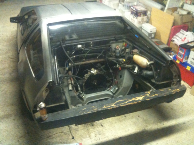

Car is much lighter like this. I might leave it this way and cut out a hole from the drivers footwell. Flintstone power will probably be faster!

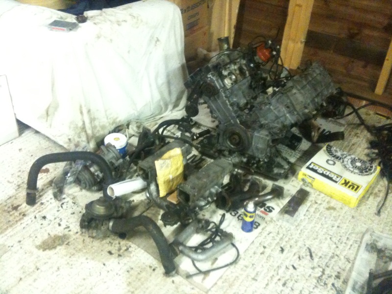

New Volvo engine to go in. Remaining toss to go on it/into it around it.

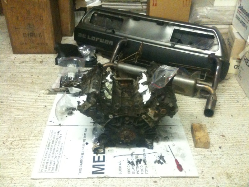

Old DeLorean engine. Wasn't long ago it was going up the Santa Pod strip!
