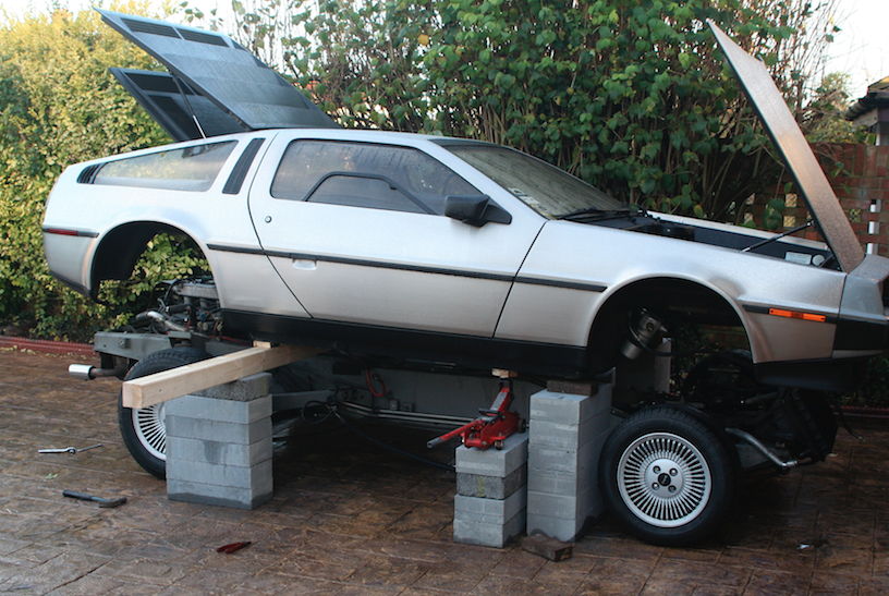

Mec, this is indeed totally epic!! Awesome getting all that done in 2 days. How long did it take to build the DeLorean Lifting System (TM)?
Dan - how did you lift your body up when you did yours on your drive? I just remember you replacing the chassis with bricks but not actually how you got the body off...

jerzybondov wrote:Dan - how did you lift your body up when you did yours on your drive? I just remember you replacing the chassis with bricks but not actually how you got the body off...
I took it off with bricks too. Jacked it up, put a brick in, jacked again, another brick in etc. Then when high enough I moved the bricks out to clear the wheels and put wooden beams across. Lots of messing around compared to Mec's lifting solution!
