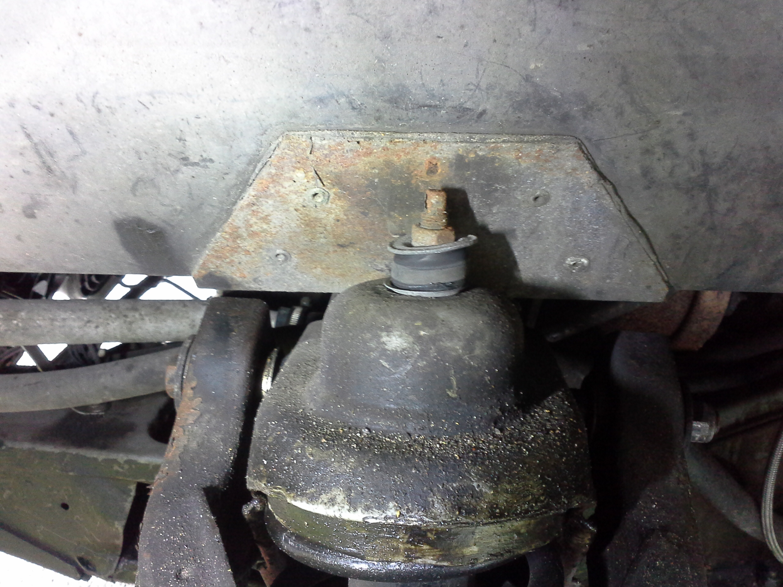

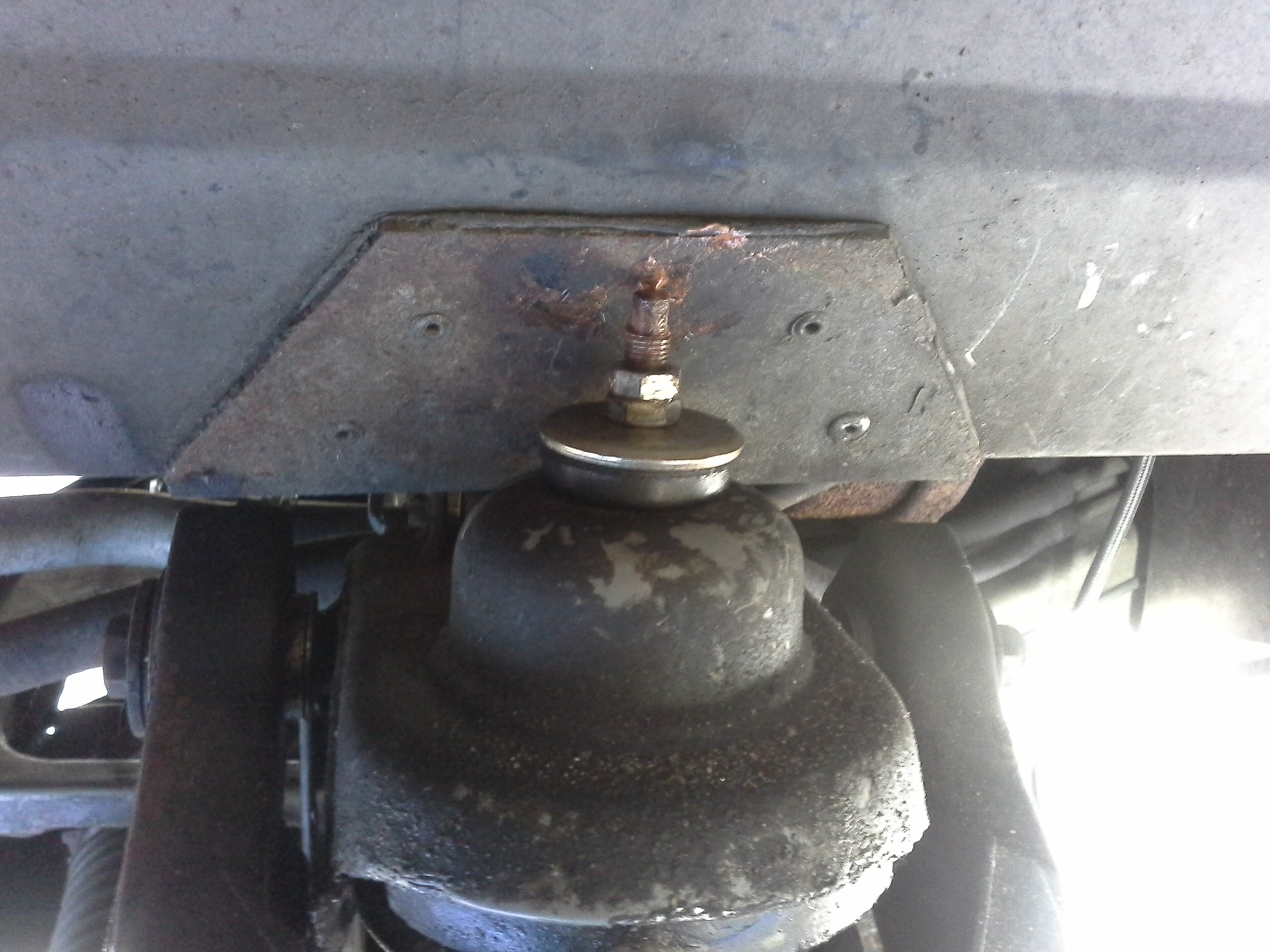

I replaced the fuel pump and lines after the last few posts. All ok i hope?
My top shock washers needed replacing. The original small spax bushes were a bit overworked too.
The new rubbers are much bigger, and the top and bottom washers rather better for the job.
Also fitted the spangly new, probably-not-very-good-but-we-definitely-prefer-it-NLA angle drive.
I do not enjoy working on the front sudpension!! Plenty of red rubber girling grease on the rubber. I also painted the same over the rear rubbers at the top of the springs to stop a super irritating squeak.
Car seems fine... I wonder what will go wrong next? :roll: :D thats the joy of these things!
New exhaust some time soon. There's a little blow on it now which isnt going to fix itself. I note the top bracket is slightly fractured, and the rubbers are all a bit tired, and the heat shield looks like tin foil... :greetings-waveyellow: bye bye money! I didn't like you anyway!!

Postby andyd » Sun Oct 22, 2017 10:09 pm
Interestingly (or maybe not) I see the plates above my shocks rivetted to the tub are not common. Early tub thing?? The threaded bits of the shocks dont touch the tub, but they are really close!
Cant get the nuts and top rubbers on with the shocks in final position.
Precision engineered huh?!
