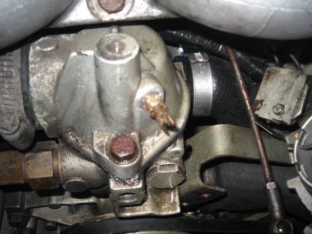

Postby RobvdVeer » Tue Apr 20, 2010 12:29 pm
I'd like to get back on the thermostat topic. As you can see, the bleed nipple is seriously wrecked and stuck. I wanted to remove that so I can see if it needs bleeding.
Can anybody point me how to diagnose to indicate a bad thermostat?

Postby Admin-bloke » Tue Apr 20, 2010 1:29 pm
Fit a bleed kit first, Ed or Martin should be able to get you one....
Remove thermostat, put it in a pan of boiling water, make sure it opens and note the temp when it does........use an old saucepan though..

Postby bozzzydmc » Tue Apr 20, 2010 1:57 pm
Yes you need to get that bleed nipple out otherwise you may have air trapped above the pump thermostat.
Looking at it you have enough of this nipple left to get the rest of it out, plus that bleed nipple is made of a soft 'brassy' material. Worse comes to worse it should be easy to drill out with the pump 'top housing' off the car.
Self bleed kit is a must.
Thermostat should open at 87 degrees C
