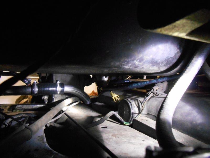

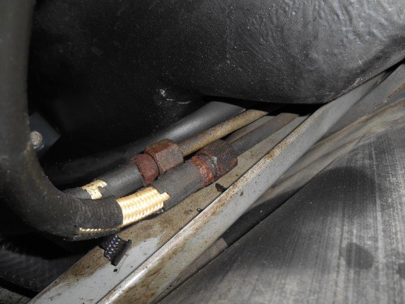

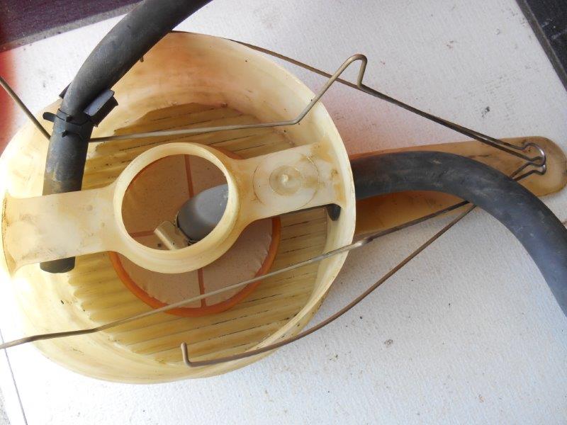

Postby Domi » Sat May 21, 2016 8:25 pm

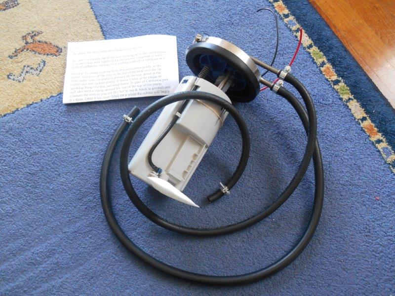

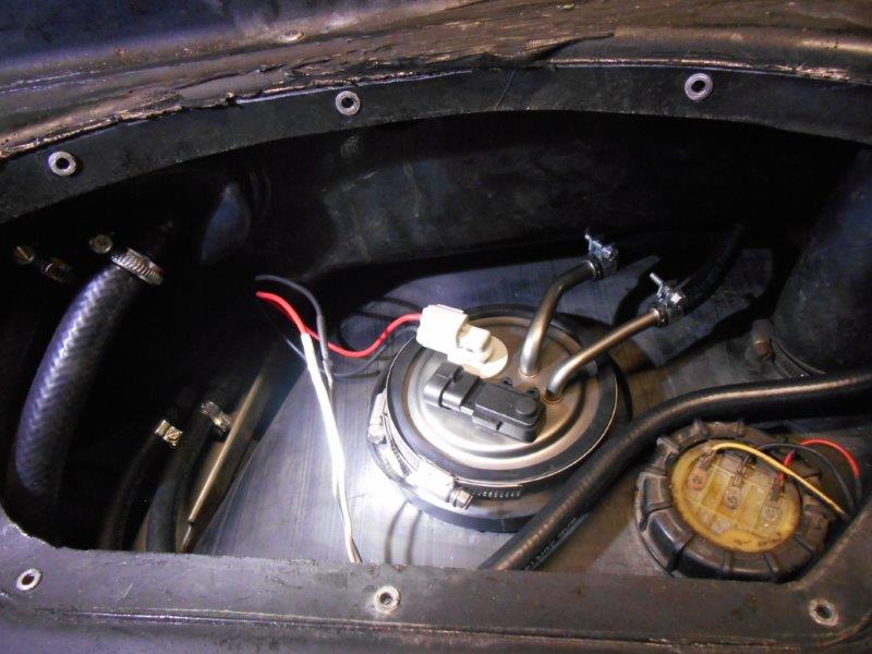

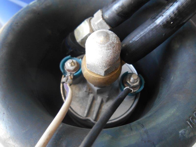

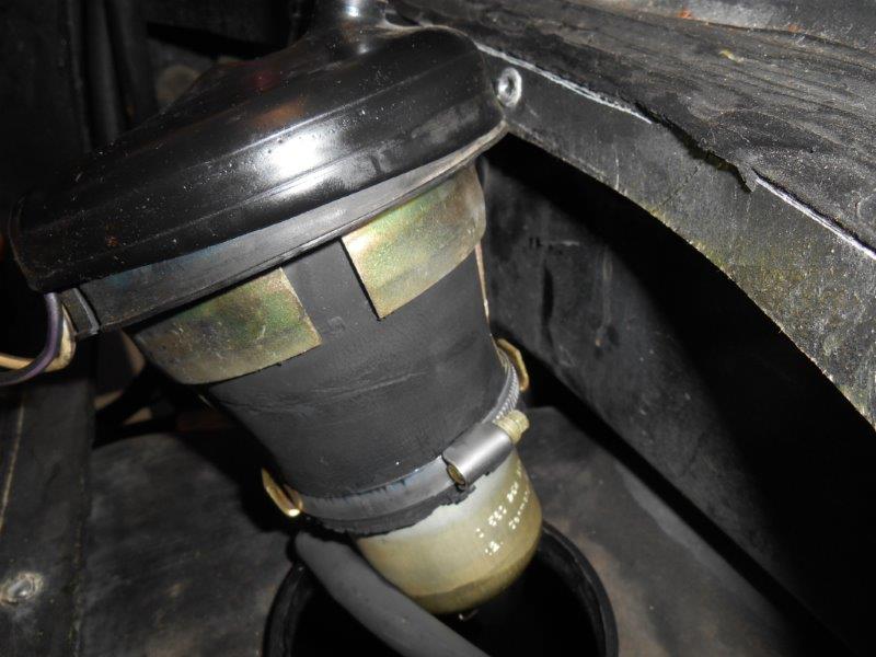

New fuel pump to replace the old one (21 years old)
The old pump wasn’t rusty and the boots not too damaged.

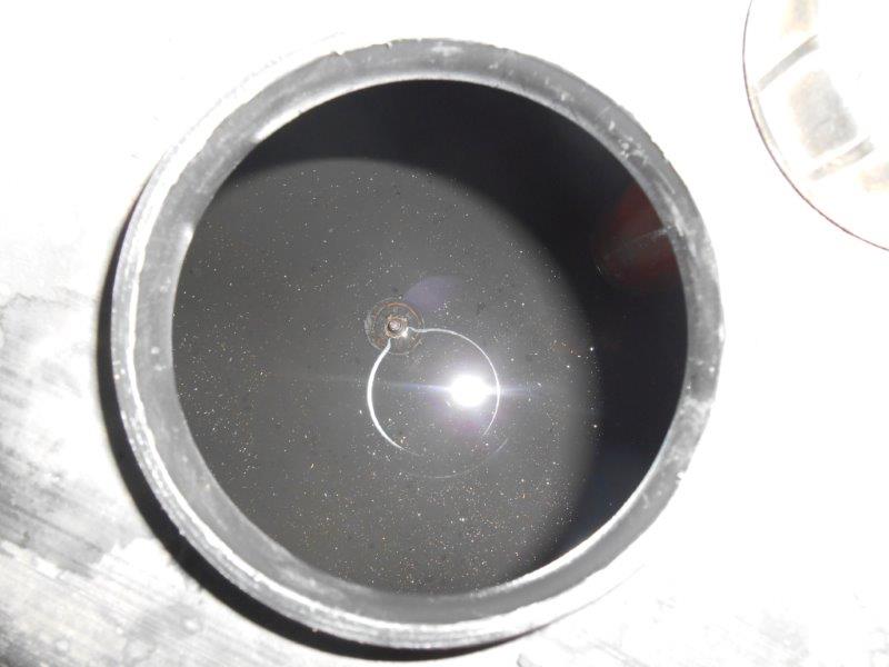

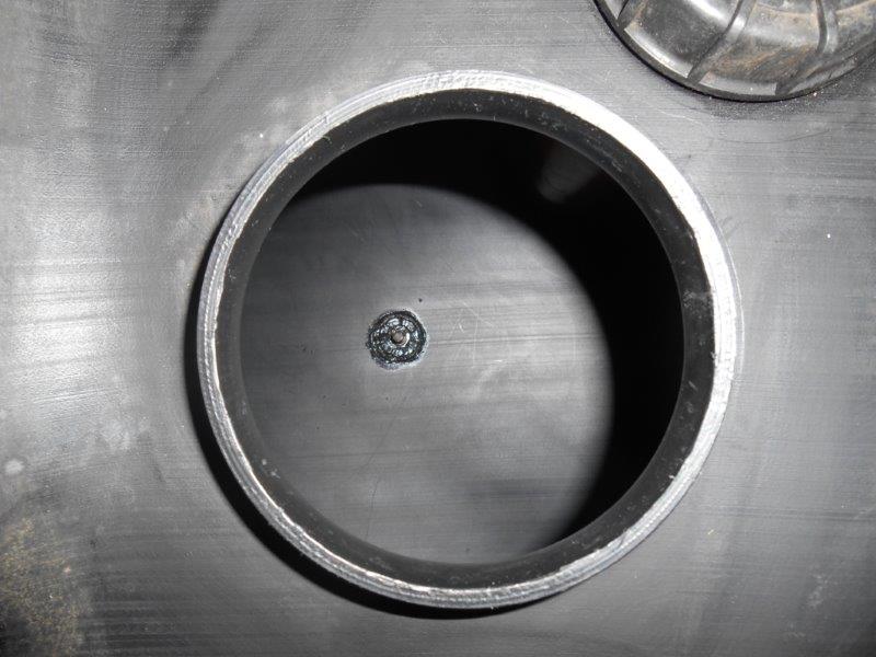

The tank isn’t too dirty but deserves to be cleaned

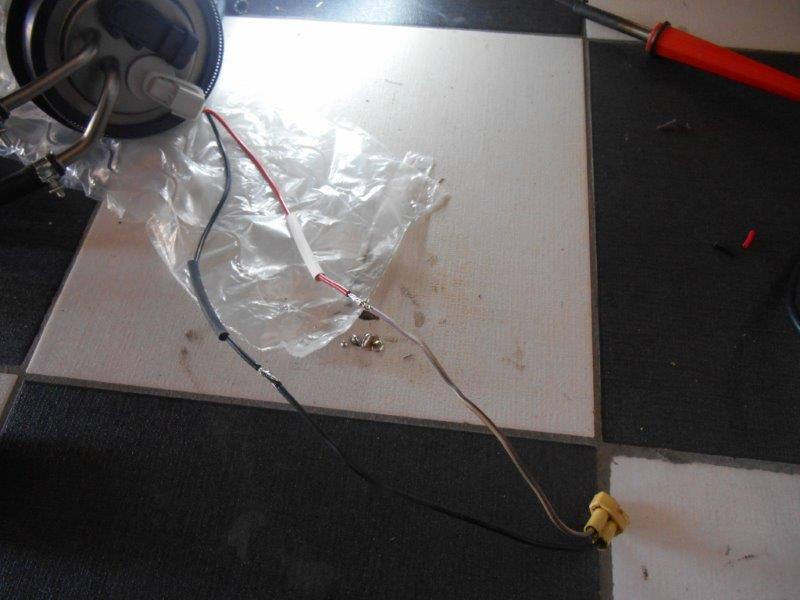

Taking back the old connector to the fuel pump

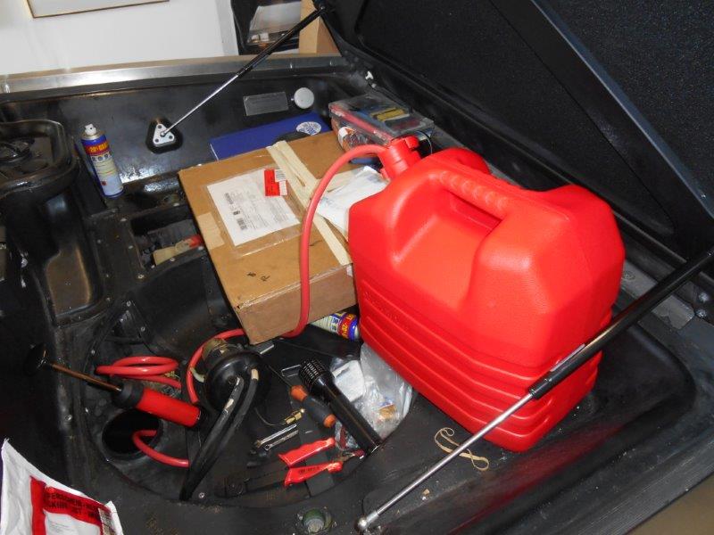

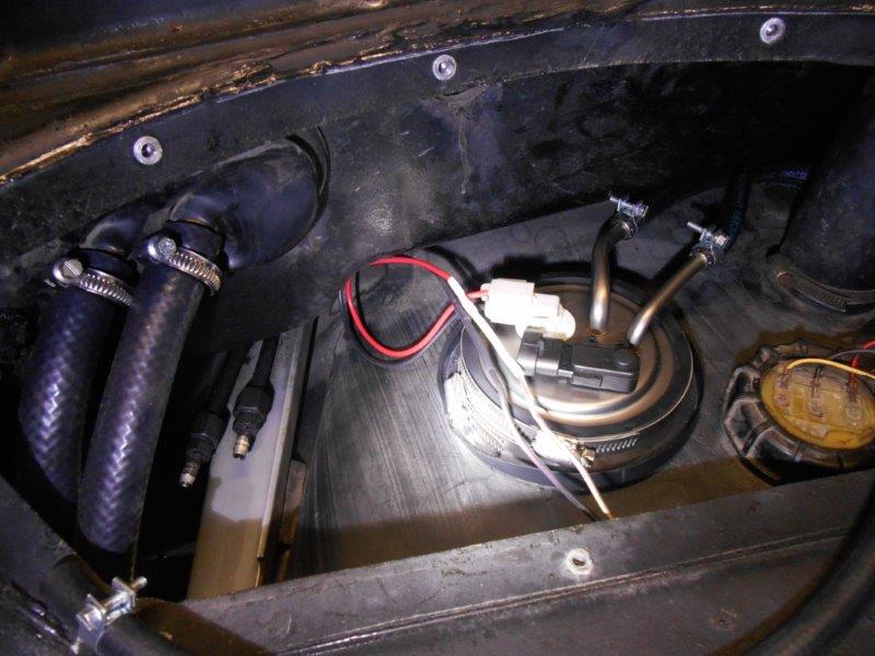

Postby Domi » Sun May 22, 2016 5:06 pm
She's thirsty :mrgreen:
New fuel pump installed :P

Postby MikeWard » Sun May 22, 2016 8:15 pm
Don't throw the old parts away. The baffles are no longer available.
Postby Admin-bloke » Sun May 22, 2016 9:18 pm
MikeWard wrote:Don't throw the old parts away. The baffles are no longer available.
Good point Mike !
Postby Domi » Mon May 23, 2016 7:52 pm
Don't worry I kept the old parts, we never know what could happen :whistle:

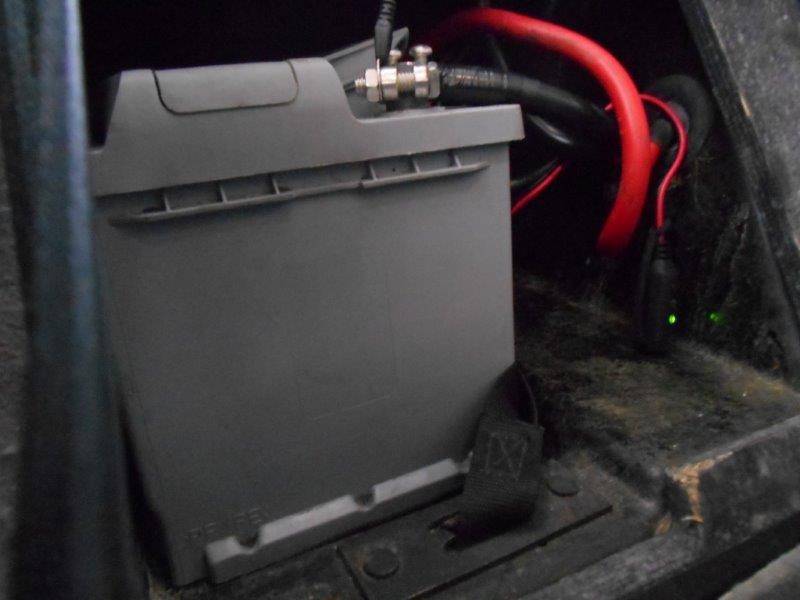

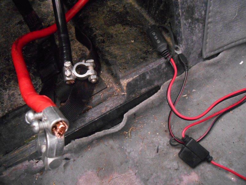

New battery terminal from the club, fits perfectly, thank you :P
