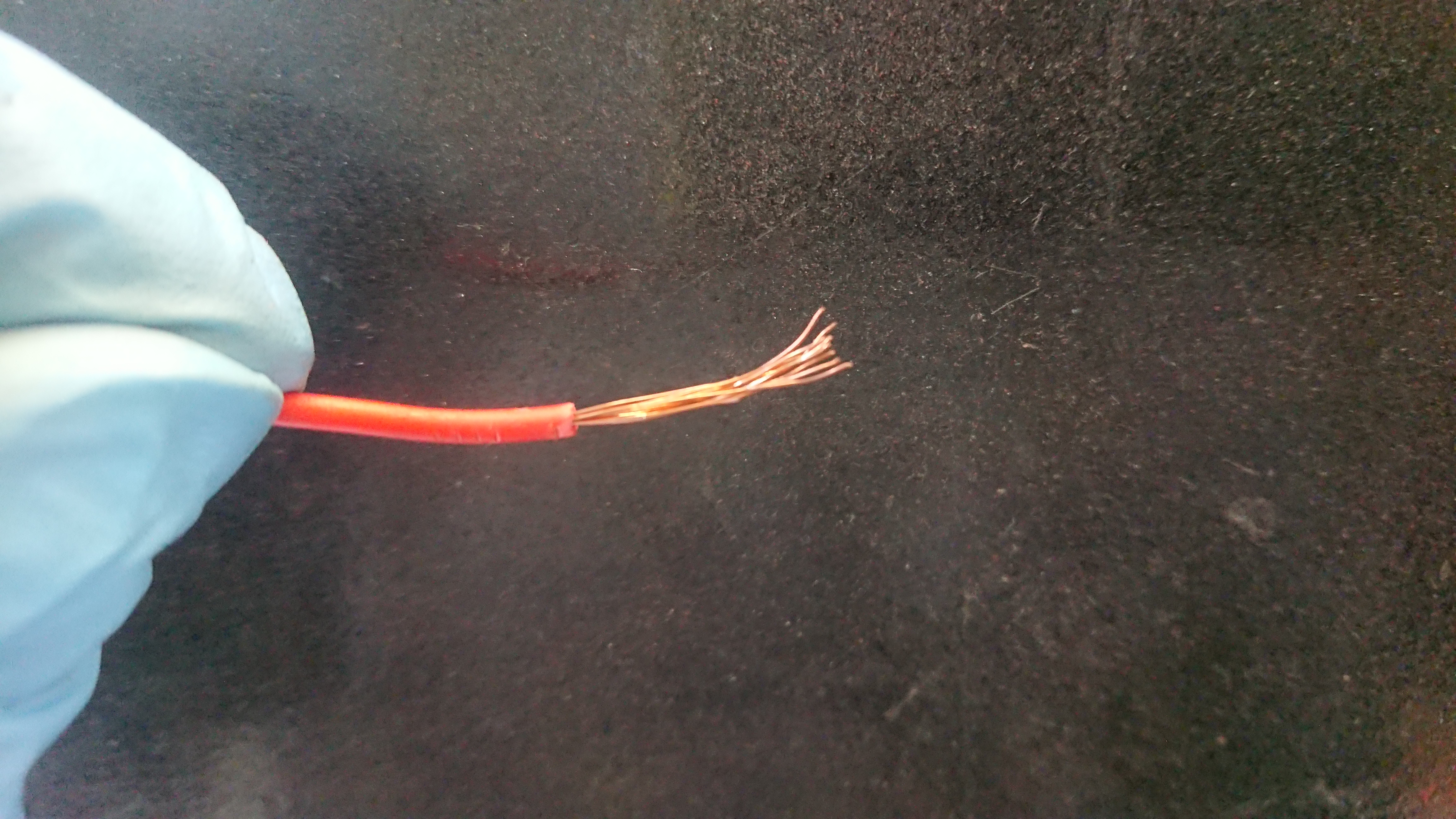

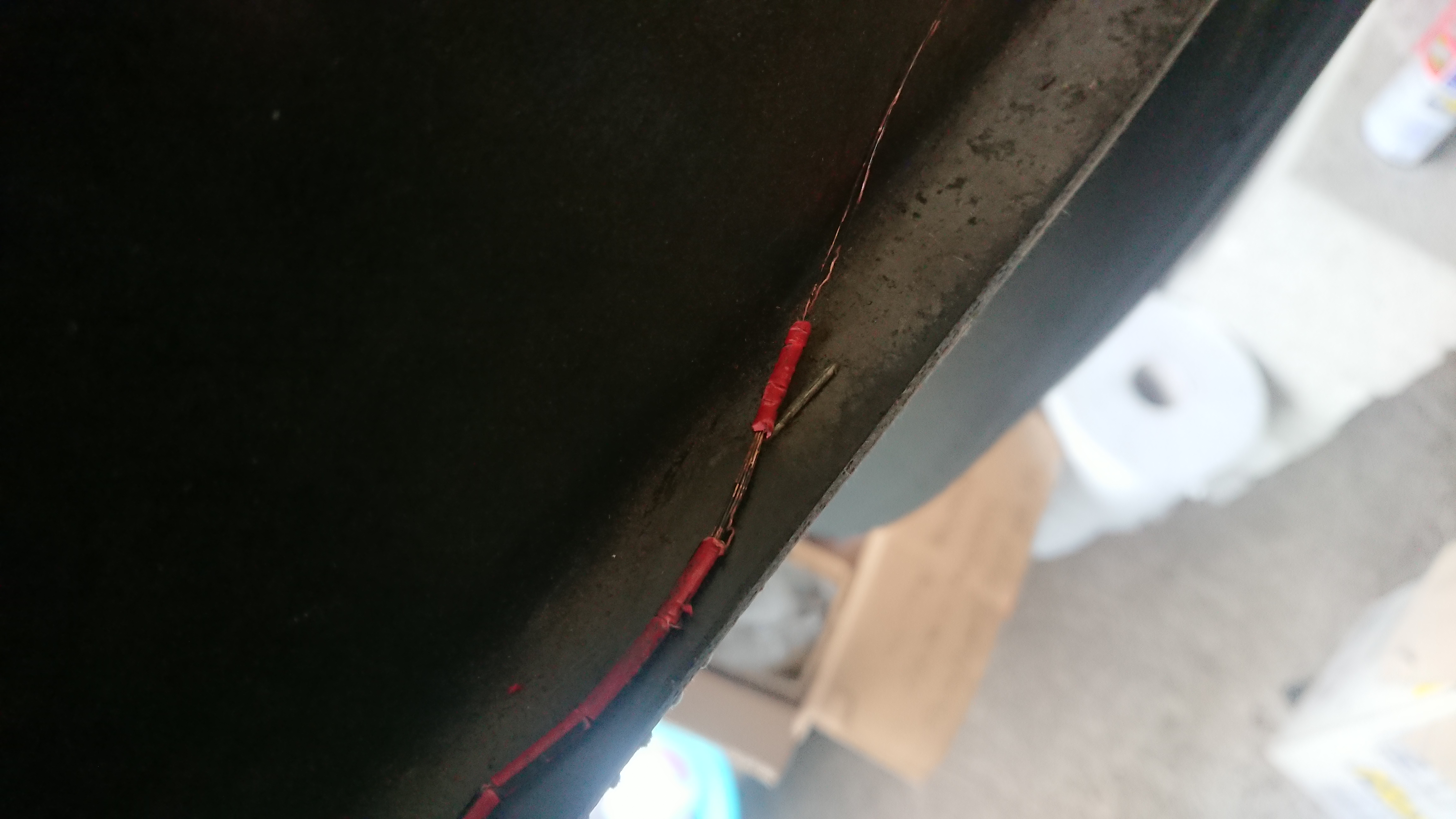

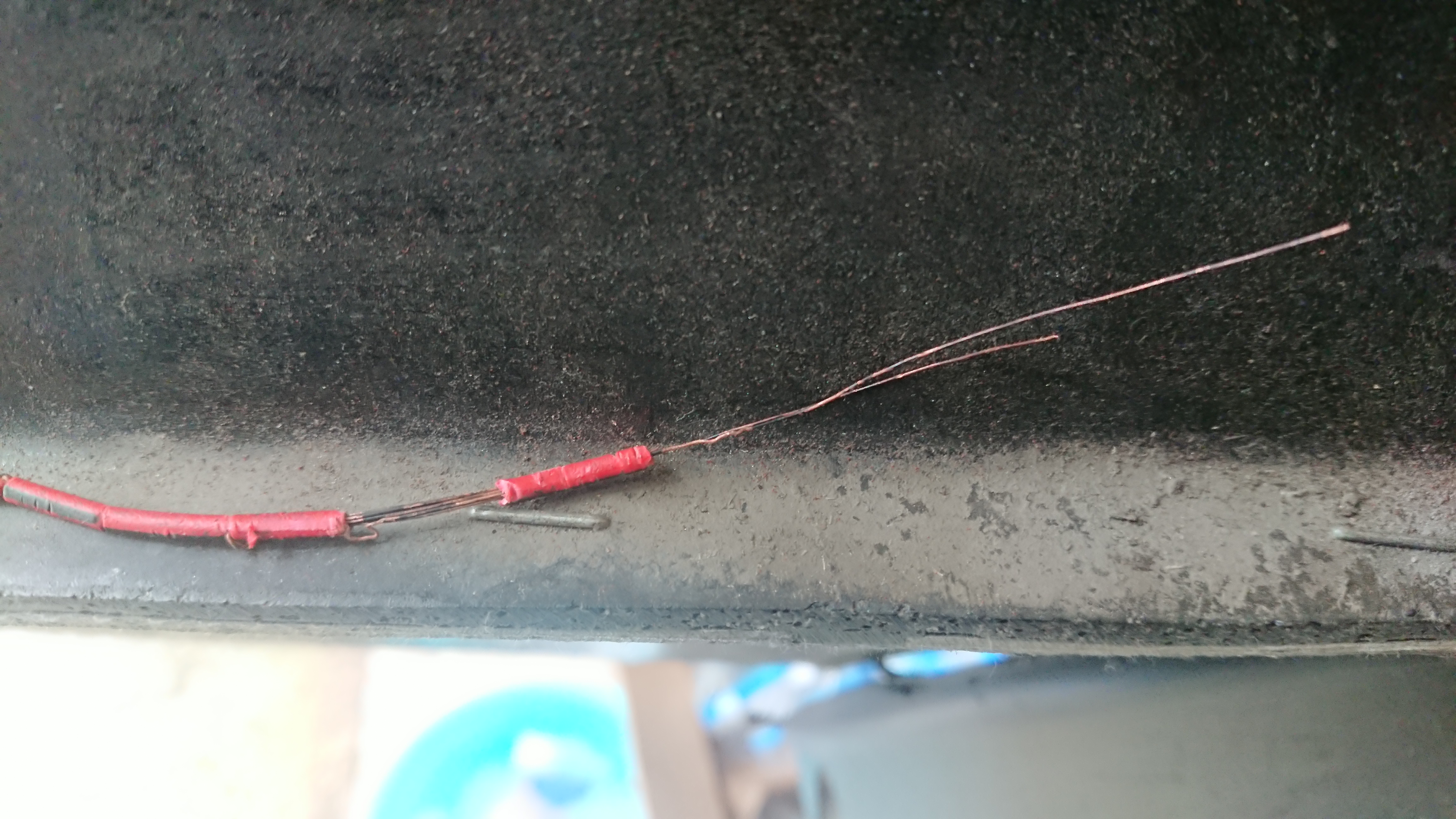

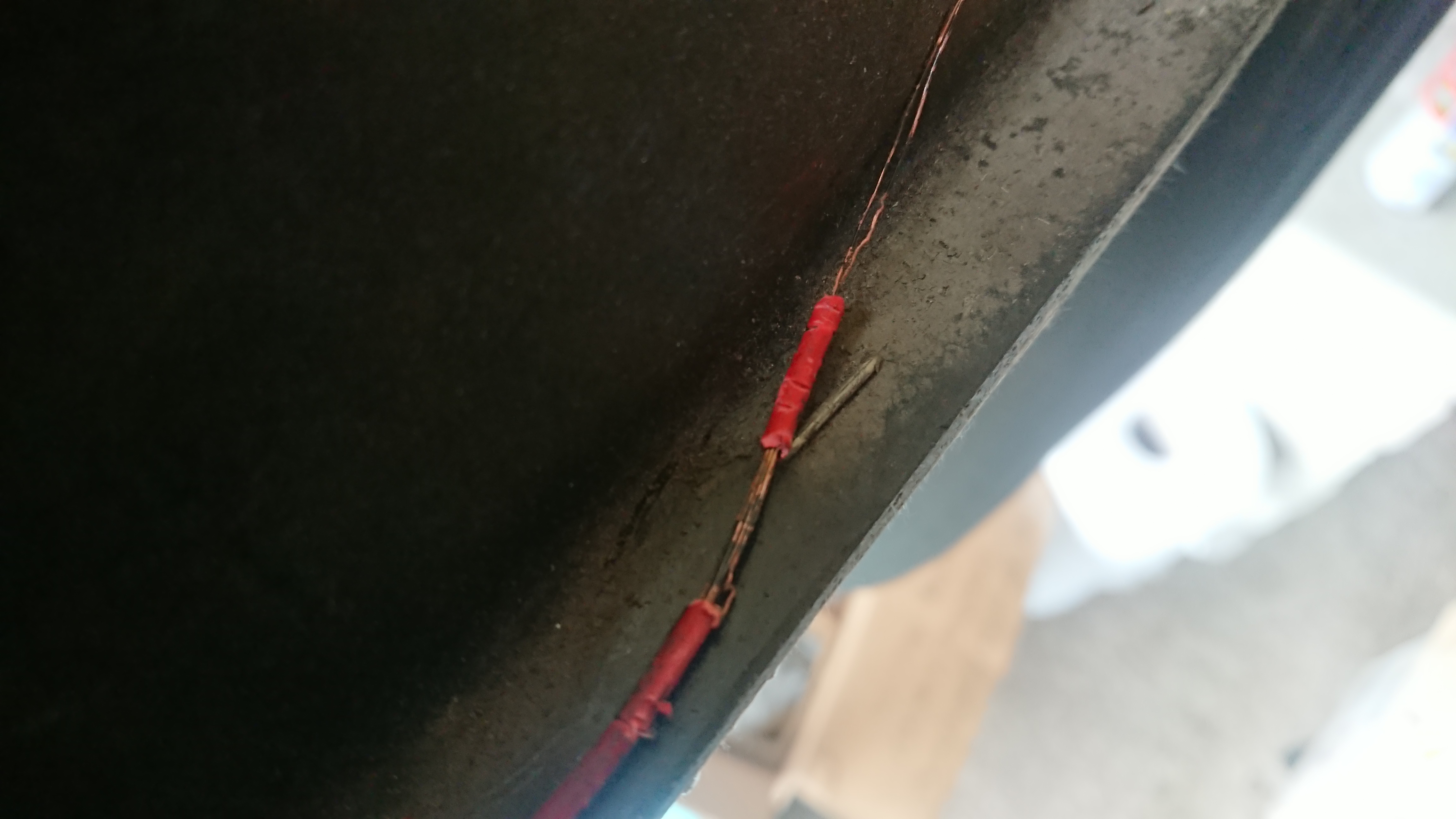

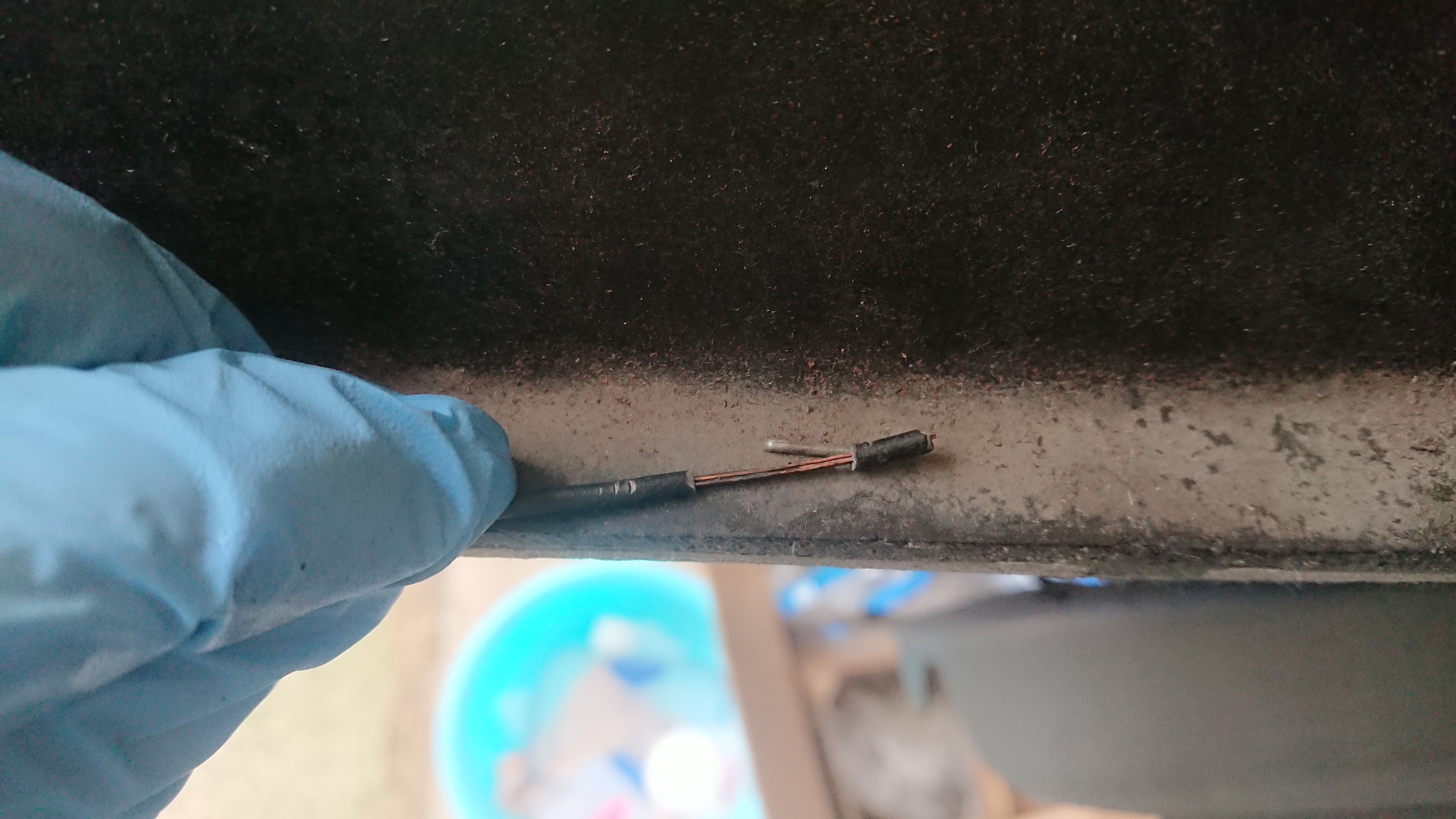

I sourced red/orange, red/black and black gauge wire for the side marker lights to match the original loom colours to try and keep it as it was..
Interesting to see how far the black oxidisation goes
About 20 inches of original wire removed to get to good clean strands
New wire with clean copper for comparison

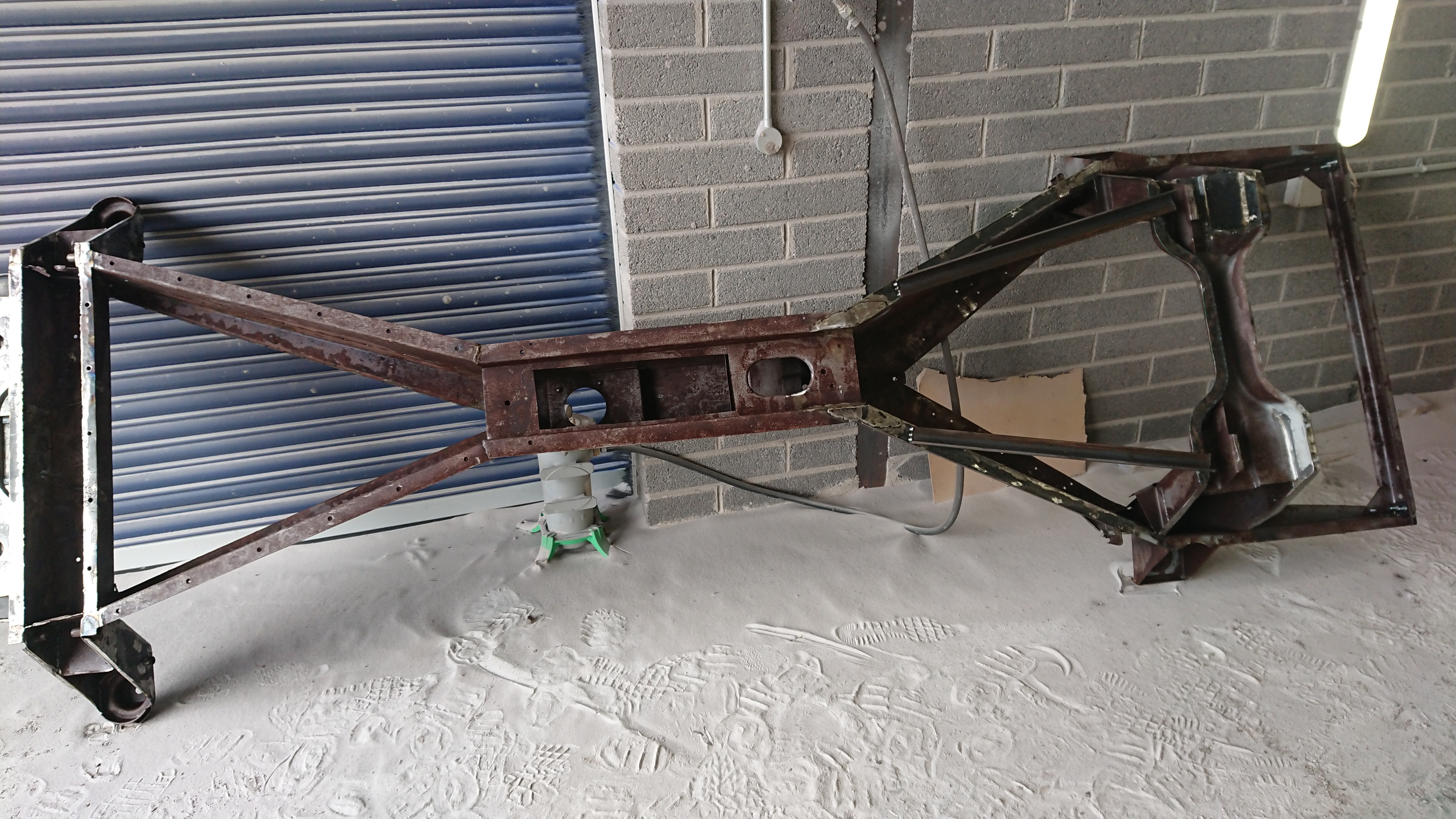

Postby cis6409 » Tue Jun 22, 2021 8:27 pm

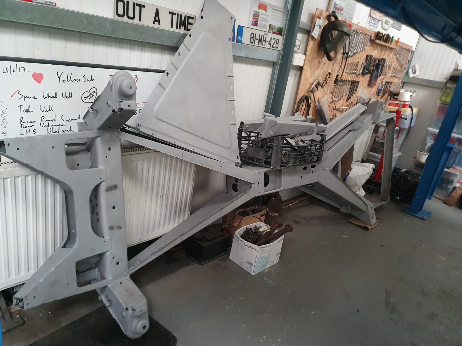

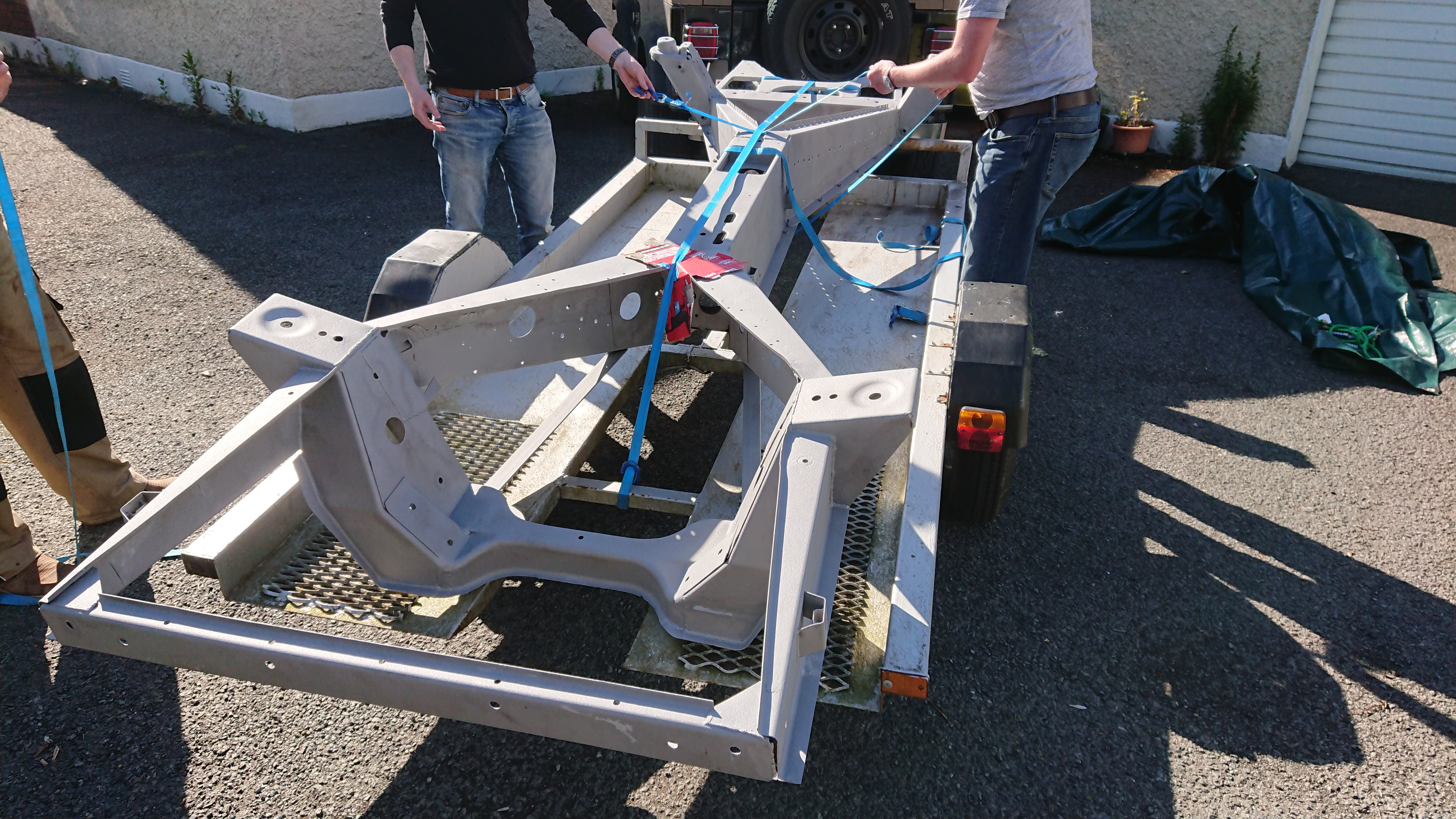

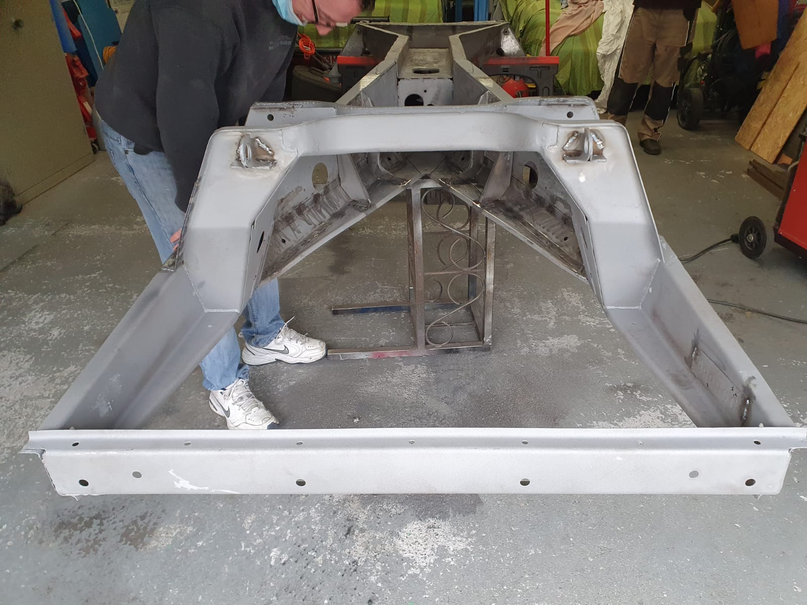

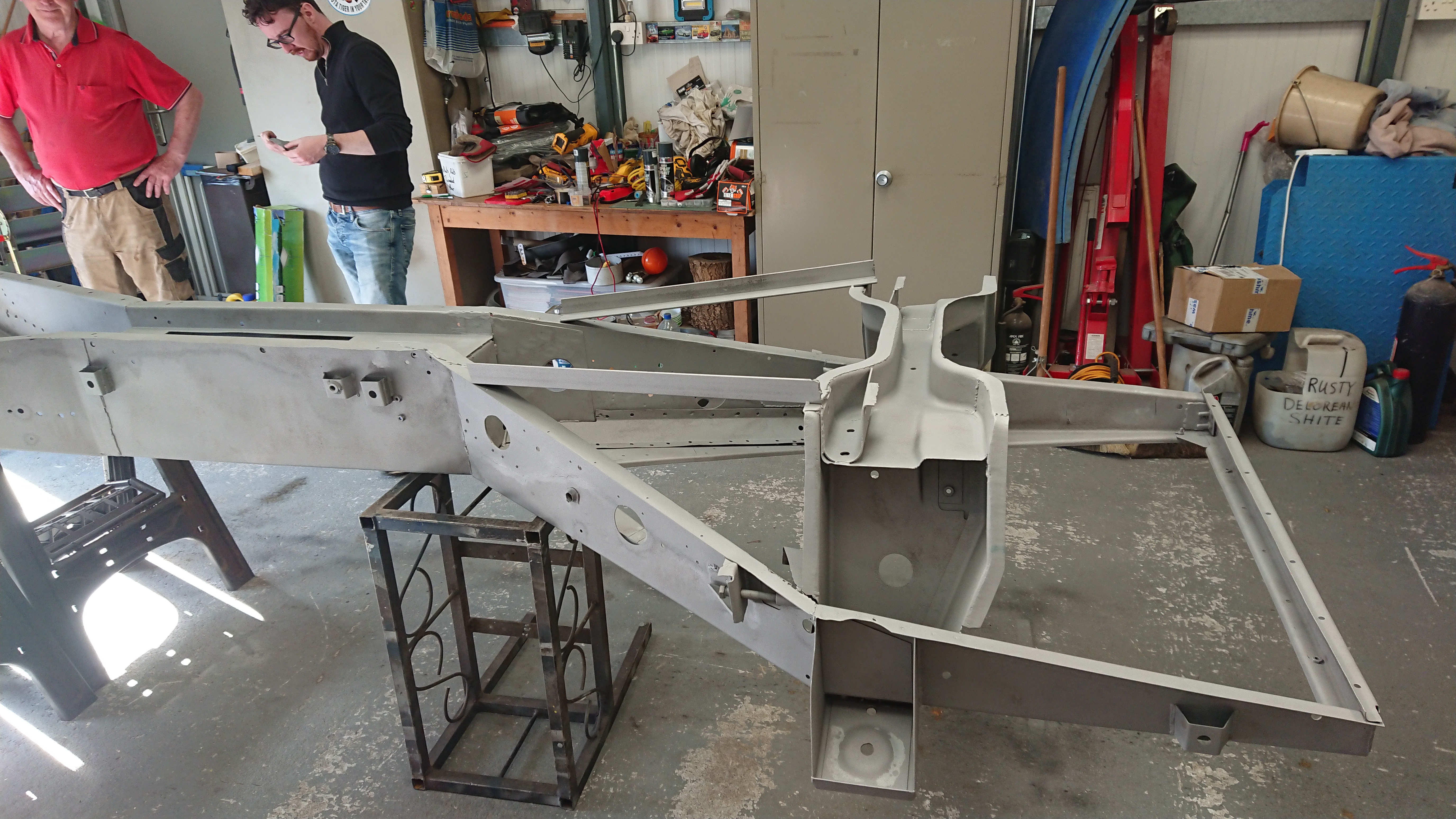

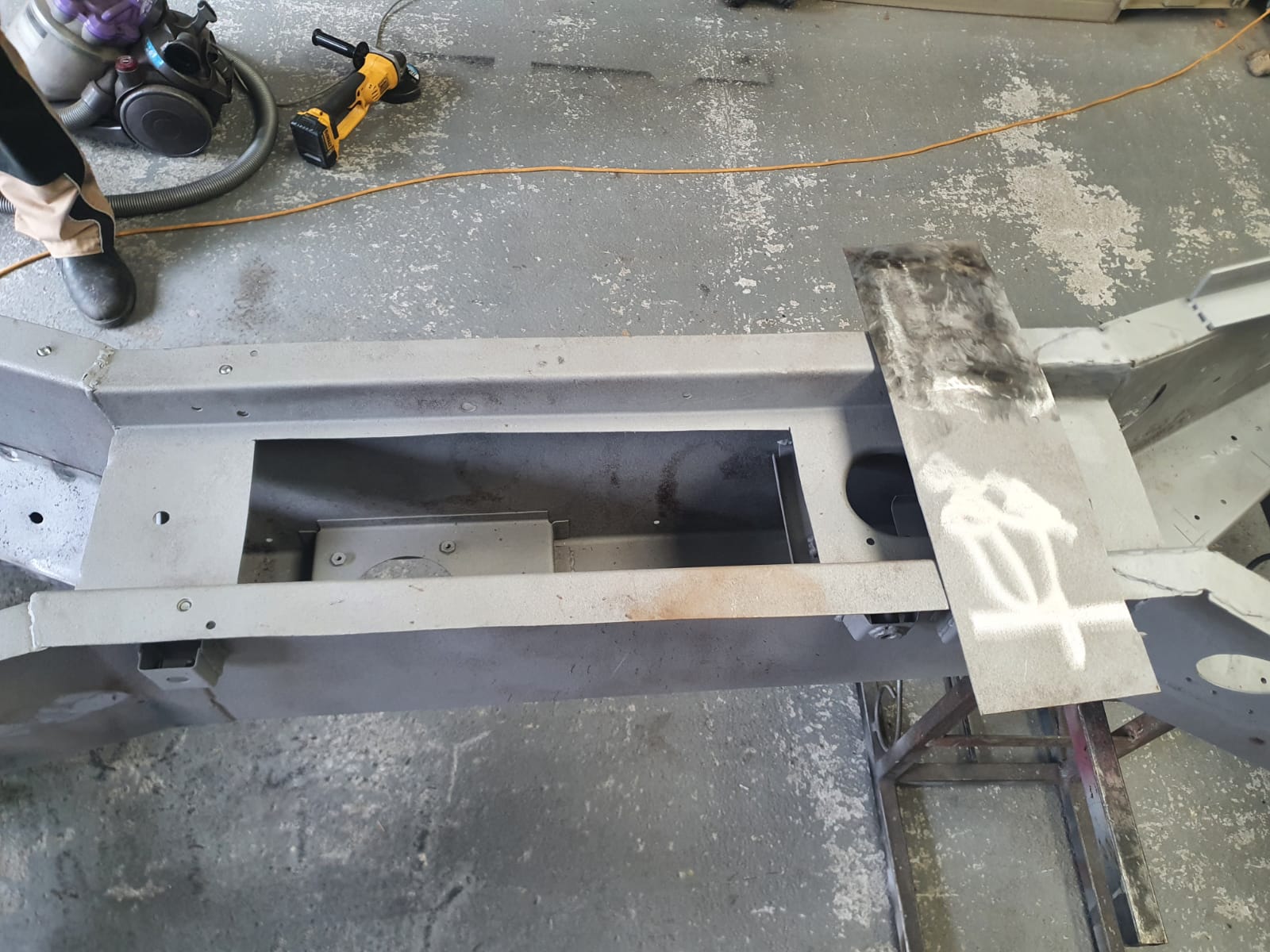

Back to the chassis again.. With the front and rear inner 'y' doubler plates removed and cleaned out the chassis could go back to the blasters again to get everything cleaned up and ready again for re glavanising.

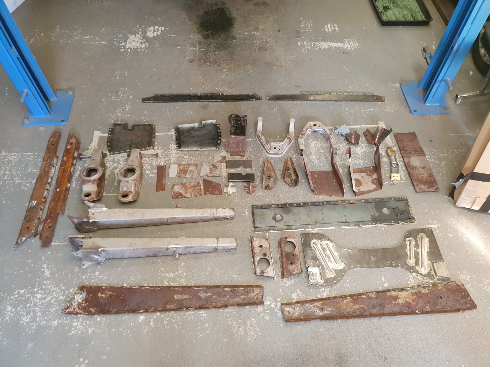

All the separate parts were numbered and listed so they could go back on for final welding. Then all going well onto the galvanisers.
First up was a mock up again to make sure all the major components lined up and fitted as they should and see if anything else needed doing..
All 34 pieces listed

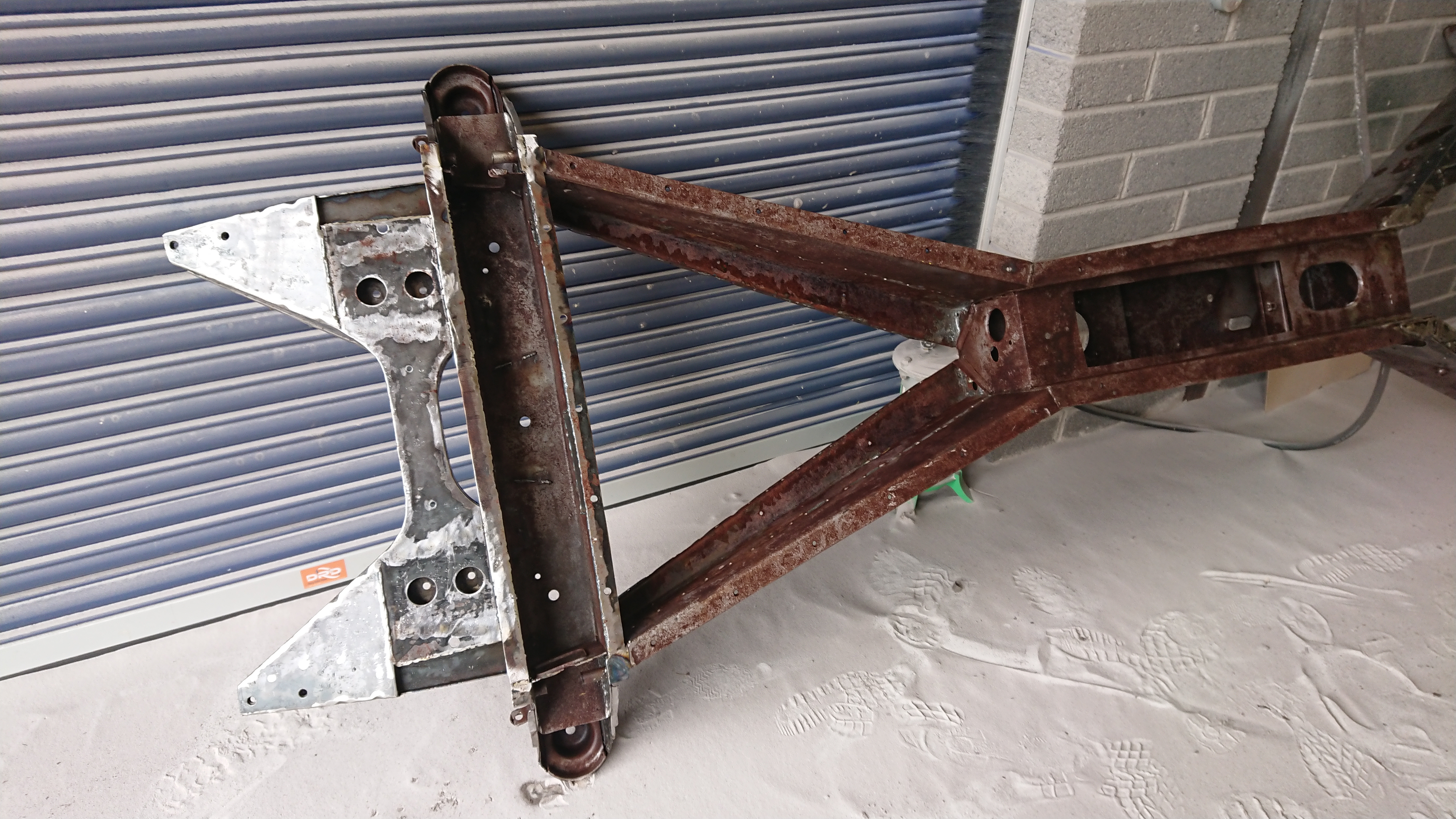

Postby cis6409 » Tue Jun 22, 2021 8:33 pm

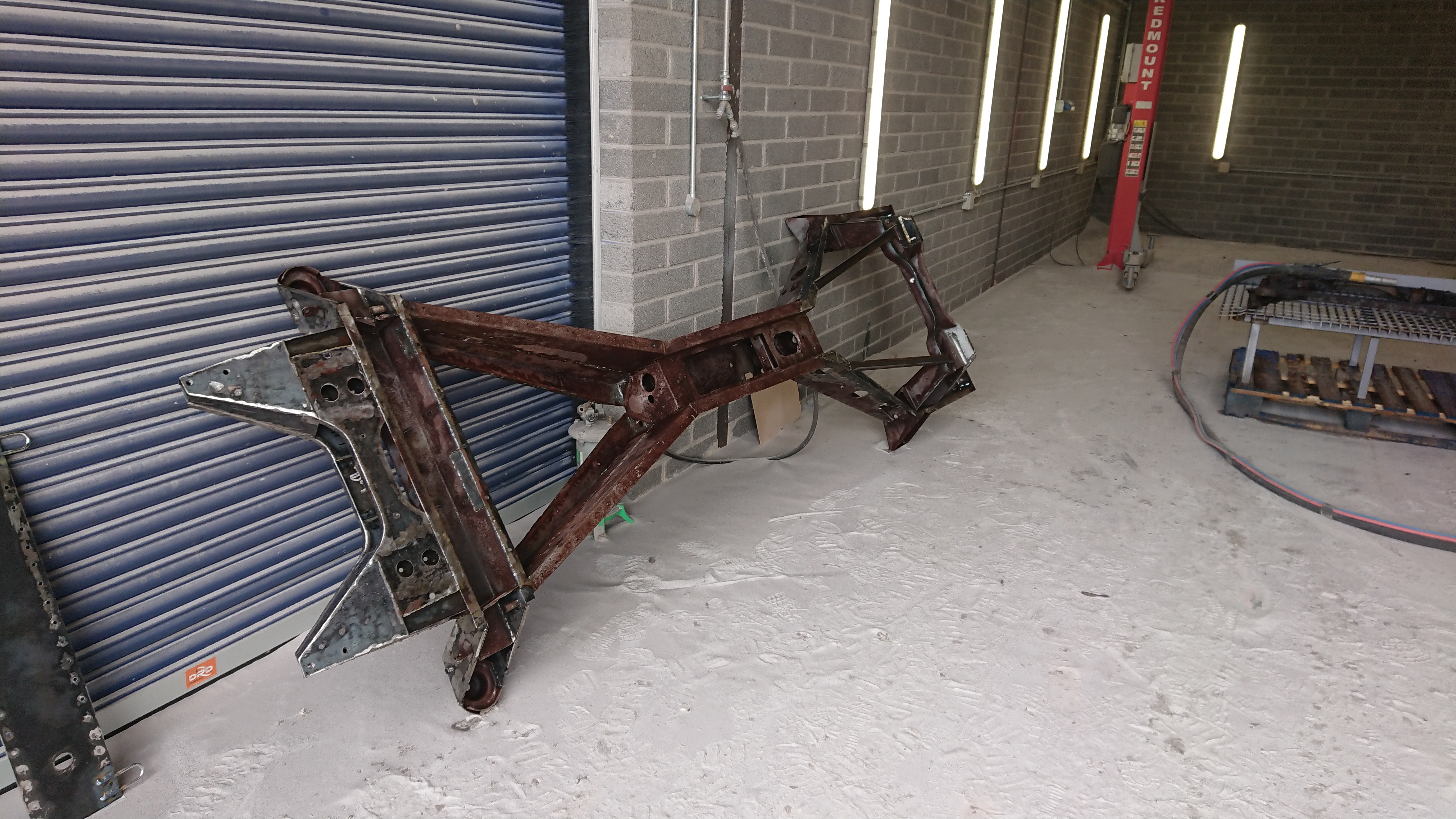

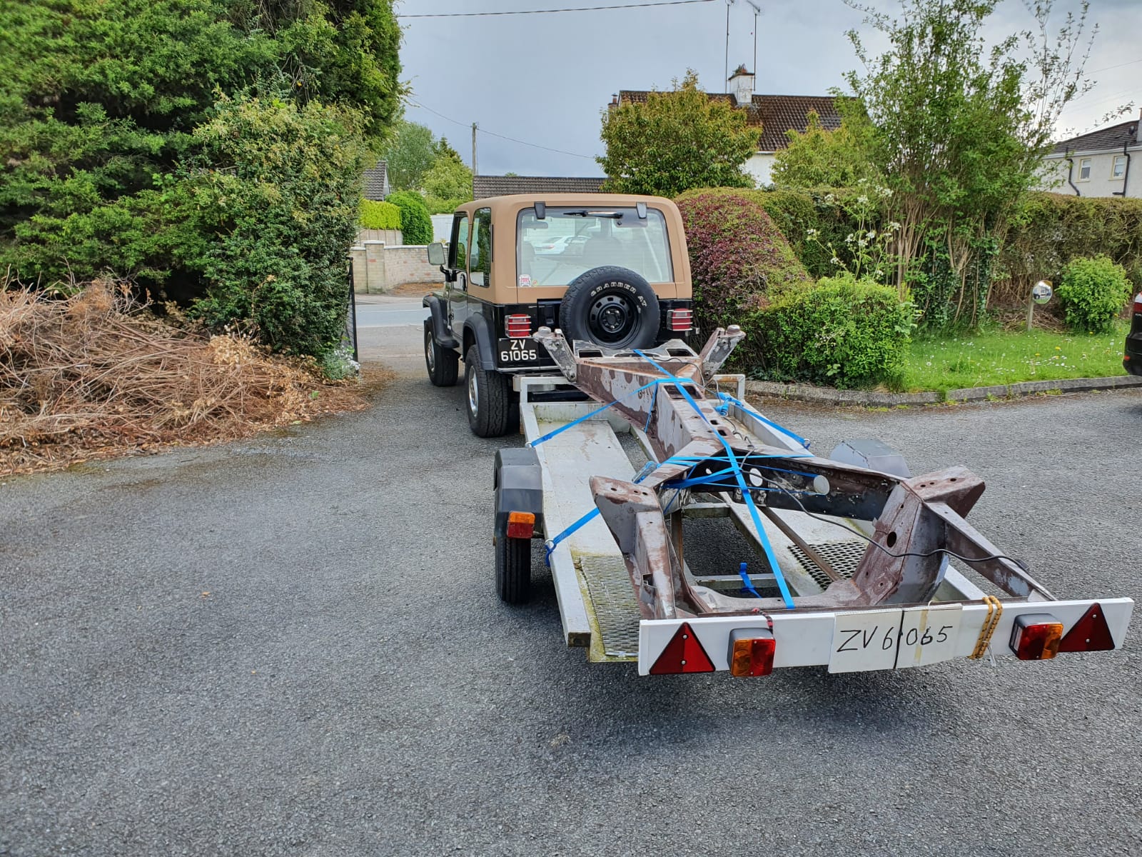

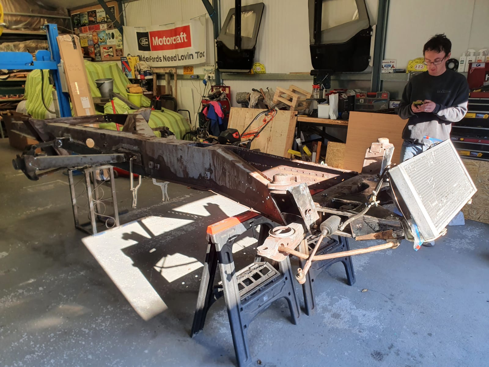

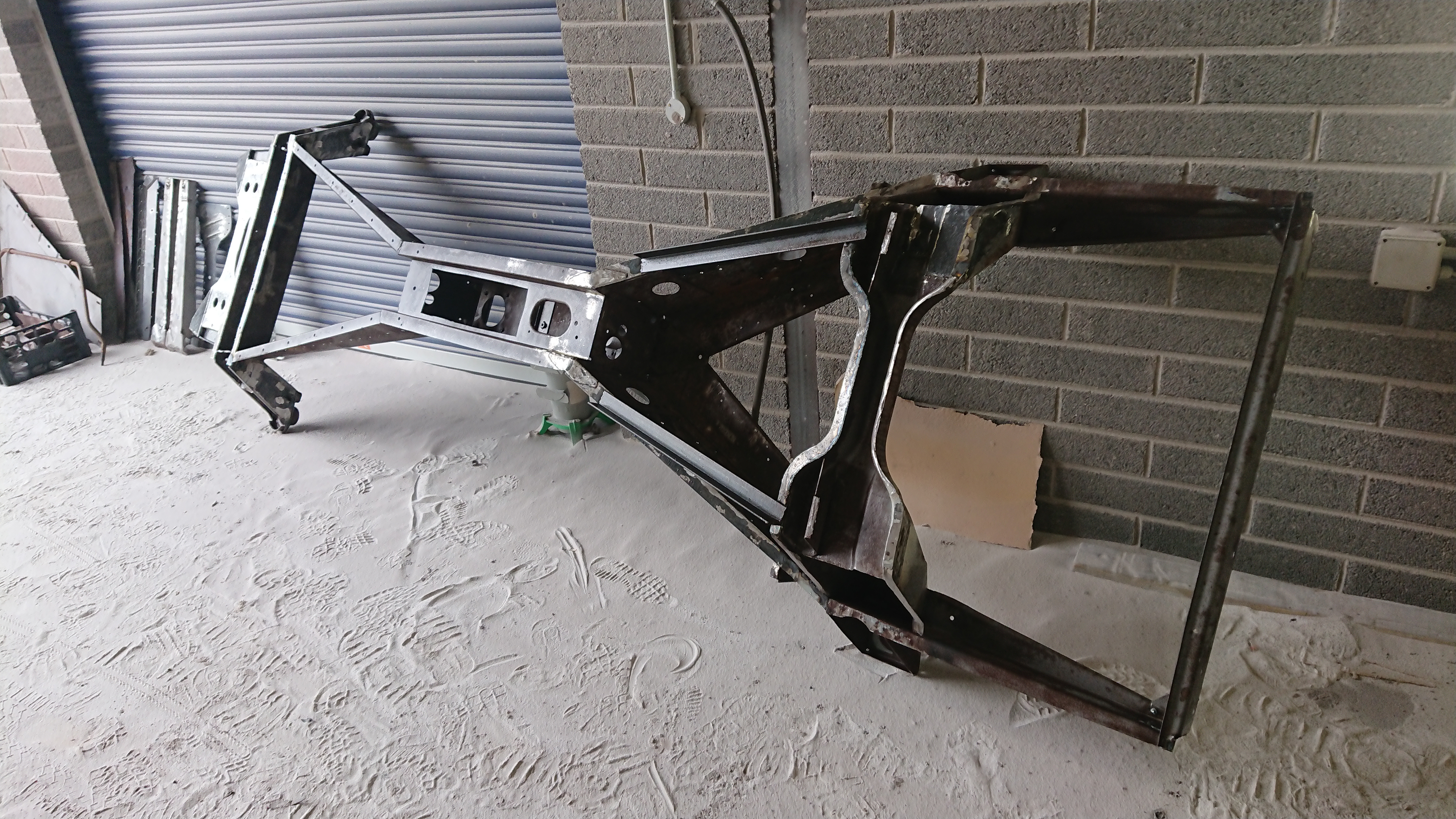

Dropped off at the blasters

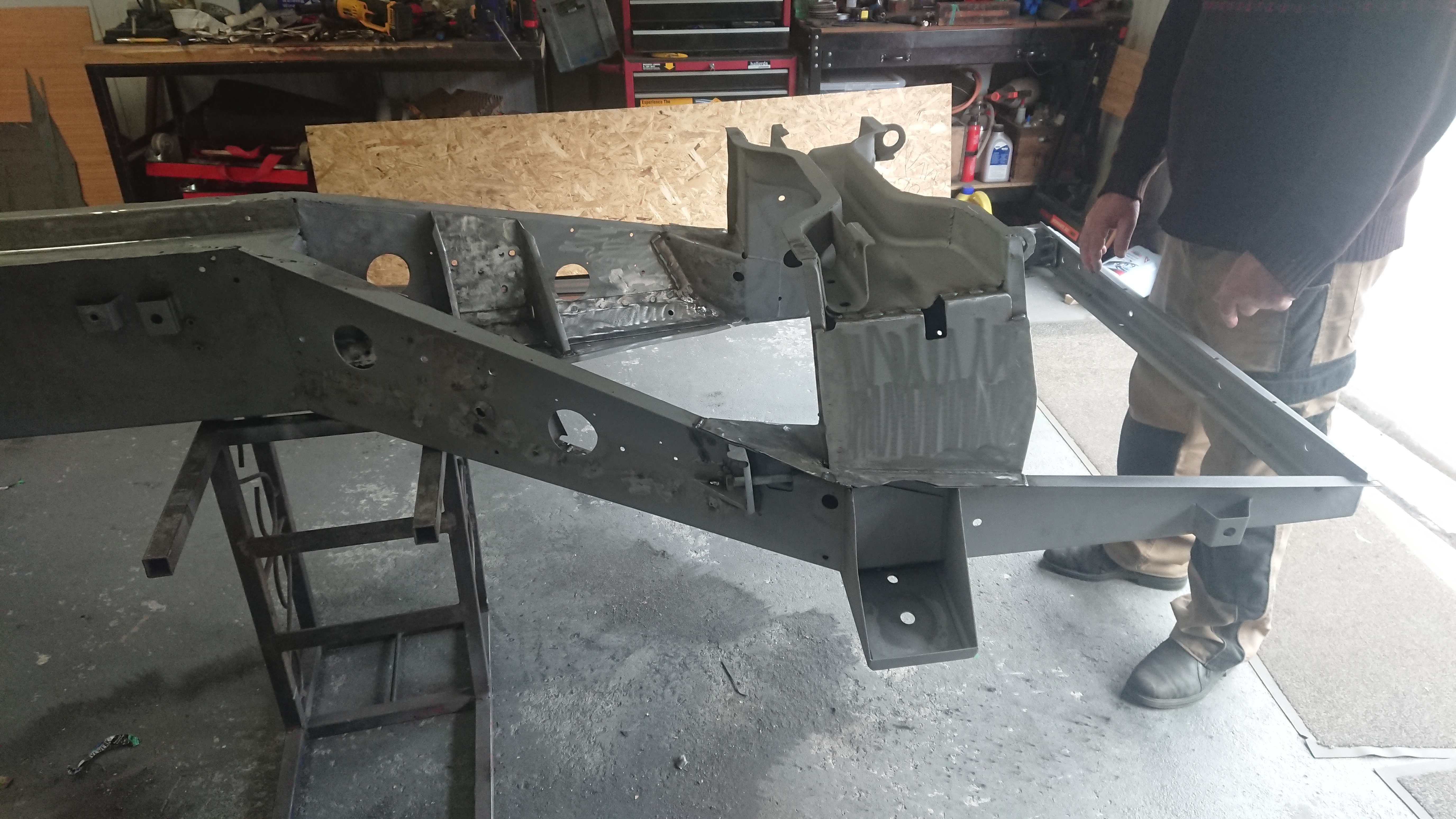

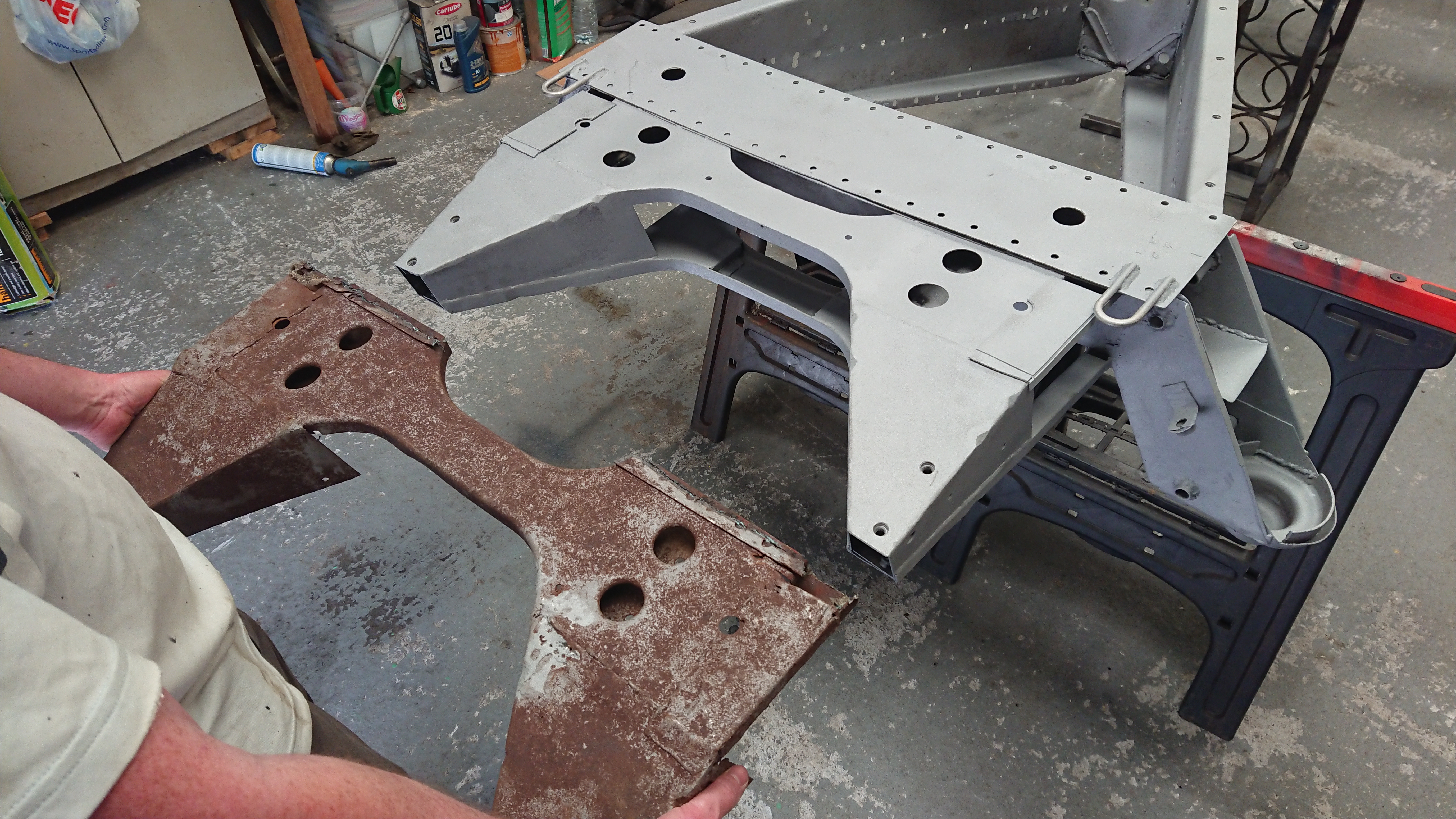

She s looking alot cleaner now this time.
Now hopefully a straight run welding everything back up and finally off to the glavanisers..
That's the plan anyways..

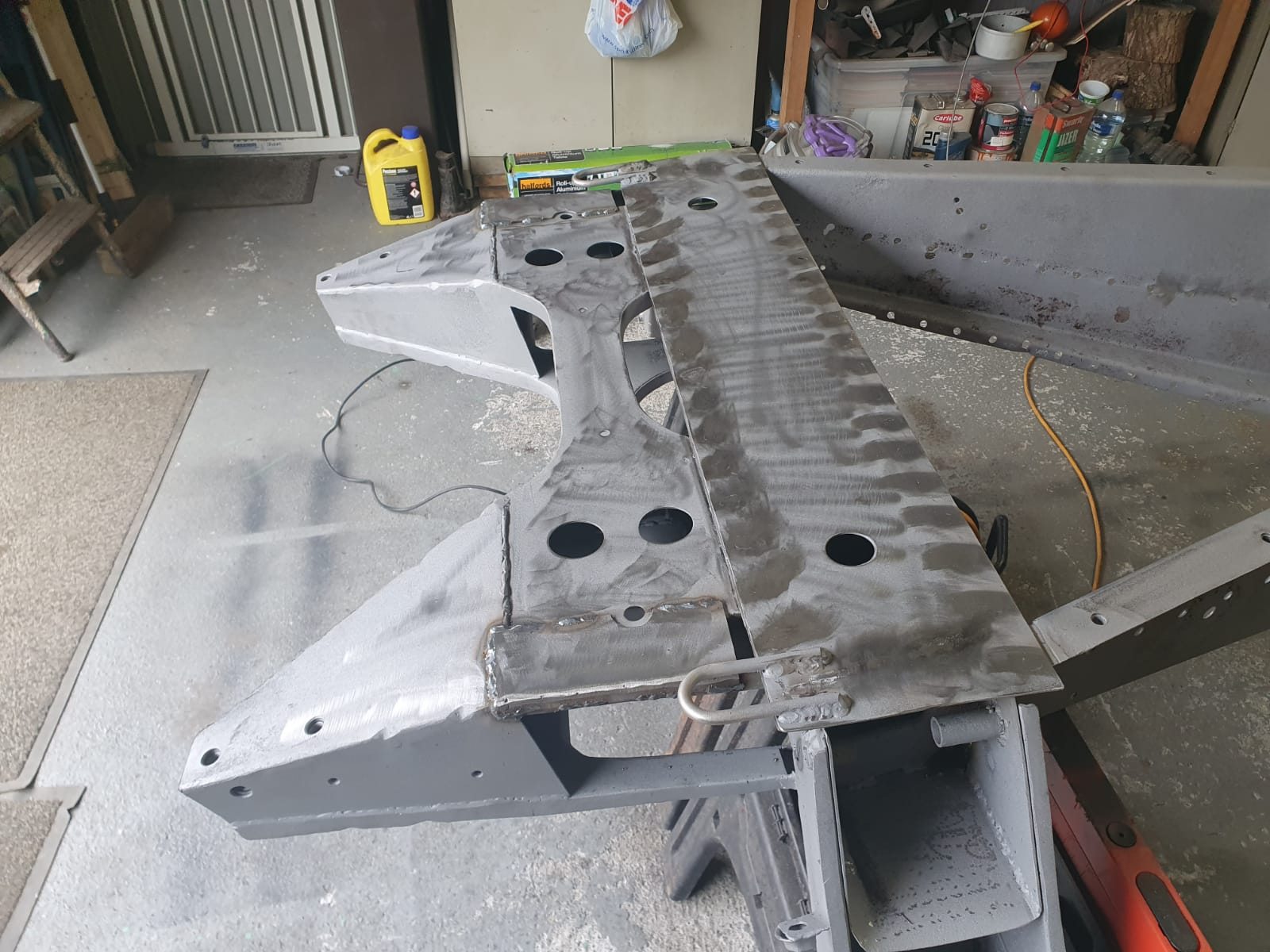

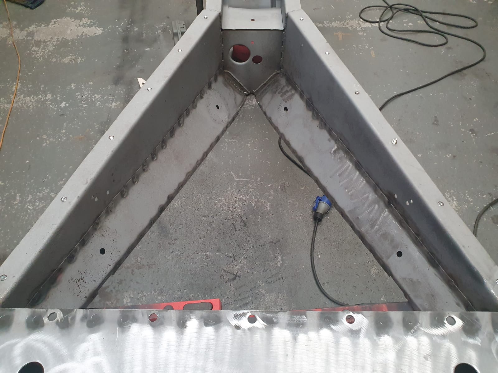

Re: Vin6409 engine rebuild
Postby cis6409 » Tue Jun 22, 2021 8:53 pm

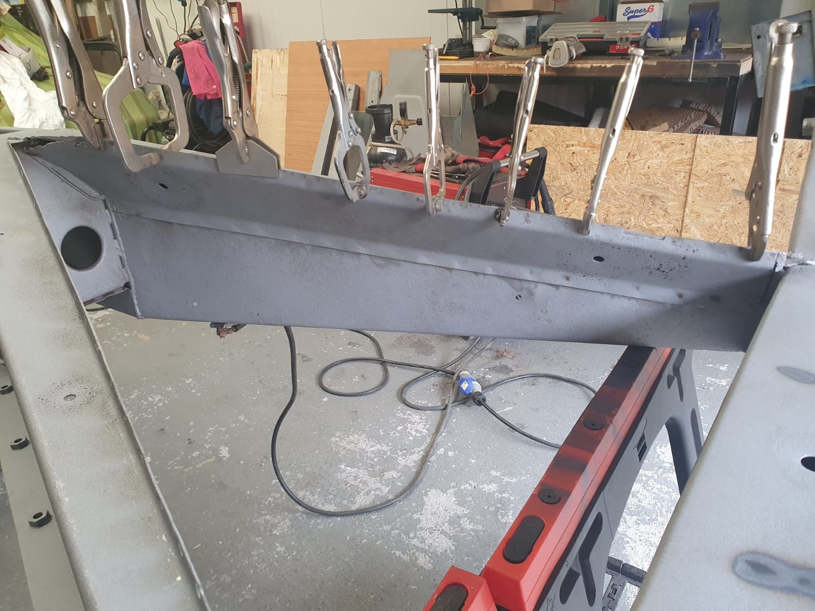

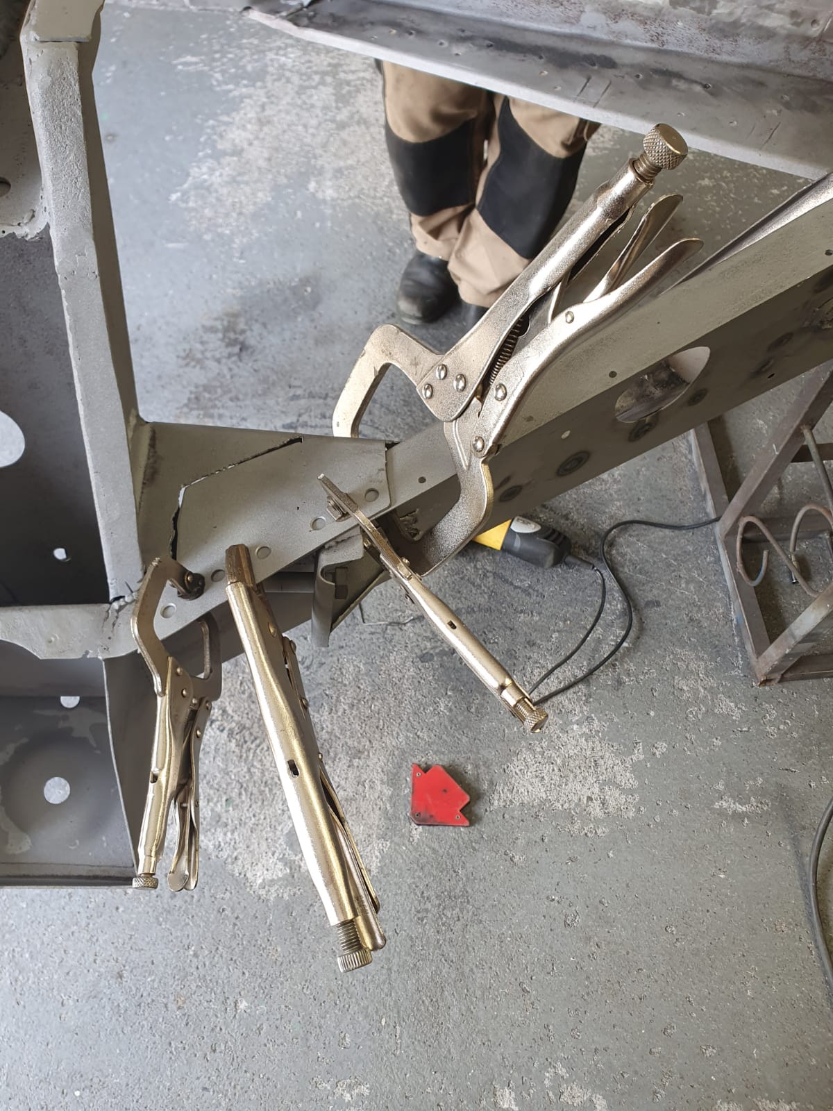

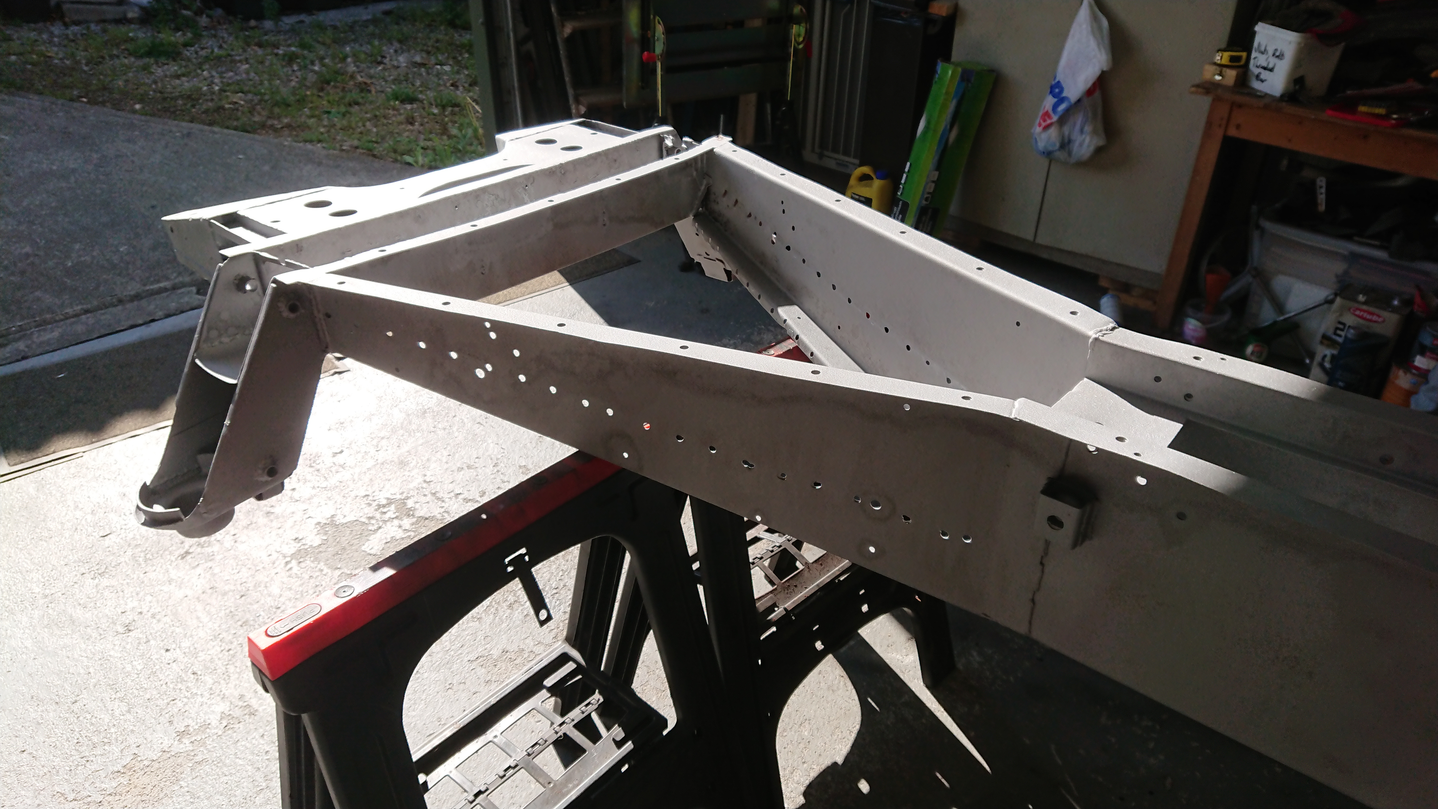

Starting at the front and working our way back.

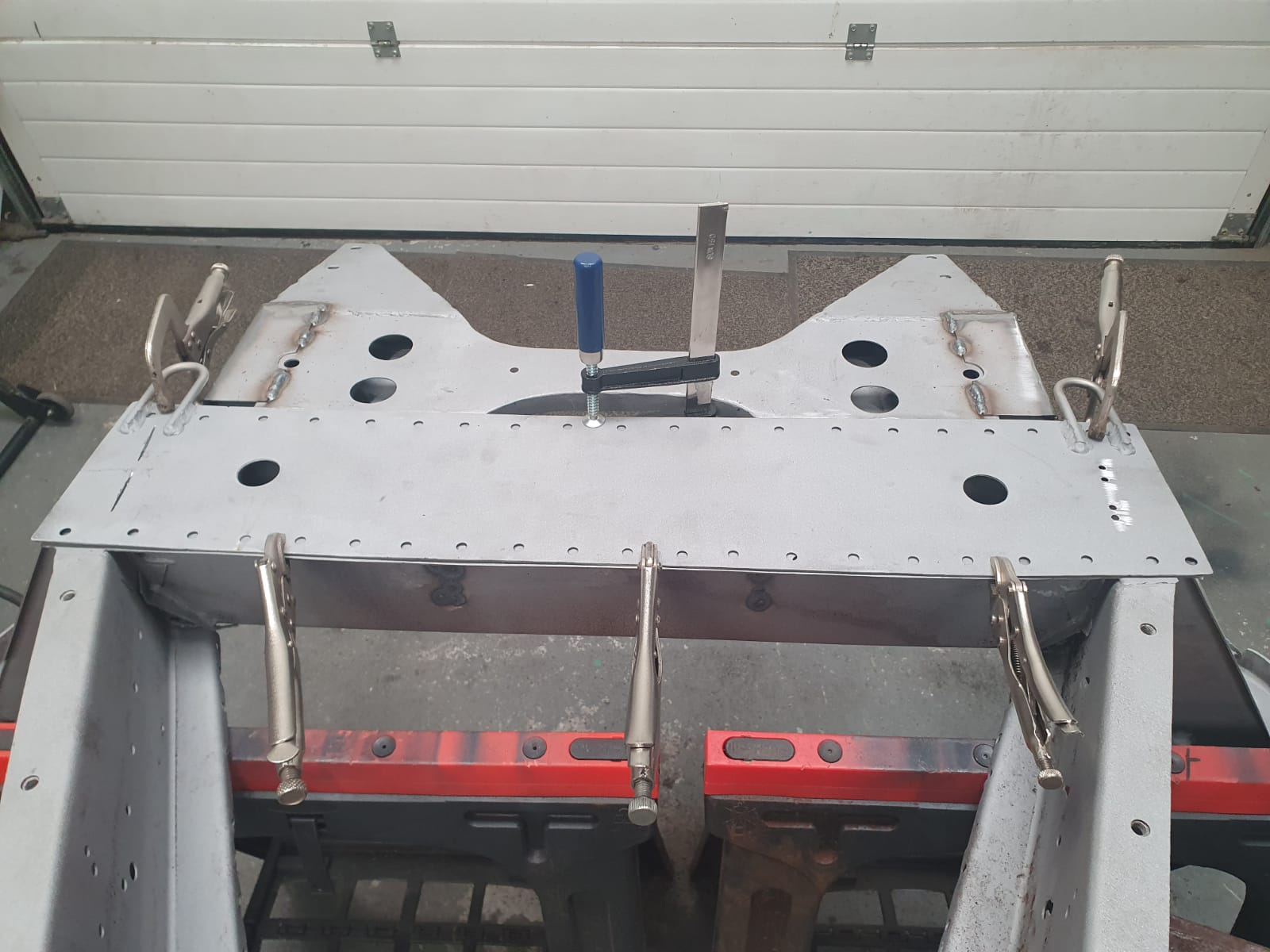

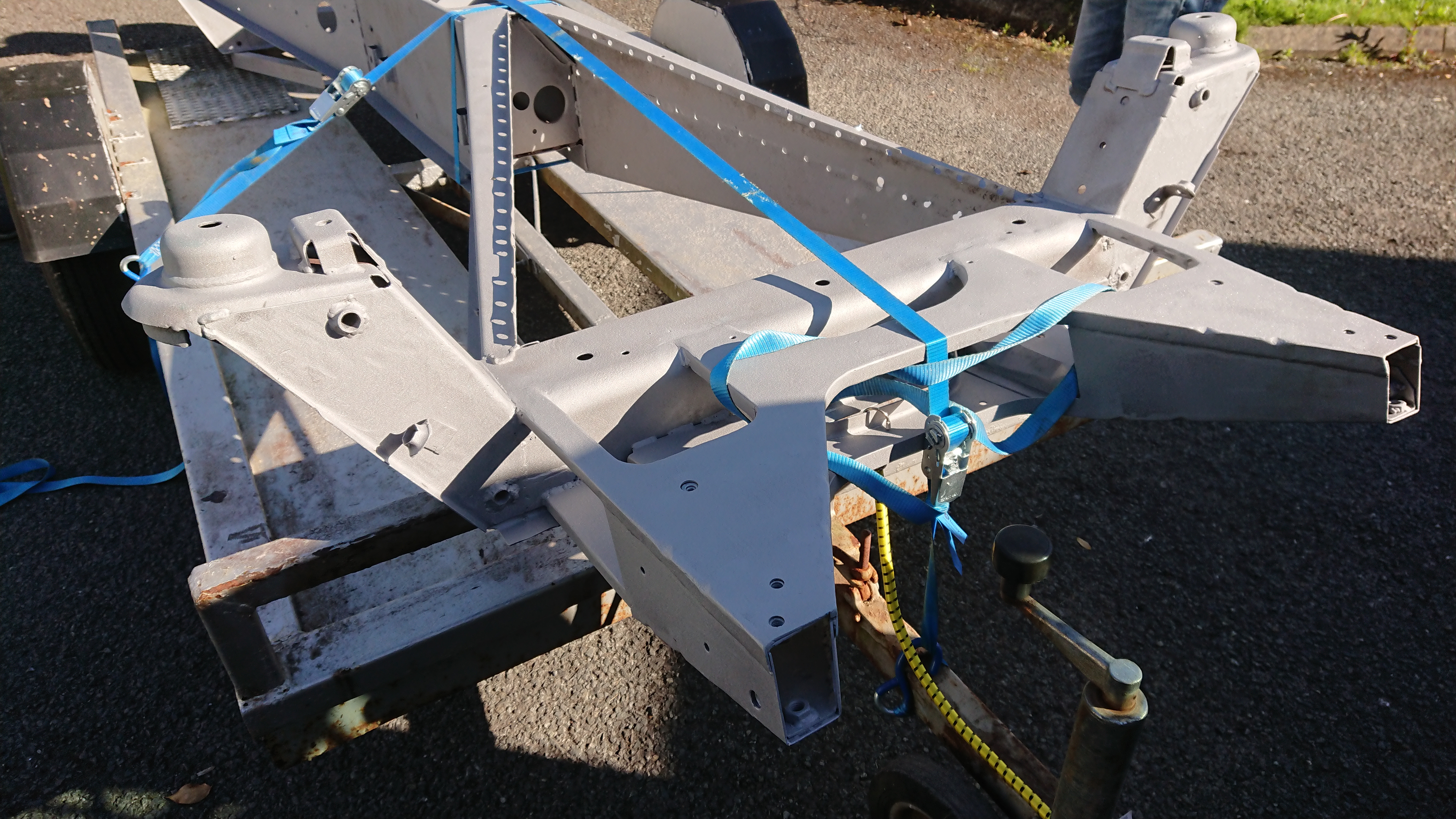

Front frame extension Crossmember supports, cover plate and towing eyes back on
Posts: 771

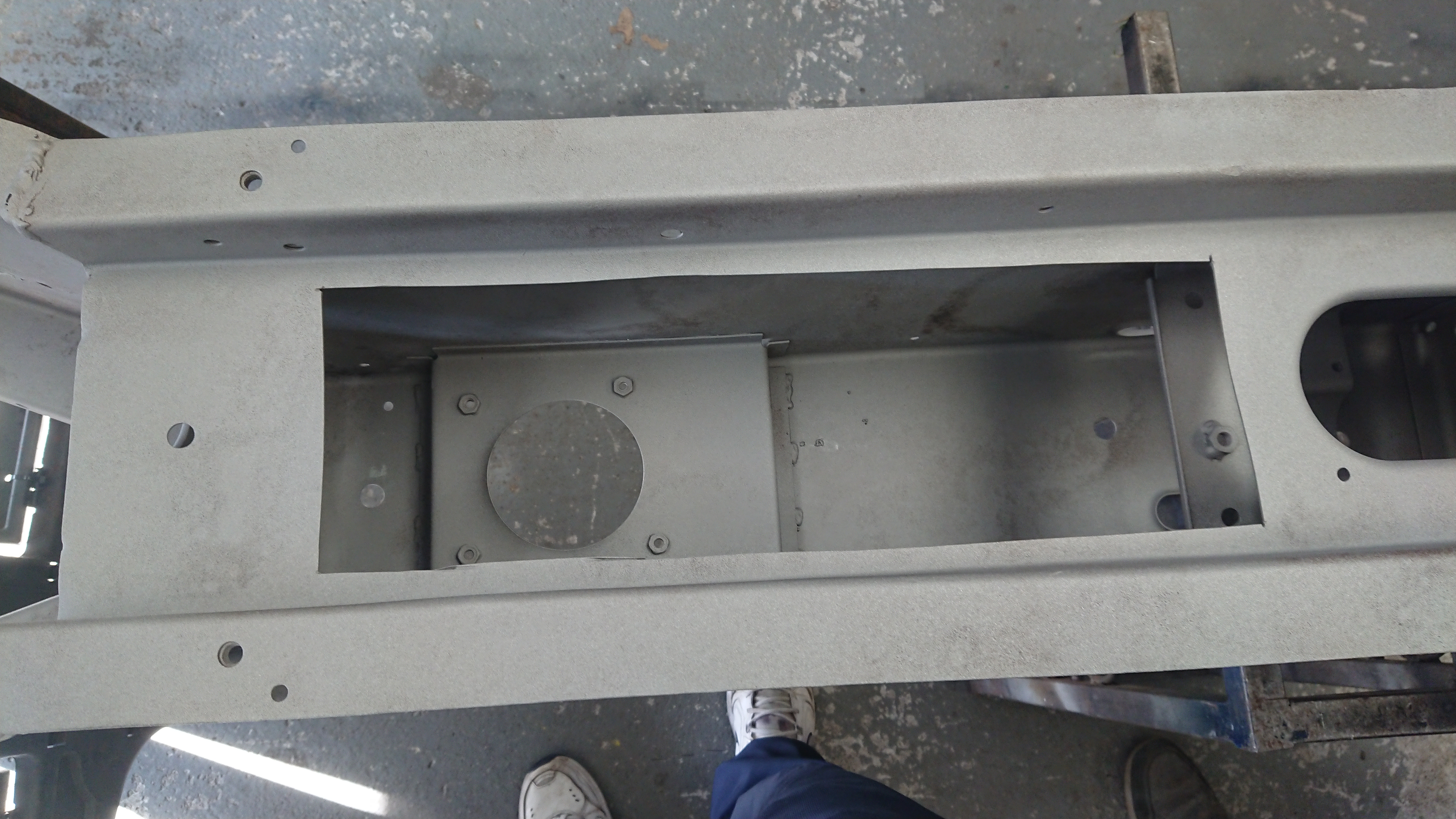

Postby cis6409 » Tue Jun 22, 2021 8:57 pm

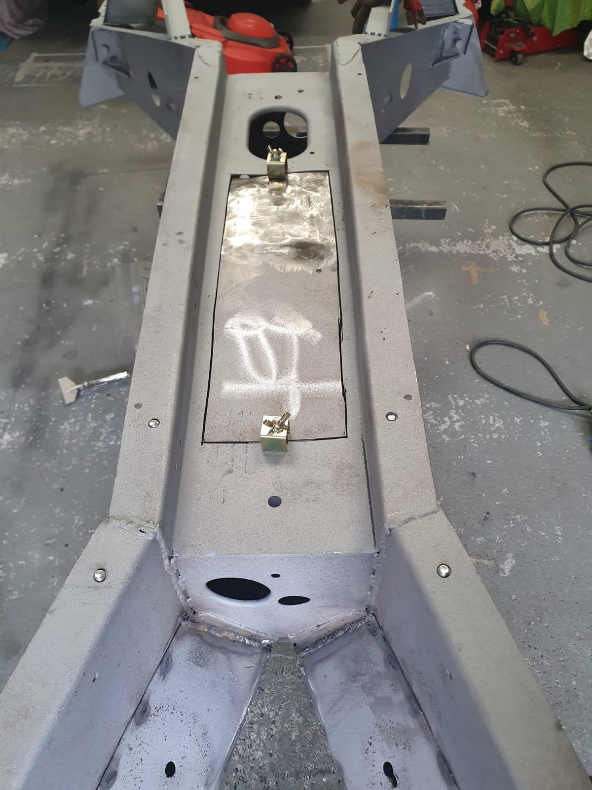

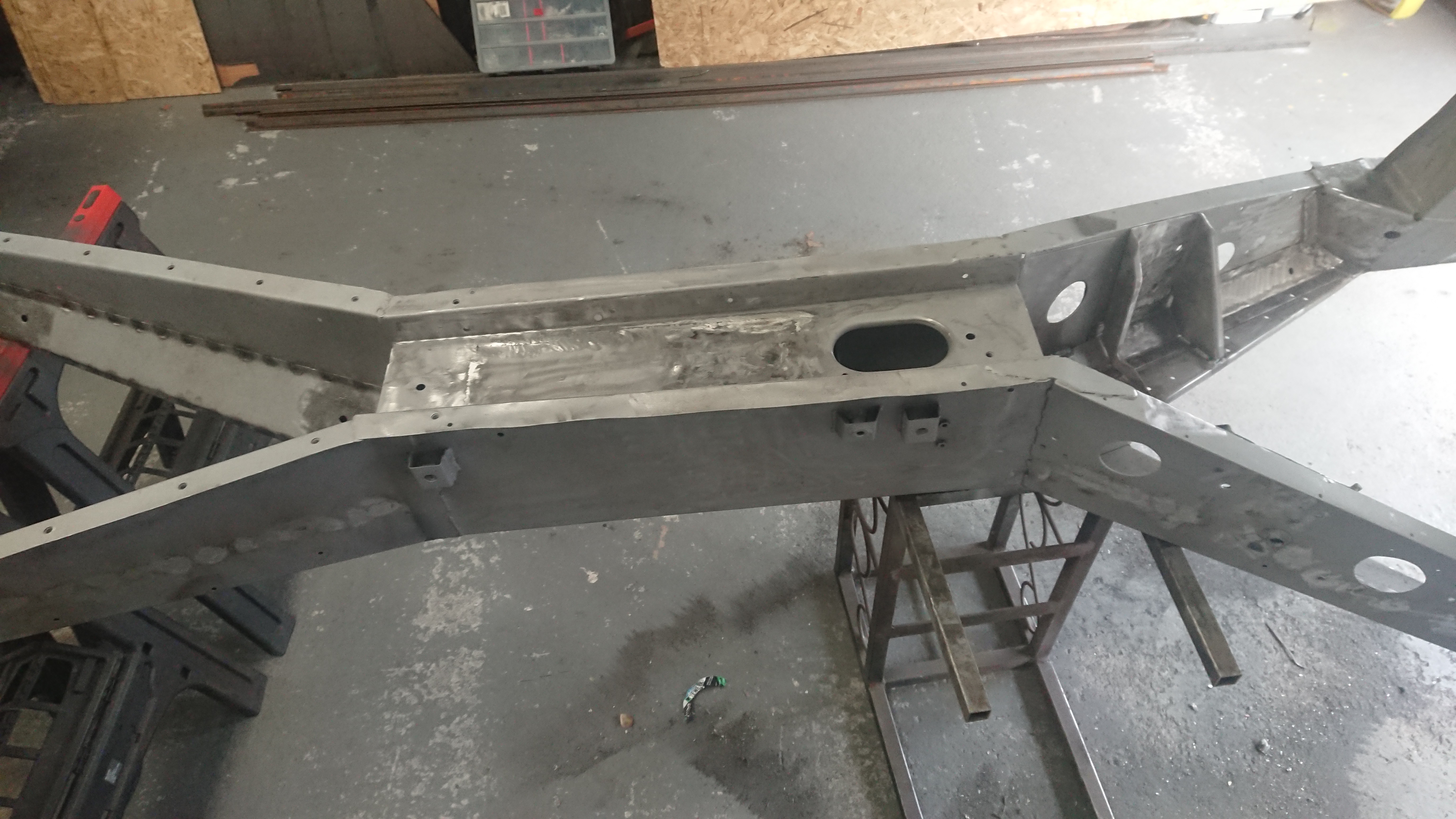

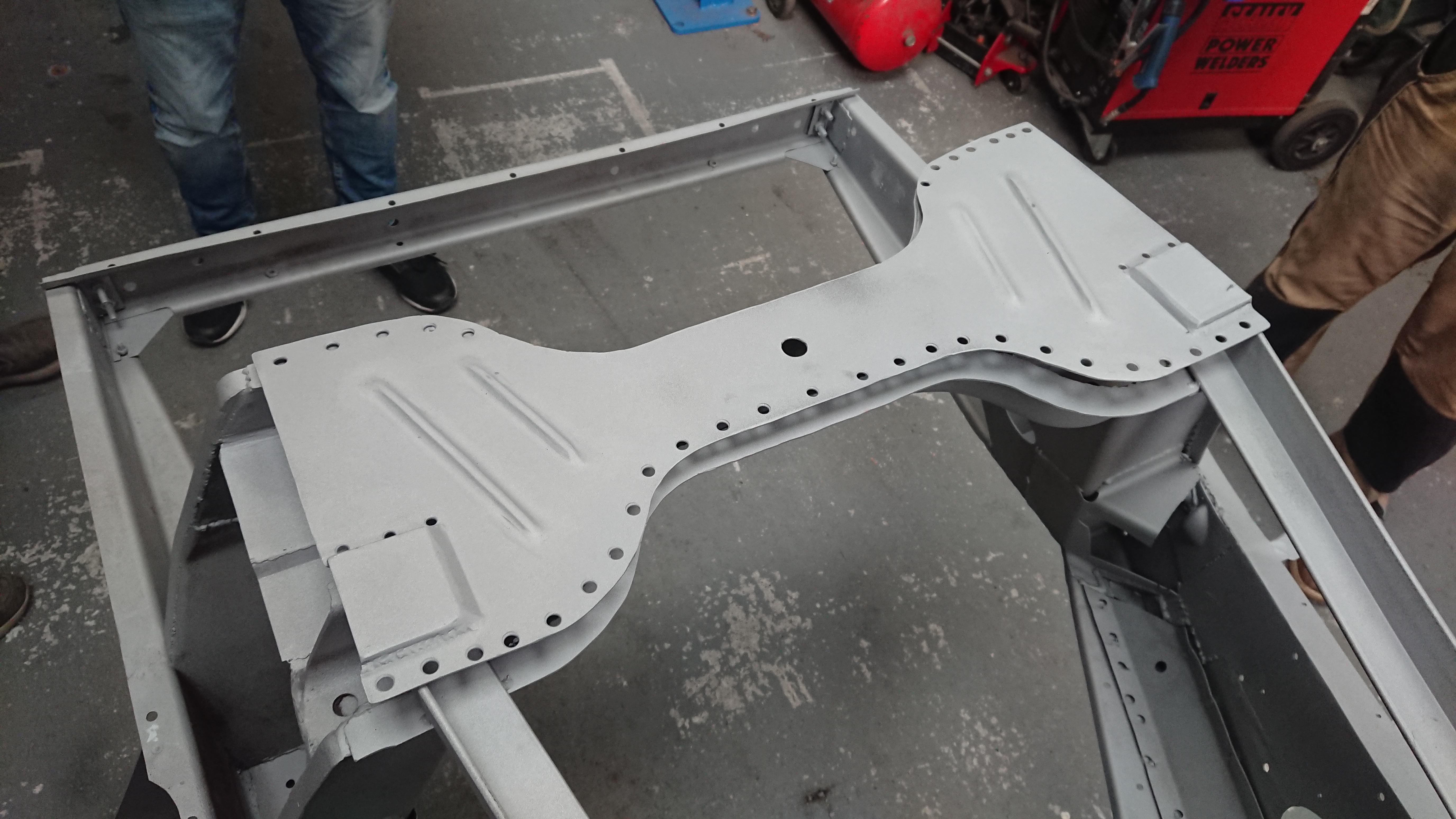

Extra access hole for center housing tunnel

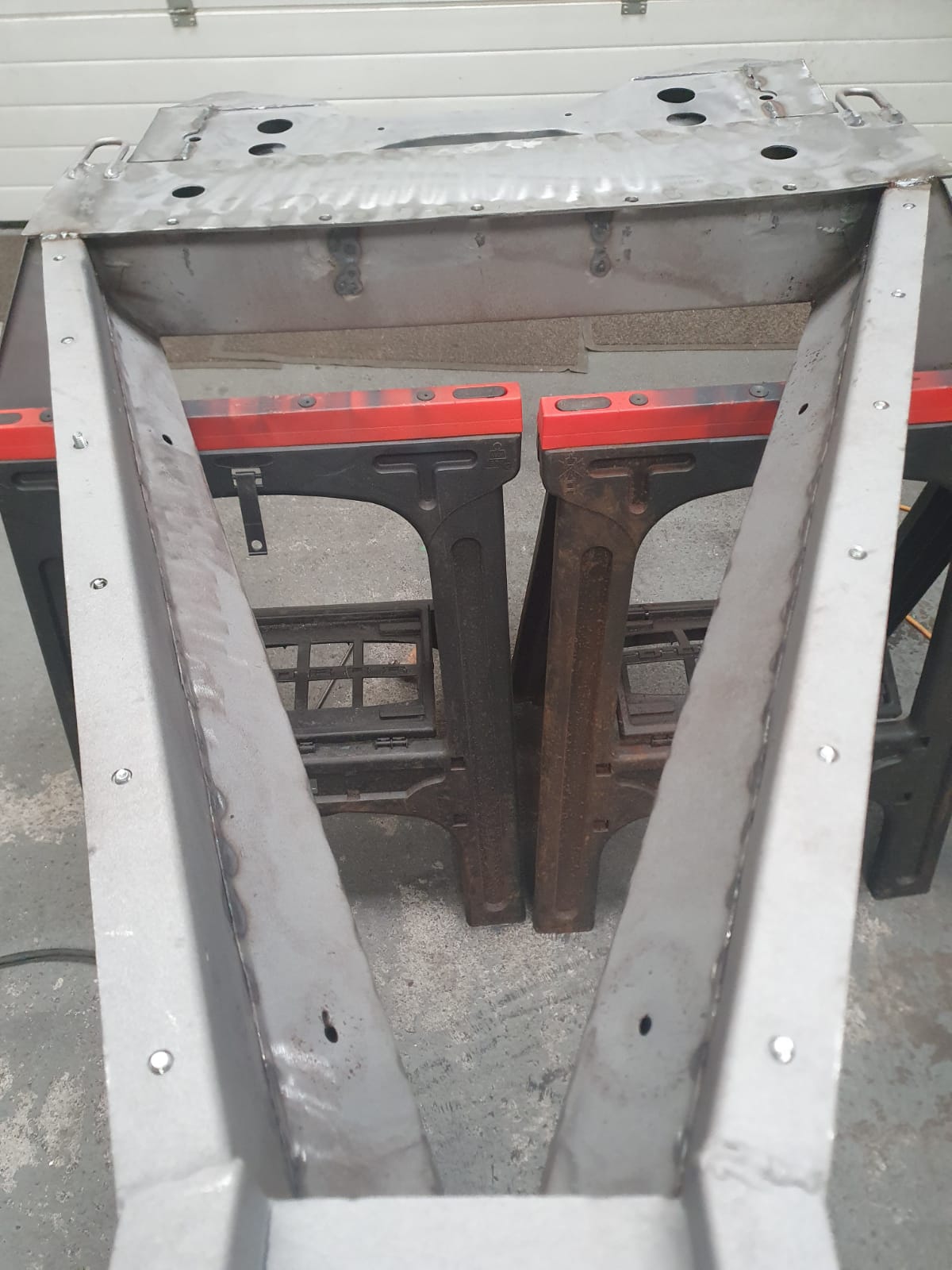

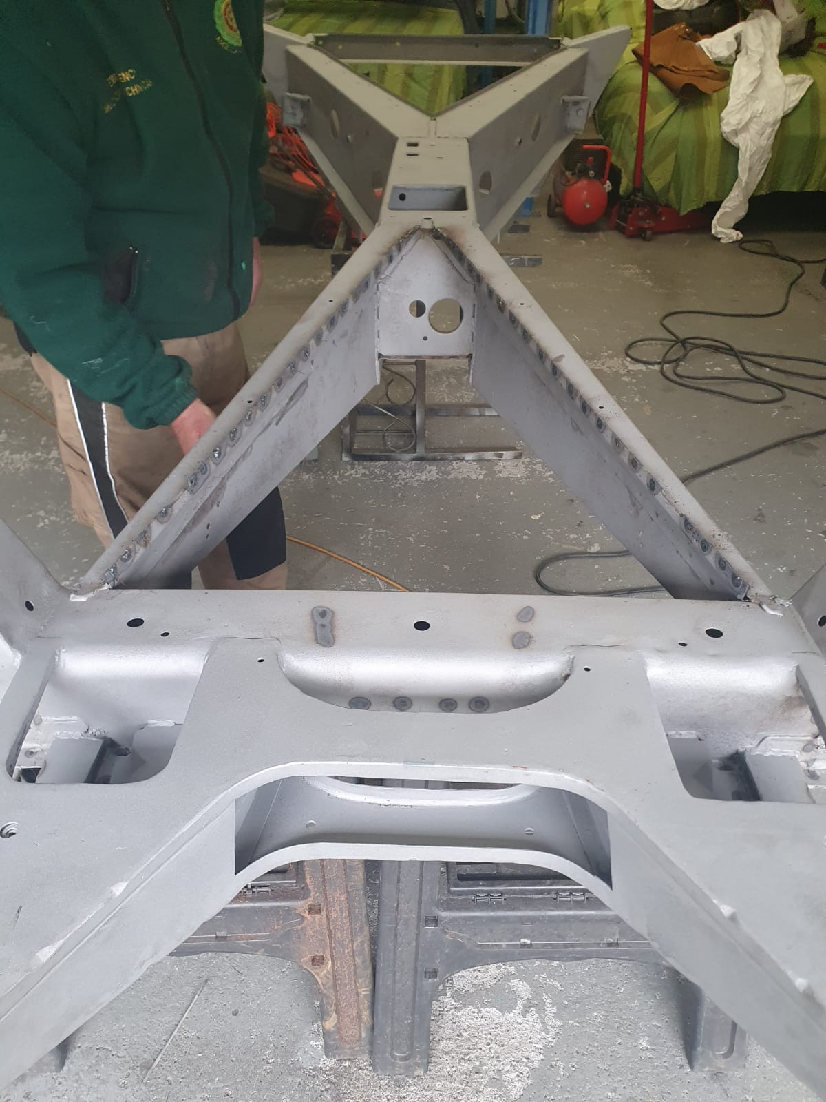

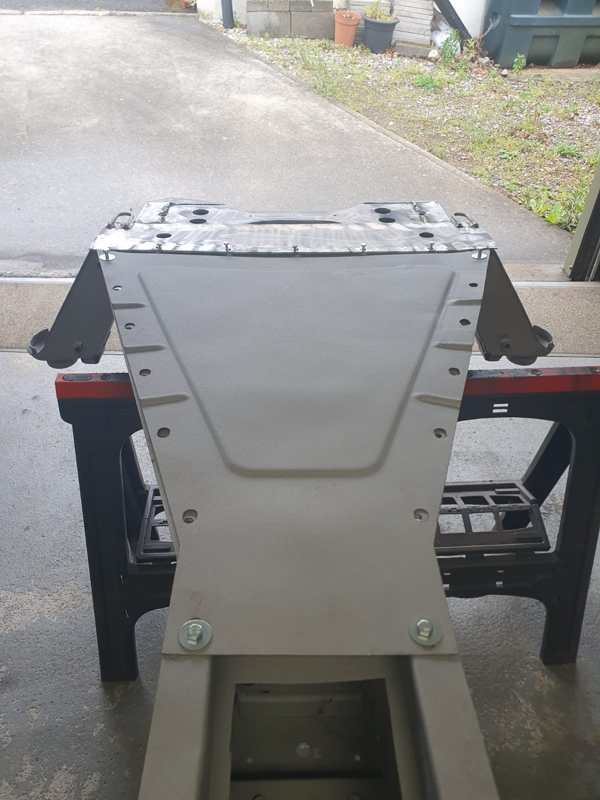

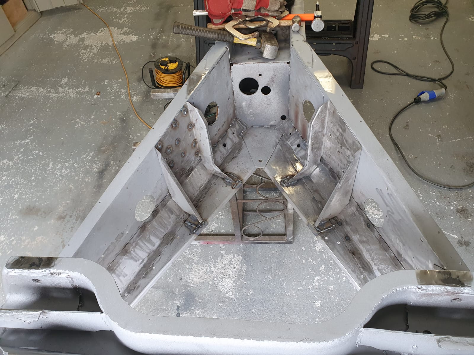

Postby cis6409 » Tue Jun 22, 2021 9:03 pm

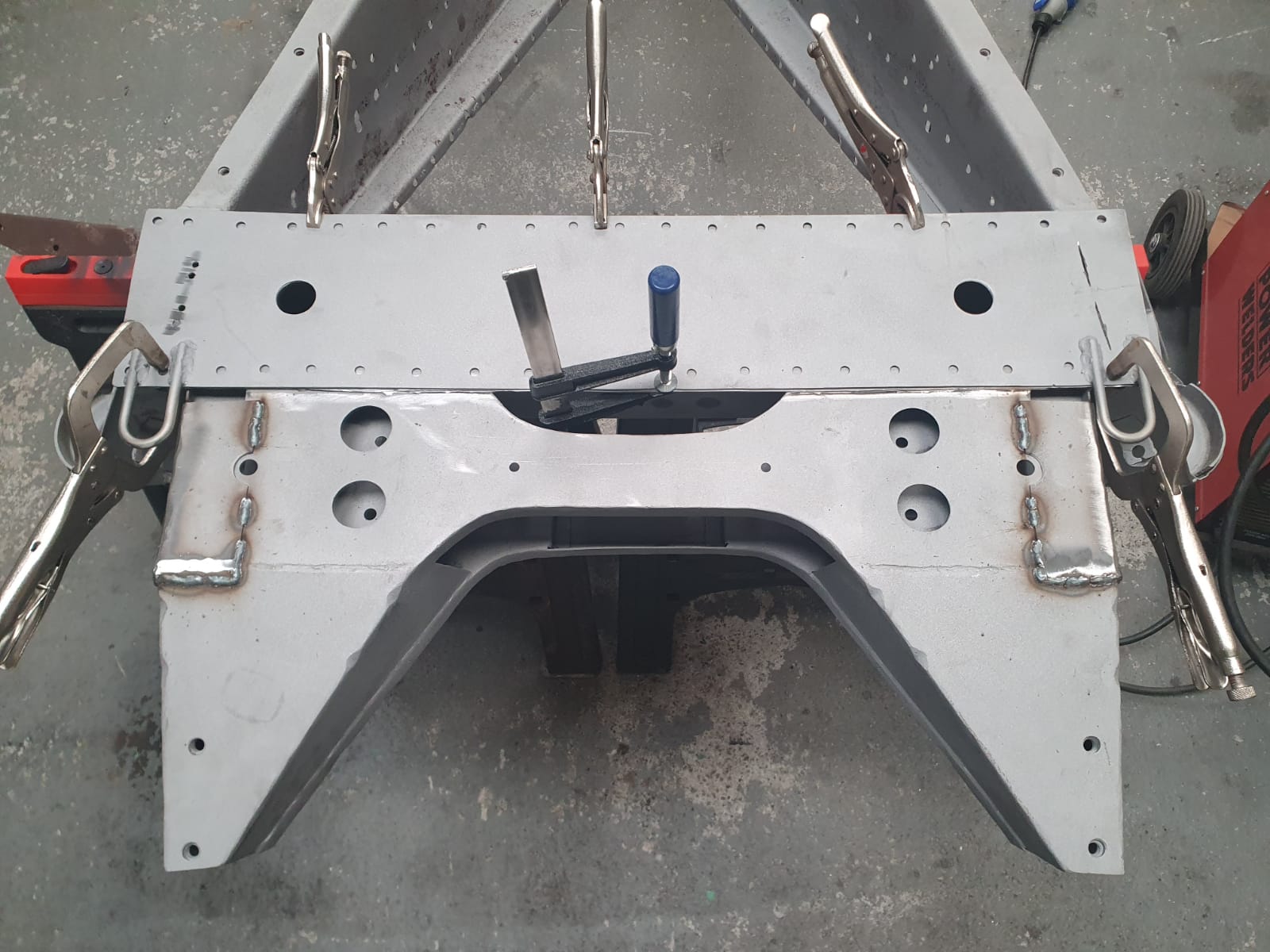

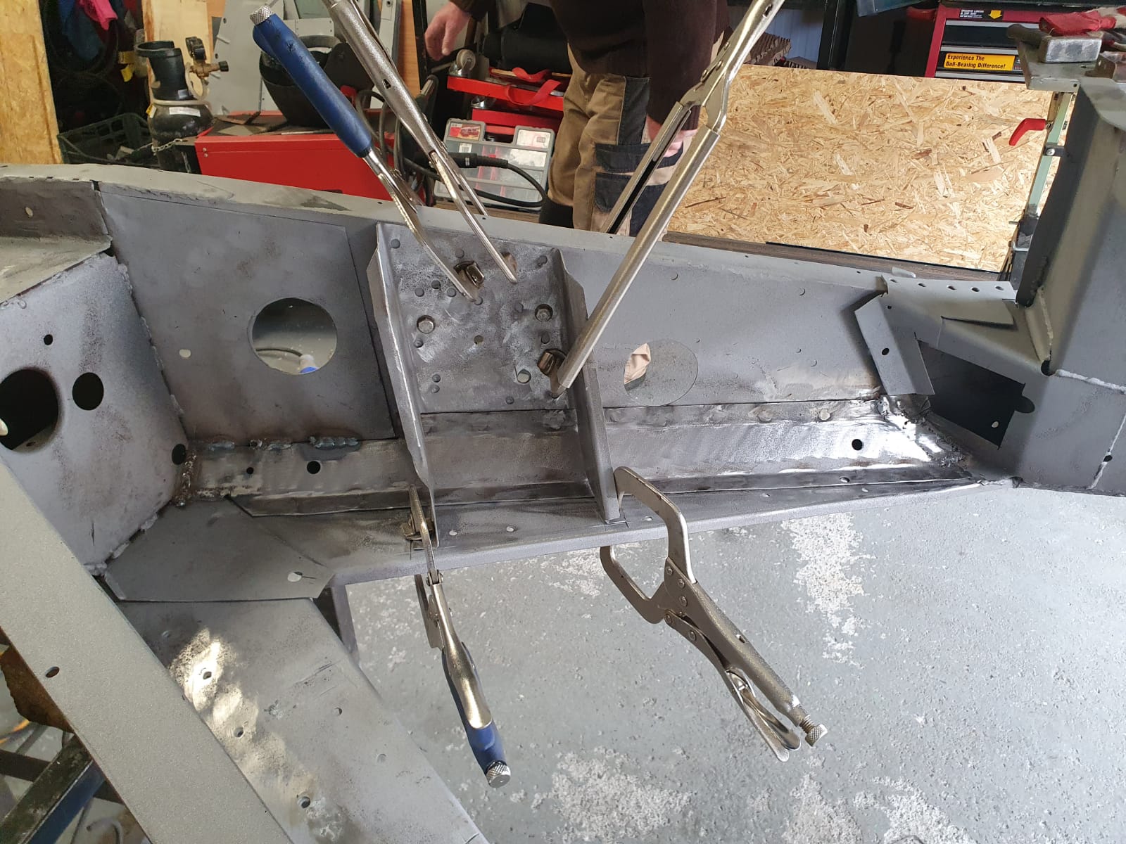

Front inner 'y' doubler plates back on

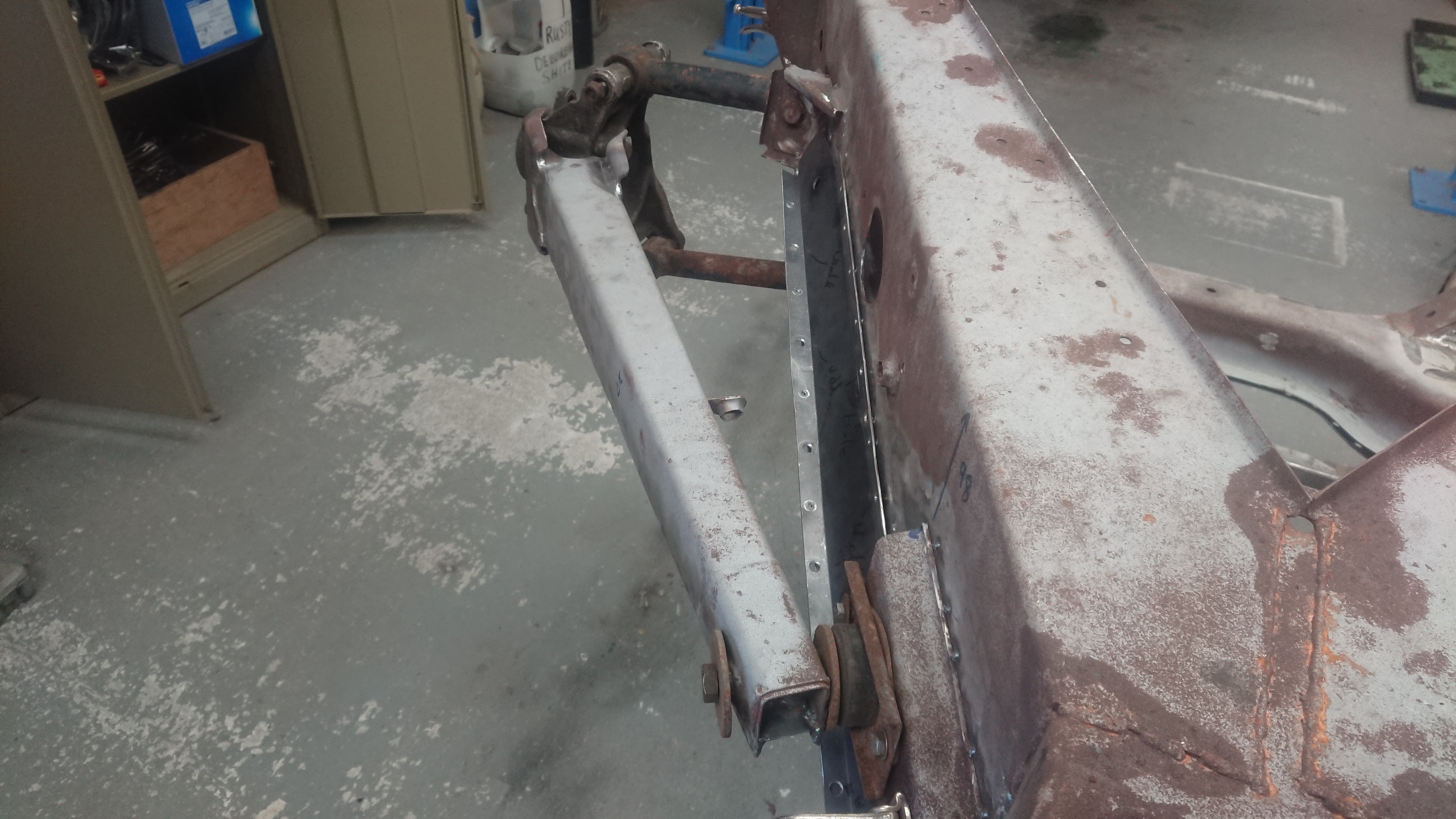

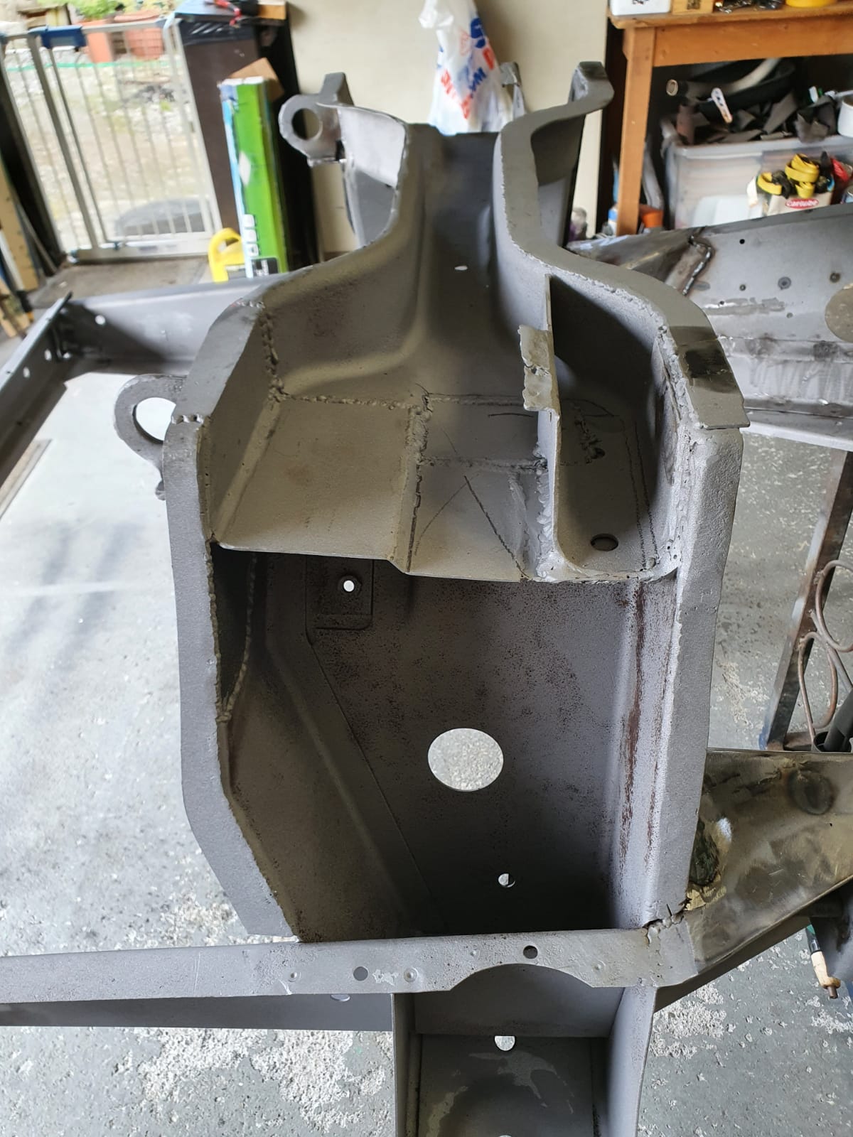

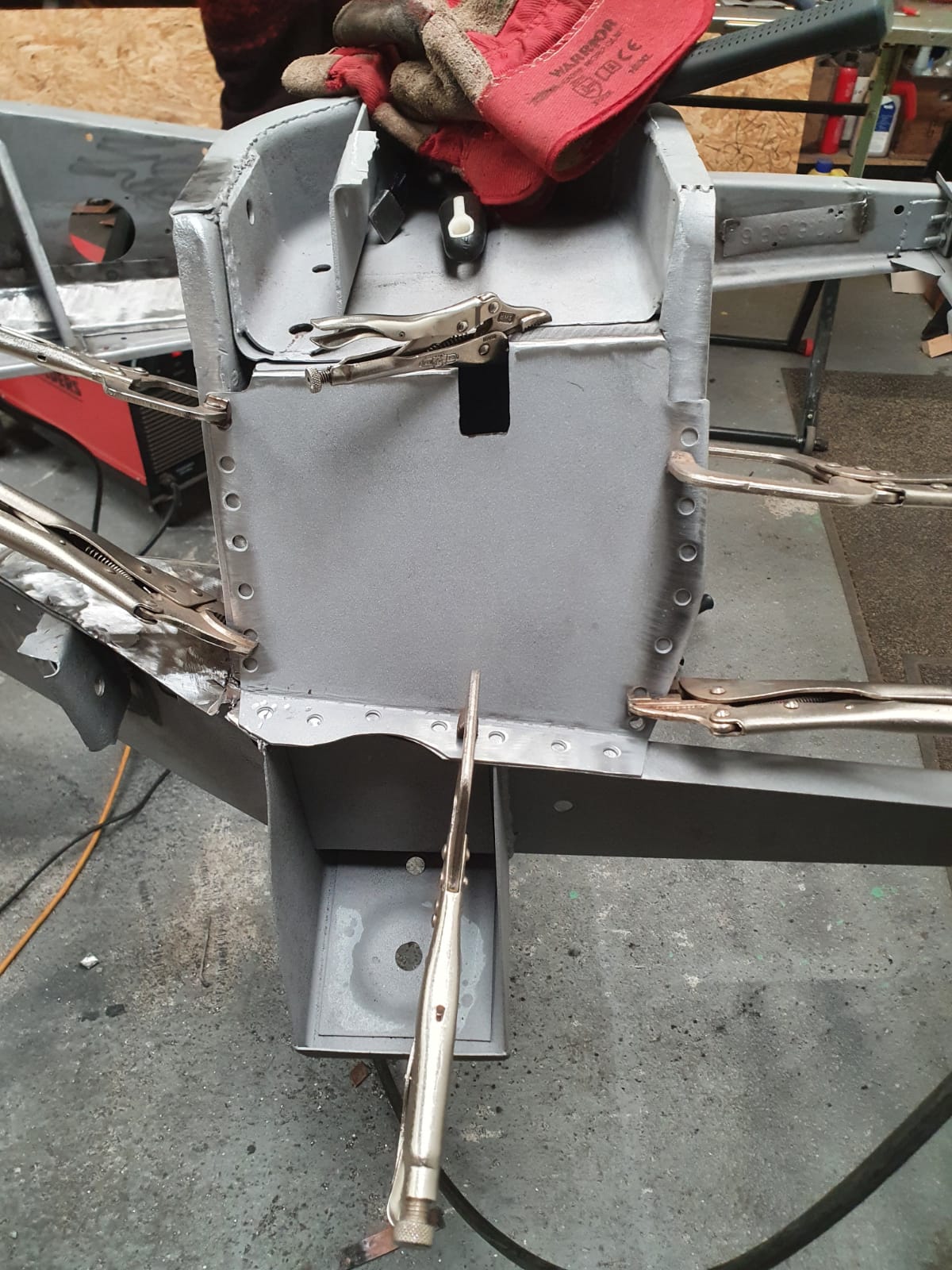

Postby cis6409 » Tue Jun 22, 2021 9:11 pm

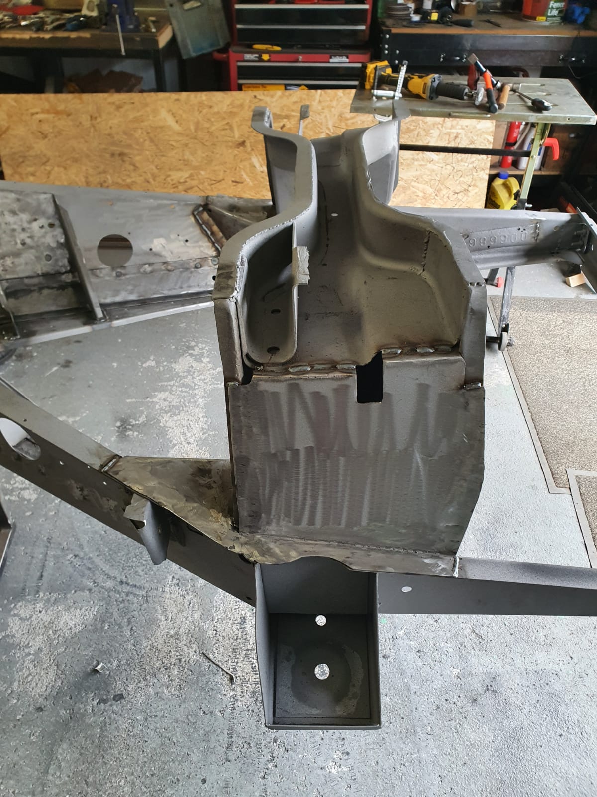

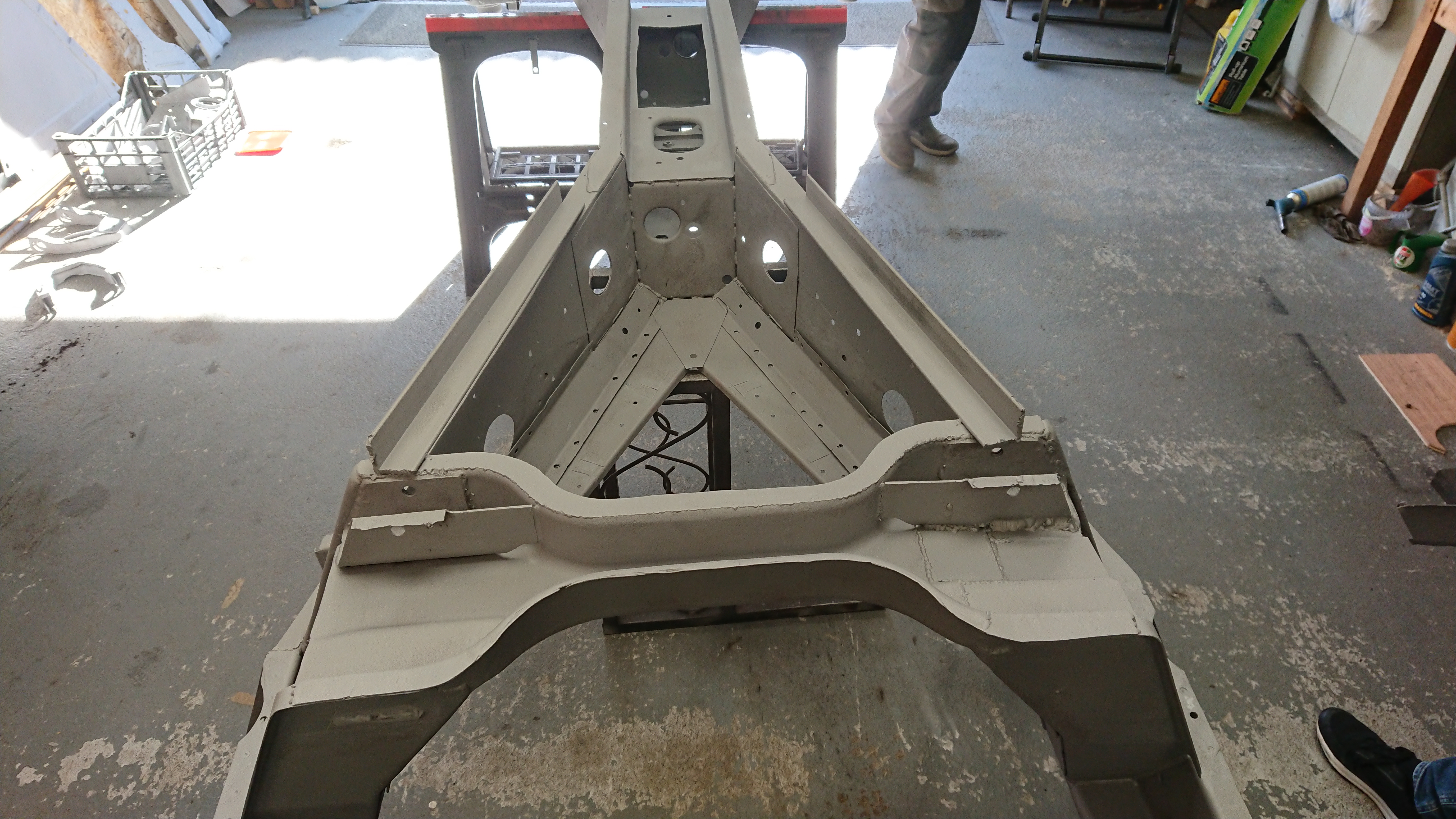

Rear inner 'y' doubler plate and gearbox support turrets in place

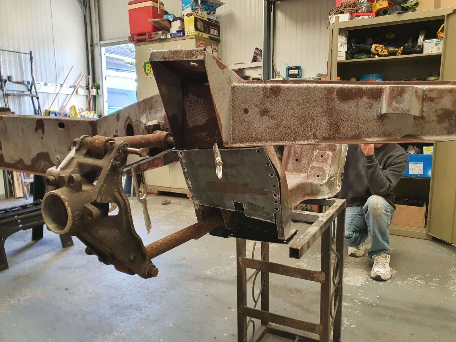

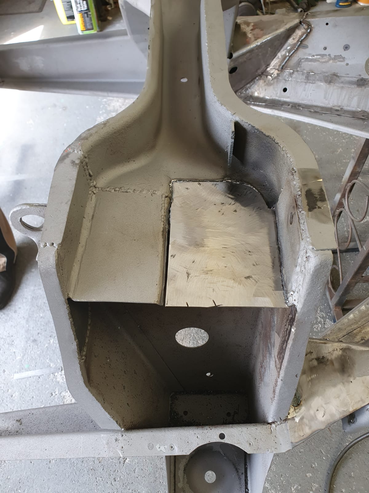

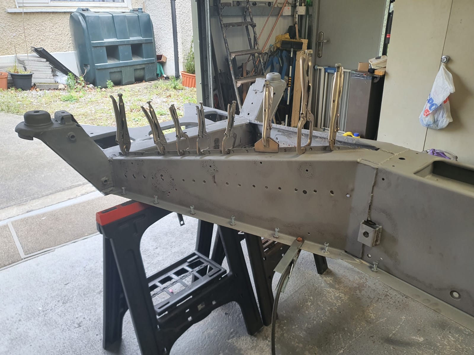

Postby cis6409 » Tue Jun 22, 2021 9:19 pm

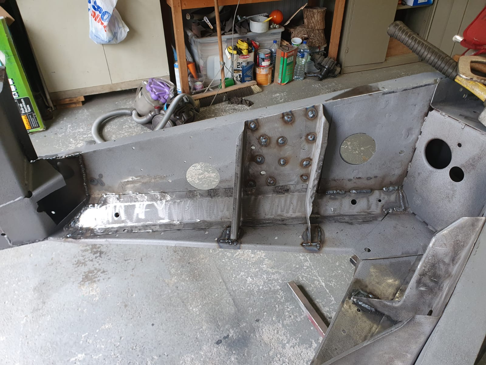

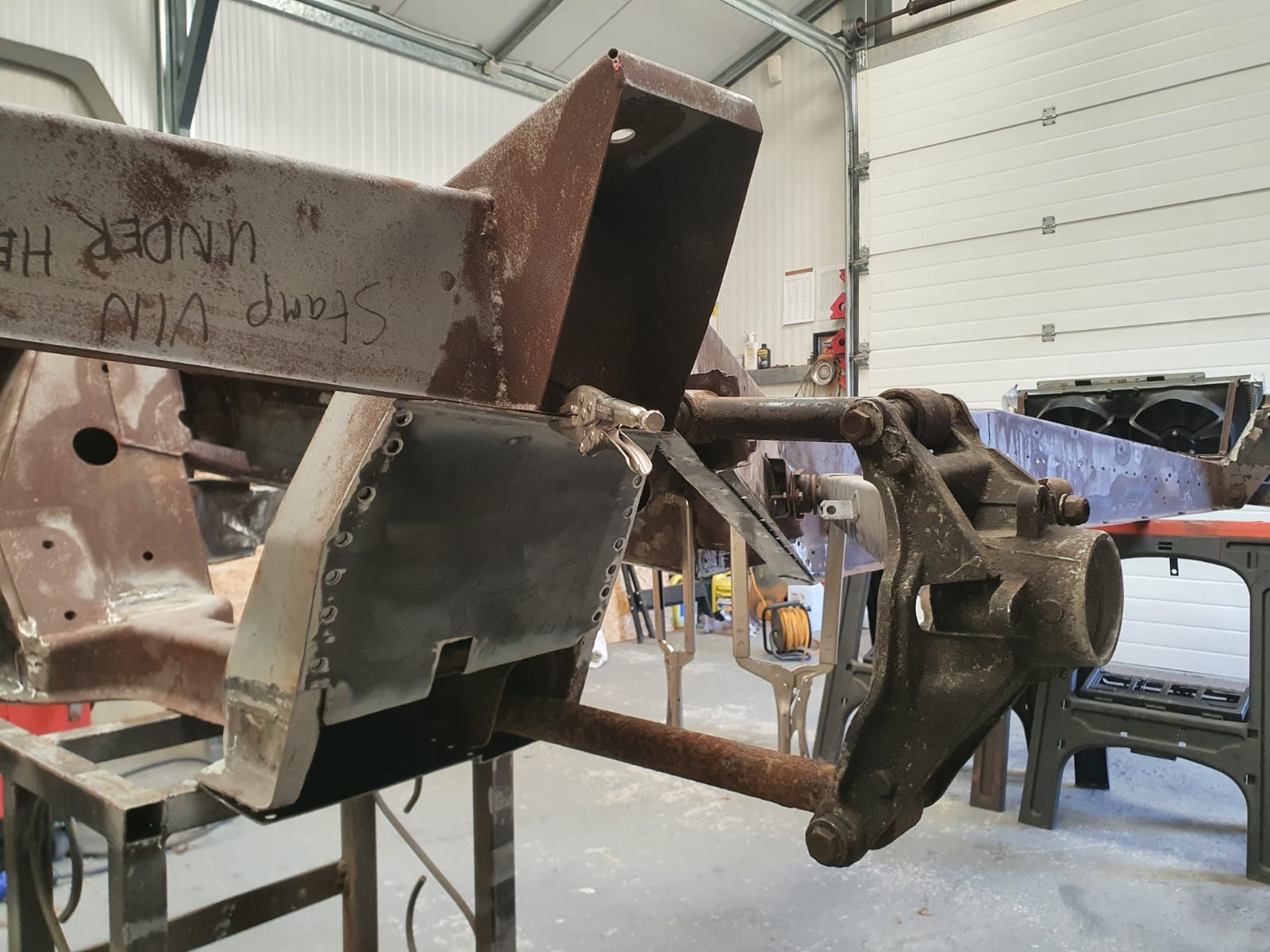

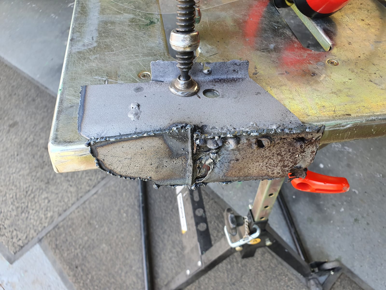

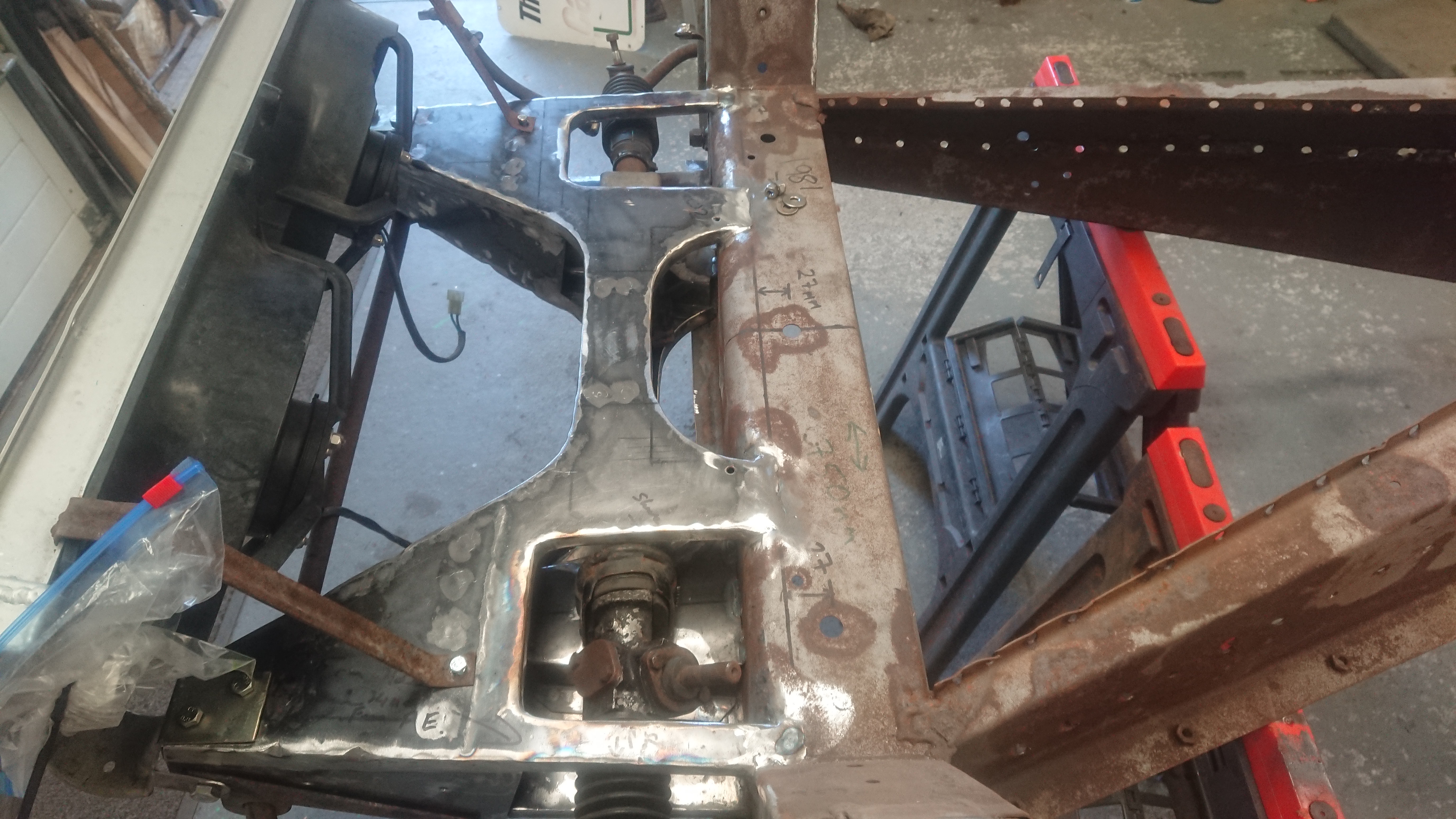

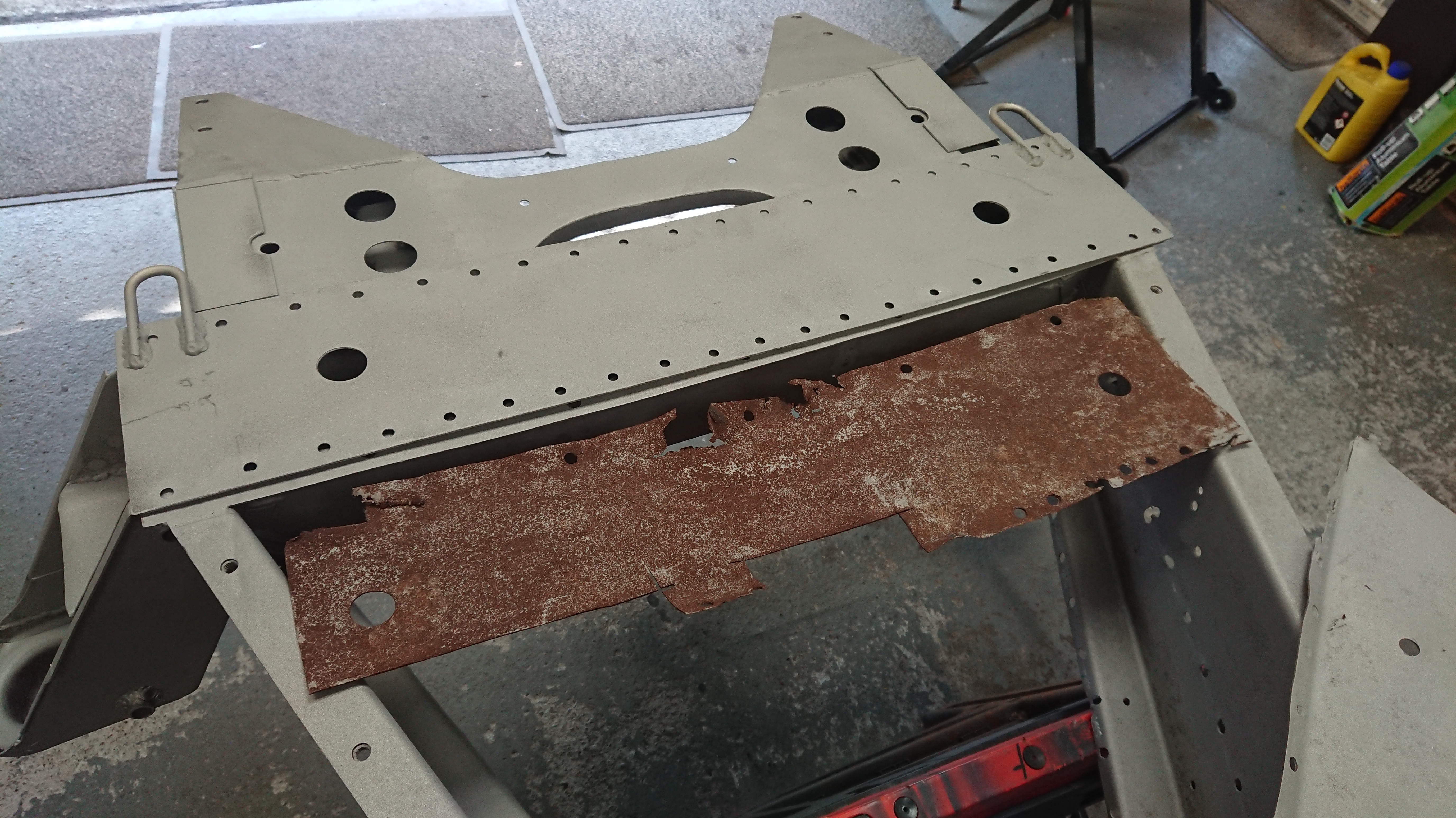

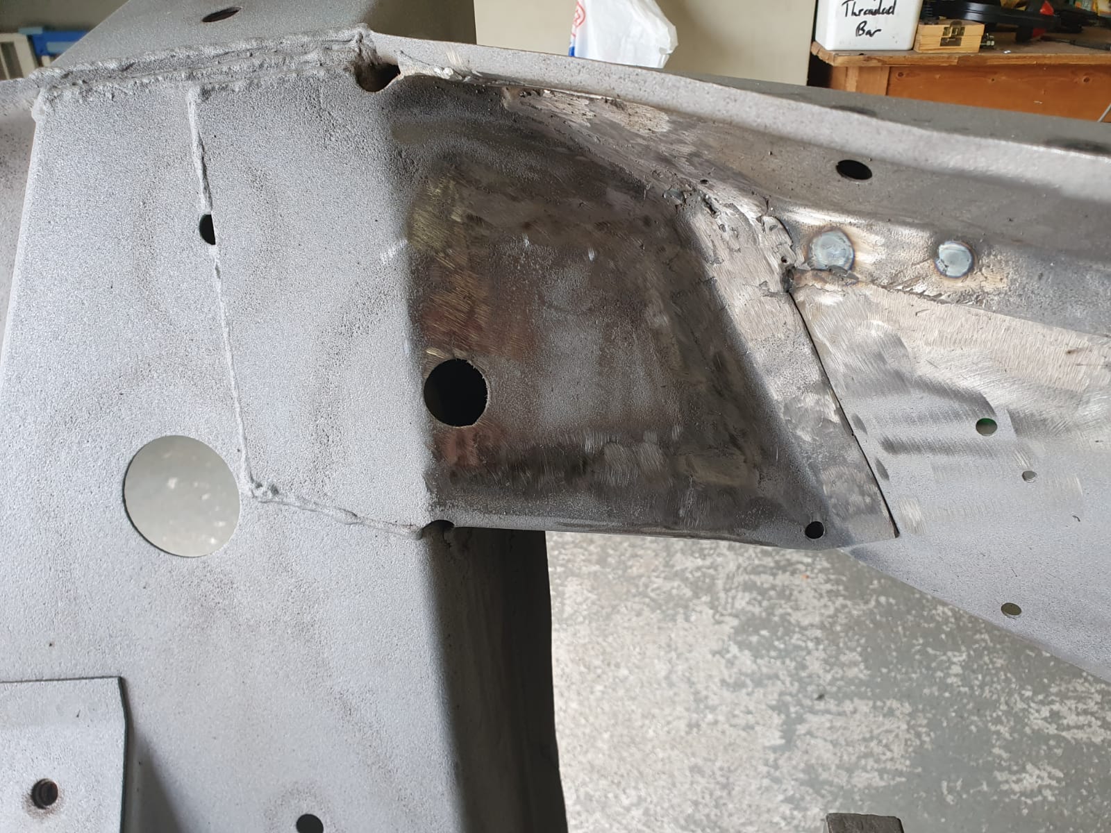

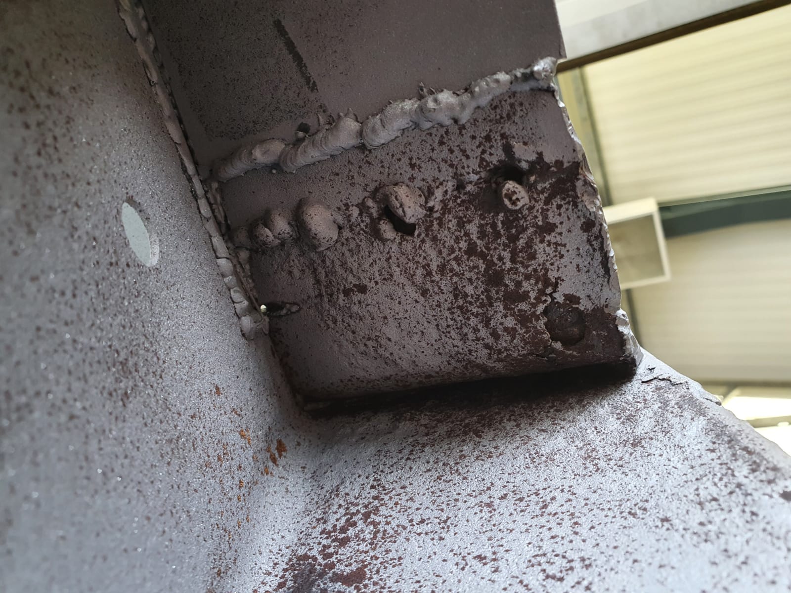

An eagle eye spot from Nicky saw an extra little spot of rust was hiding under the passenger side base of the rear cradle under the double lipped skin. A previous repair on a repair I think was done here but either way not very well. So off with it..
Forgot to take a pic of it fully finished before closing it up :doh:

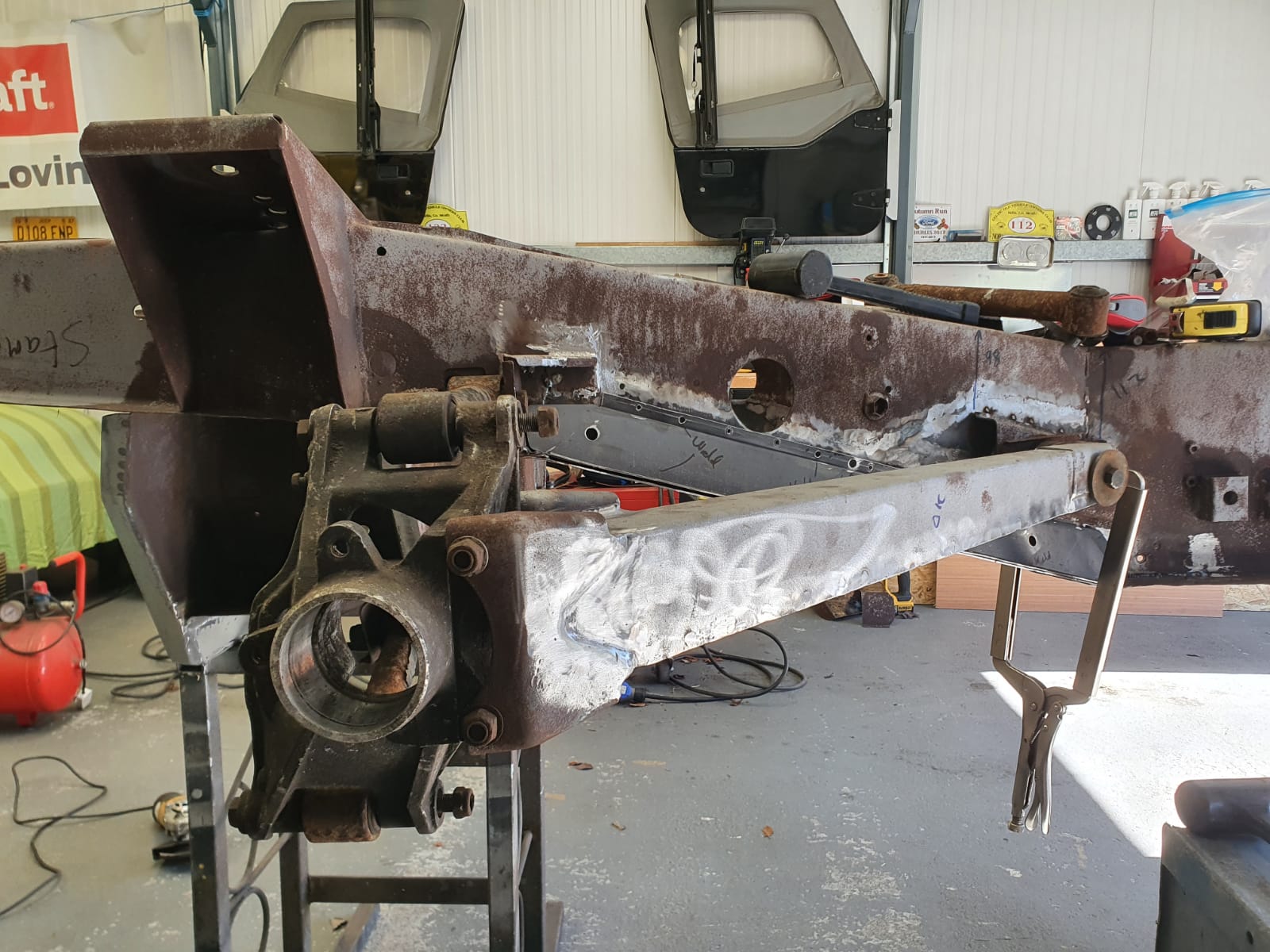

Postby cis6409 » Tue Jun 22, 2021 9:27 pm

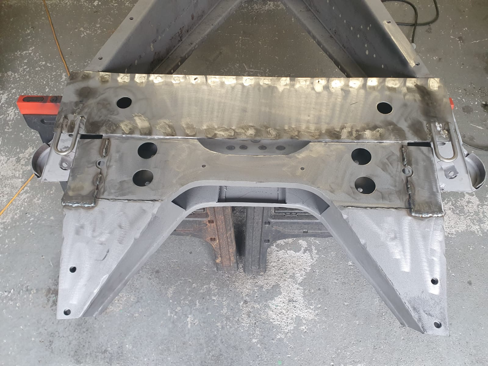

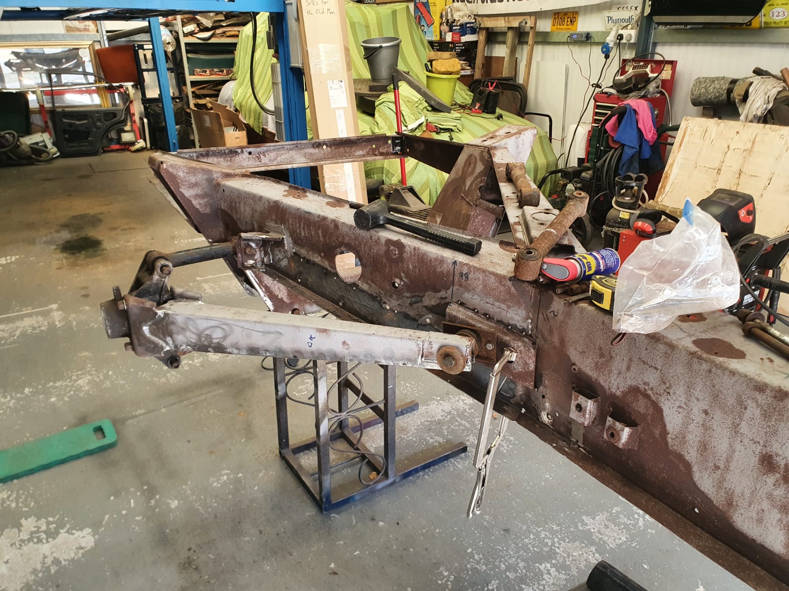

Side rear cradle plates and rear towing eyes back on
