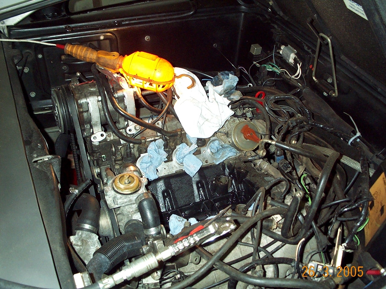

Postby RobvdVeer » Sat Jan 29, 2011 3:49 pm
More progress made. Today I removed the final bits of piping in the VOD without any issues. Bolts from the Y-pipe came out without any struggle whatsoever. Woohoo! No broken bolts! (I was scared about this quite a bit). Now that everything is loose I can start cleaning up.
Postby Admin-bloke » Sat Jan 29, 2011 7:16 pm
Nice one Rob.
Get that valley cleaned out and painted. I used cylinder black for air cooled bike engines.
