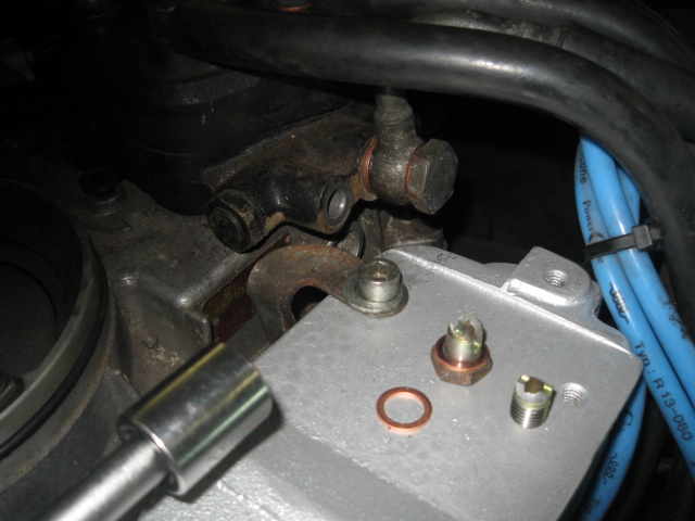

I just stopped trying to fit the fuel bolts back on. The last one snapped while twisting it in with my fingers. Looks like it was already very weak. I have not yet torqued these bolts down, just fingertight.
I was a big day, with a lot of work. I know I am really close to getting it running again, just need to charge the battery and get some replacement bolts for the fuel dizzy. I only need to go under the car once more to refit the tank plate and the rear bottom screens. Then 3695 can be lowered to its wheels for a first start in months.

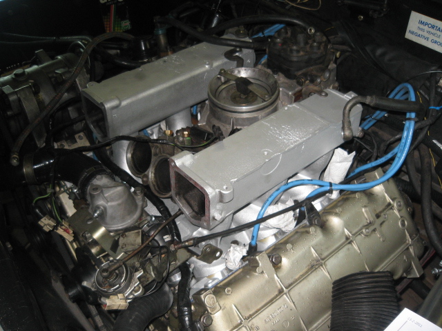

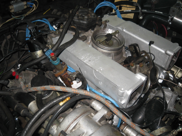

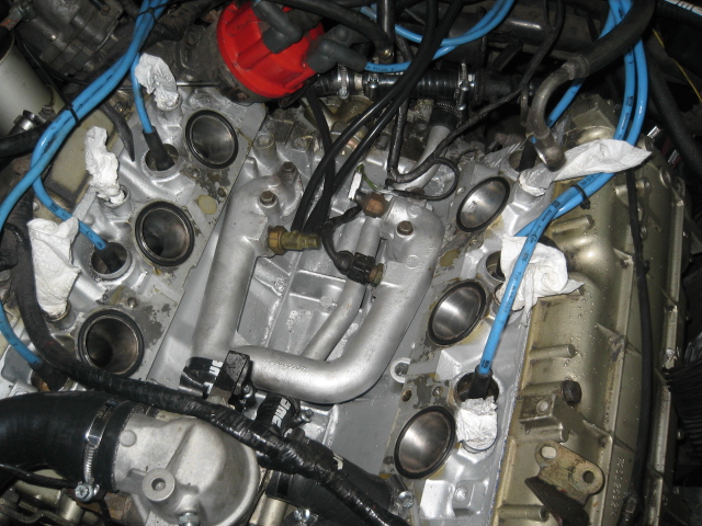

Postby RobvdVeer » Sun Feb 13, 2011 4:35 pm
Some pics:
Postby bozzzydmc » Sun Feb 13, 2011 4:42 pm
Hey rob ... Where is that grey hose with the orange stripes connected too ?
Mike
