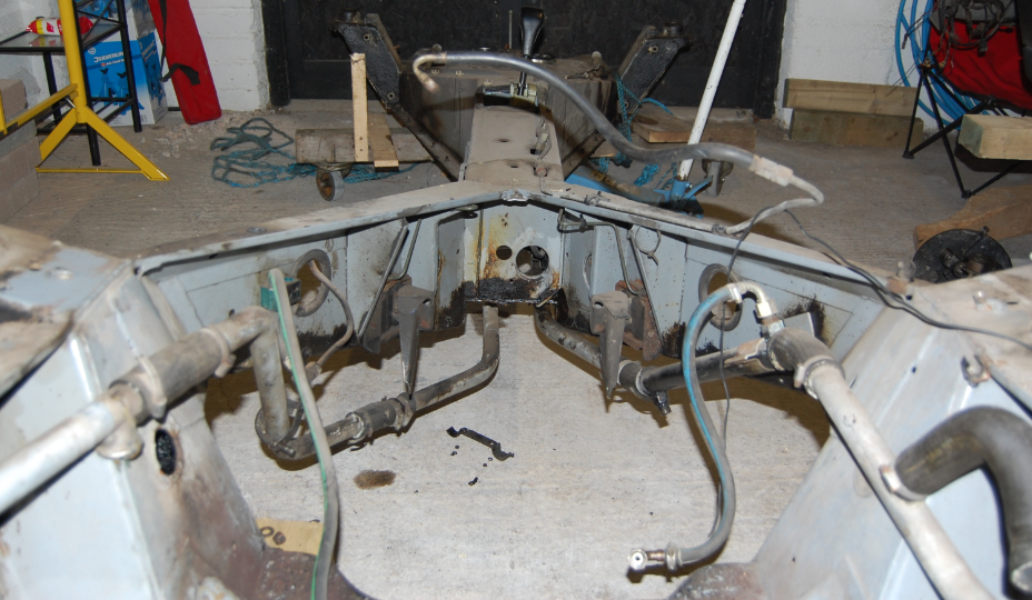

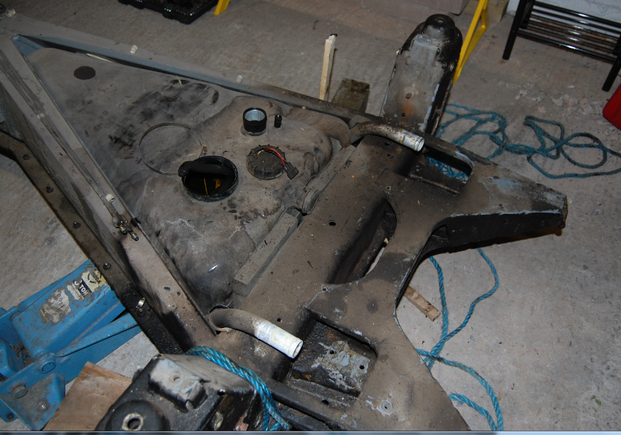

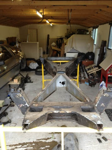

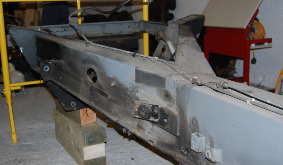

Hows the engine coming along Tony? Would love to see some pics if you have some?
Have a few pictures of the chassis being stripped yesterday and then it has been finished today but only one pic from today.
Trying to find a company round here that can deal with either blasting or acid dipping such a long chassis as the few i've contacted so far can't.

Postby mec » Thu May 31, 2012 11:11 pm
looks in a bloody site better shape than mine ! :shock:
