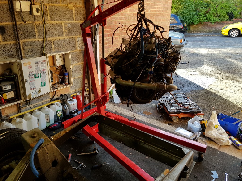

It begins (spot any issues)?
First lift failed as I had the flaming Leveller on side to side so it would let me jiggle it not tip it.... LOL live and learn.
I popped the W PIPE off as I wasn't happy with the weight getting put on it.
Up she comes
Double check all ok
Tada !
All in all a piece of cake, so much easier with no body to worry about bashing. When the transmission came out it swung a little and brushed the chassis. No biggie but I thought ouch that would have been a rear window gone or scratched stainless if the rest of the car was there.
One of the engine mounts was a bit stubborn whilst been loose it wouldn't release for a while but in the end it came.
I would highly recommend not splitting the transmission it was so much easier and I look forward to putting it back in.
