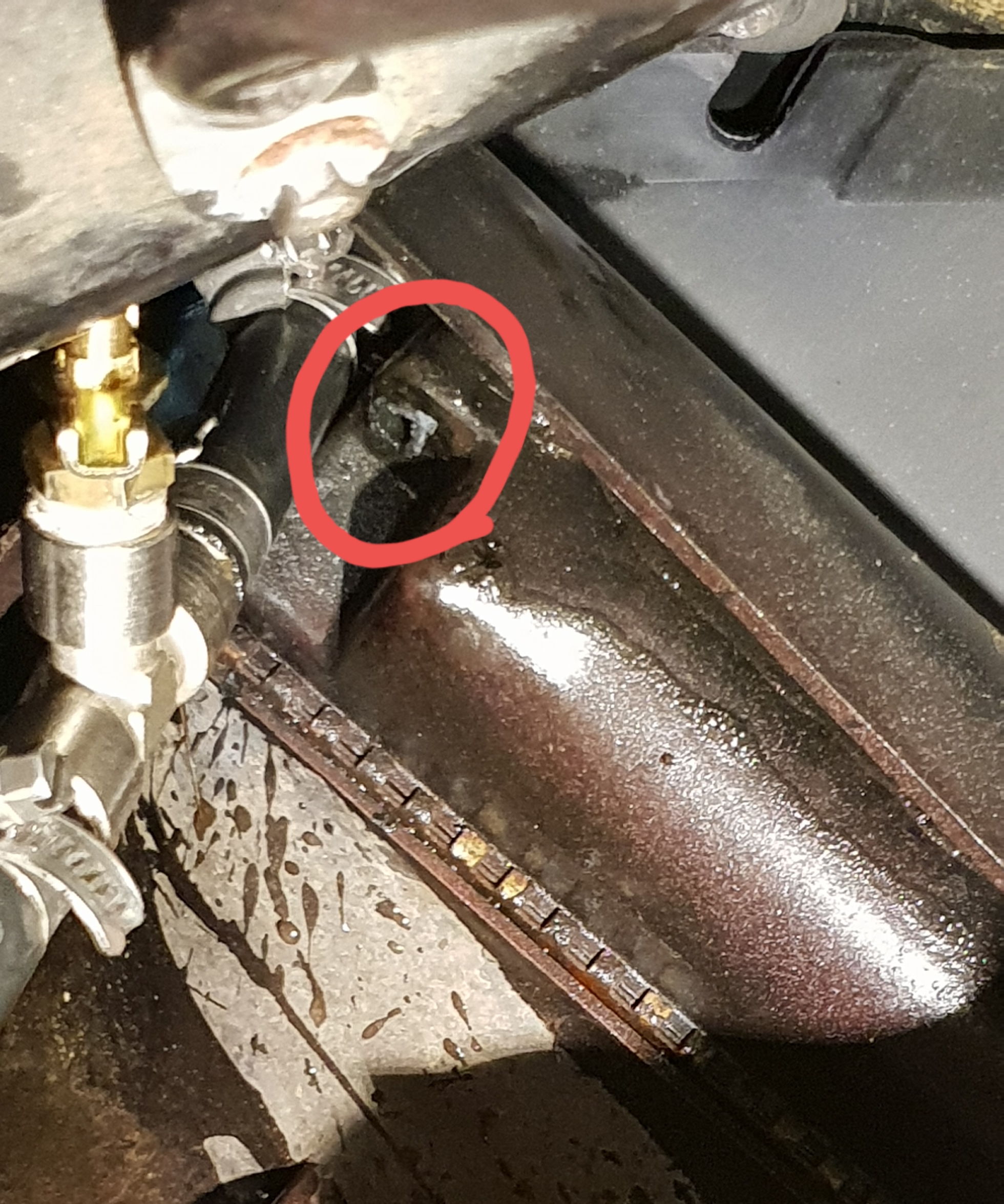

Crap! #@%@€$¥#¥$&#*@^$&#!!!

oooo whats that ??
Re: Vin 5063
Postby cis6409 » Mon Dec 10, 2018 11:18 pm
Is that a hole in the rad!?Ouch.. how did That happen?

So much for fitting the "little bleeder" !!!!
Will you get a new style rad?
I will have a spare original rad soon - I have the new one ready to fit in - I'm just using the old one to get the car up n running.
Get a new one - they are supposed to be more efficient?

Postby mec » Tue Dec 11, 2018 10:36 am
Ive got a 3 core ally one in my car, they are very good !

In the process of replacing that little hose, I broke the plastic fitting on the radiator. I did add a little bleeder valve, but the hose had to be replaced anyway.
I'll drop the rad pack, it gives me a great opportunity to check the fans too. I can not imagine that they work.

Postby Spudmurphy » Wed Dec 12, 2018 8:31 am
When I removed my hose I used some heat from a hot air gun - it helped - but this is of no use to you now - maybe a useful tip for anybody contemplating removing this hose?
Some wd40 may help a bit too.

Postby mec » Wed Dec 12, 2018 11:54 am
I know this is no use to you now but for others in future if there is enough length in the hose, it may be worth sacrificing the end of it and cut a slit up the side so it relives the pressure off the fitting, once its off then then cut the end off to create a fresh end to re attach later, just a thought
