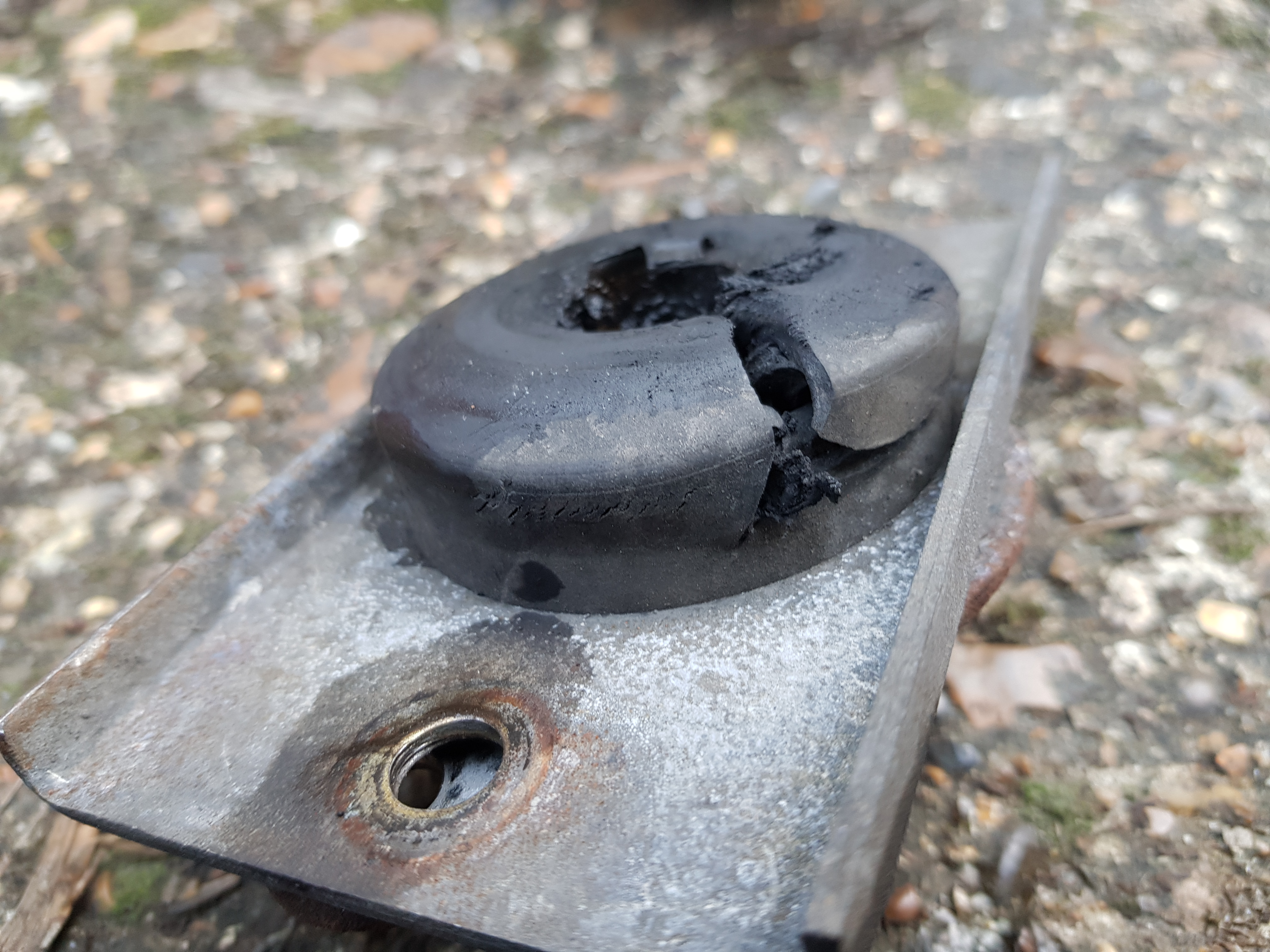

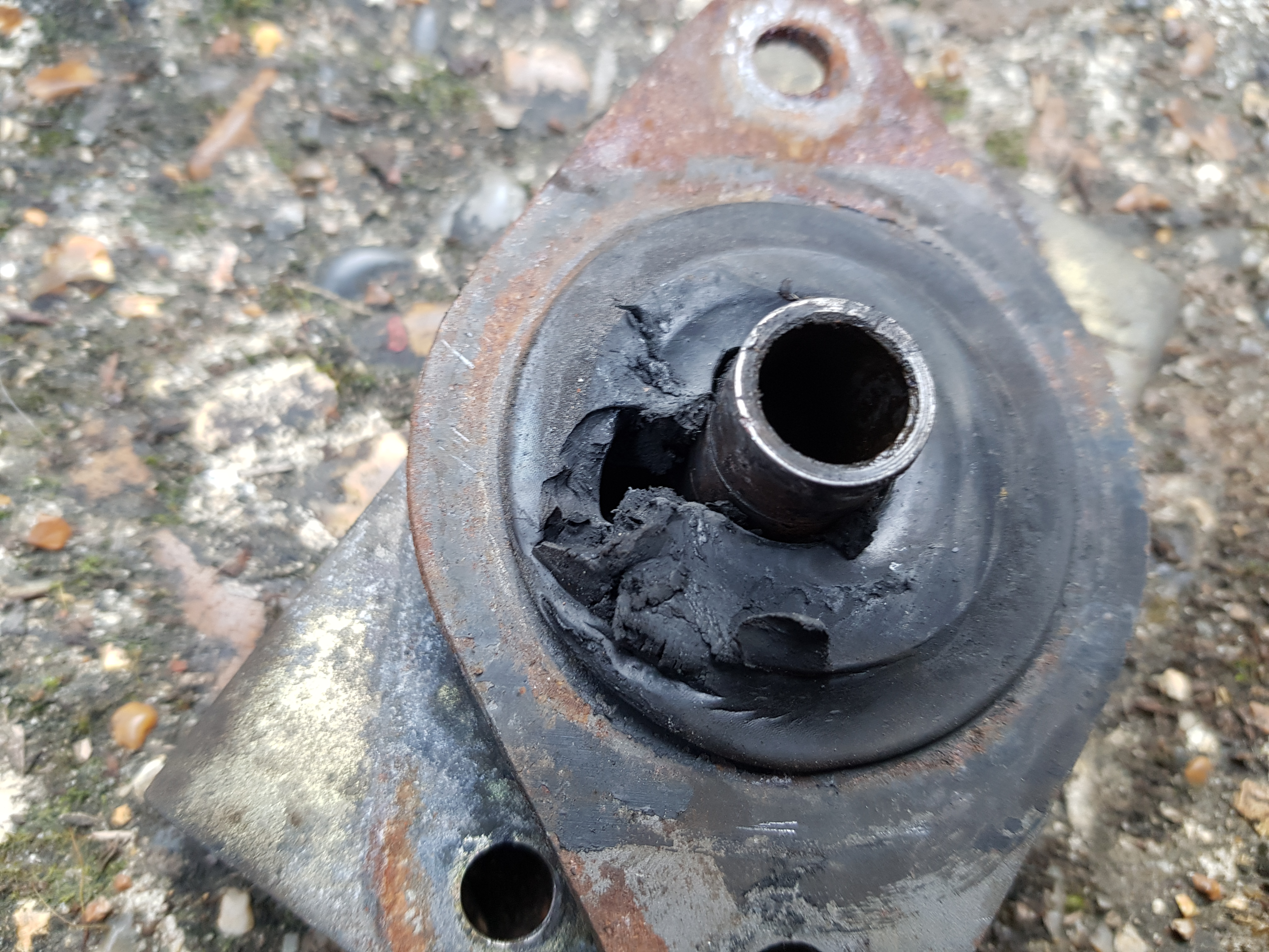

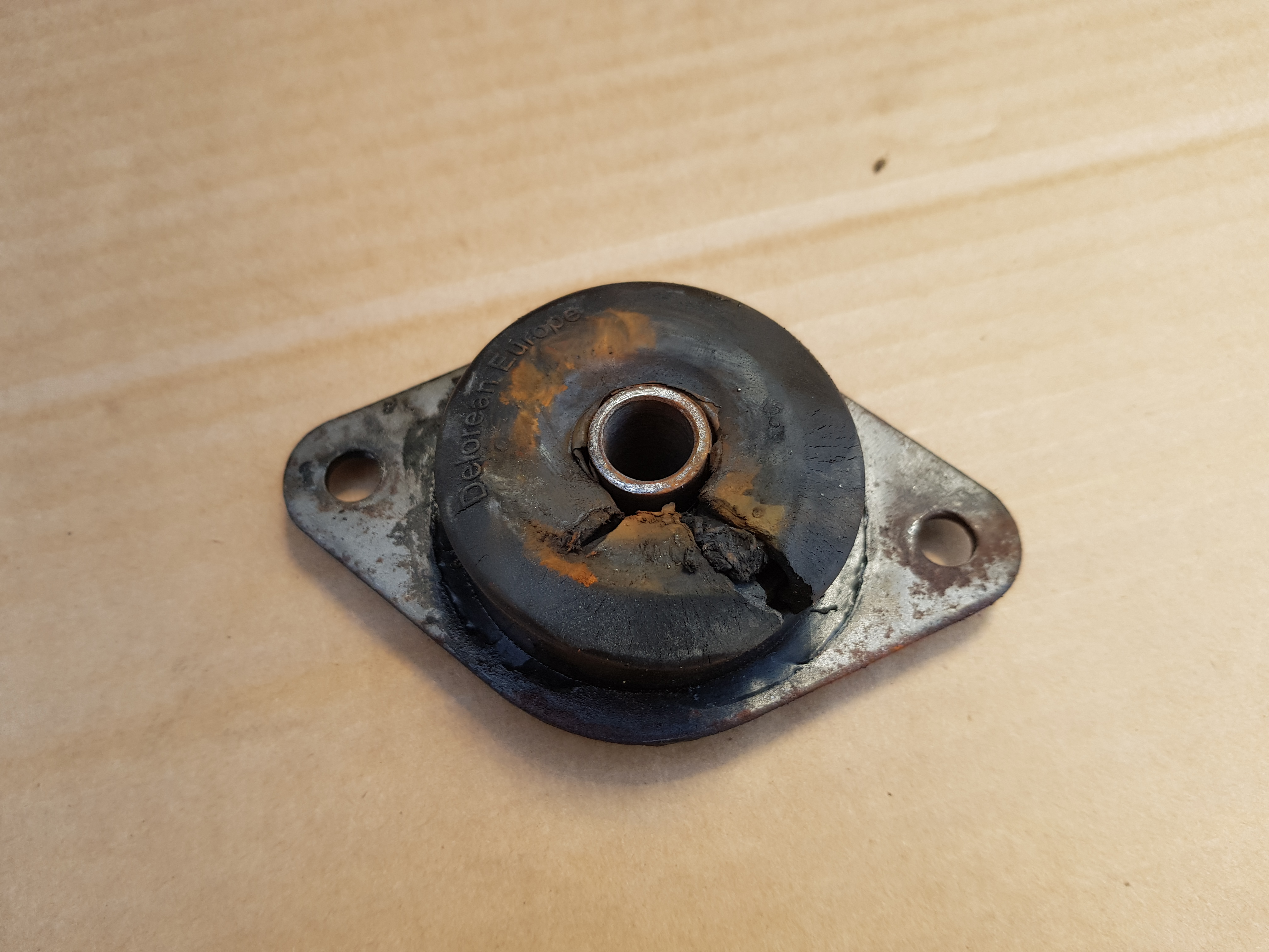

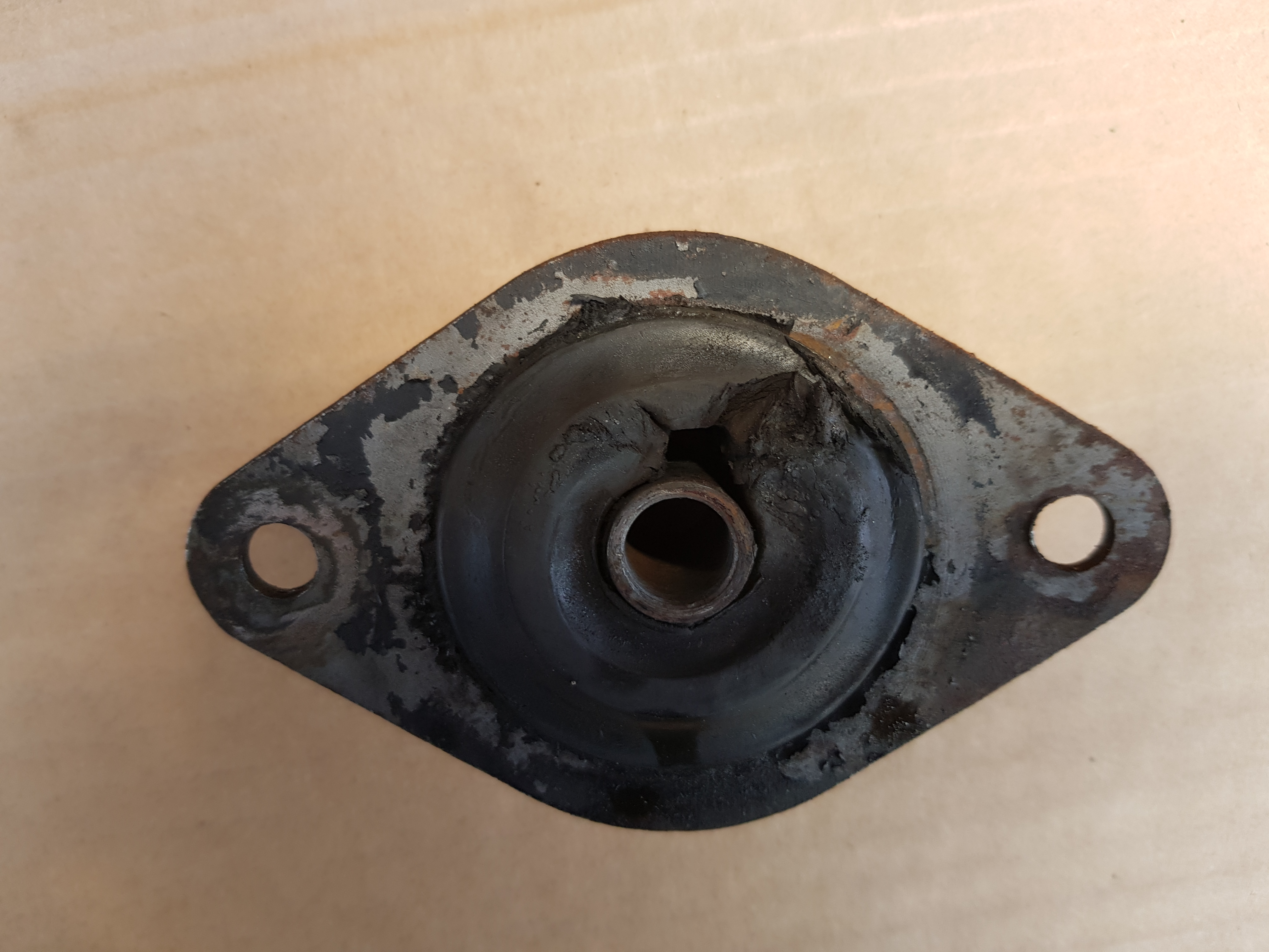

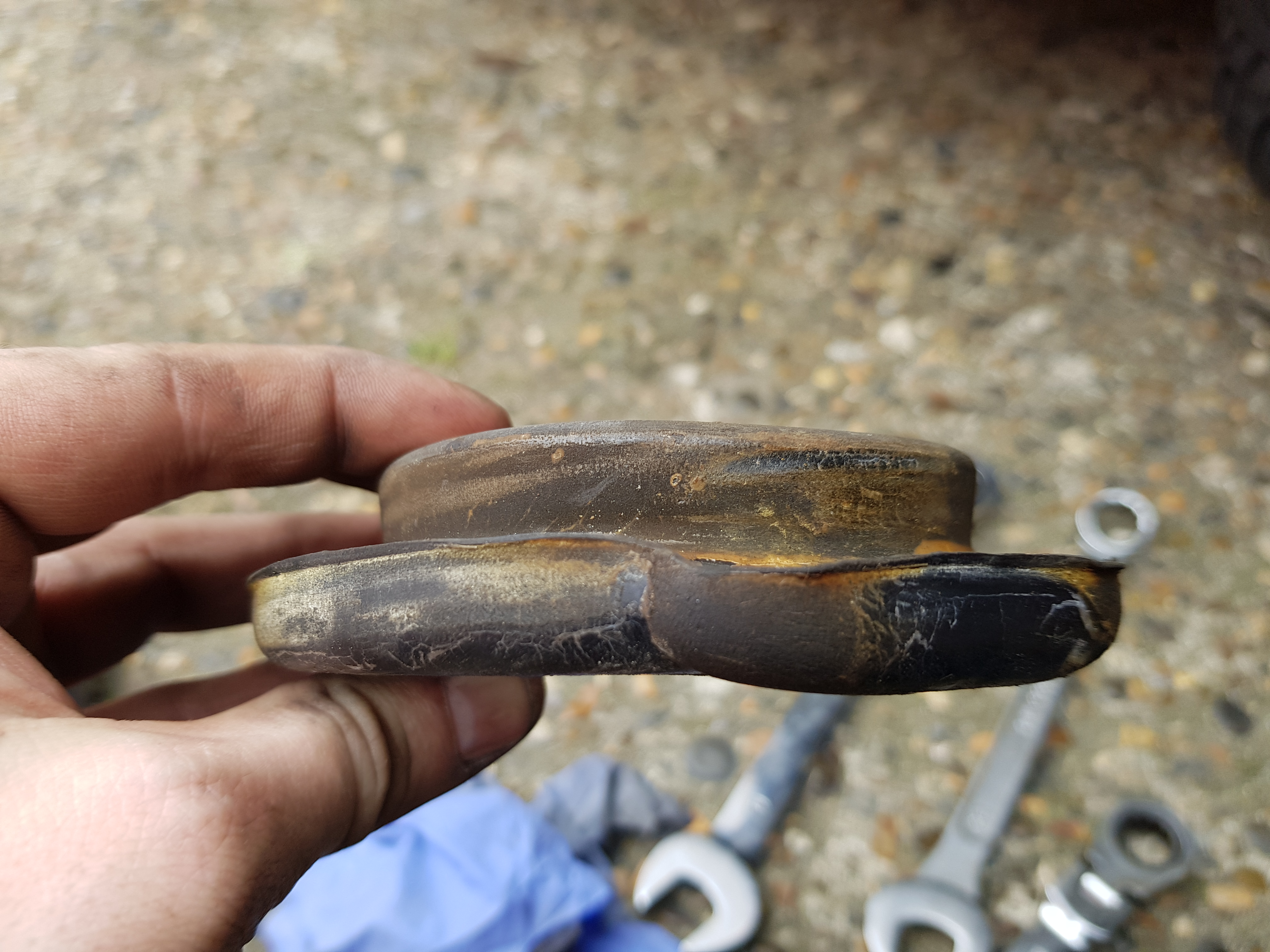

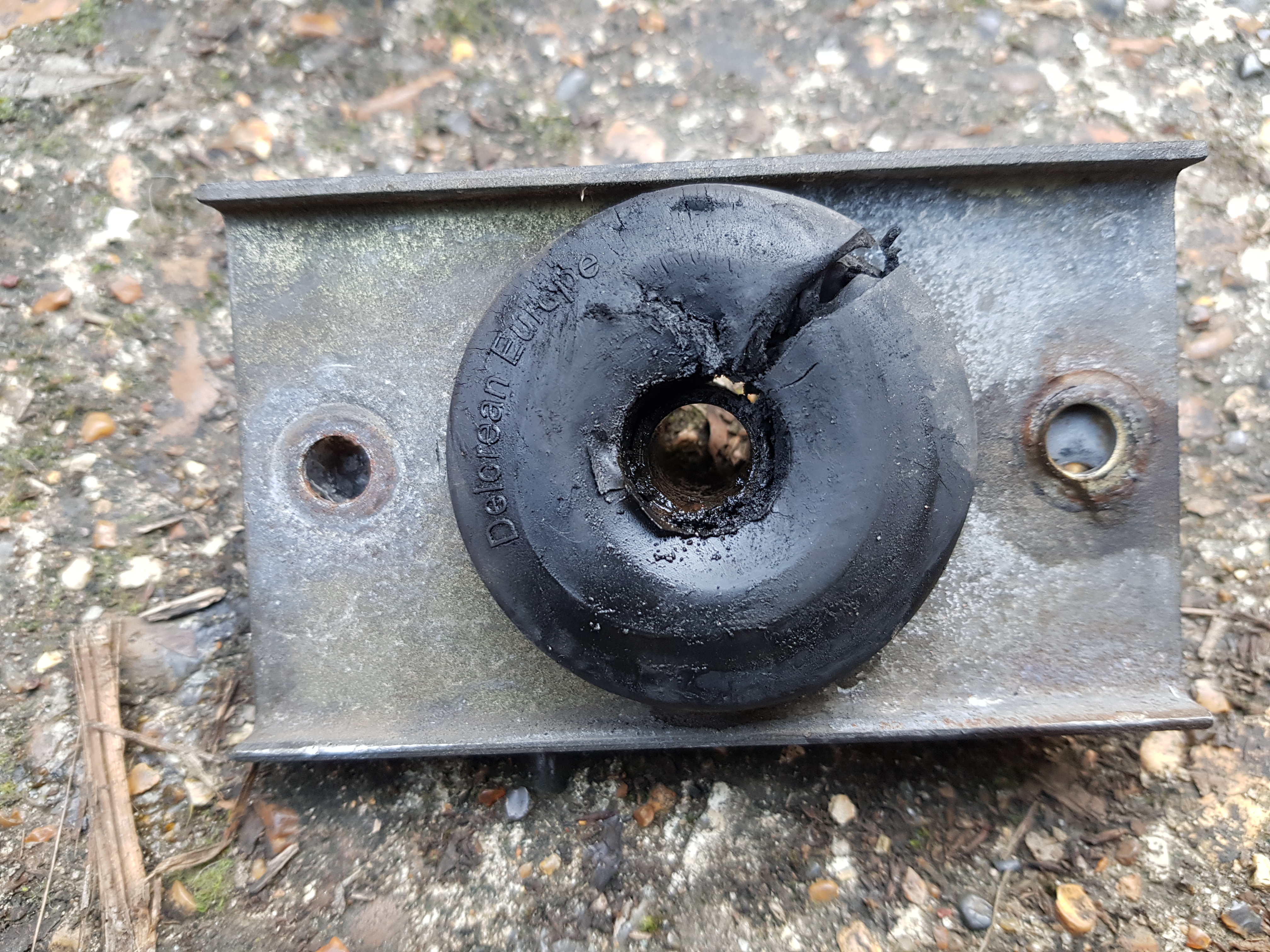

Firstly as some are aware, I had the delorean europe radius bushes fail on me. I would advise anyone who have these to check them. This is what I pulled from my car...
Drivers side
Passenger side
:shock: :shock: :shock: :shock: :shock: :shock:
These have now been swapped for NOS ones which Ive been told hold up rather well. Ive also opted for the Inconel bolts too. Rear end feels much more stable now.

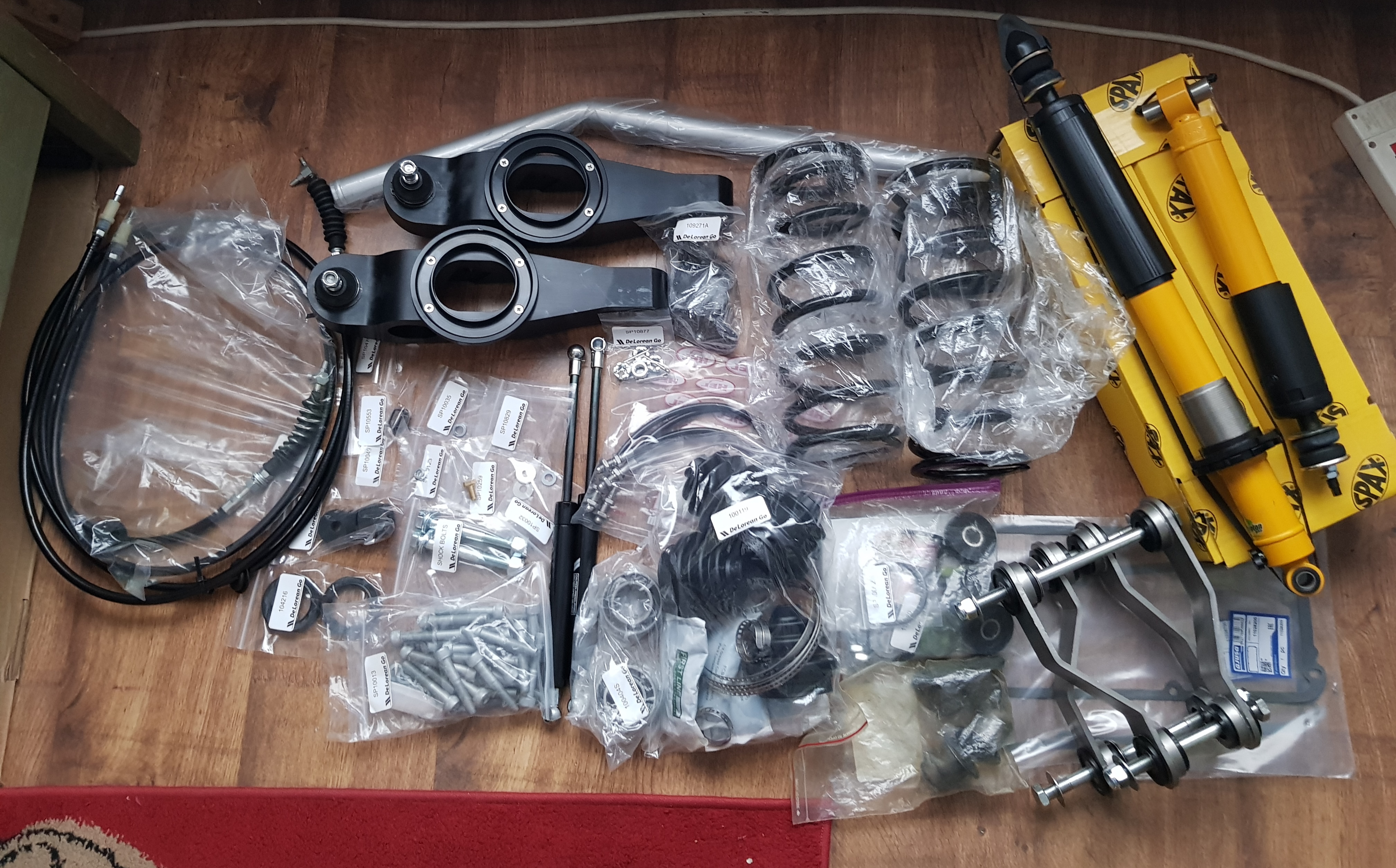

I now have everything I need to start work on the front suspension area.
- Lowered springs
- Ali LCAs with british LBJs
- LCA support brackets
- :spax: shocks
- Poly bushes for the sway bar
- British upper ball joints
- Hub bearings
- NOS upper control bushes
Basically the works.
I also have por15 grey paint and prep to touch up a few little areas here and there.
Kinda feel like a parts shop

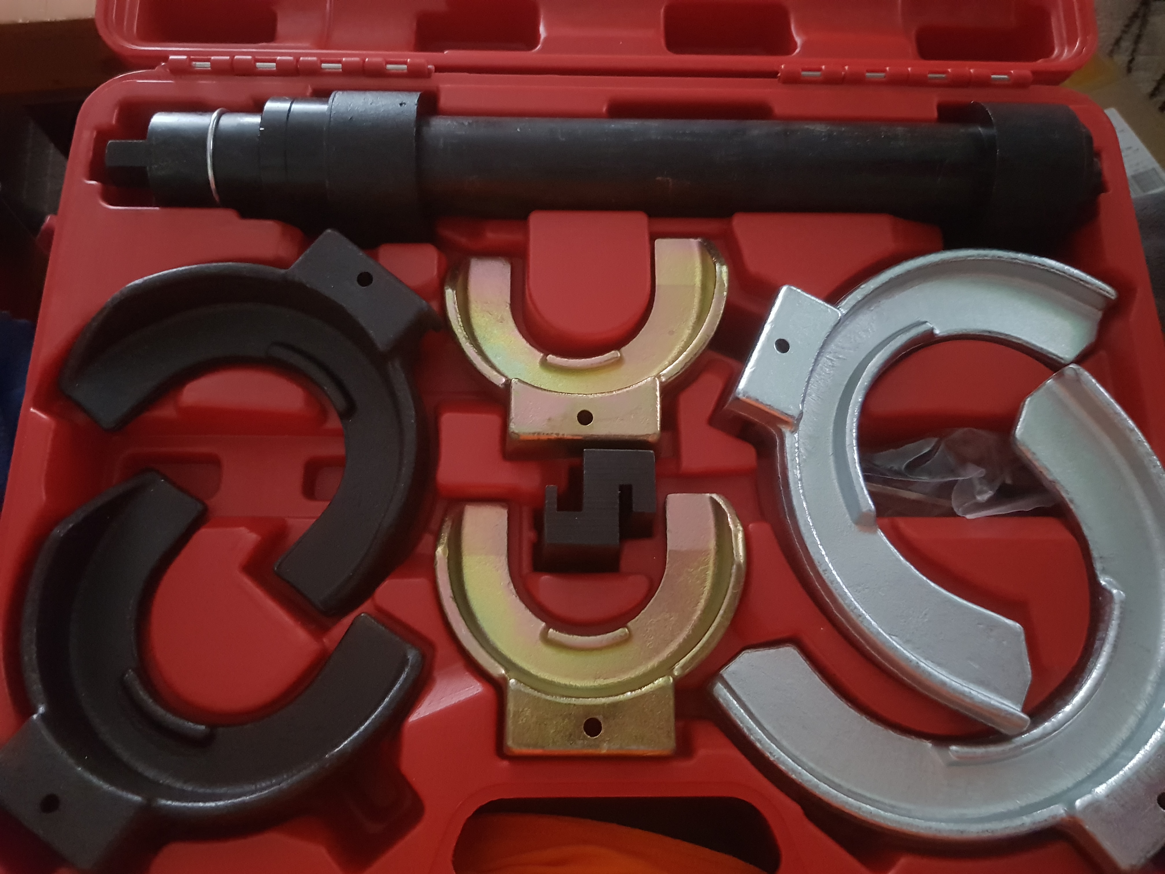

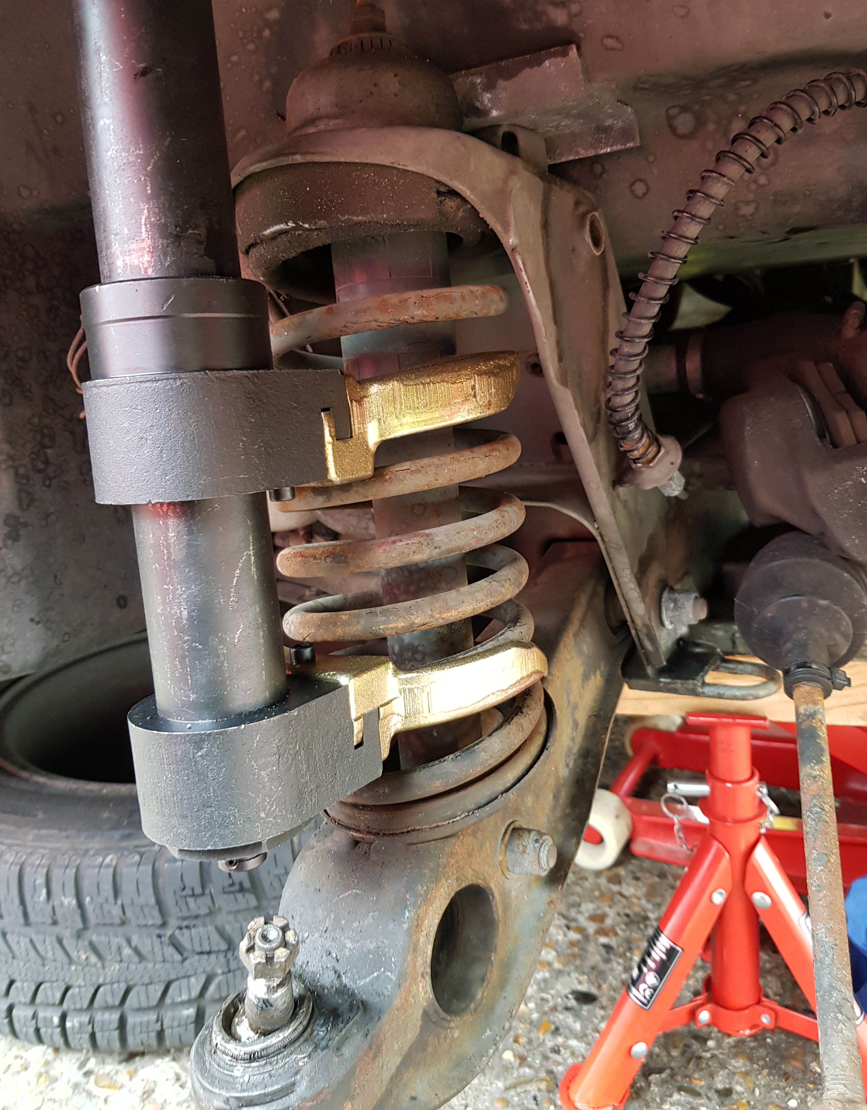

To compress the springs, Ive gone for these as they seem to be the safest to use...

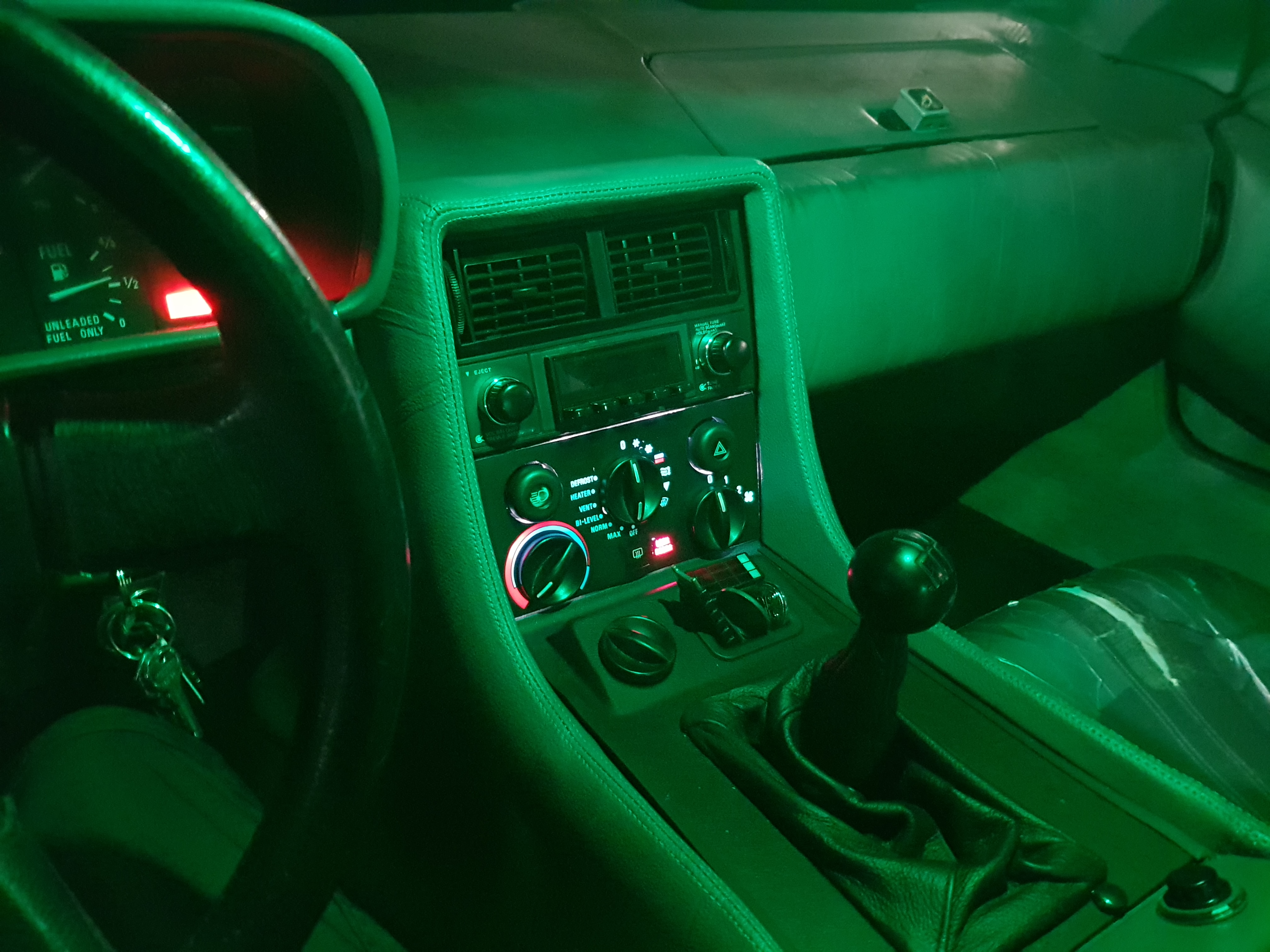

The headliners are now back in the car finally and I opted for green interior dome lights. I may add footwell lighting at some point but wont be soon...

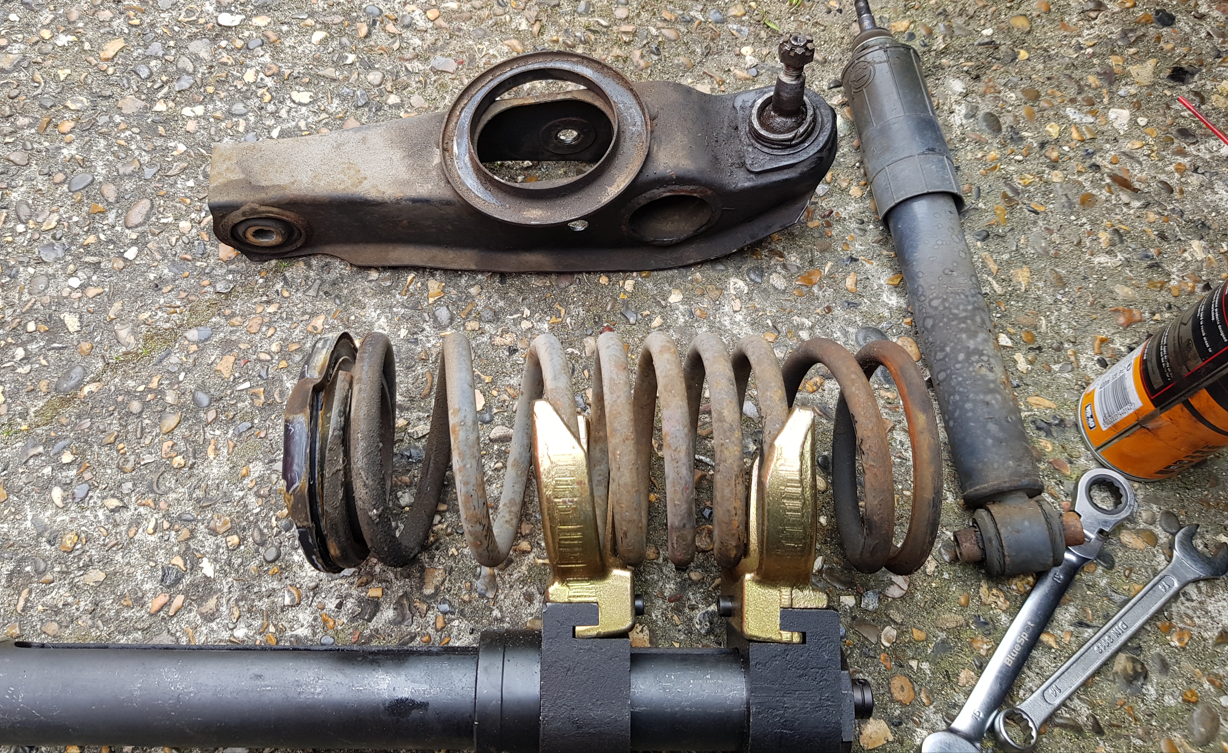

Postby Dan 6511 » Thu Mar 04, 2021 11:11 pm
Honestly the springs aren't as bad as they are made out to be. I took mine out without spring compressors at all. I pulled the lower arm out of the chassis with the spring and shock still in place. (The spring can't go anywhere with the shock still in place) Then turned the arm 90 degrees so its clear of the chassis - brute force needed here. Then jack up the underneath of the arm to compress the spring a bit and take the tension off the shock fittings. Then you can unbolt the shock. Then lower your jack down slowly and the spring will gradually extend until its no longer compressed and you can just lift it all out :thumbsup:

Postby DMC1983 » Mon Mar 08, 2021 6:08 pm

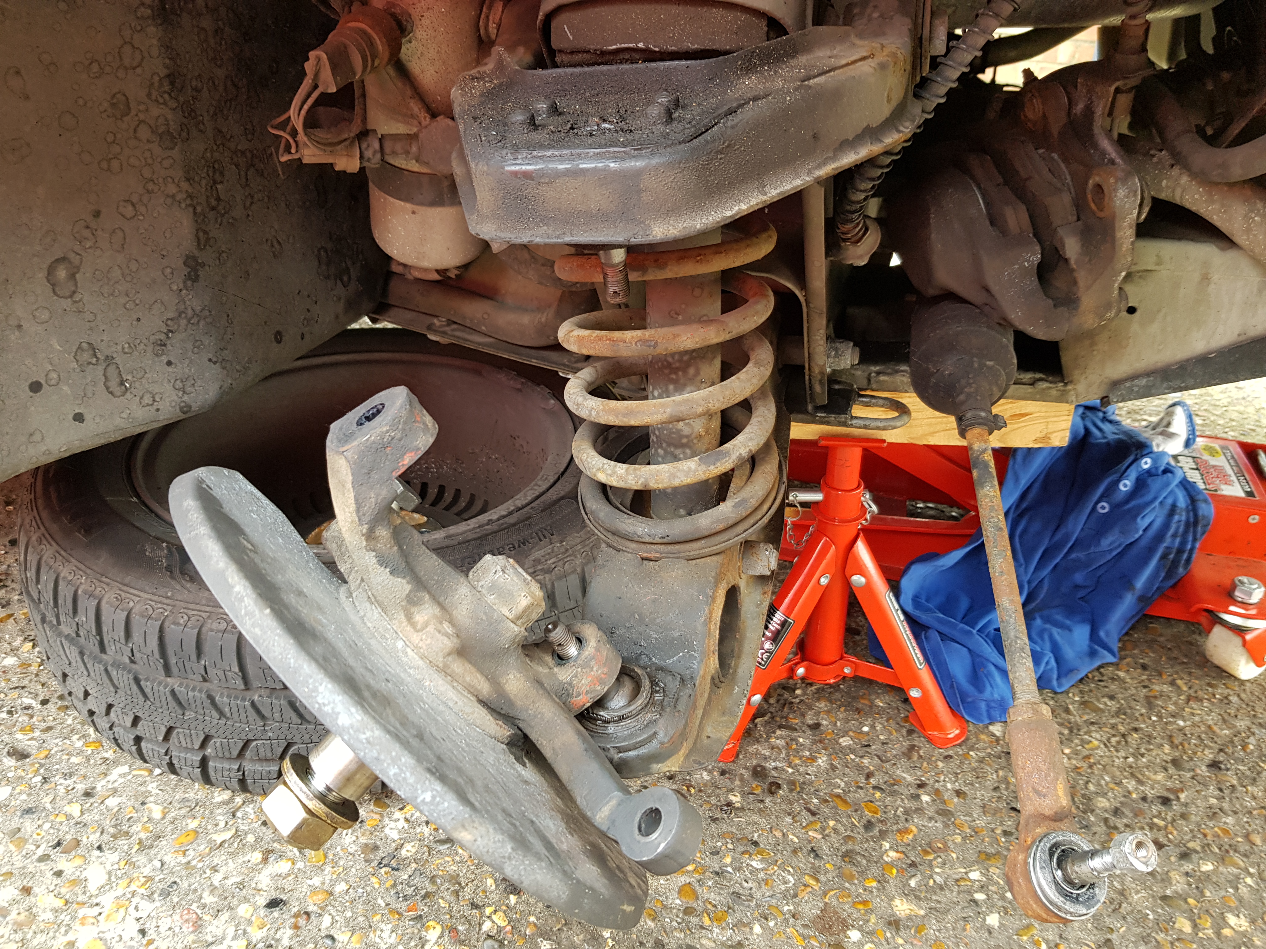

Been busy today. The spring compressors I used are damn good and kept the spring straight with no bending and didnt scrape any of the frame either. They are expensive but theyve just paid for themselves as far as im concerned. Im still alive :D
A few little por15 touchups needed but far less than I thought.
Also managed to get a local garage to put in the new hub bearing too.
Annoyingly (as always) I need a few bits and pieces to complete this side (like the padding bit that sits on top of the spring).
Overall, this has been a fairly straight forward and easy job with no seized bolts or space issues. Who knew?

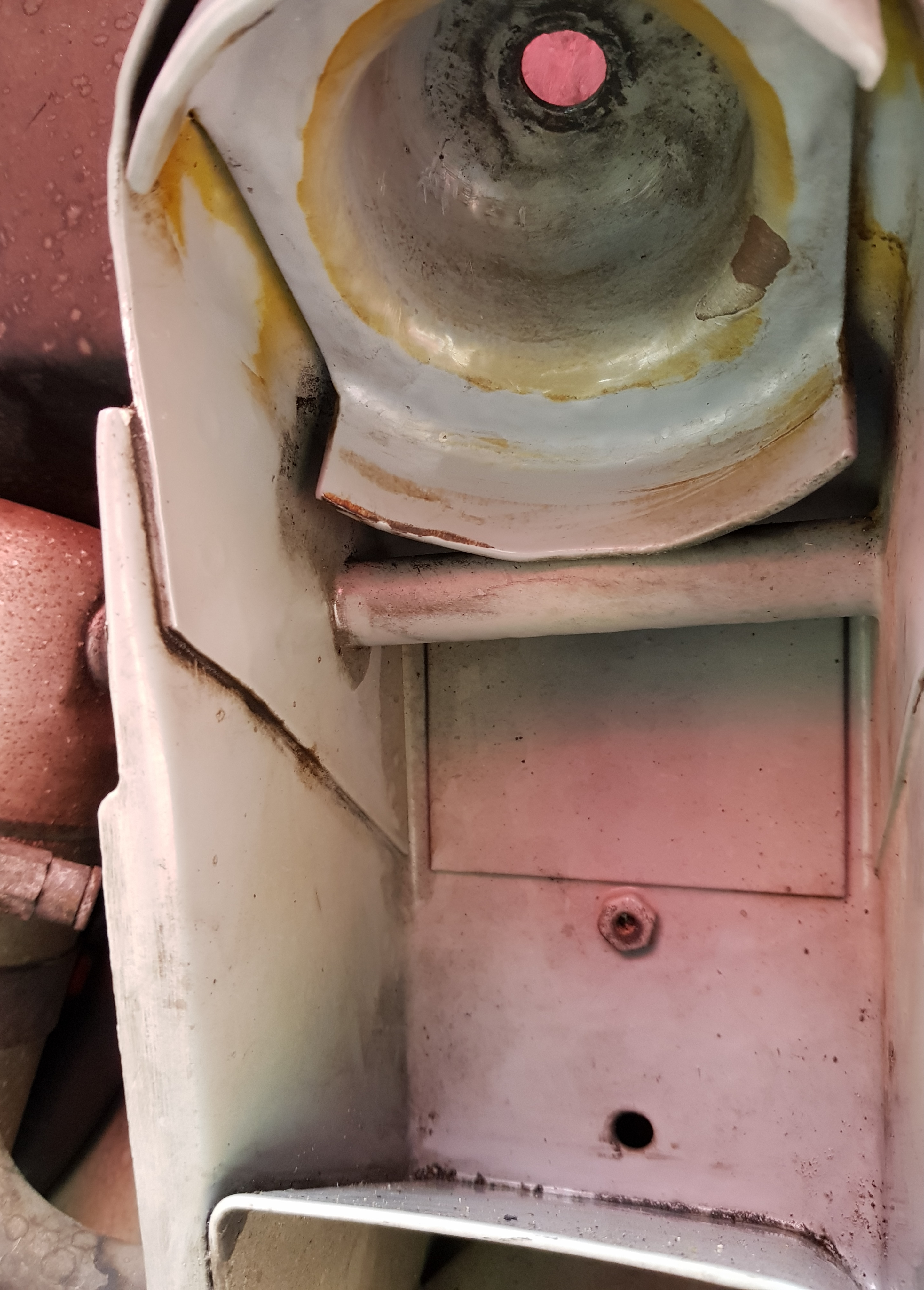

Yep, that needs a new one

Postby Domi » Mon Mar 08, 2021 6:47 pm
Indeed your spring compressors are really cool.
I remember the ones I used were pretty dangerous and hard to put on the car, especially the front.
