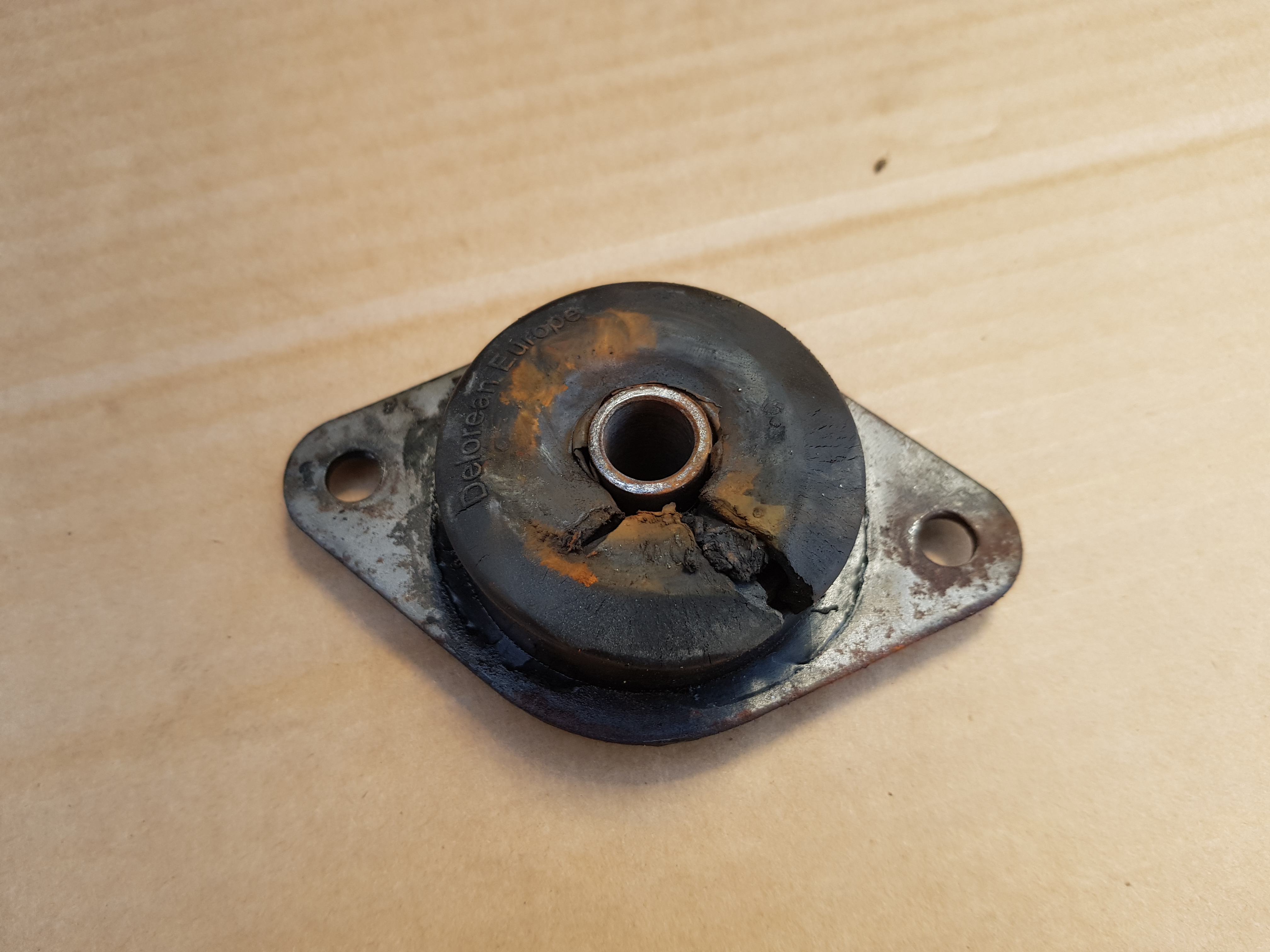

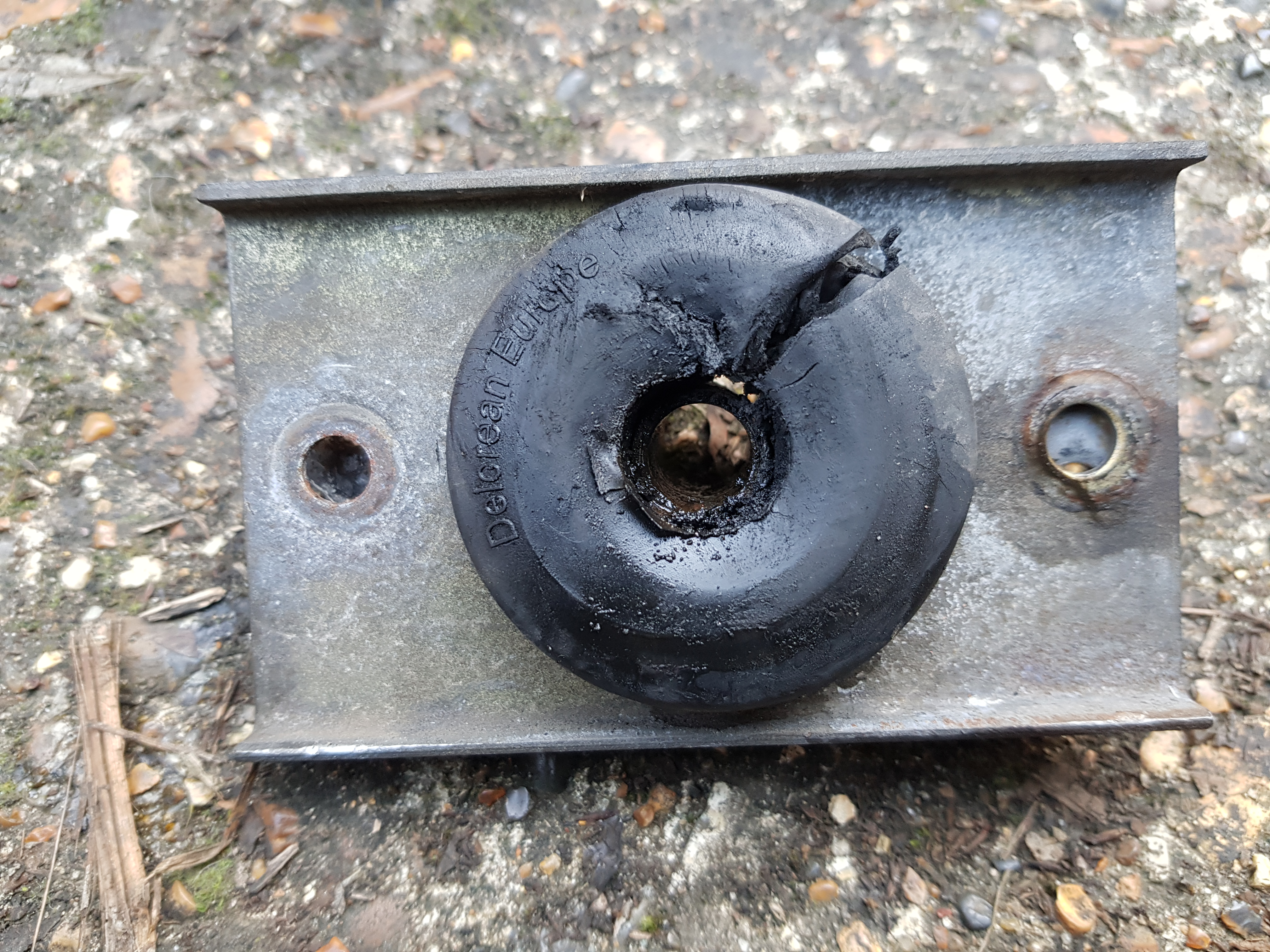

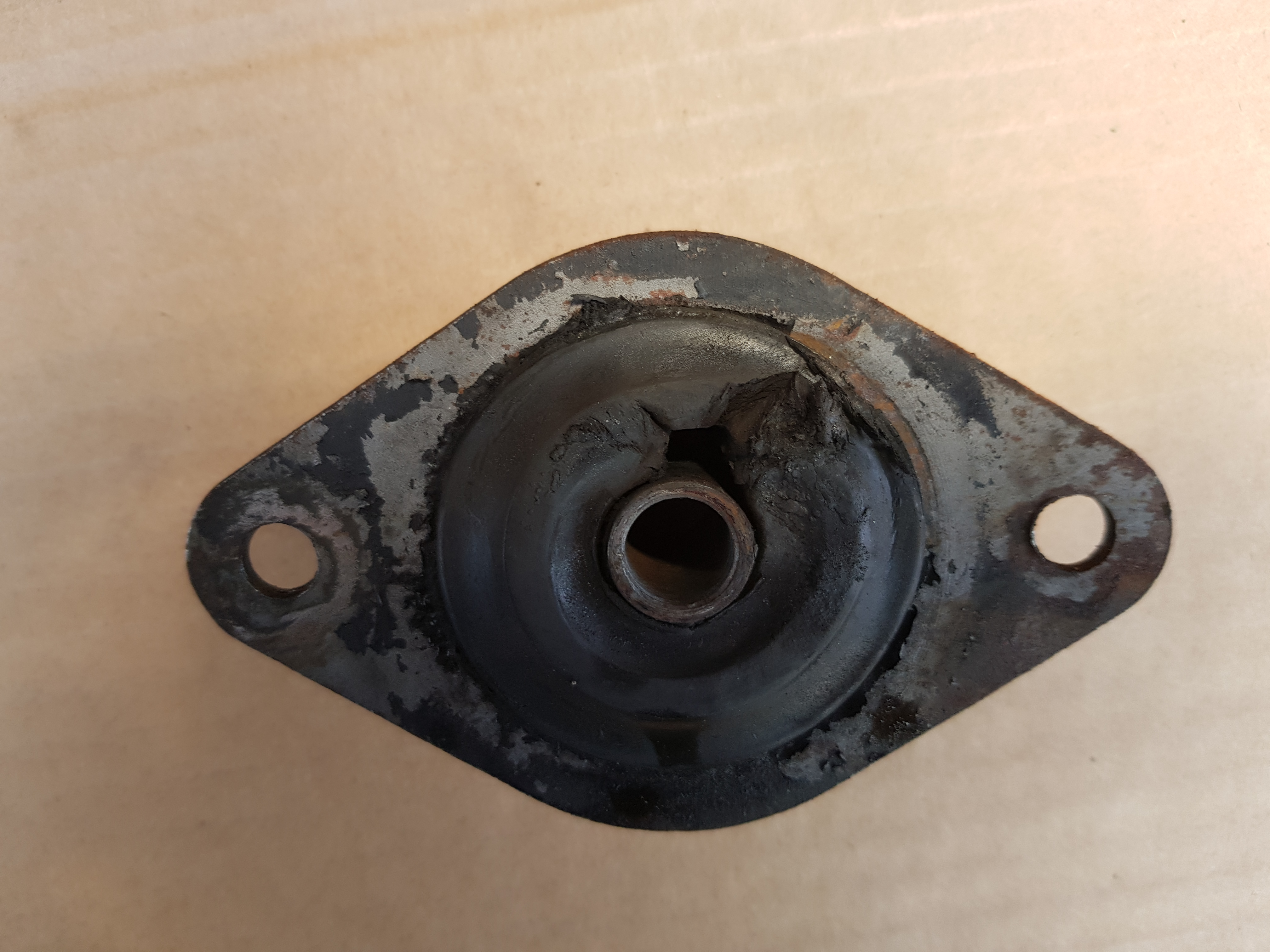

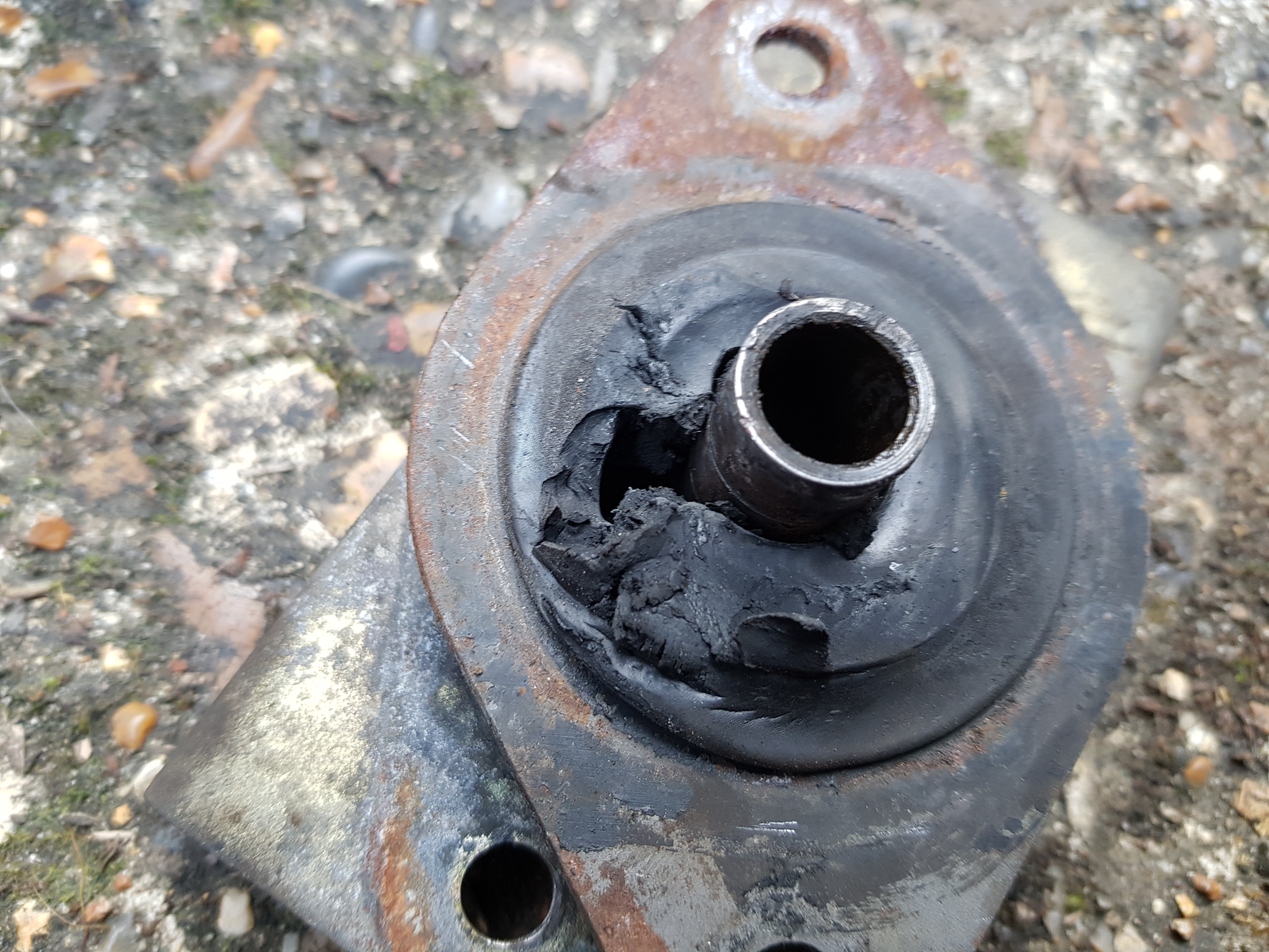

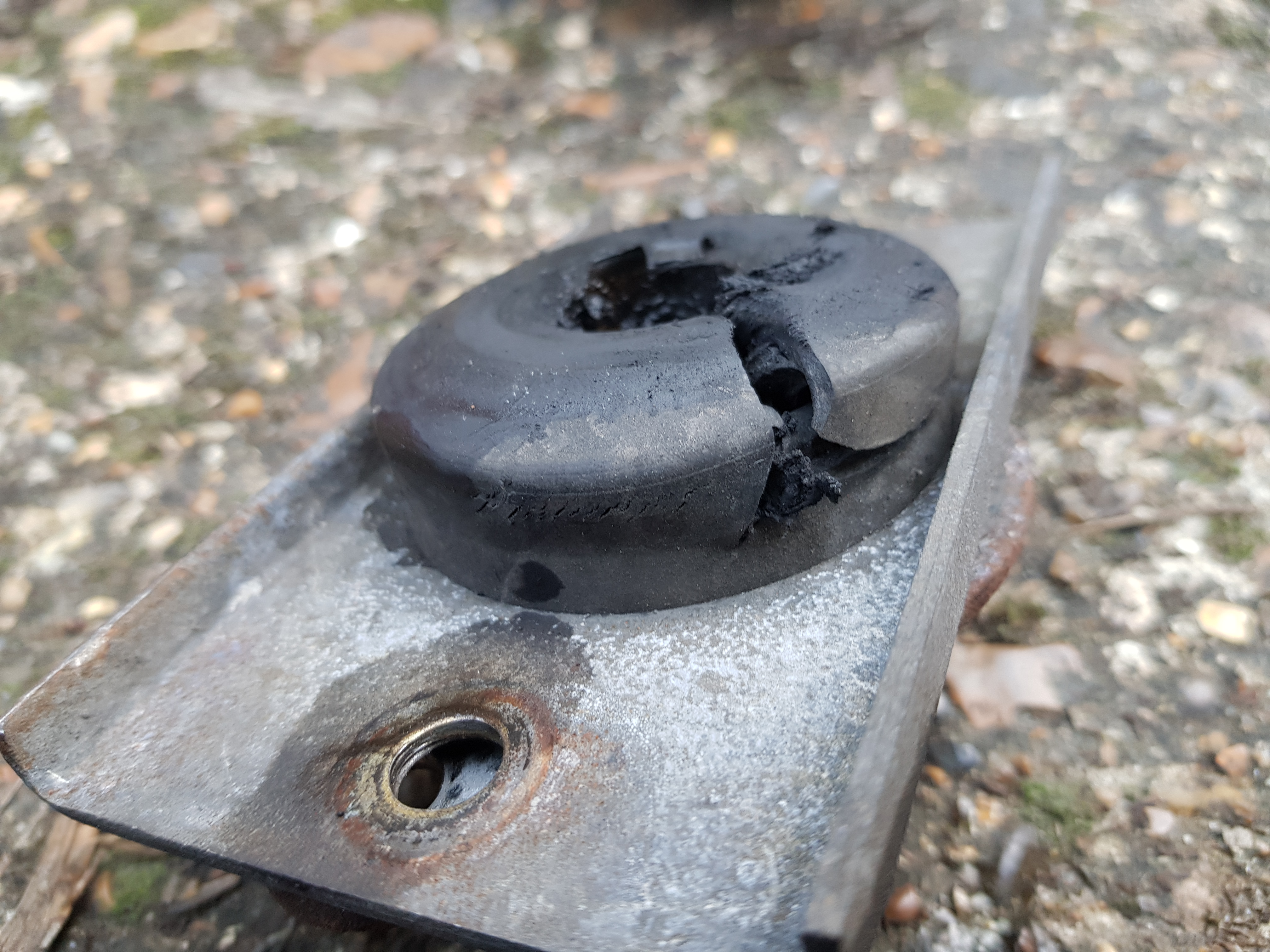

Firstly as some are aware, I had the delorean europe radius bushes fail on me. I would advise anyone who have these to check them. This is what I pulled from my car...
Drivers side
Passenger side
:shock: :shock: :shock: :shock: :shock: :shock:
These have now been swapped for NOS ones which Ive been told hold up rather well. Ive also opted for the Inconel bolts too. Rear end feels much more stable now.

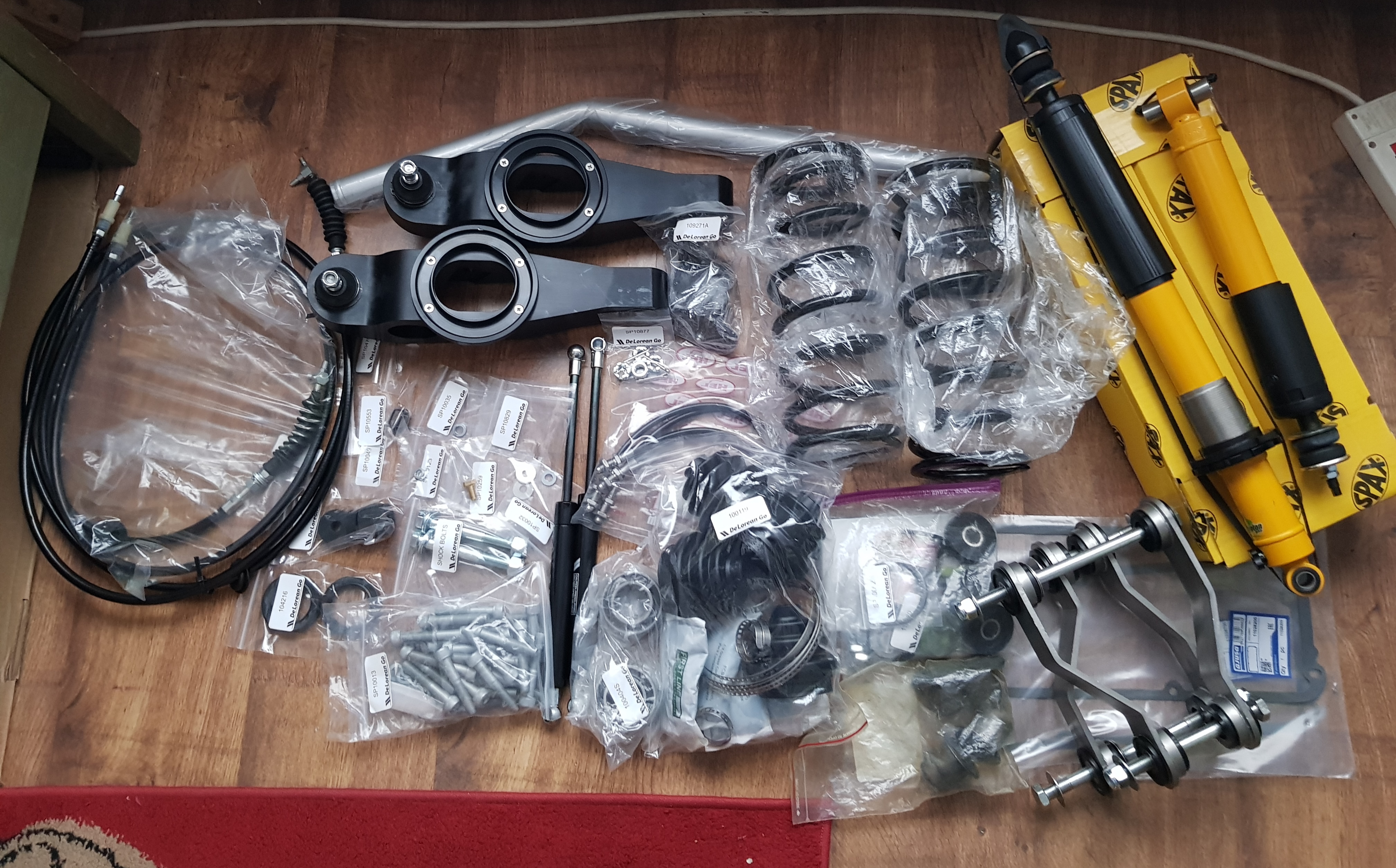

I now have everything I need to start work on the front suspension area.
- Lowered springs
- Ali LCAs with british LBJs
- LCA support brackets
- :spax: shocks
- Poly bushes for the sway bar
- British upper ball joints
- Hub bearings
- NOS upper control bushes
Basically the works.
I also have por15 grey paint and prep to touch up a few little areas here and there.
Kinda feel like a parts shop

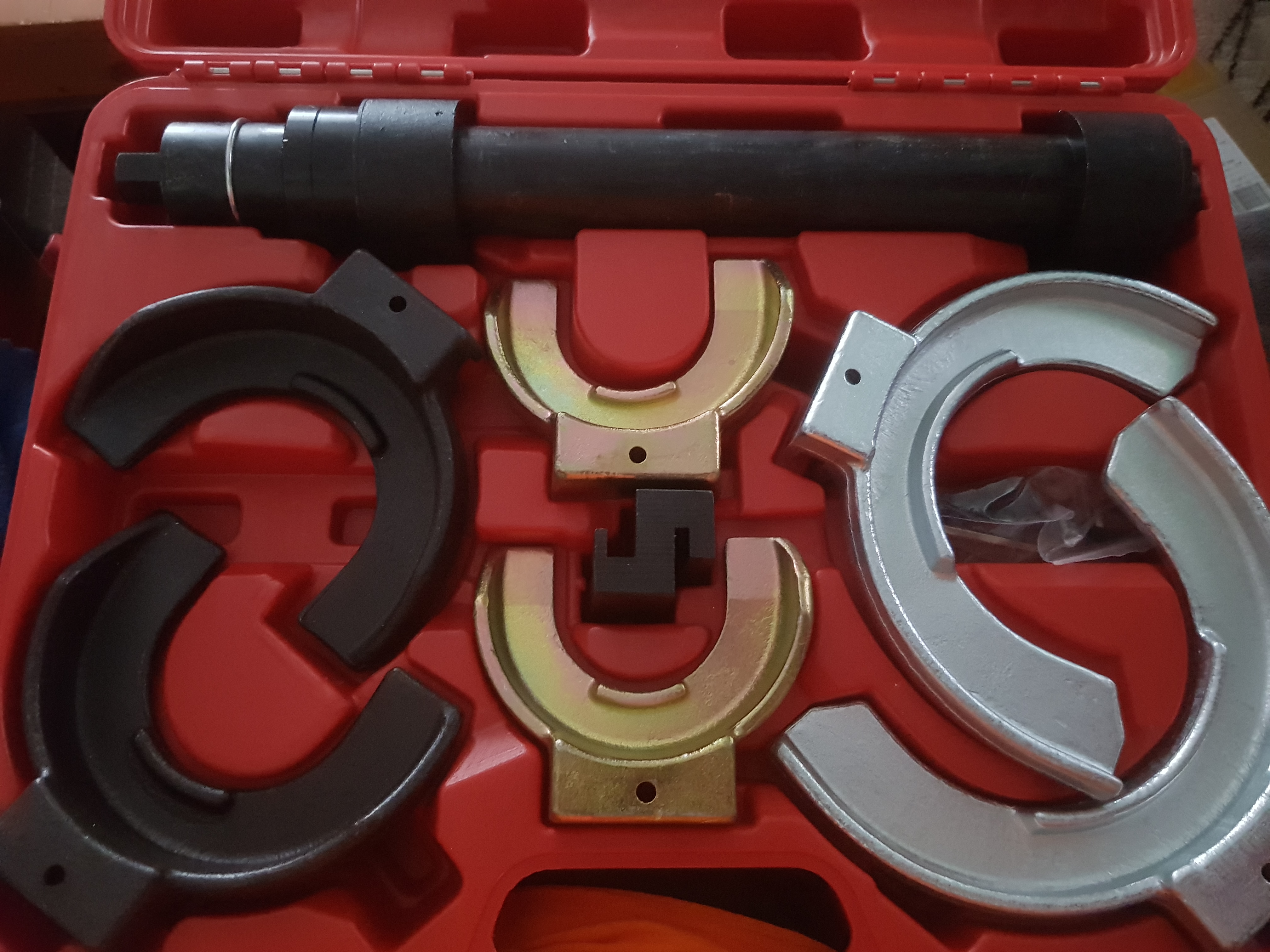

To compress the springs, Ive gone for these as they seem to be the safest to use...

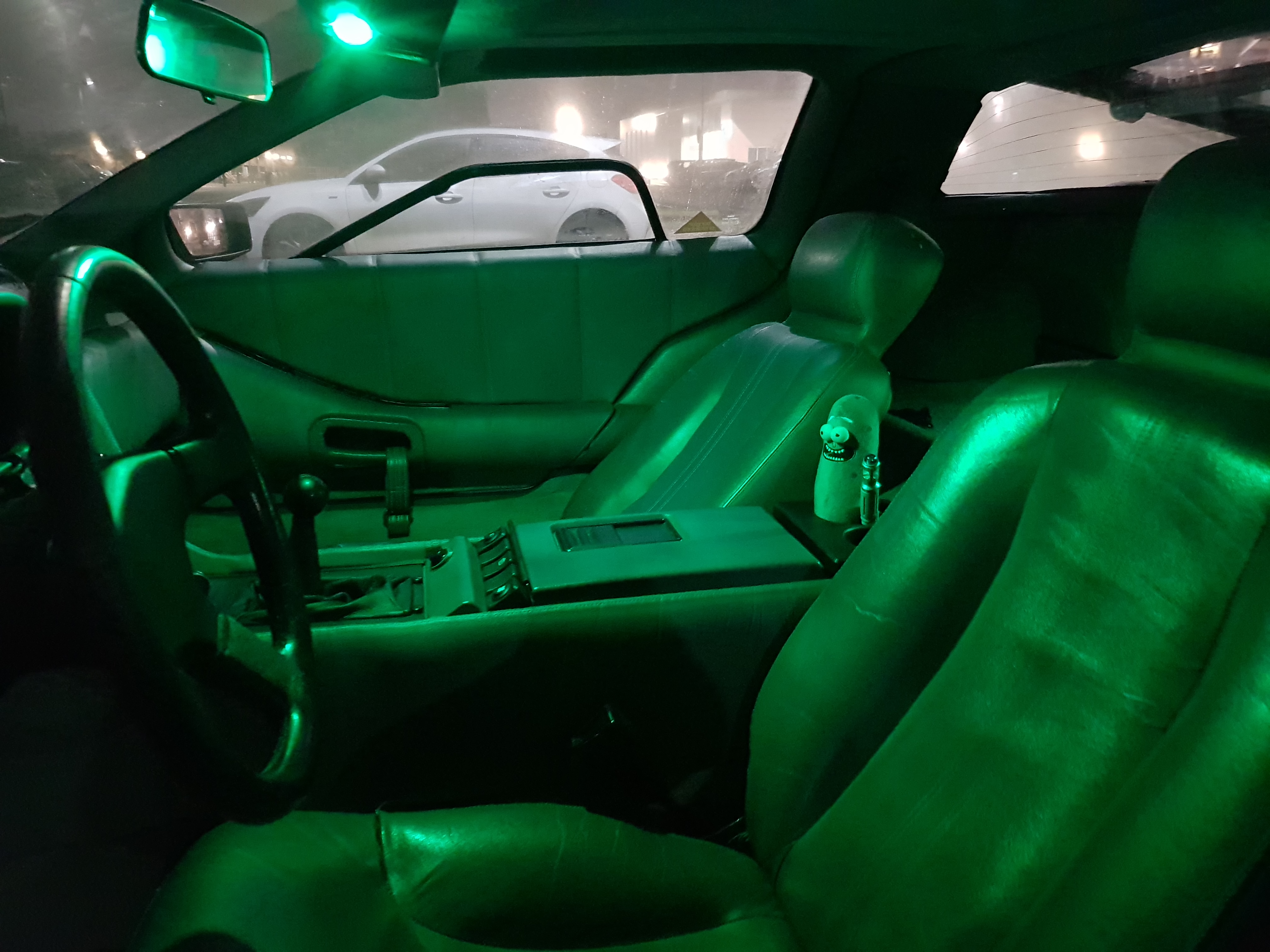

The headliners are now back in the car finally and I opted for green interior dome lights. I may add footwell lighting at some point but wont be soon...

The green is a bit out there but like it 8-)
Re: VIN 5219
Postby DMC1983 » Thu Mar 04, 2021 6:25 pm
I know its not to everyones taste but besides the warm white, I see the next common colour is blue. I thought I would try green and I quite like it. Ive seen someone in America who has red dome lights but it didnt do anything for me :D
Im looking forward to getting the parts on the car even if somewhat a little apprehensive when it comes to the death springs. Still, it'll all be worth it
Re: VIN 5219
Postby Dan 6511 » Thu Mar 04, 2021 11:11 pm
Honestly the springs aren't as bad as they are made out to be. I took mine out without spring compressors at all. I pulled the lower arm out of the chassis with the spring and shock still in place. (The spring can't go anywhere with the shock still in place) Then turned the arm 90 degrees so its clear of the chassis - brute force needed here. Then jack up the underneath of the arm to compress the spring a bit and take the tension off the shock fittings. Then you can unbolt the shock. Then lower your jack down slowly and the spring will gradually extend until its no longer compressed and you can just lift it all out :thumbsup:

Been busy today. The spring compressors I used are damn good and kept the spring straight with no bending and didnt scrape any of the frame either. They are expensive but theyve just paid for themselves as far as im concerned. Im still alive :D

Indeed your spring compressors are really cool.
I remember the ones I used were pretty dangerous and hard to put on the car, especially the front.

Wow you’ll not have any problems with those bad boys. Jobs a good ‘en.
