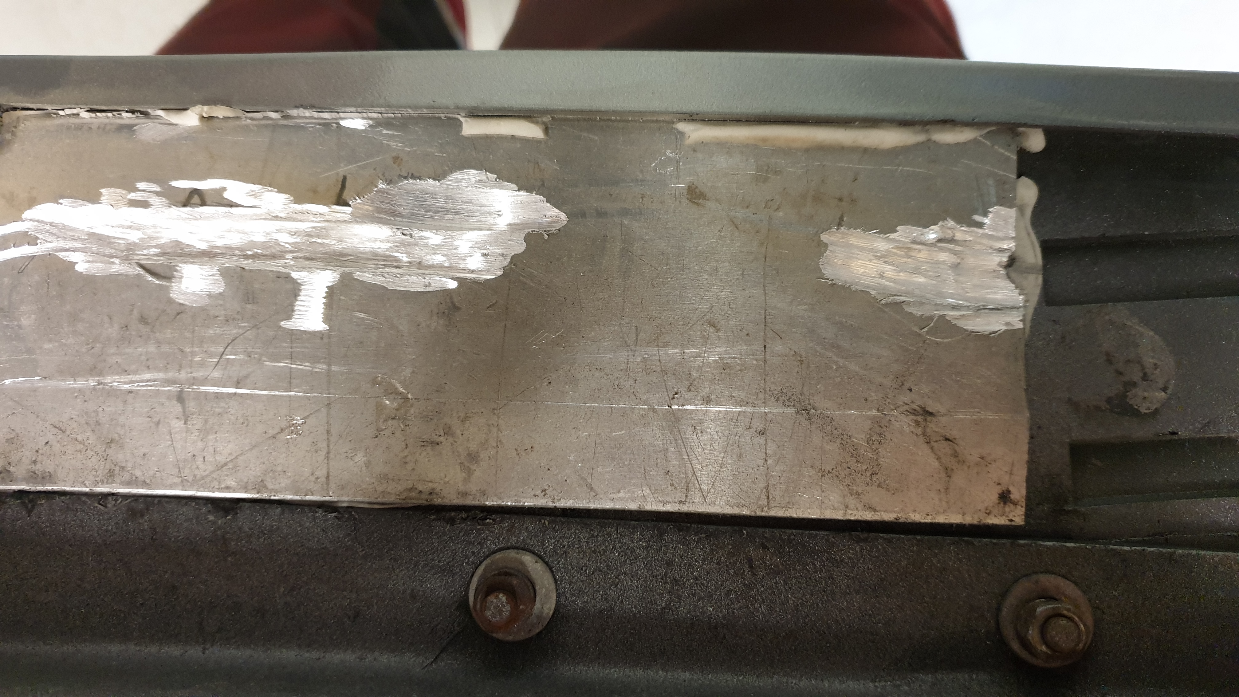

Are the reinforcing plates too thick?
Re: Vin 5063
Postby gruffalo » Sat May 11, 2019 2:43 pm
After som grinding and taking it on and off 5 times, the front bumper fits with no issues.

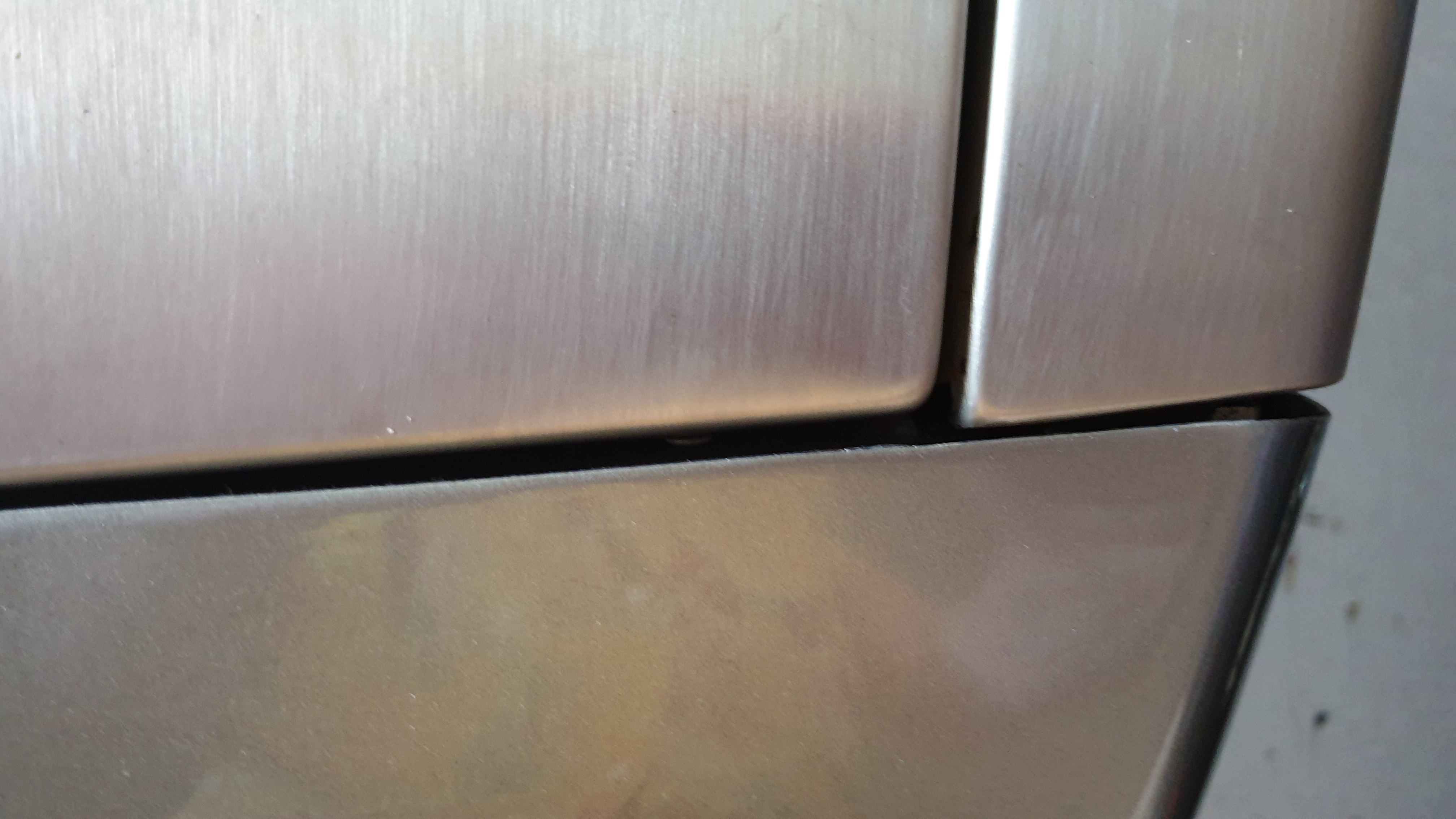

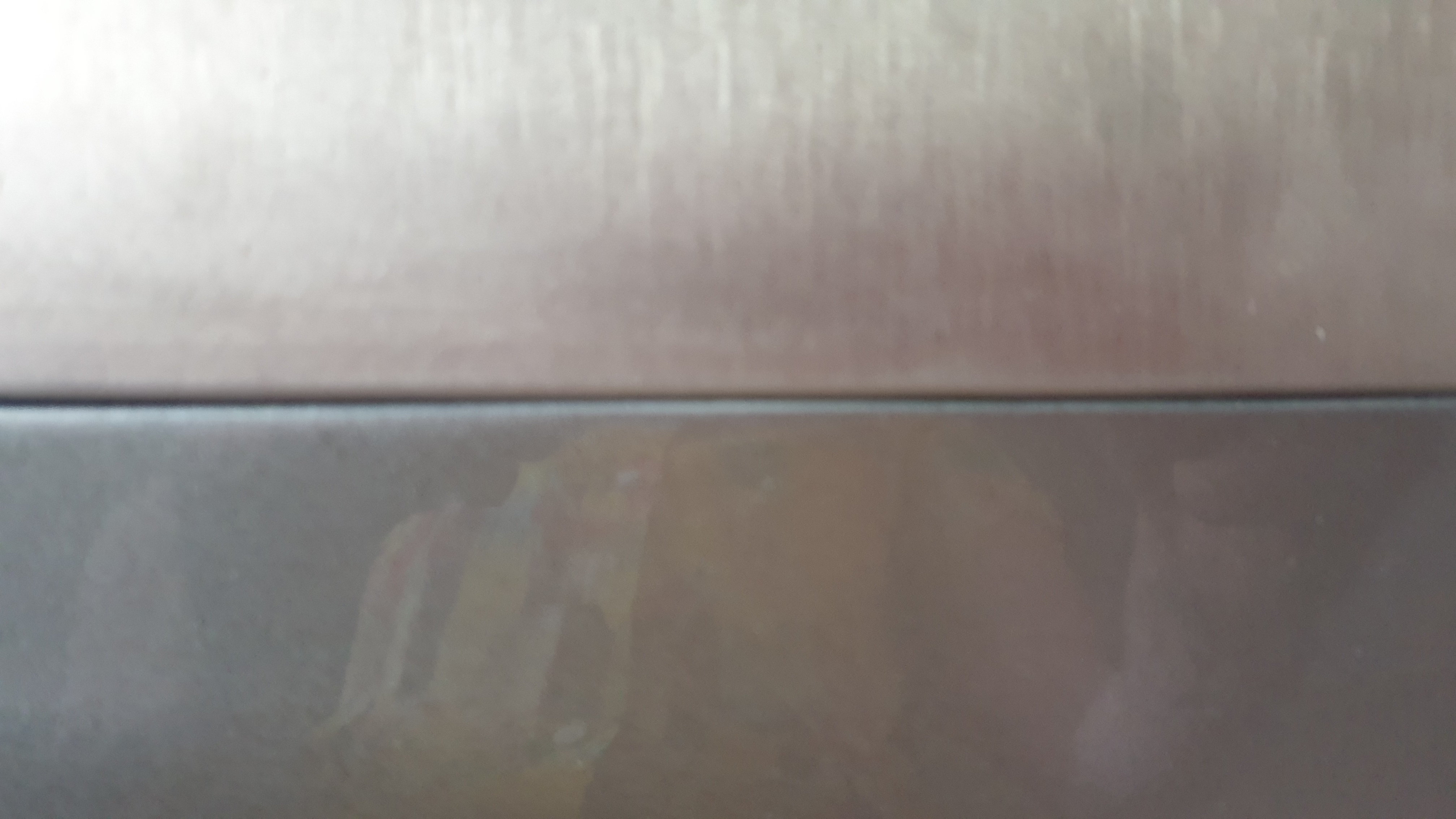

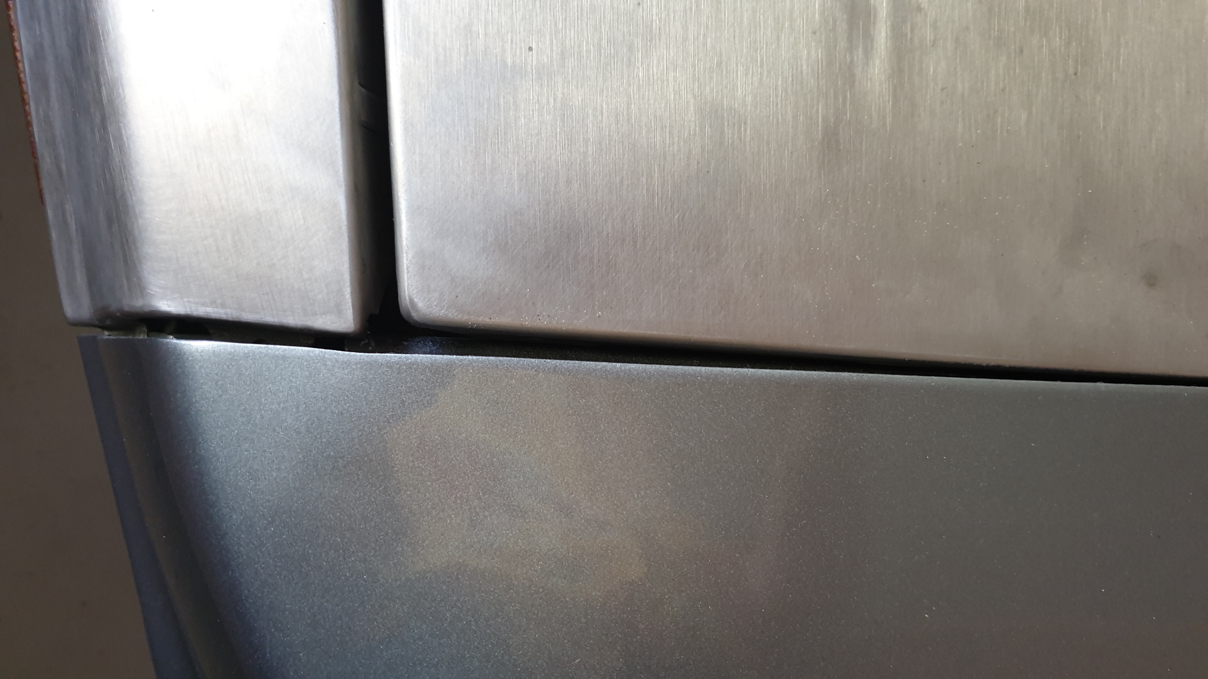

I have hood alignment and panel gap issues...
Corner
Middle
Corner
gruffalo
Posts: 256
Location: Norway
VIN #: 5063
Re: Vin 5063
Postby andyd » Fri May 17, 2019 11:49 am
Probably fairly standard. Does the bonnet catch the fascia when it opens?
If not, I dont think that's too severe?
Re: Vin 5063
Postby dmc4087 » Fri May 17, 2019 1:31 pm
I hand to grind down part of the front wings (the recessed part hidden by the fascia) where they bolt to the tub - they were fouling on the fascia, causing them to sit on the corners a little like your pic above.
If you remove the fascia you might see marks underneath where the stainless is rubbing.
They are a bit of a bollocks though. I think they shrink over time and there isn't much that can be done about it?
Re: Vin 5063
Postby gruffalo » Fri May 17, 2019 2:41 pm
I'm more concerned with the curve of the hood not matching that of the bumper.

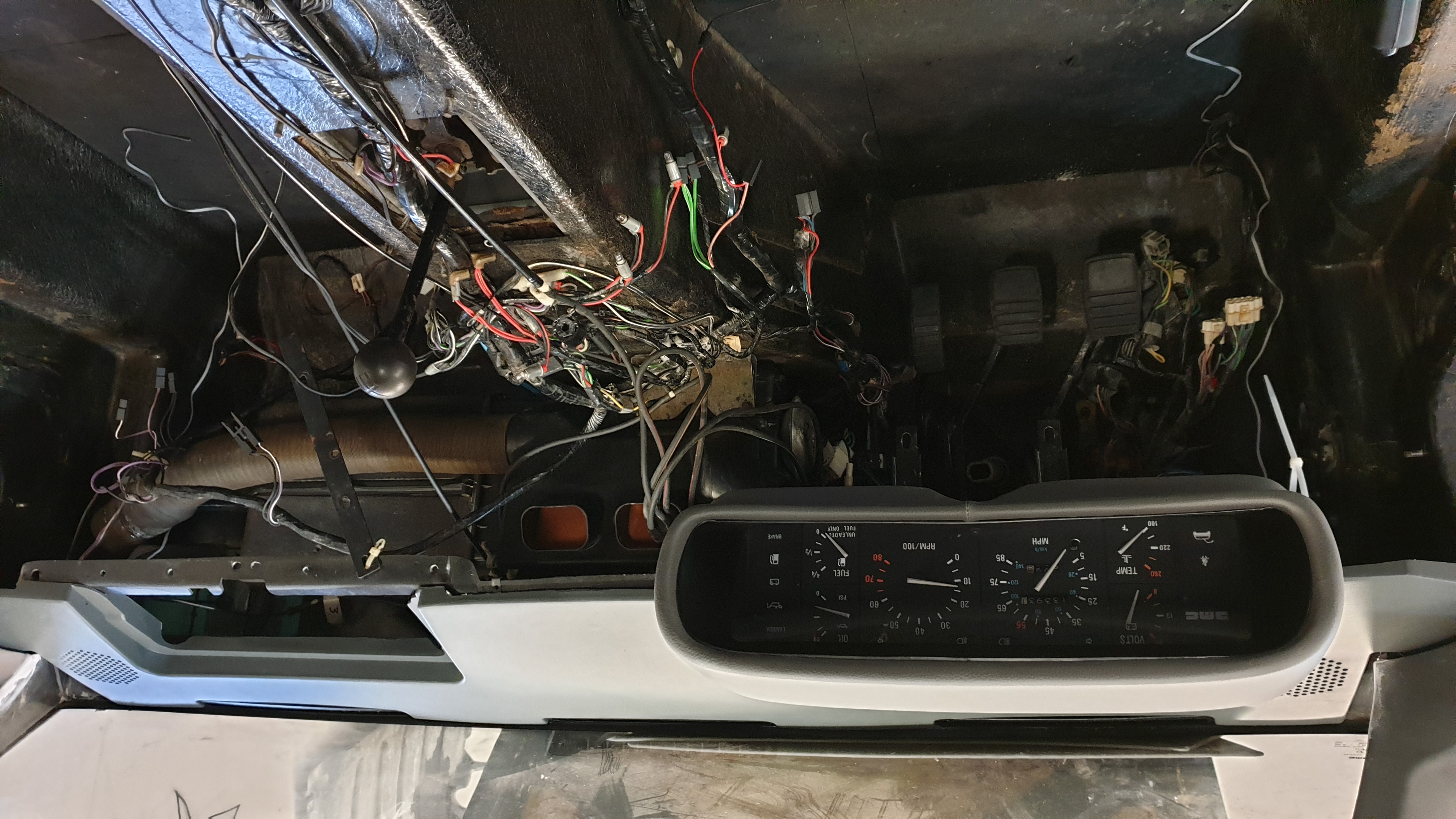

Well, I got the heater back in, along with the dashboard and instrument binnacle. Slow but steady getting there.
