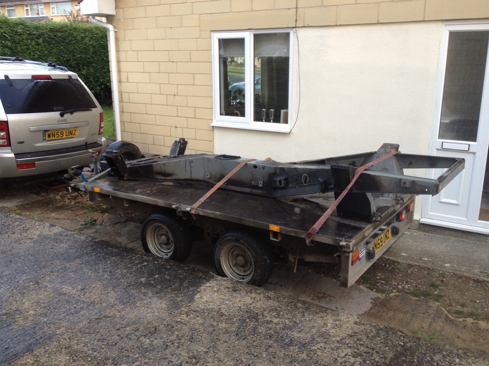

Postby OllieWilks » Sun Jun 24, 2012 4:32 pm
Just a quick update and picture. Took the chassis to pro strip in nottingham yesterday morning. They kindly opened up at 8.30am for us to drop it off. Was up to nottingham and back to Bristol by 11am yesterday but worth it! Probably a couple of weeks as they have quite a lot of work on. Making progress though...
