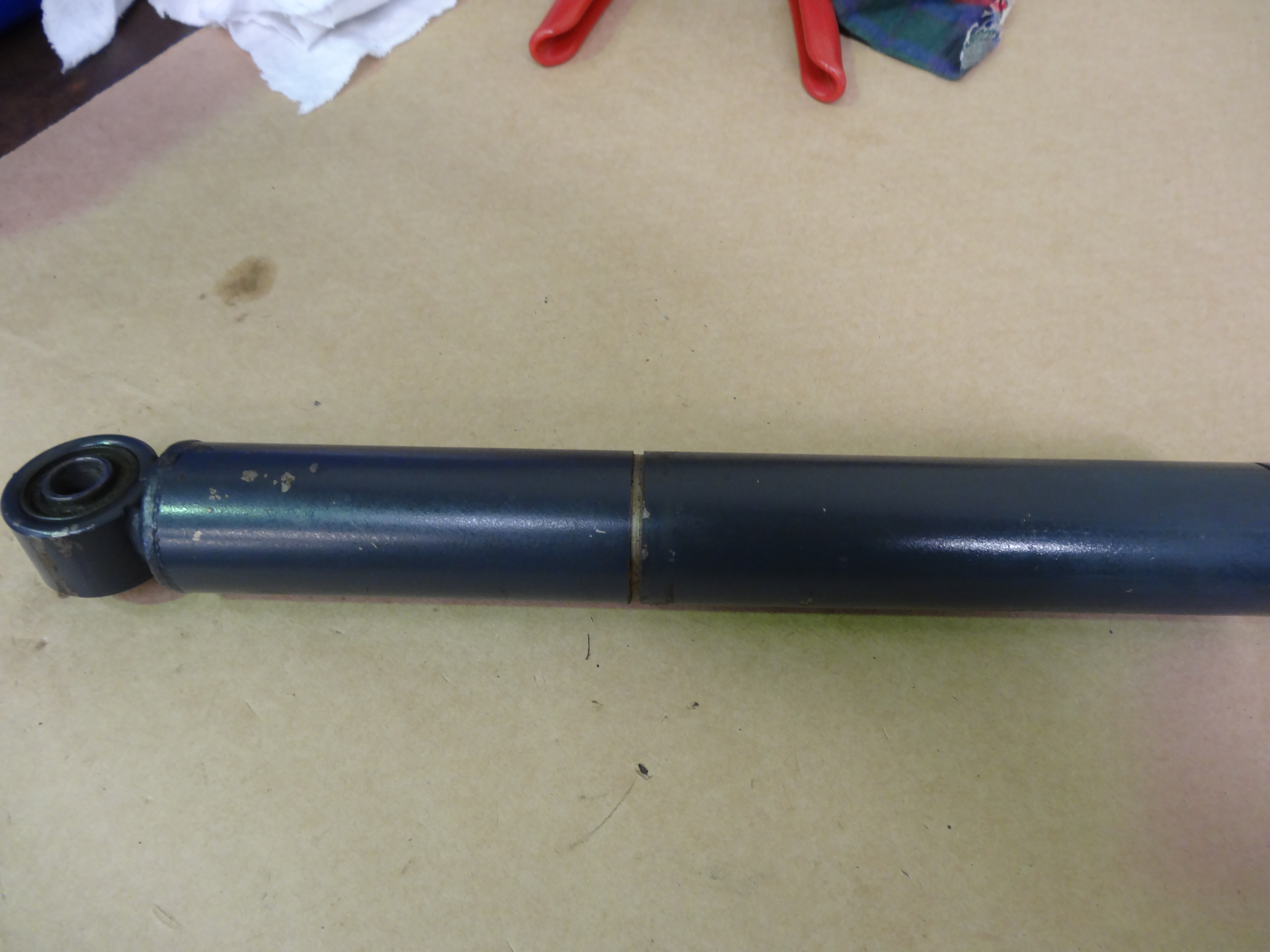

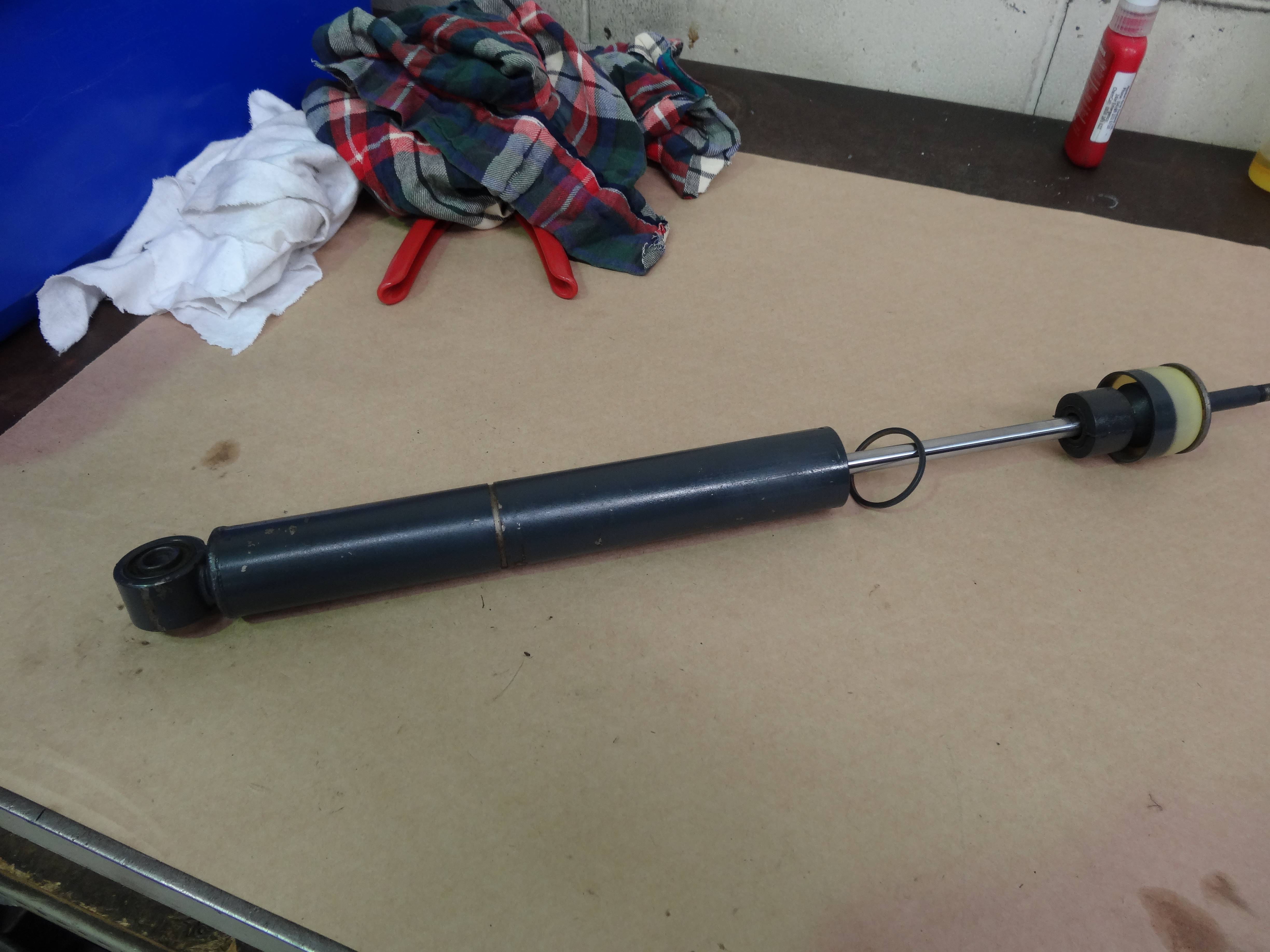

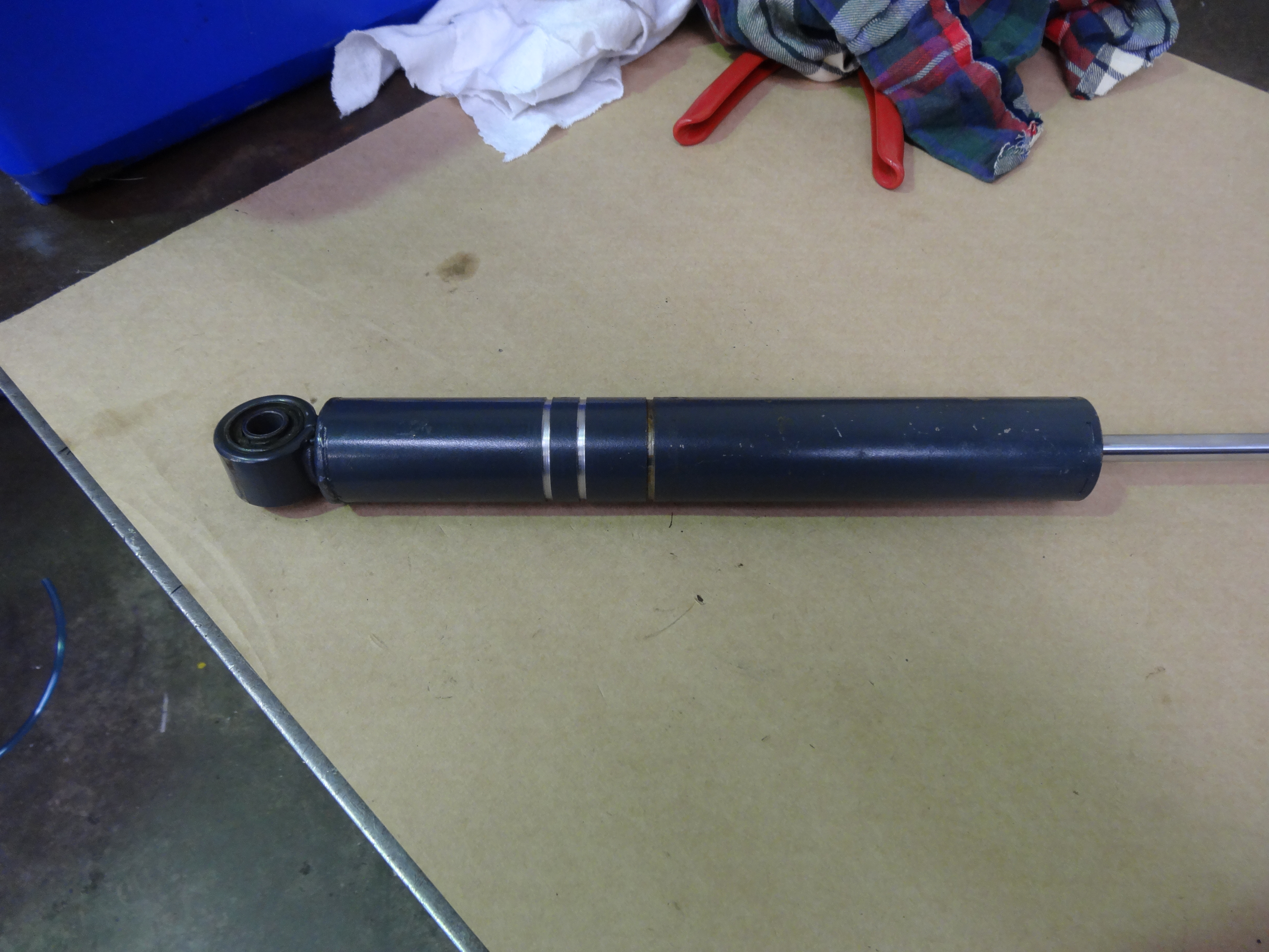

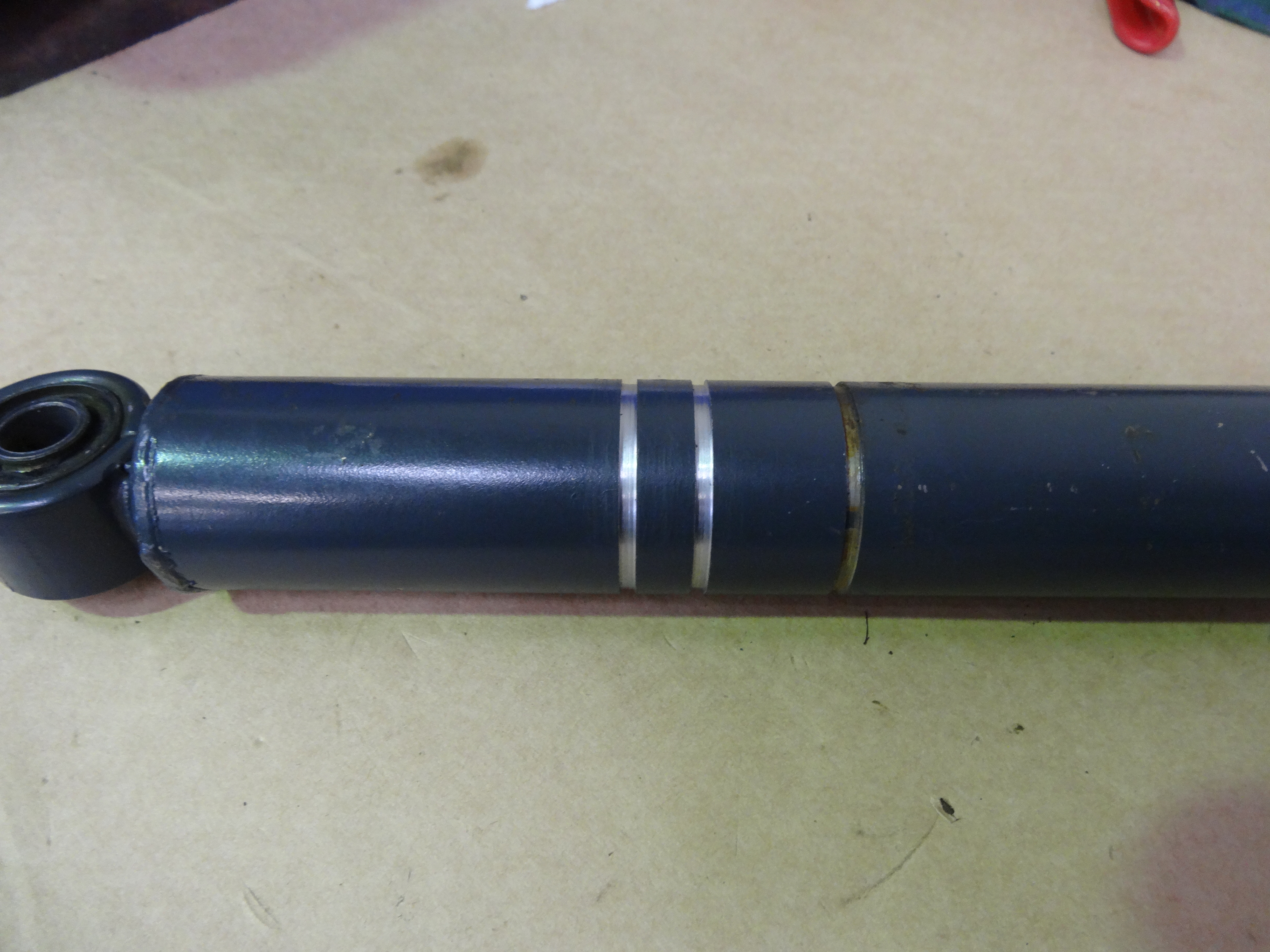

also i've found a simple way of lowering the rear springs without cutting or buying new shocks,
just re groove where the the spring sits on the shock, this is the original
and re grooved at 1" and 1 1/2" lower

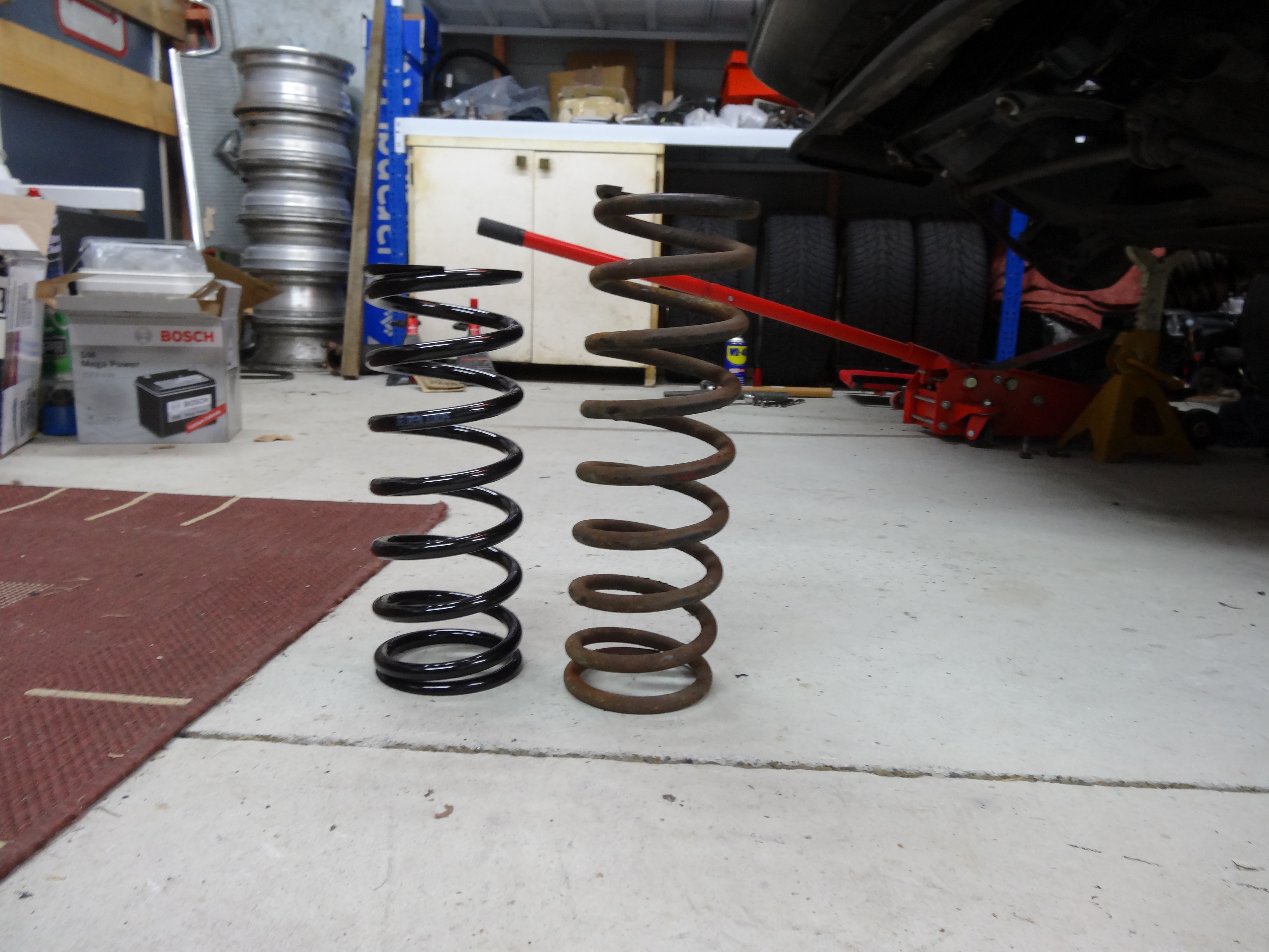

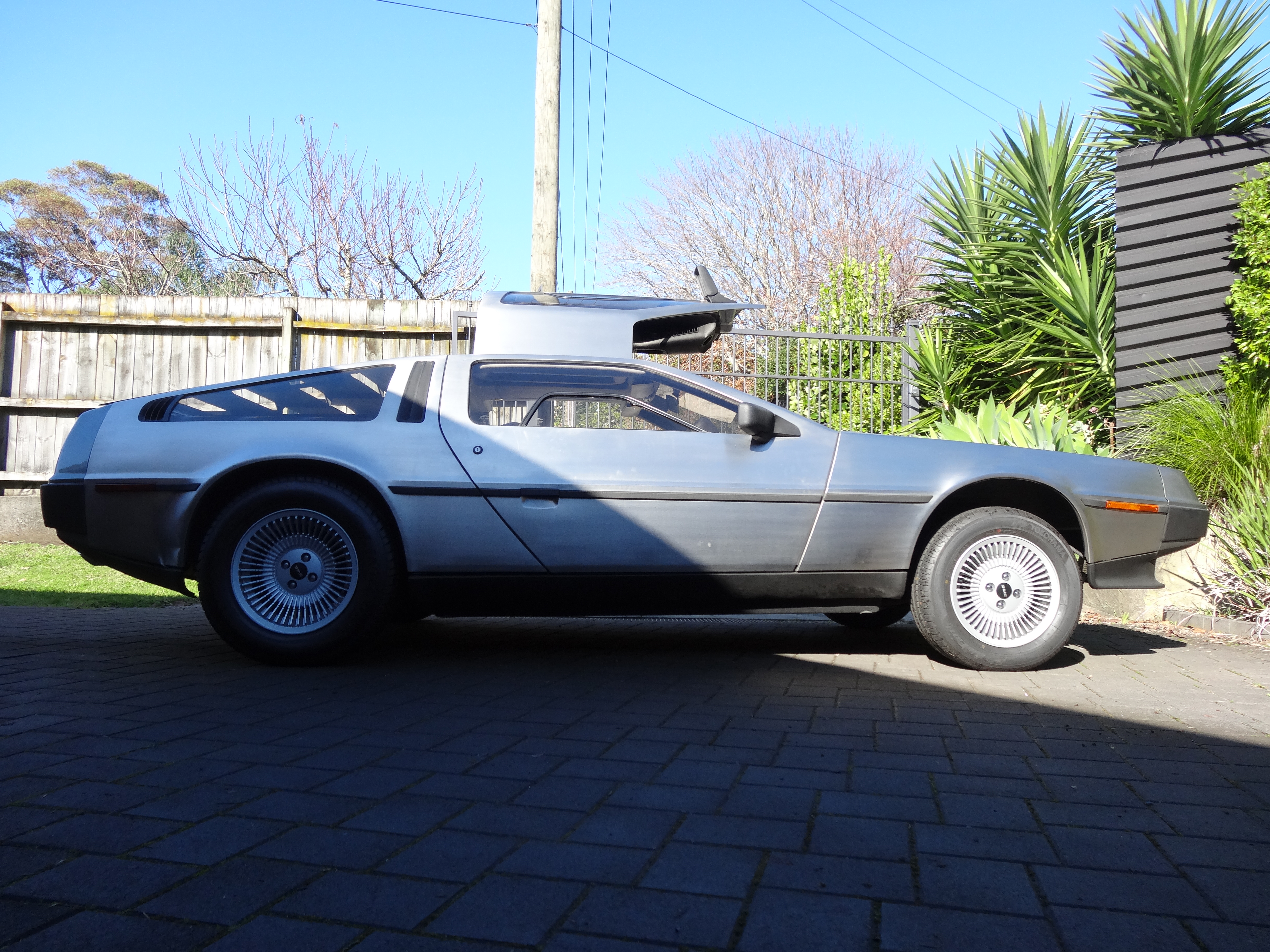

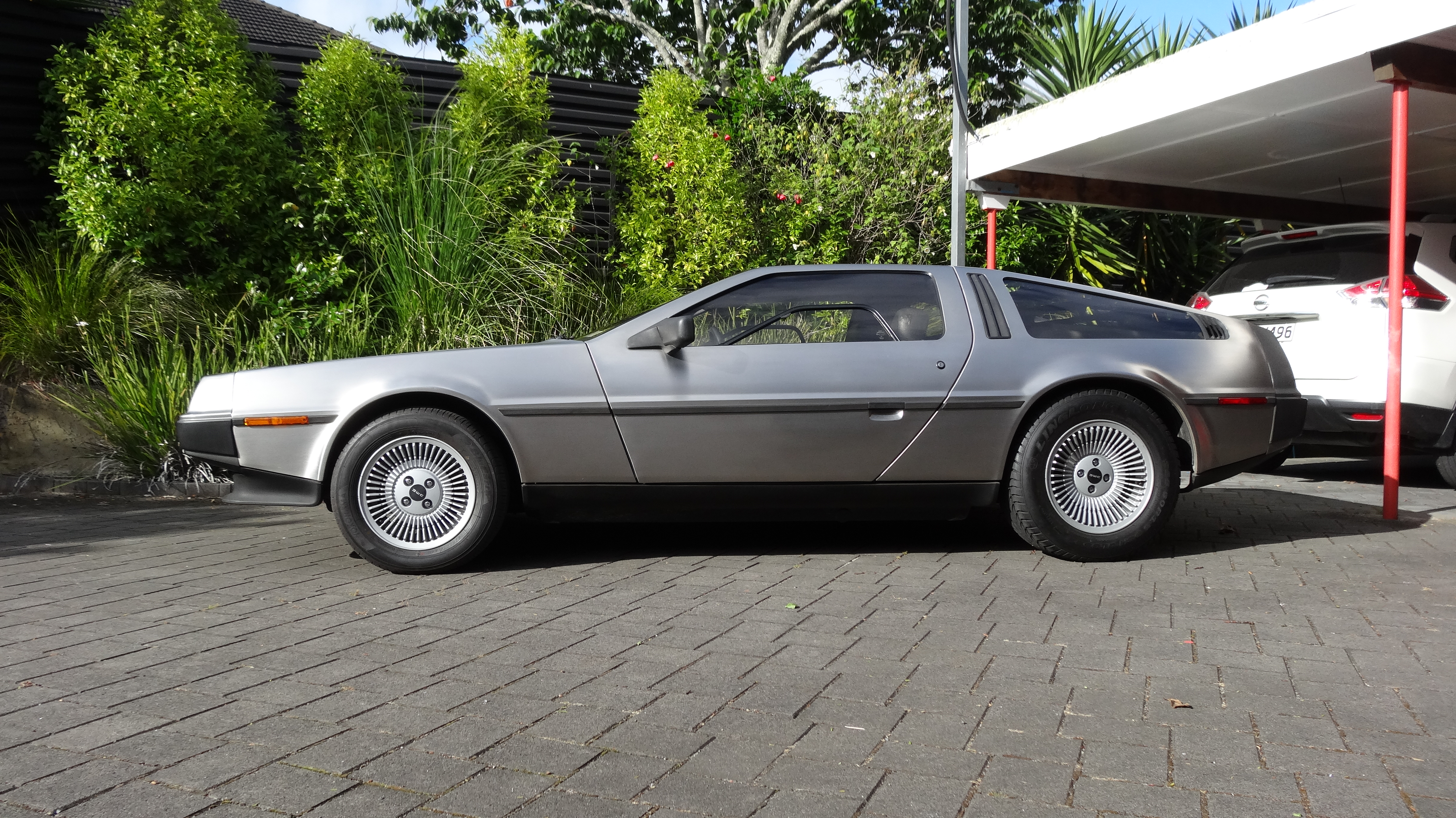

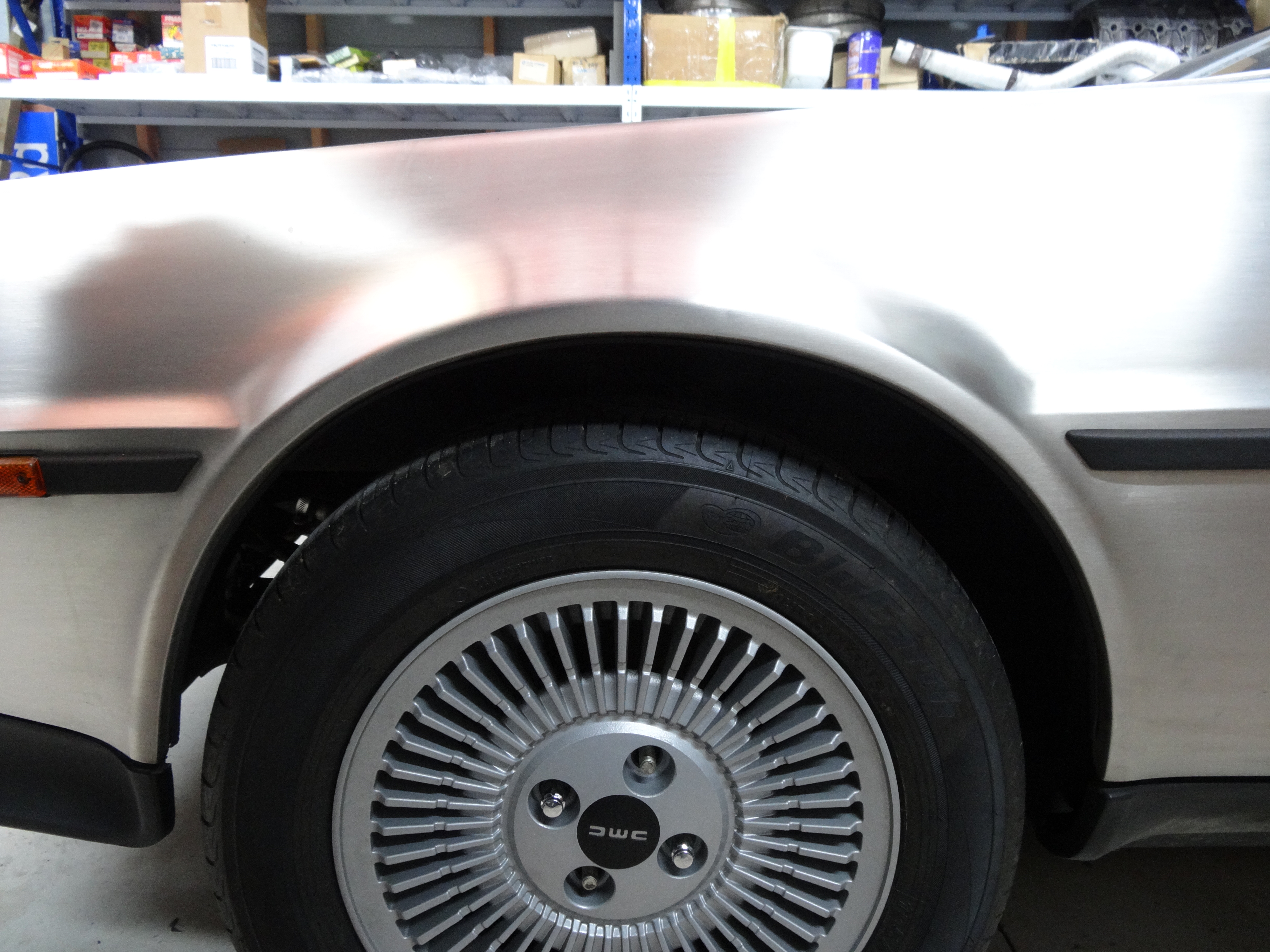

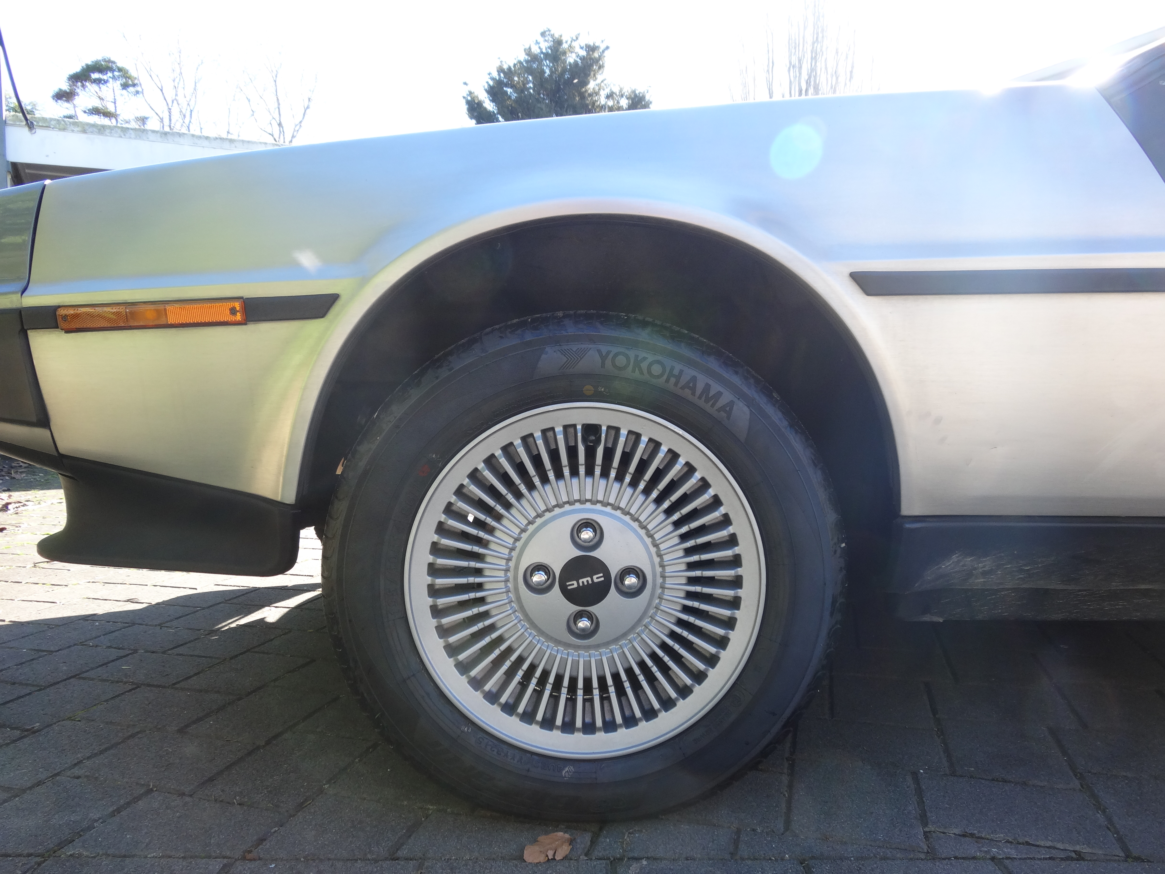

Next job is to sort out the front springs, the 4 wheel drive look is awful and makes the car look stupid, i think these cars need to look more normal
club springs vs original

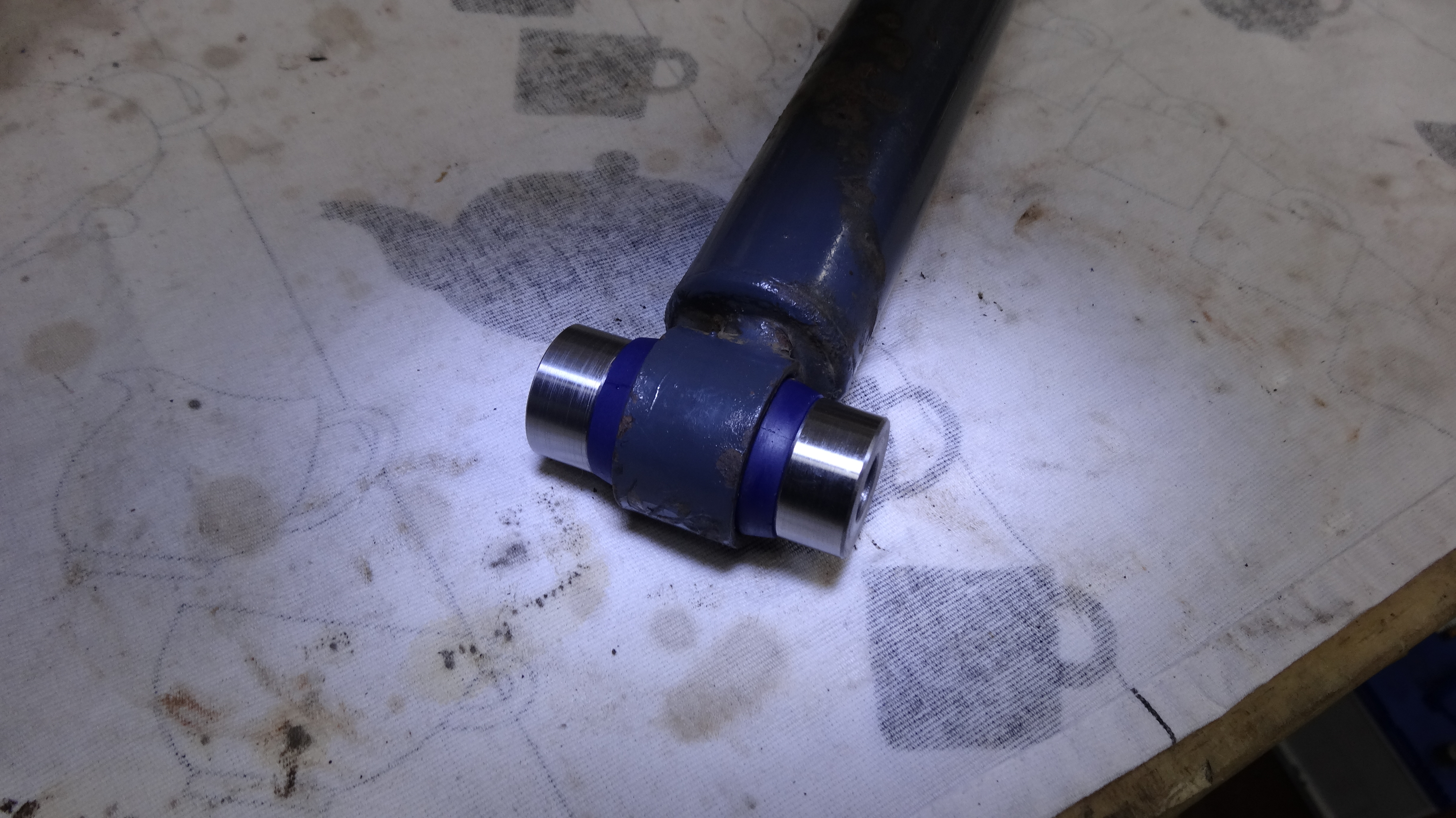

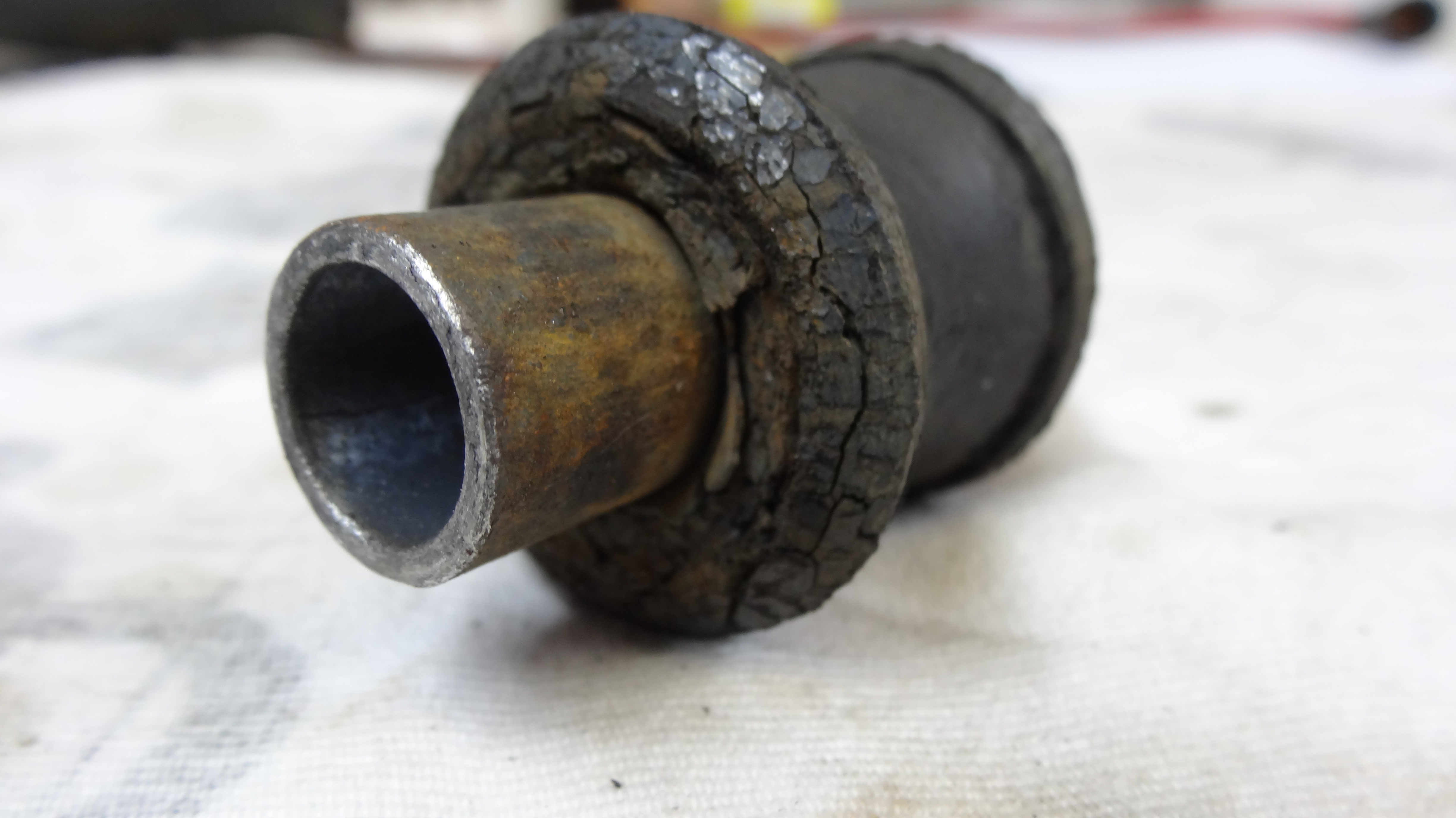

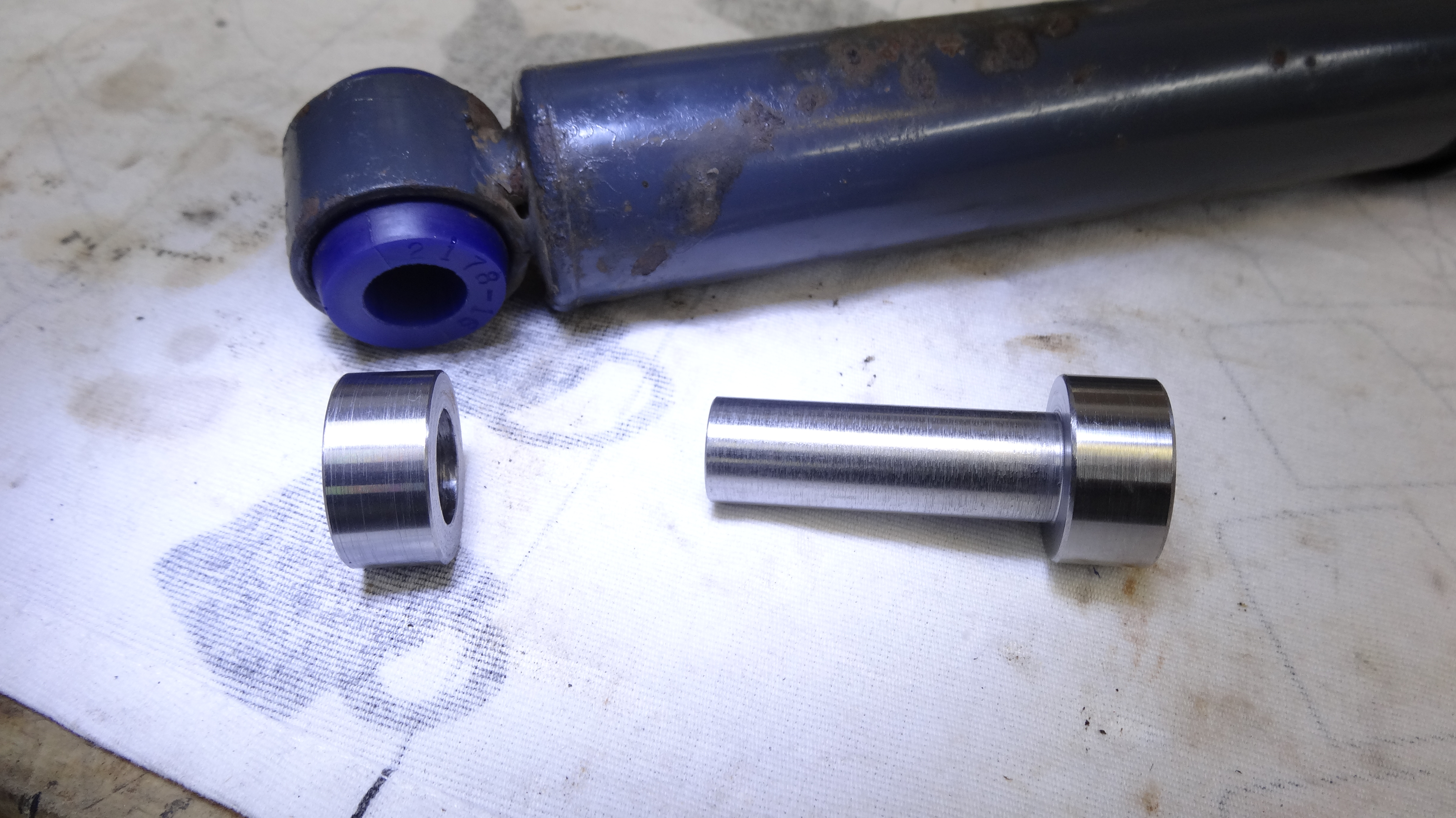

while i was there i didn't like the look of the bottom spring bushes
so got some poly bushes and made some spacers to suit

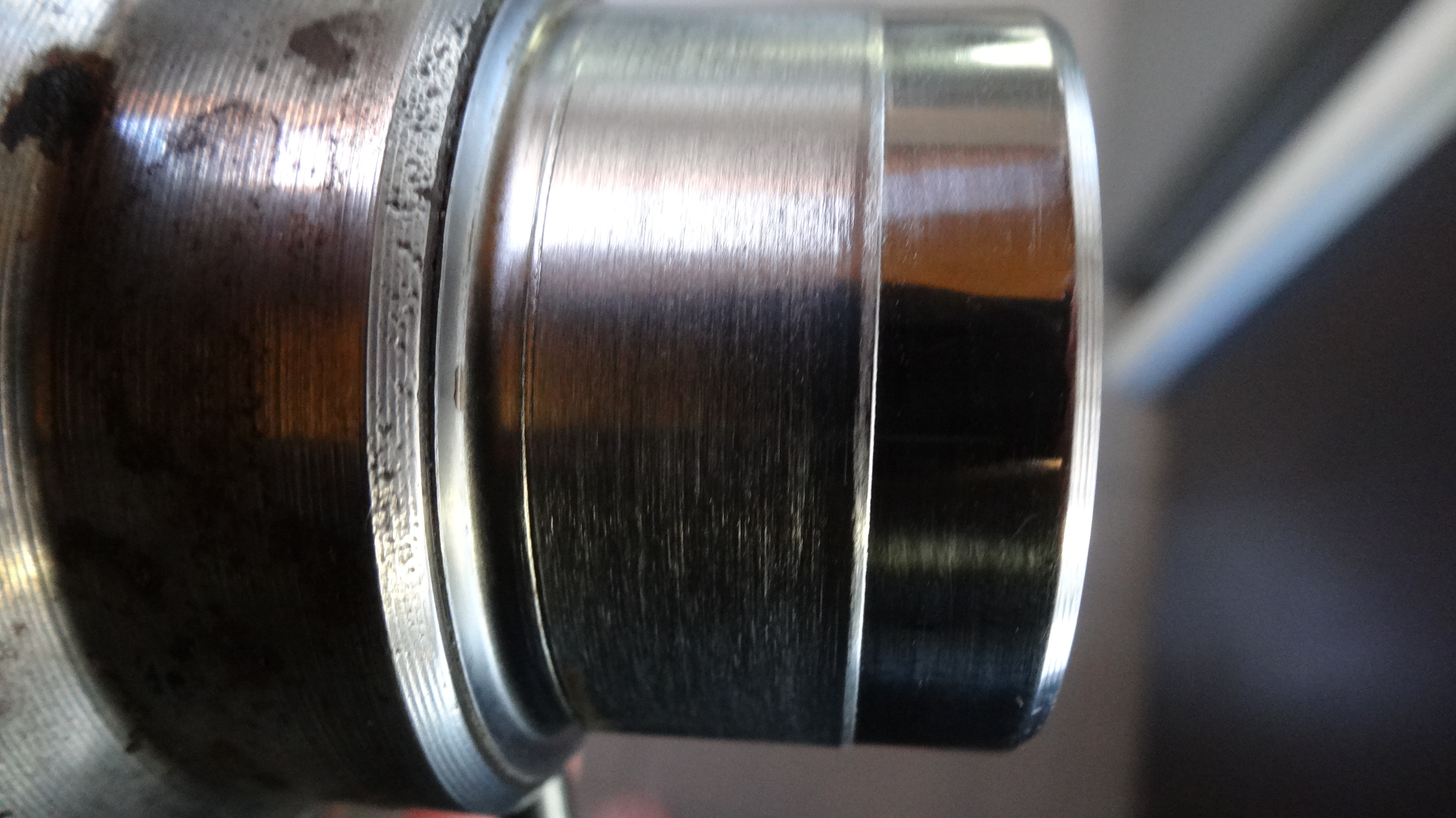

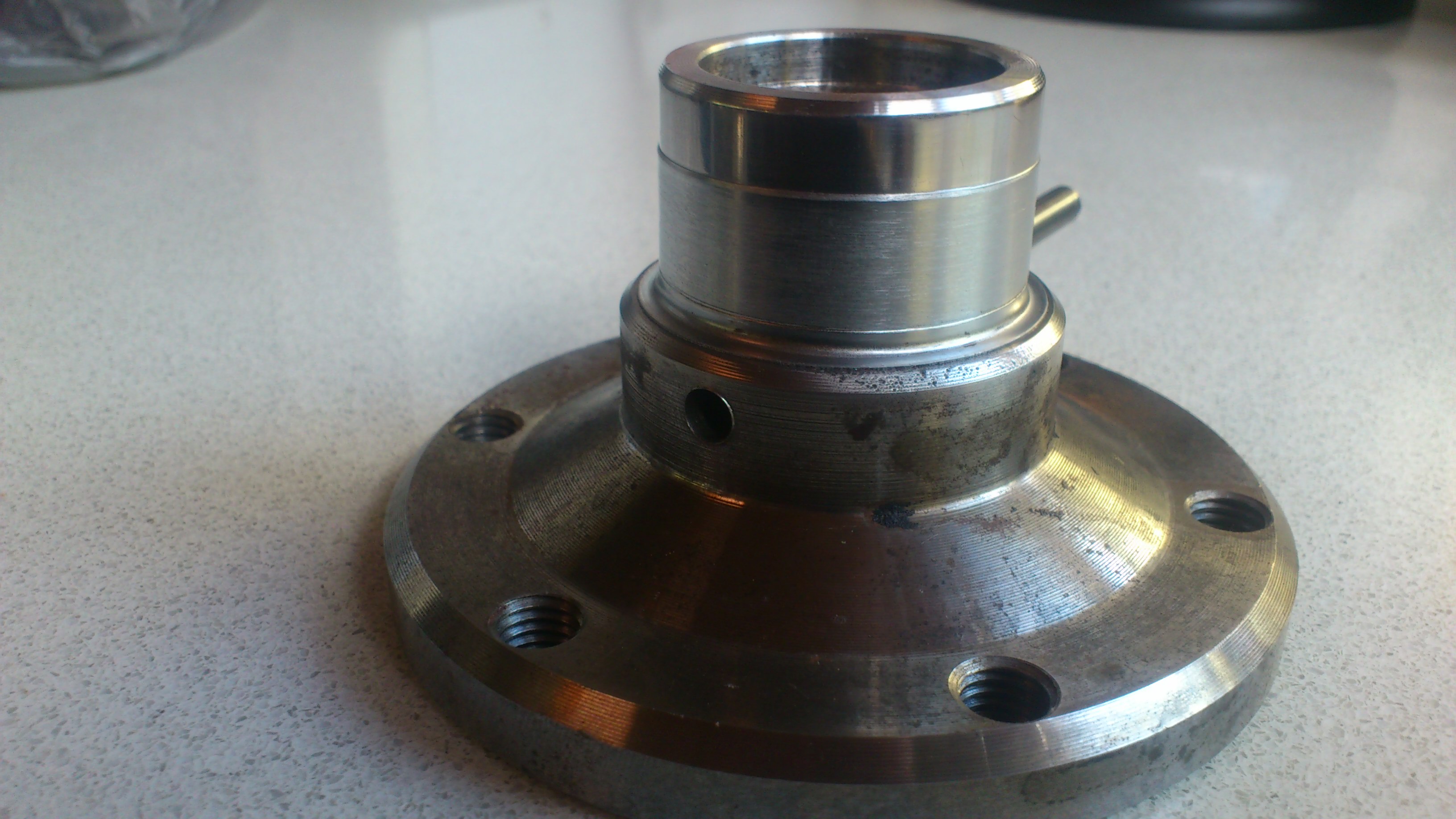

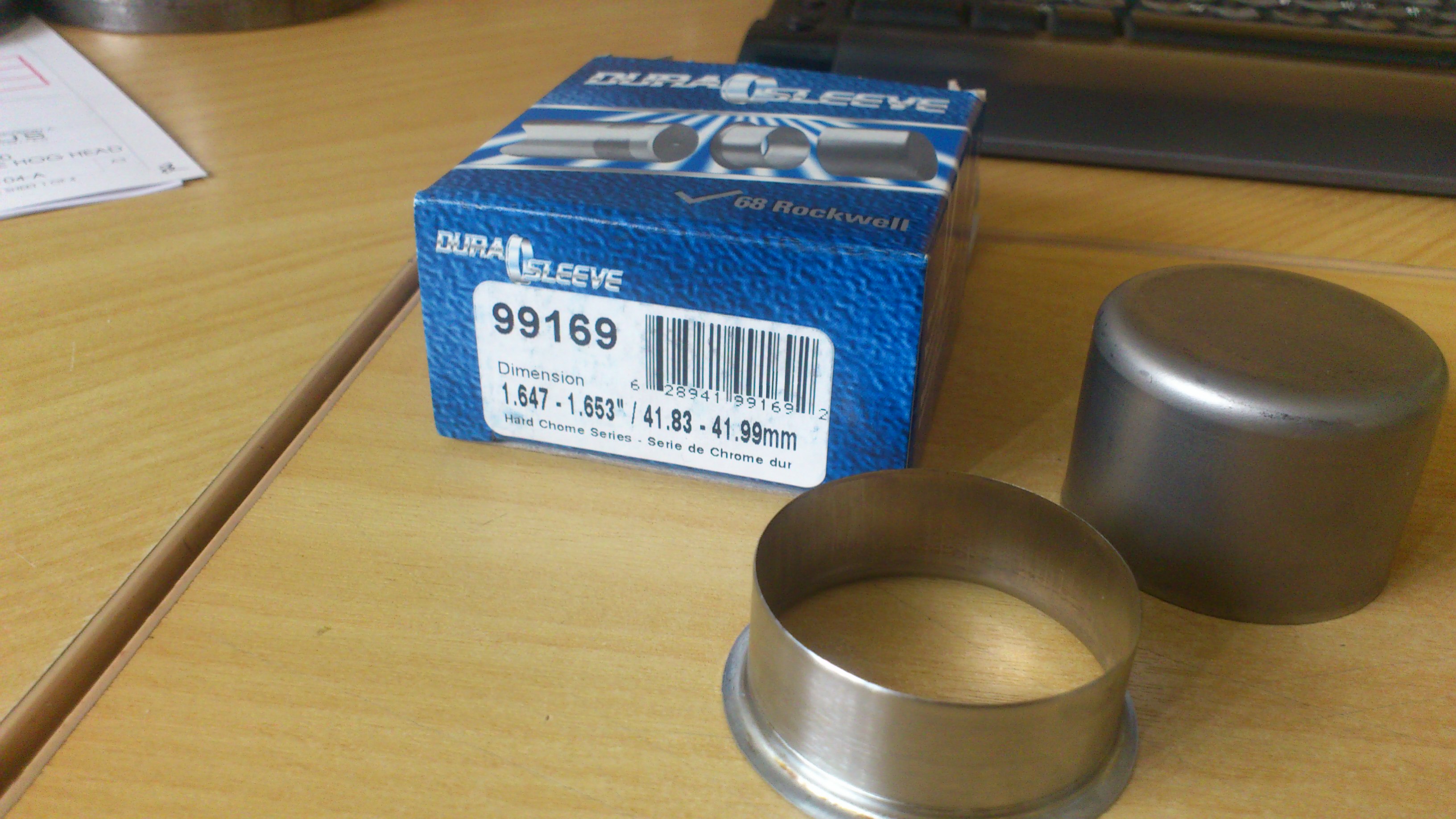

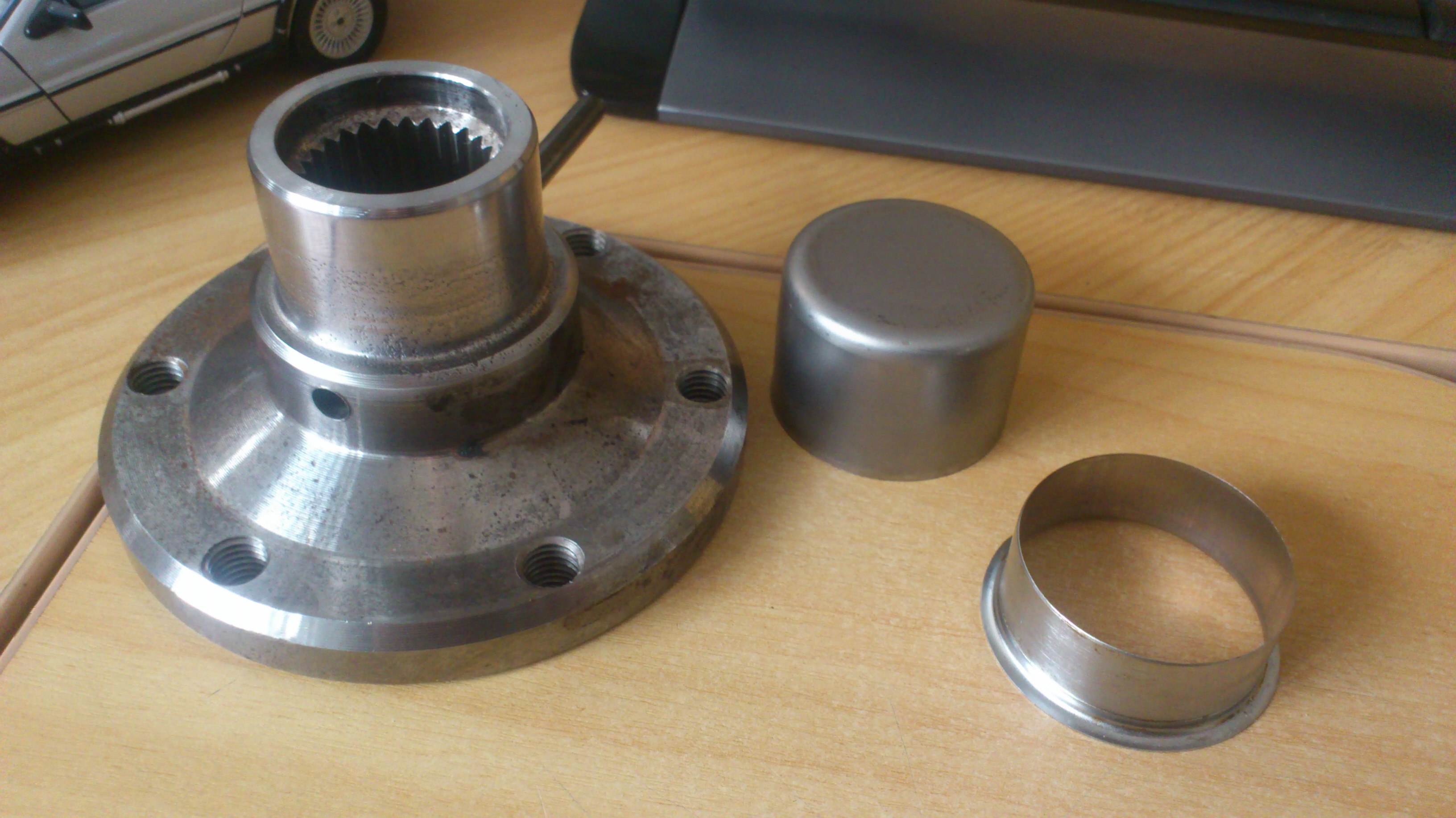

So after thinking that i'd fixed the leaking gearbox seals i found they were leaking again, i thought i had installed the wrong seals so i got some from the club which are the same as my one's, but the flange has a bit of slop and the seal face is quite pitted so the only way to fix it is to press a speed sleeve on which did the job.
so now i can enjoy driving it for the summer

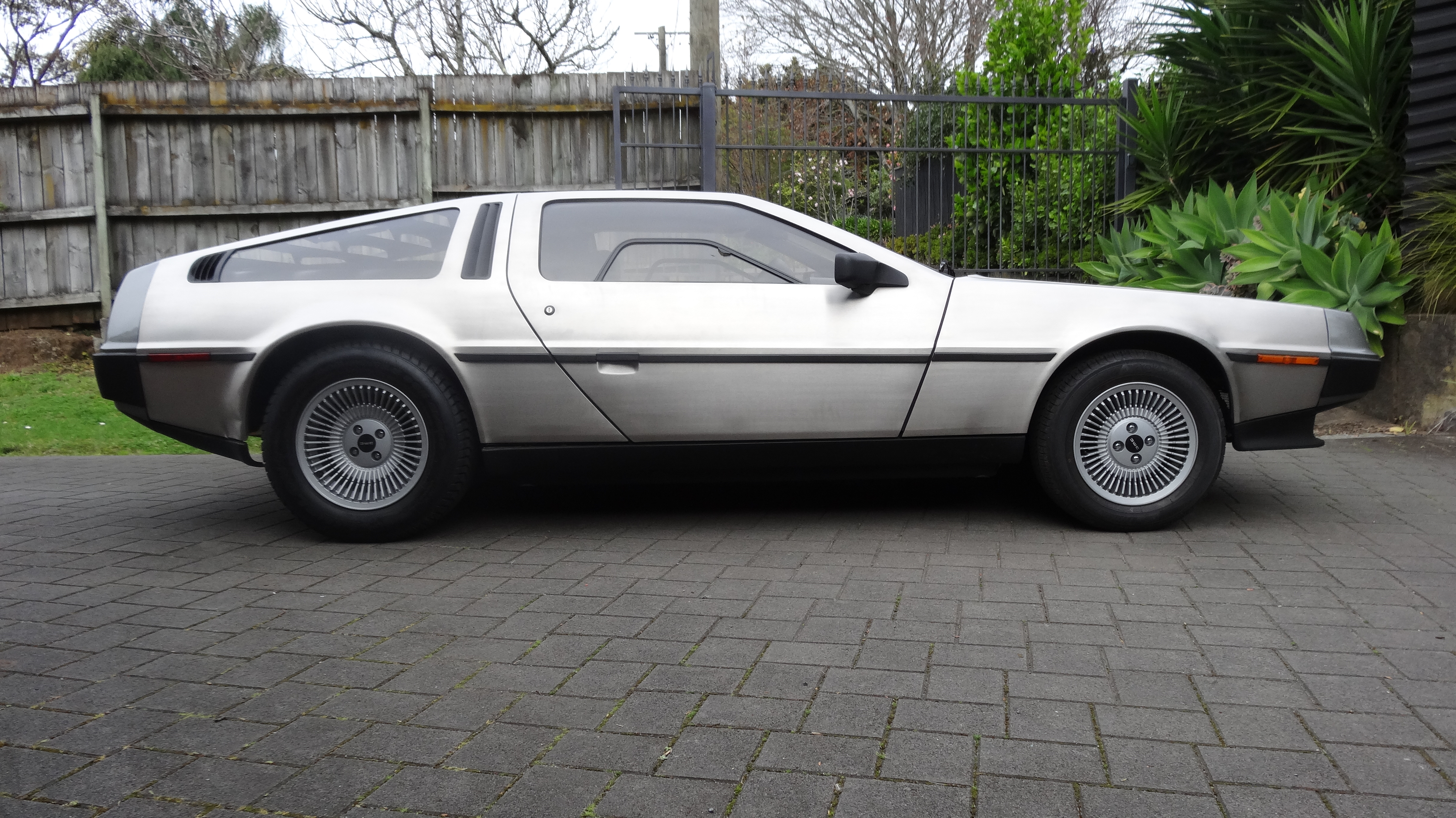

Postby gary290 » Fri Mar 03, 2017 8:43 pm
this what i started with

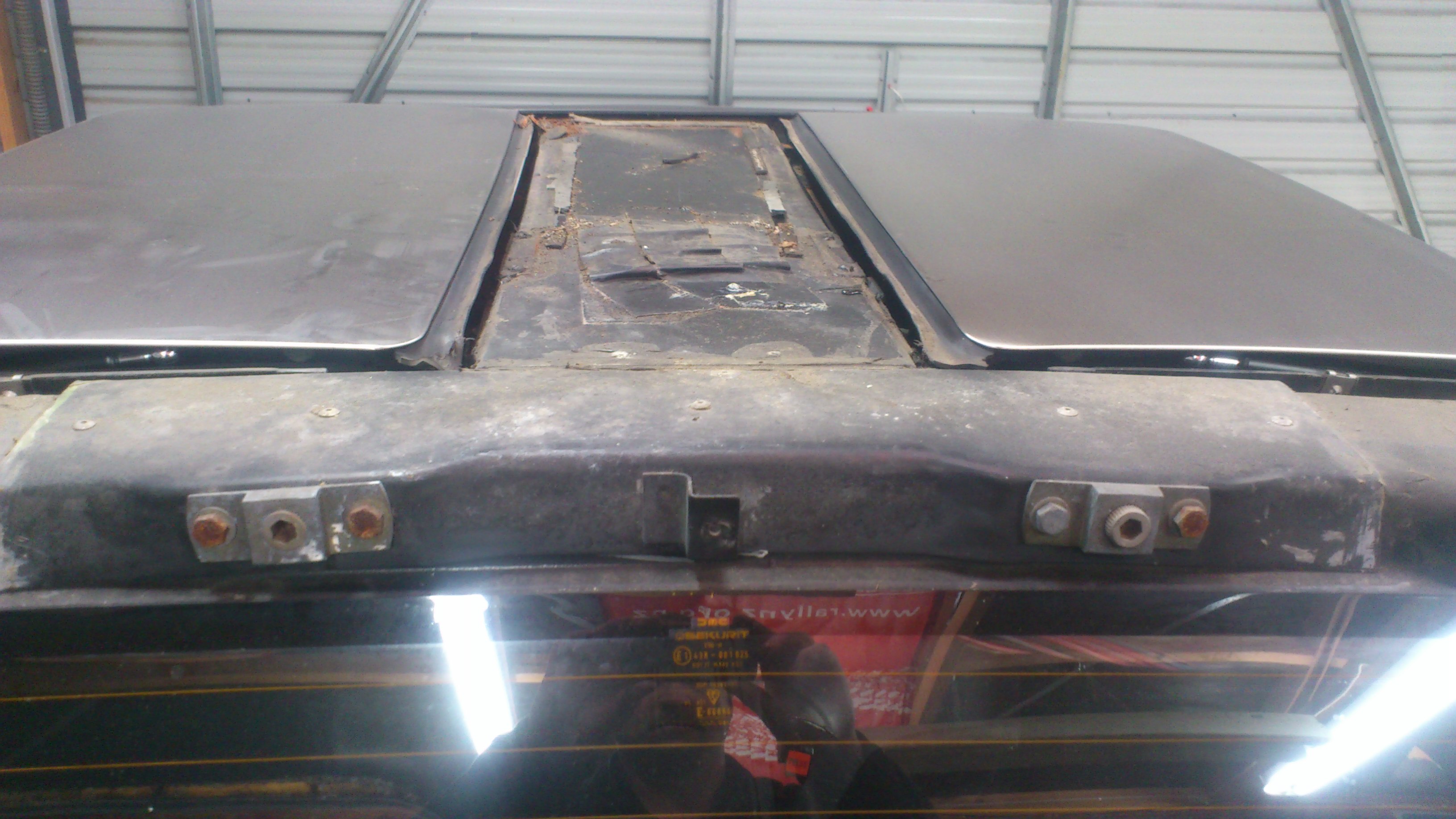

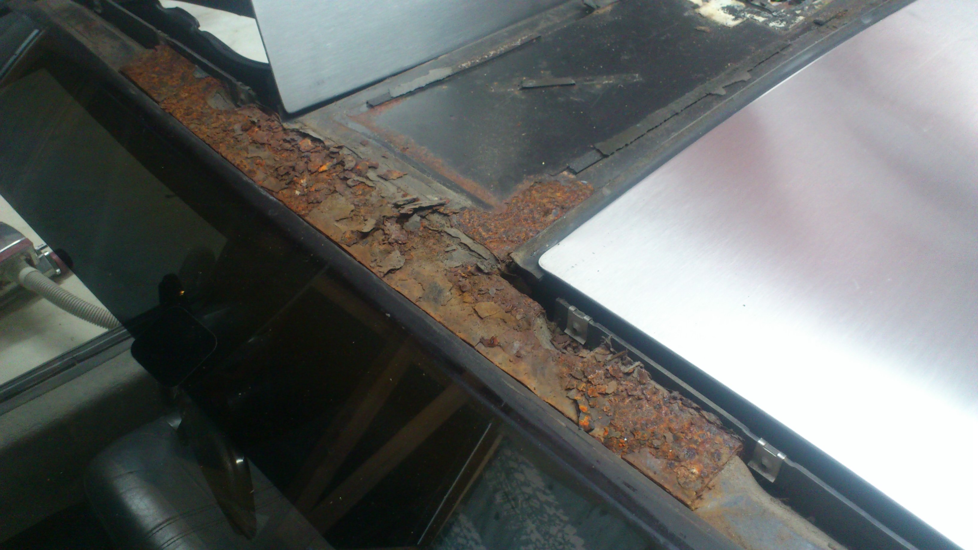

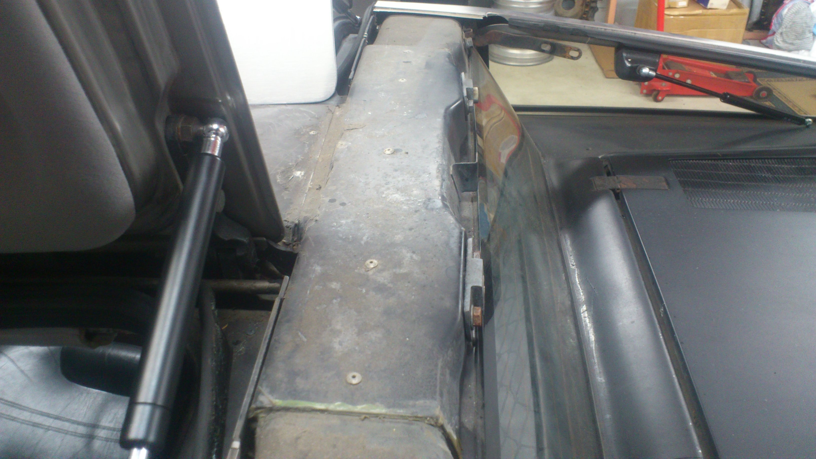

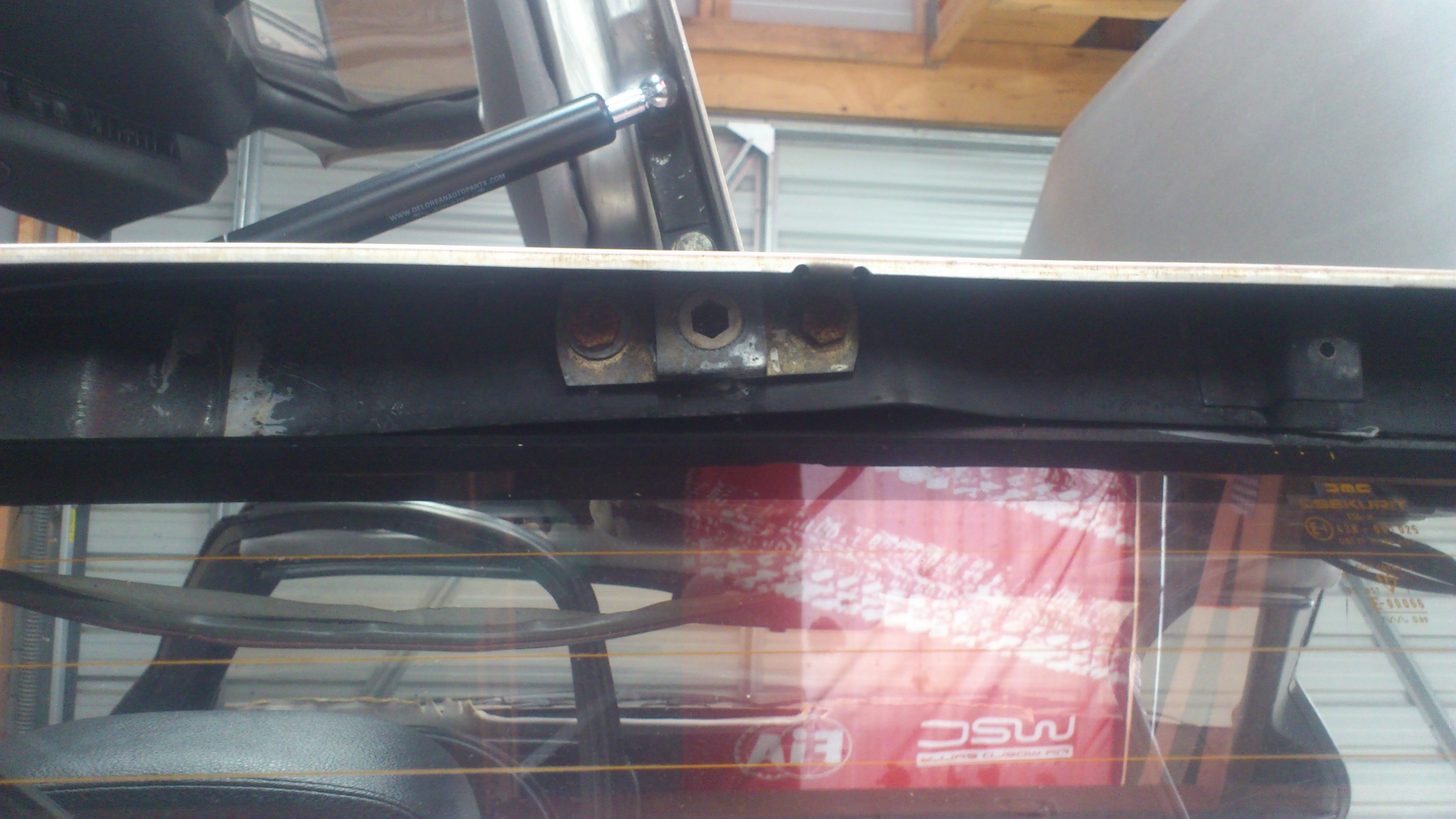

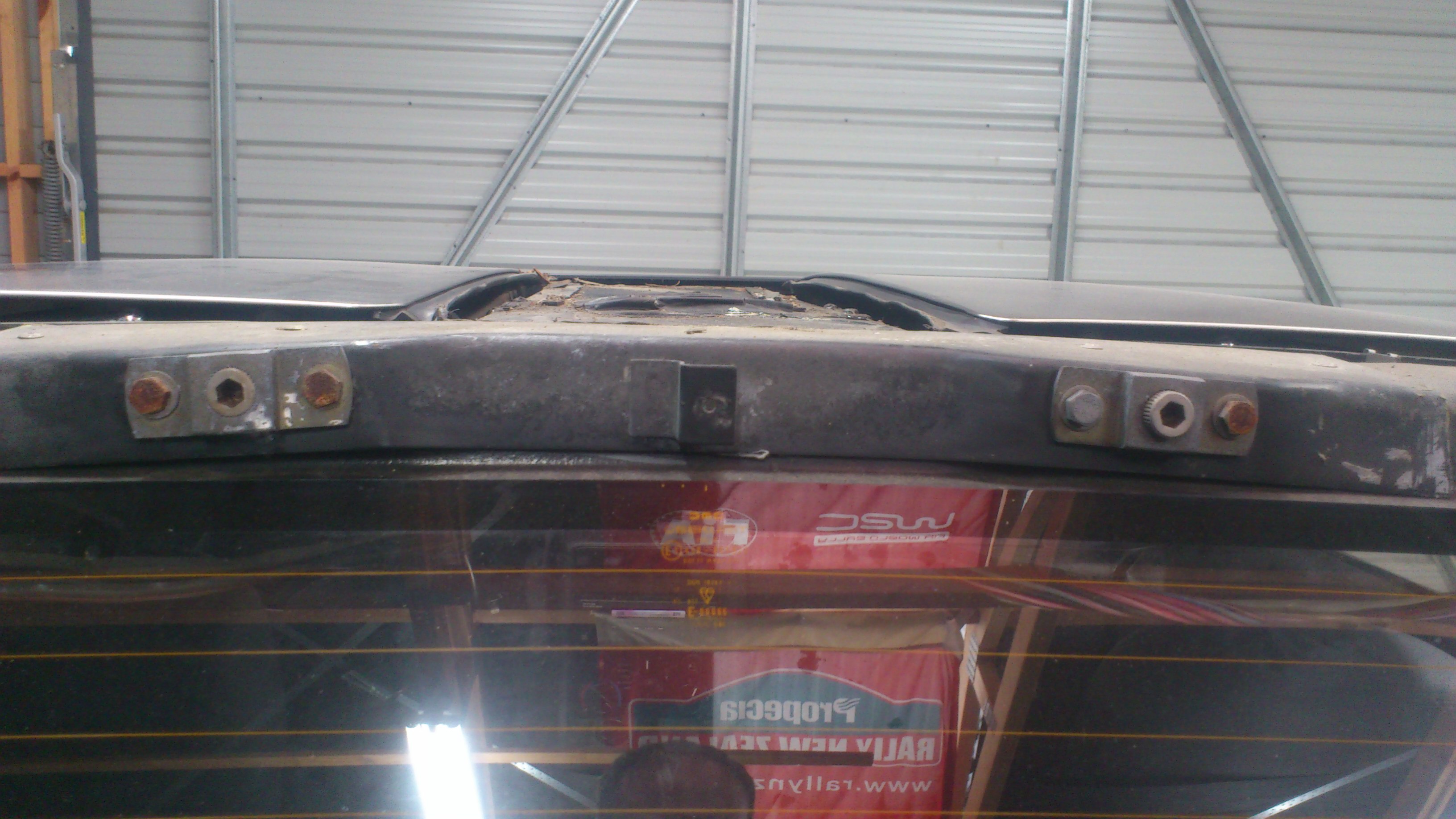

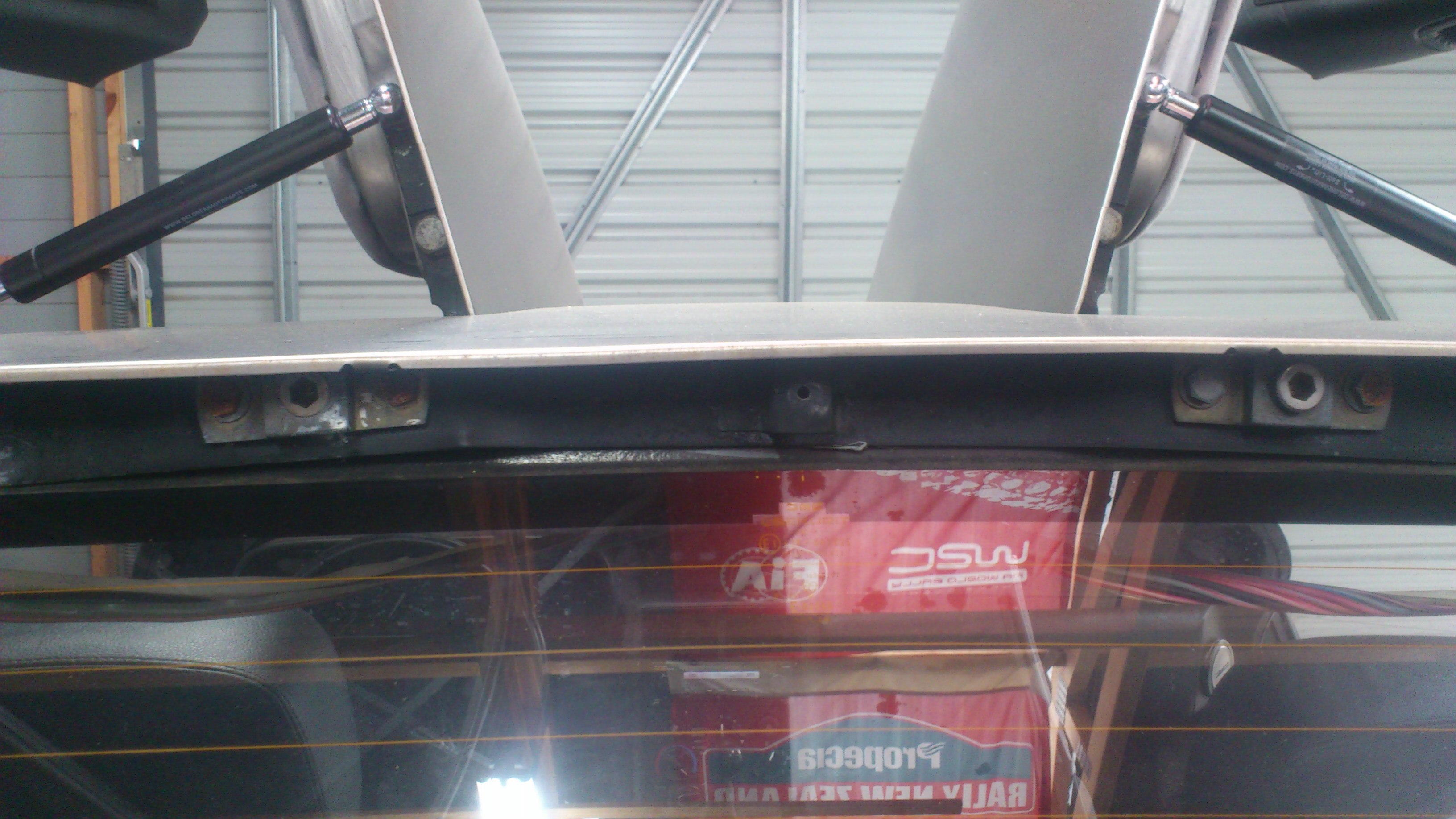

next job is to bolt down the rear roof box as it is lifting and has pushed out and broken the plastic covering panel above the rear window
some muppet has put rivets in
and the front part has a little rust
