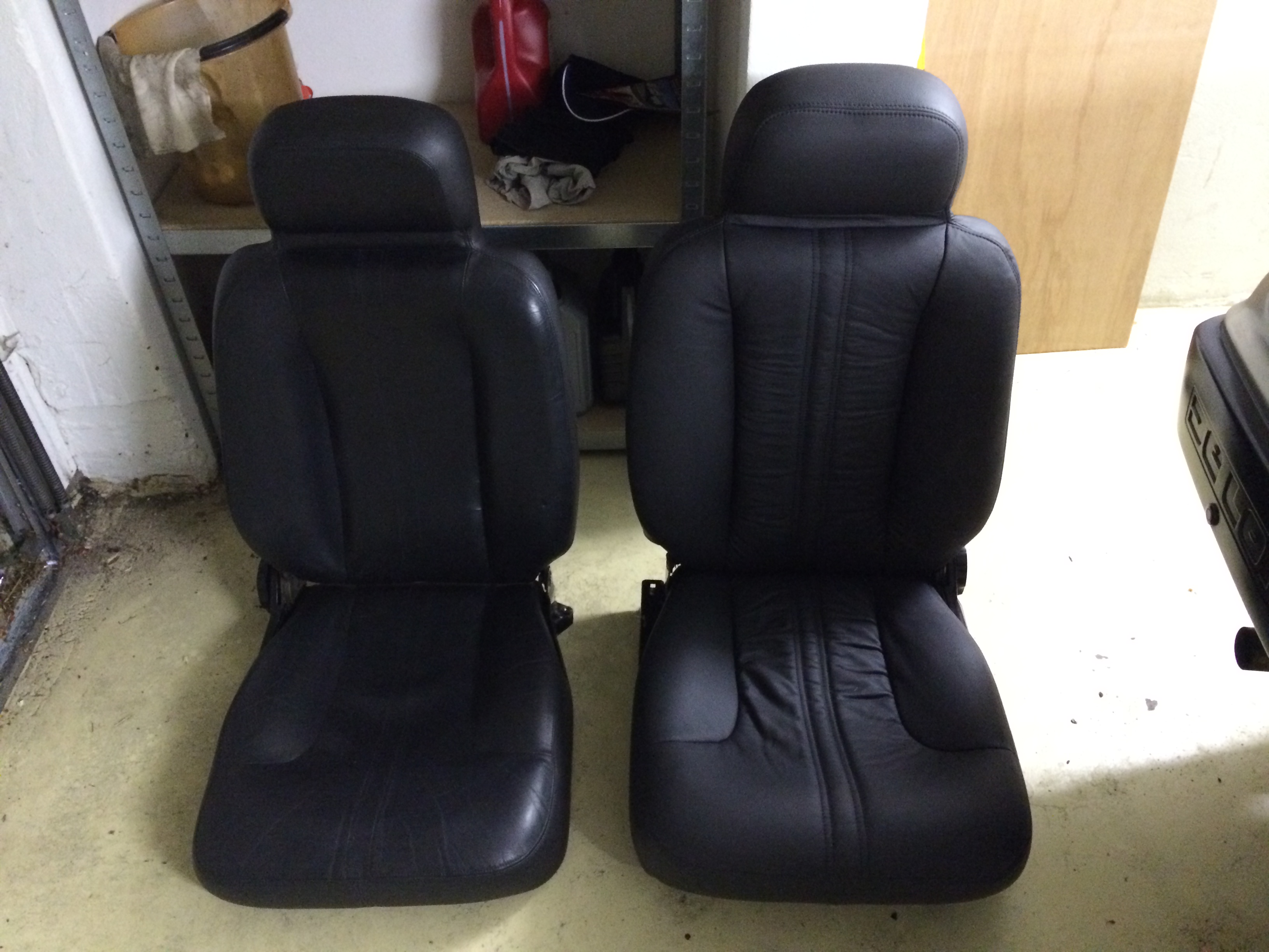

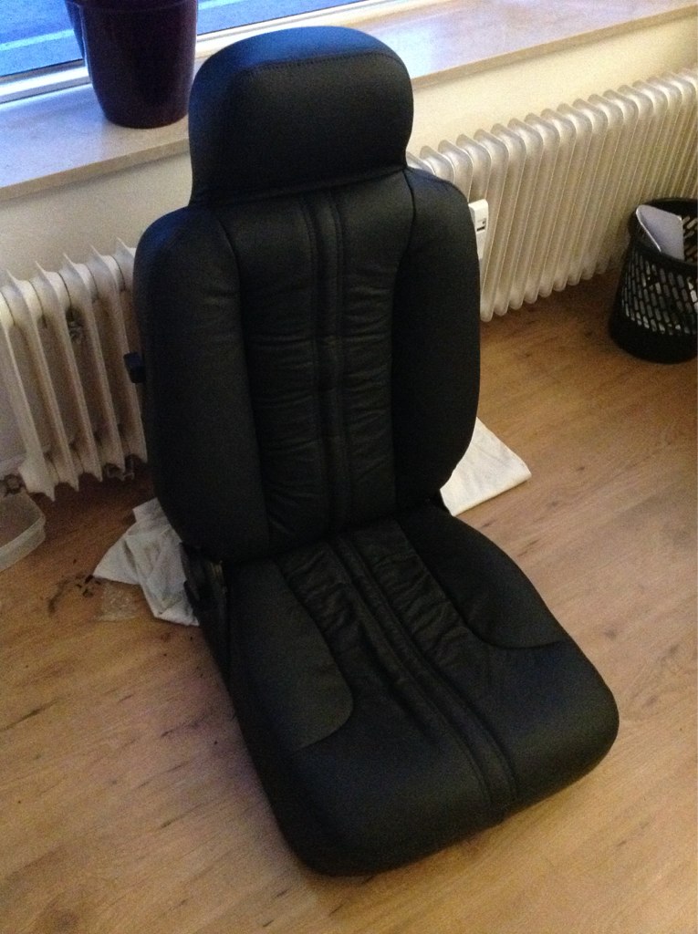

Postby RobvdVeer » Sat May 10, 2014 10:35 pm
One chair recovered fully and 'screwed up'. It turned out really nice. I'm keeping the other chair for next weekend. One tip i'd like to add, run some soft wire through the ribs of the seat back and the padding before you do the hog rings around, so you can easily pull them up in the last stage. Just like you do with the tie-raps really. Once you are ready pull the strings to tighten the back ribs and use the last hogrings to fix 'em securely.

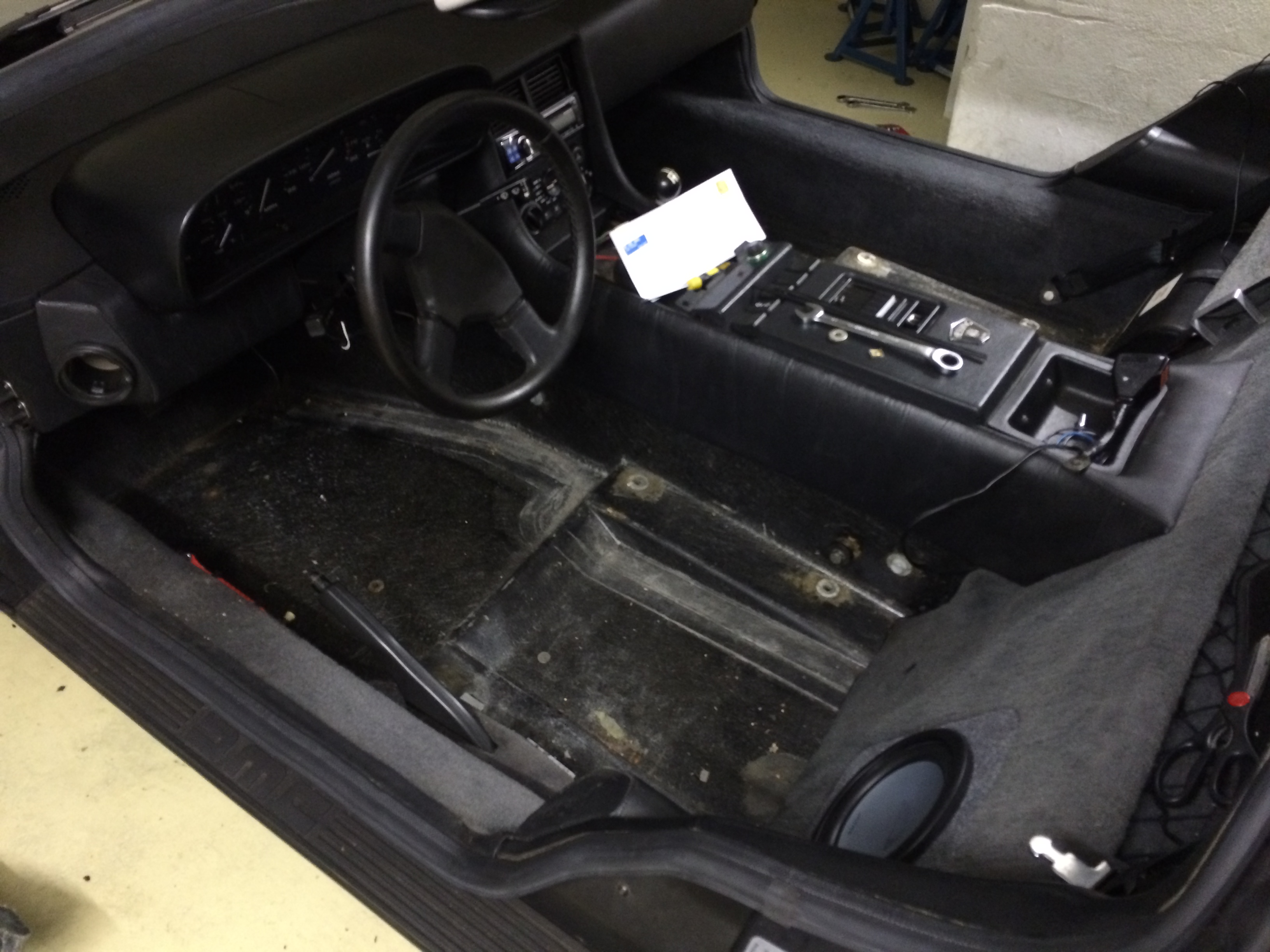

Postby RobvdVeer » Sun May 11, 2014 10:22 am
And so i've started early, getting out the other seat and removing the carpet. Hurray I found a treasure!
carpet out
treasure
Old versus new. It looks better in daylight.
Old vs New
Seeing there is NOTHING under the carpet (not even a foam padding), i am definitely going to use the Dynamat/Dynamat clone way. :dance:

Postby RobvdVeer » Sun May 11, 2014 6:49 pm
Babis, the left one is my original passenger seat. The right one is my old drivers seat with the new seat covers that I installed last week, which I bought at DMCEu (Ed Udink) over 2 years ago.
Postby RobvdVeer » Sat May 17, 2014 8:22 pm
Seat two has been finish too. Too-too-ketchoo. I'm out of energy to even clean up, let alone drag it to the garage.
