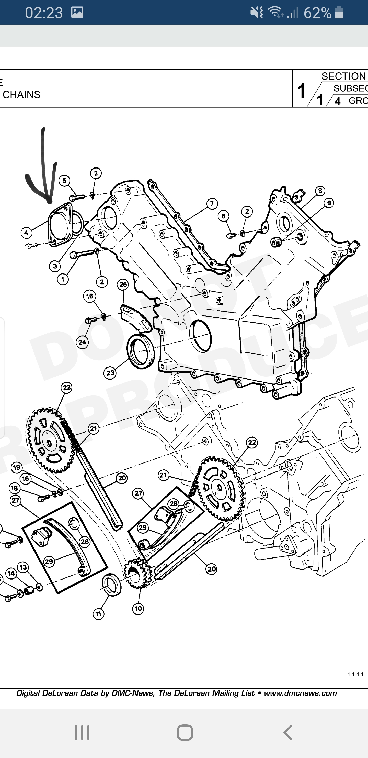

DMC1983 wrote:I would get a 35mm ring spanner on the crank pulley. You could use a socket but you would need to remove the muffler to do it that way.
What is that in the 2nd picture?
Will look for a 35mm something. The second picture is one of the bores

Postby DMC1983 » Sun Aug 30, 2020 2:34 am
The arrowed part is the blanking plate that A Van is talking about.

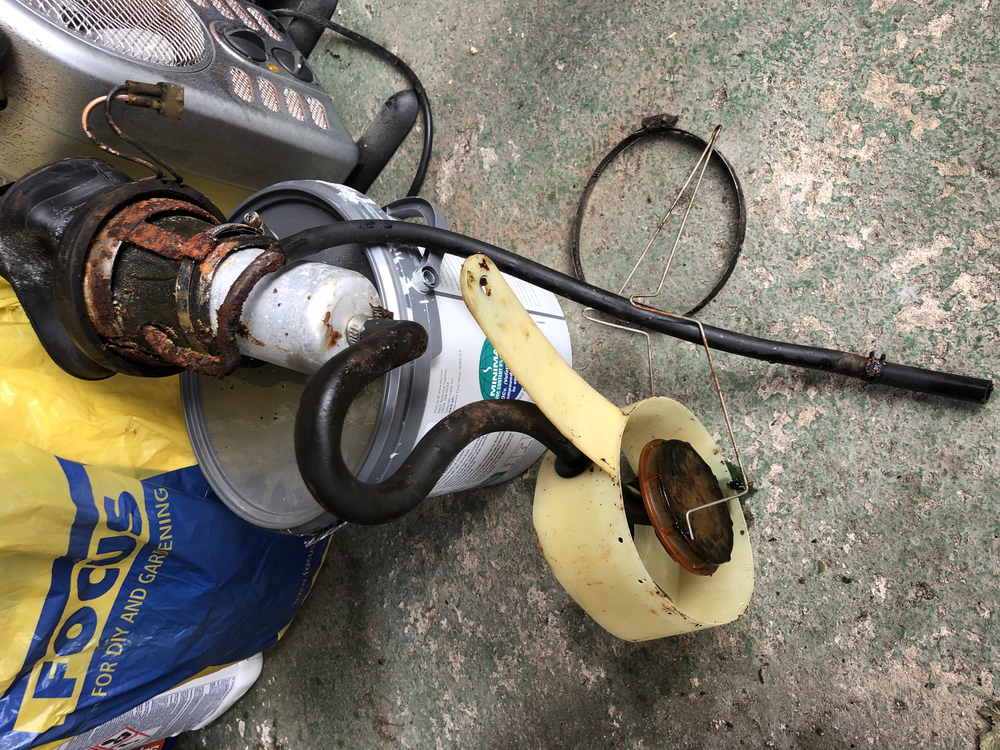

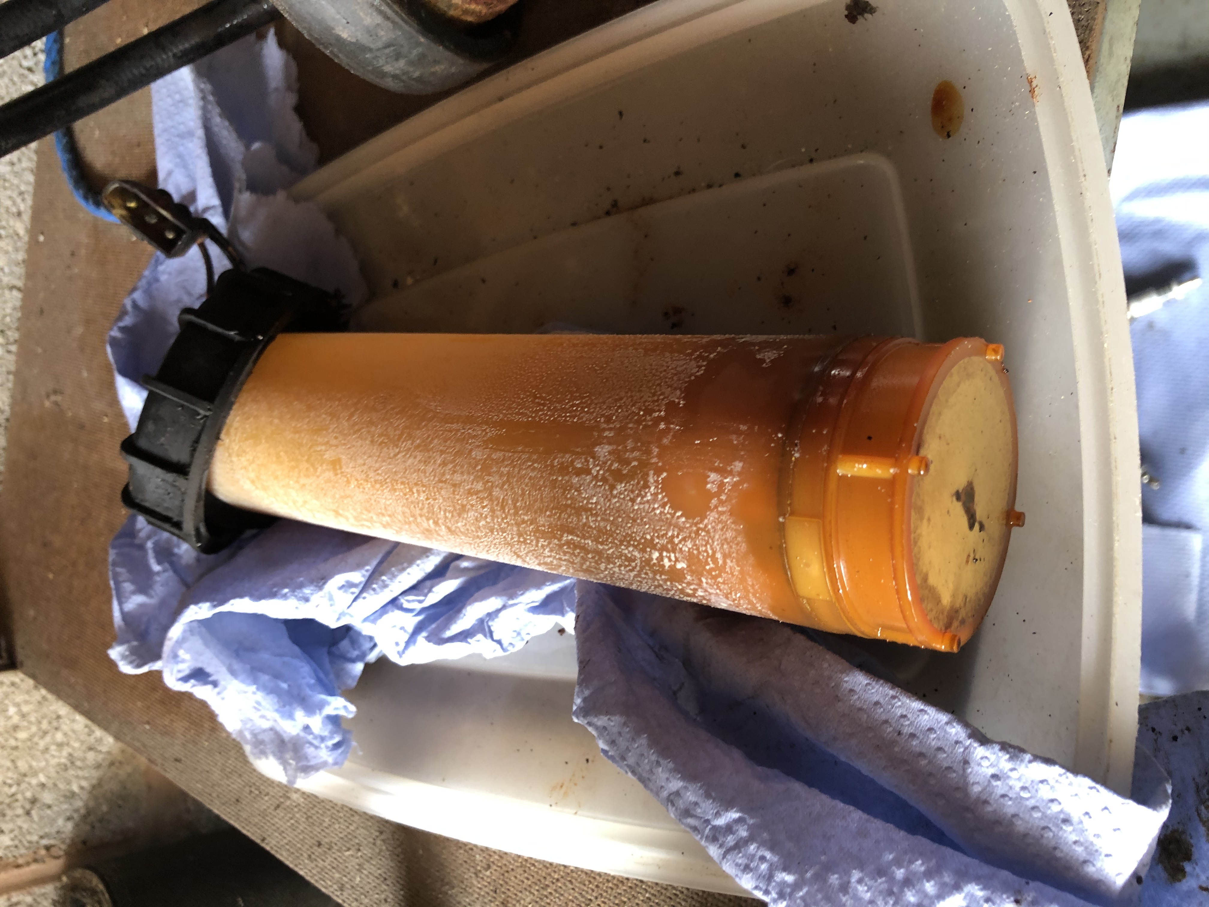

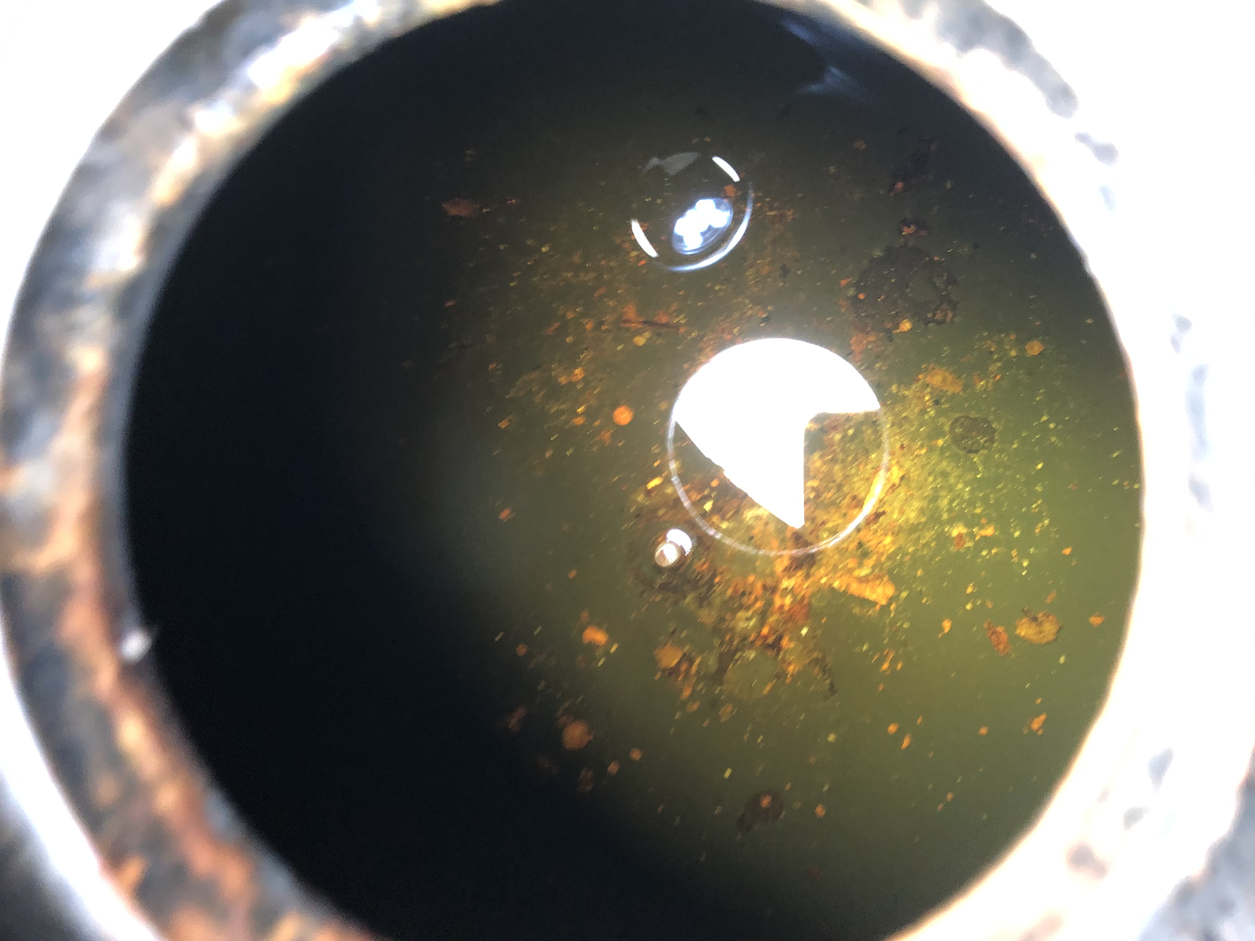

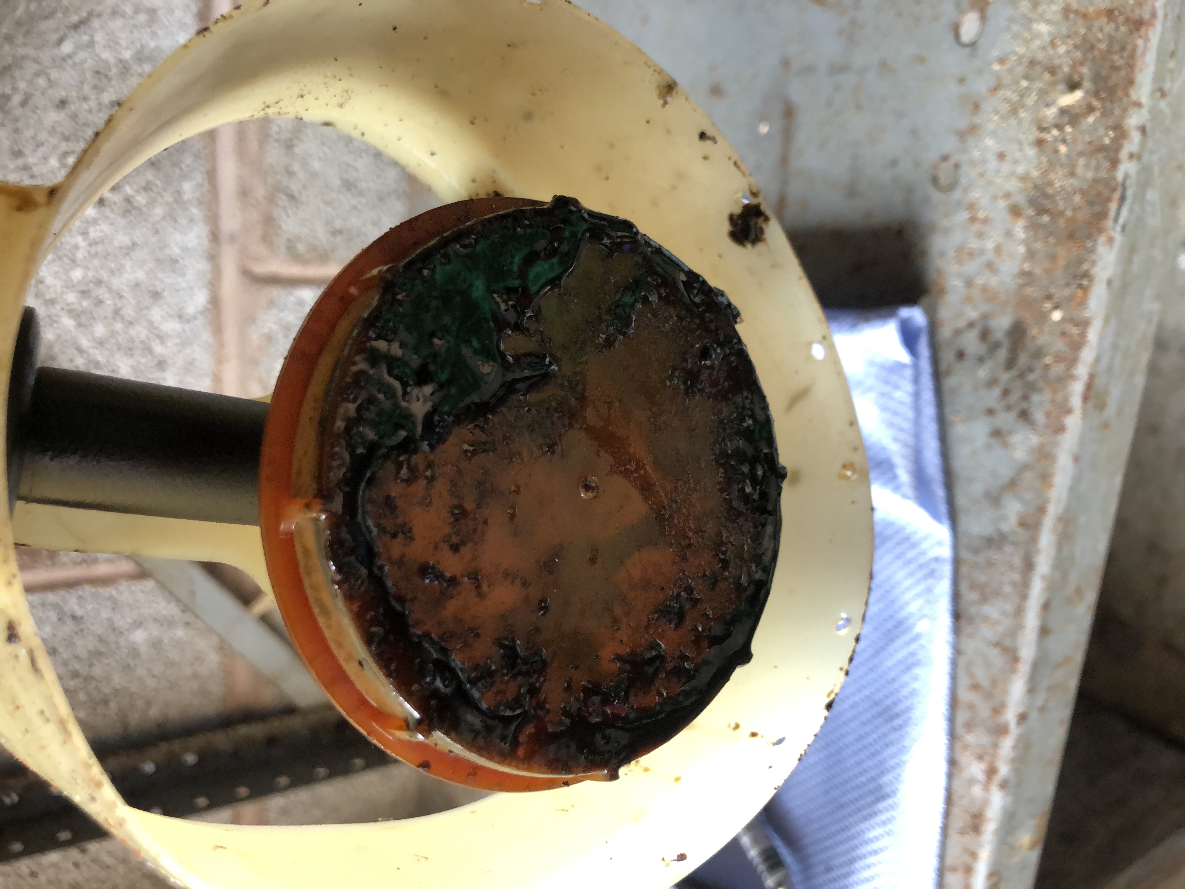

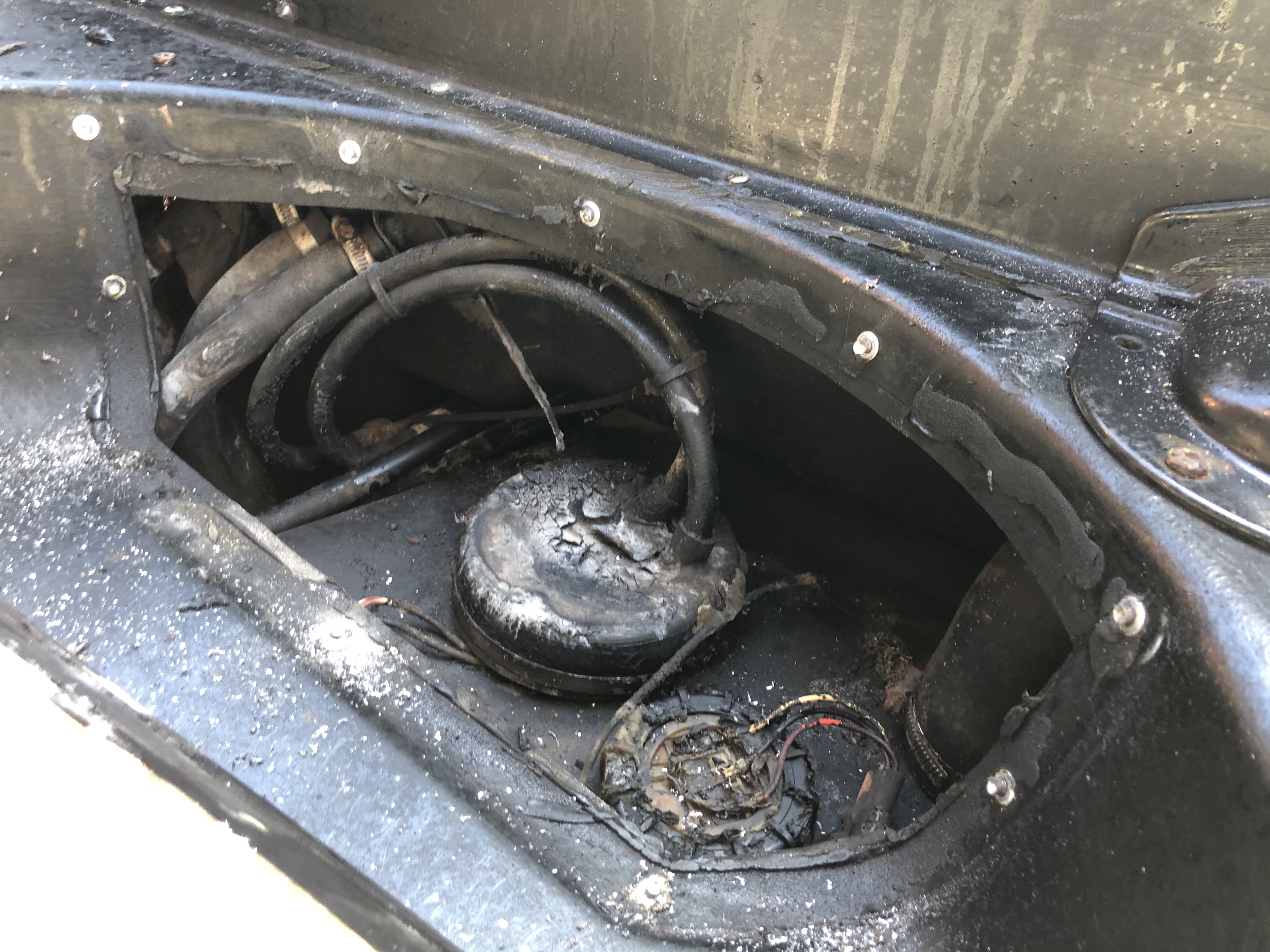

So another fine bank holiday. Most of the Engine bores are still full Or part full of WD40 (some has run out through an exhaust underneath or into the sump)
Thought I would finish the fuel tank inspection.
Had to drill out all the screws and to be honest I am quite pleased with what I have found With the pump and tank in general, after sinking myself up to my arm pits in stinky varnish!
Here you go
After but I still smell of varnish!
Before gloves and arms
Looks like it works
Nice
All the bits
Under cover

Postby eric » Mon Aug 31, 2020 5:05 pm
All too familiar, a very common sight......
Top job and good work. Get it syphoned out and a load of rags in there to clean it up... But before you go dislocating your elbows for this and other jobs, if you are going the whole hog and lifting the tub off the chassis and engine out, a lot of these jobs suddenly get a lot easier.
