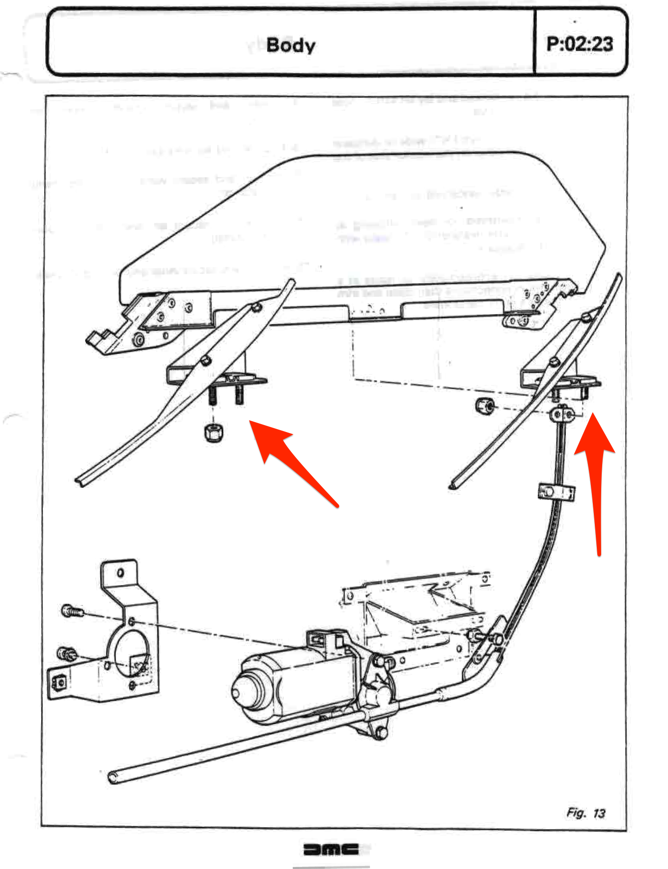

now if somebody could point me where those two adjuster bolts are from #32, that would be nice.

Postby RobvdVeer » Tue Jun 10, 2014 8:53 pm
RobvdVeer wrote:
32.Motor has been mounted. Before raising and lowering the window , loosen the two rear window rail nuts, raise and lower the window two or three times with the window switch for self alignment of the rail.
Found em:
Postby RobvdVeer » Fri Jun 13, 2014 6:22 pm
Another day, another weekend.
I just spent one hour in the garage to get that window permanently back on track. Letting the rails adjust themselves did the trick. I loosened the 4 nuts mentioned and ran the window up and down a few times. Then I tightened only the front rail and repeated the process a few times to see the required amount of play. I'm very happy now. I decided to stop playing and get clean.
