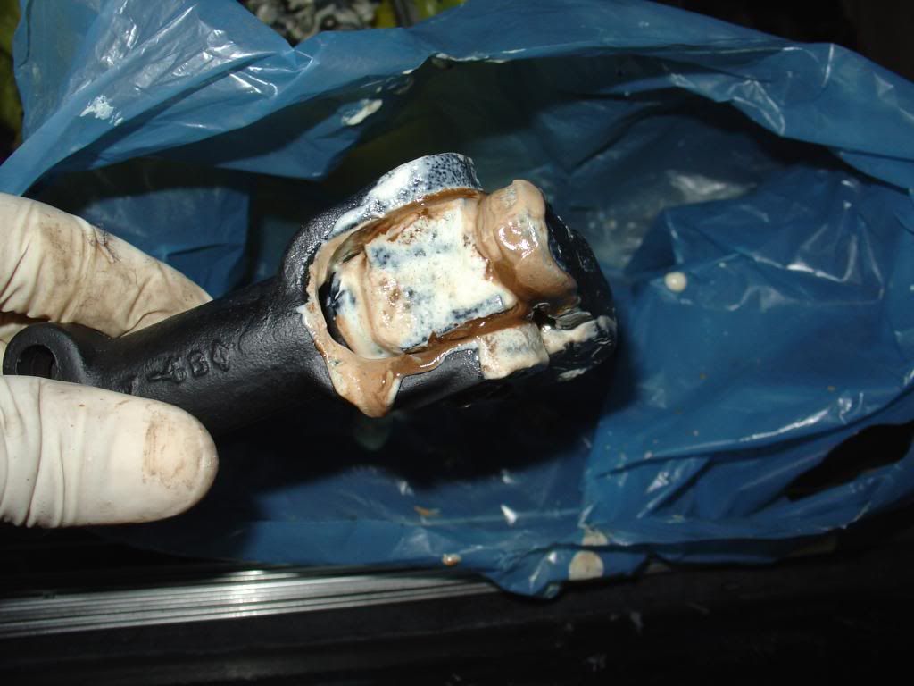

Do consider a weekend joint grease change if you haven't got a clue when it was ever done on your D.
It is a minimal cost job, yet pretty messy. Have plenty of paper at hand or old clothes for it.
Minimal skills required.

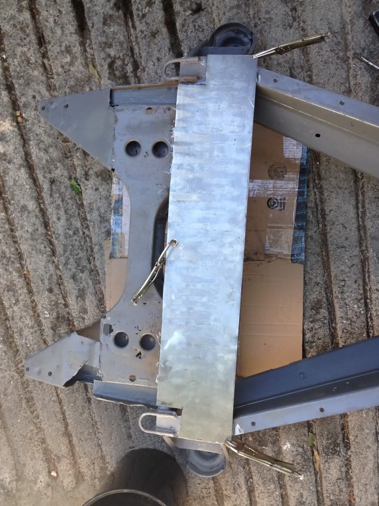

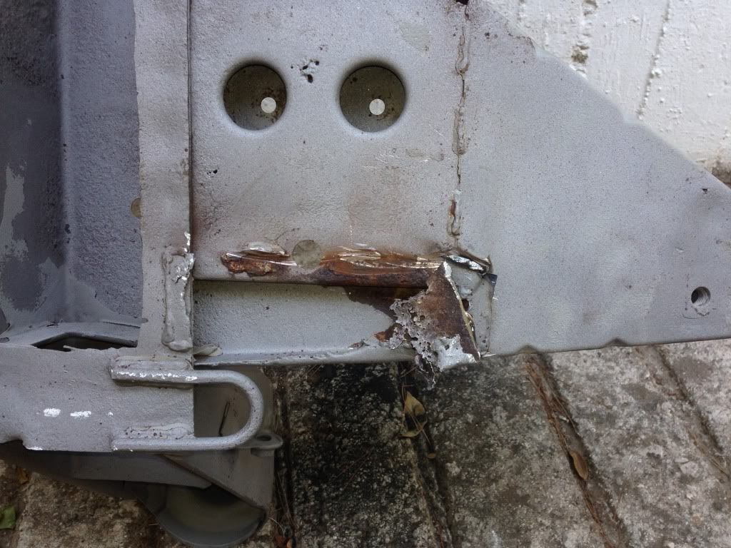

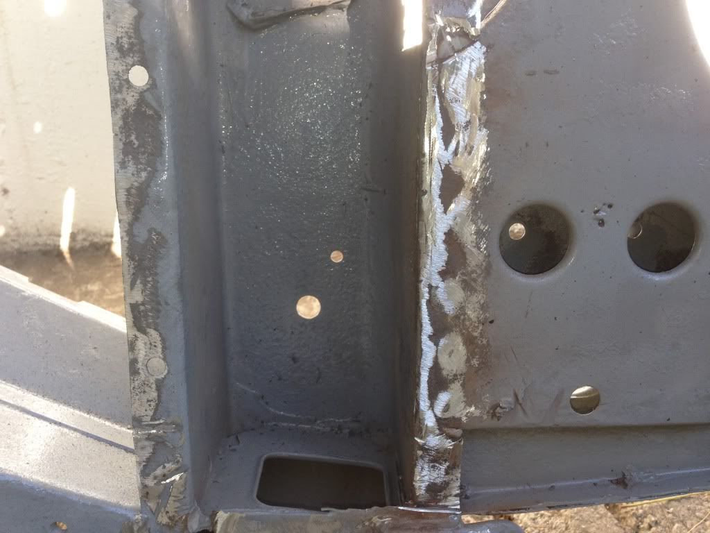

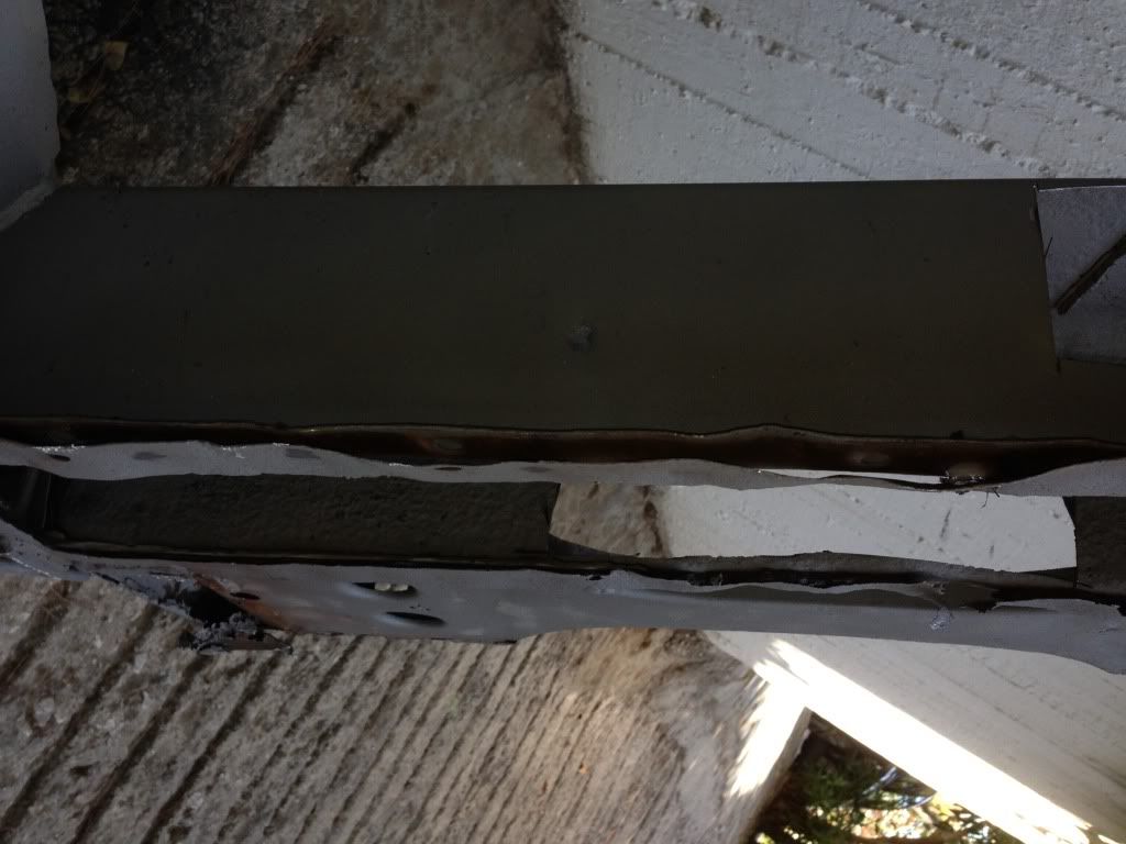

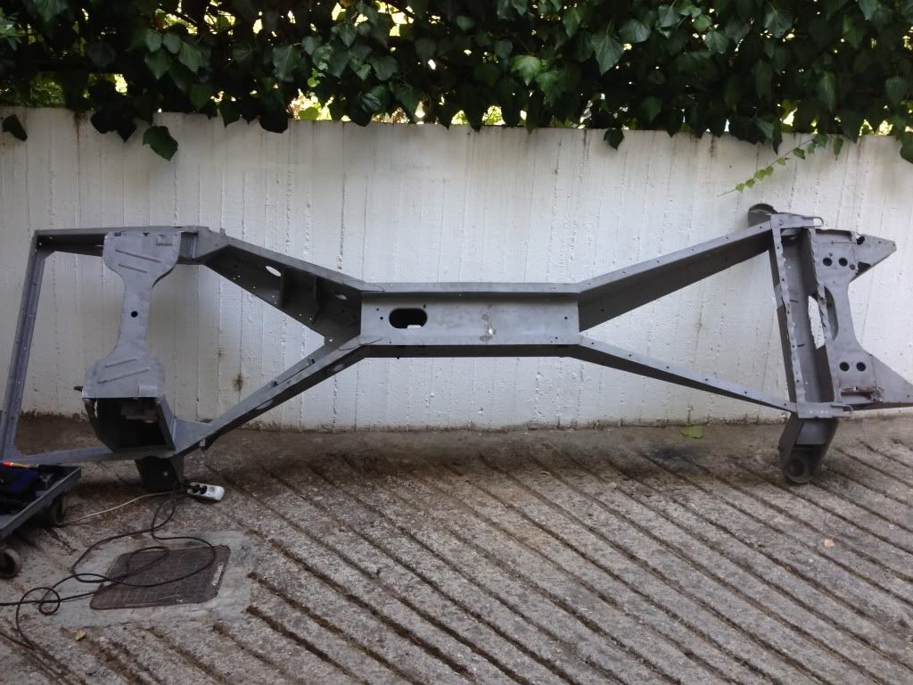

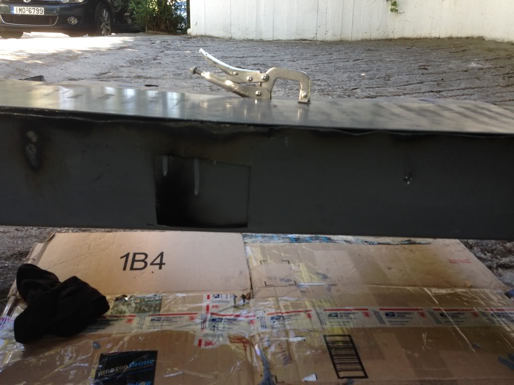

Placed frame against the wall to have a better working angle of the lower side and most rust affected.
Started removing welded covers to clear of rust.
Rust be gone
this is a very slow process cause I needed to paint the interior parts with antitrust primer. and the each part that is to be attached from the inside also.
Forgot to take a picture of the internal column I added for stability and durability (adds also about 4 Lbs to the front of the car :P) Hence the welding spots.

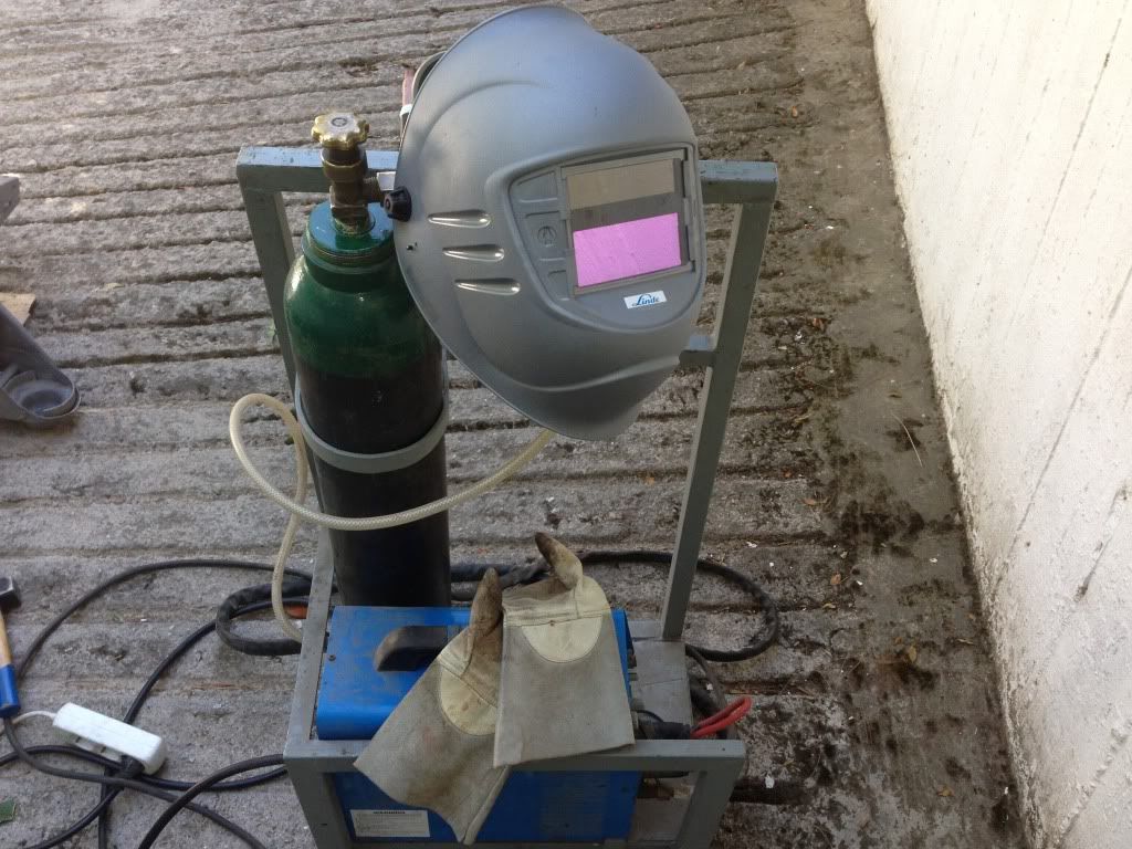

Speaking of welding... my TIG tool
and finally the first front cover of the frame. Two more to follow at the front tips for stability to strengthen them.

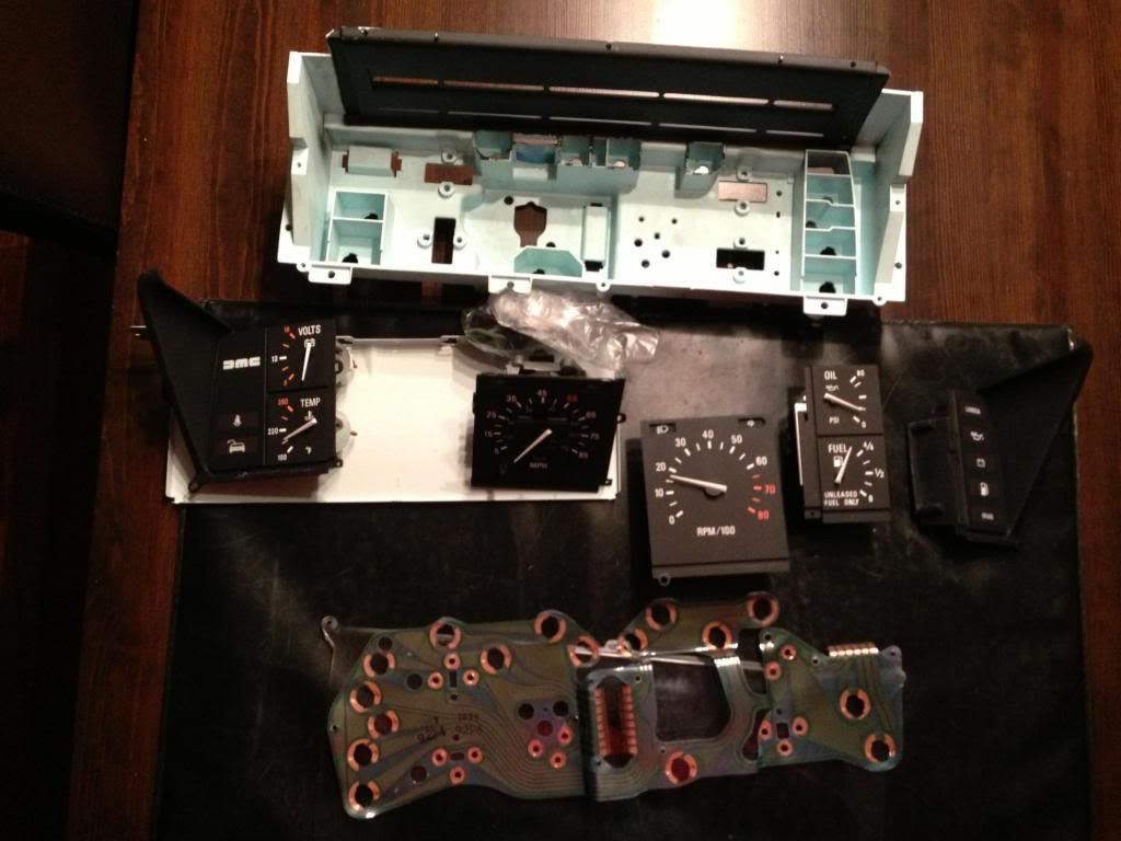

First, did a quick gauges refurbishing. Well, I was hearing a clinging noise inside when I sway it around and seemed like something was loose. Fortunately it was just one of the anchors that hold on to the temp gauge. No biggie.
So I also exchanged all bulbs with LEDs...

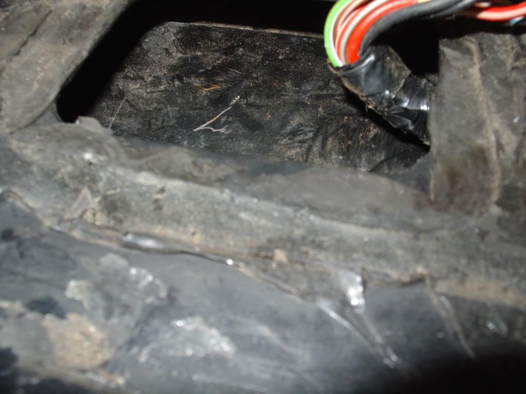

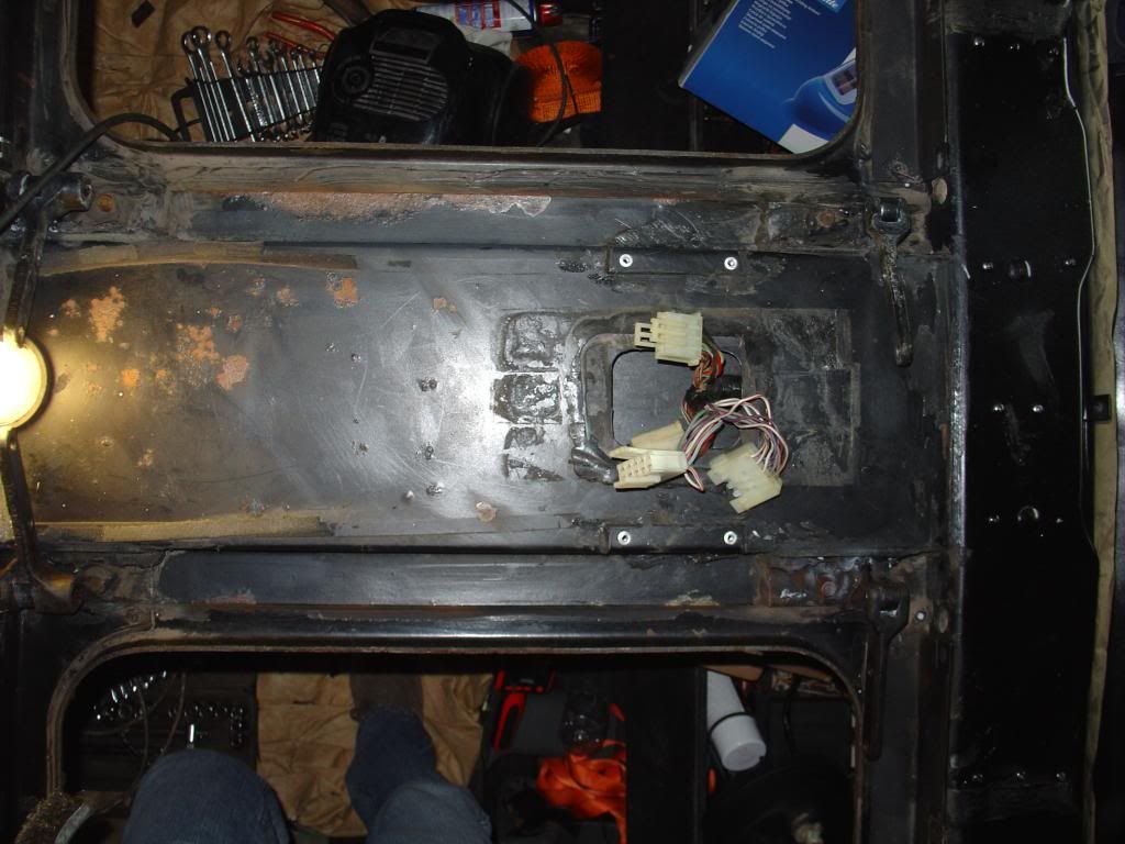

On to the garage, I took a look at the rust friendly roof under the T panel. To my surprise, that is one of the VERY few things, that was almost rust free.
With the doors down, I too the opportunity to clean it up from the minimal rust points and prepared for painting it tomorrow.
Lubed the door hinges.

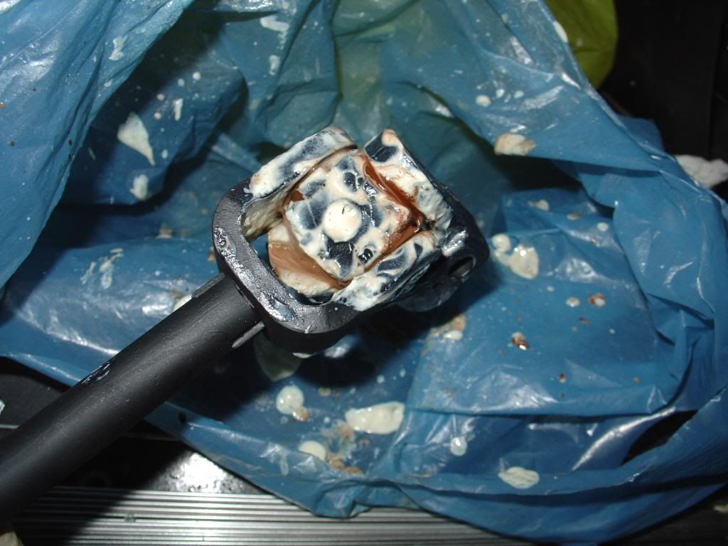

While I was at it, I also lubed the steeling column joints.

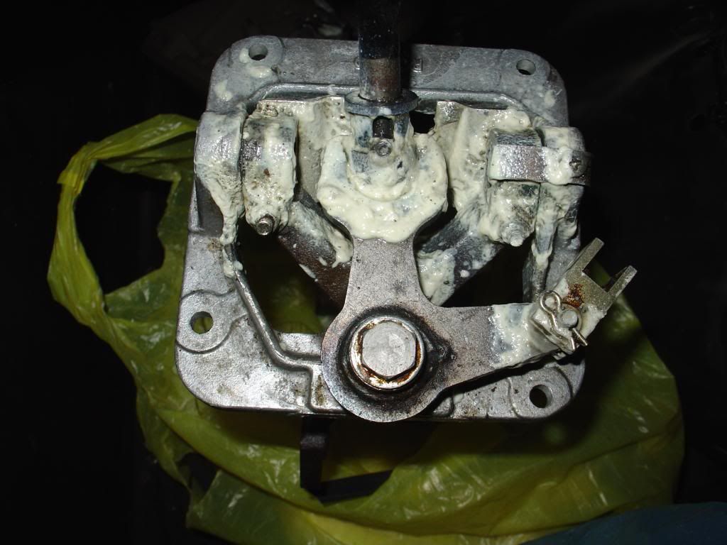

Sprayed the lube
Moved the joint frequently to have the rusty joint's juices come out, cleaned it with a cloth, and the resprayed it. That I did over and over again until no more brown stuff came out.
Did the same with the gear selector.

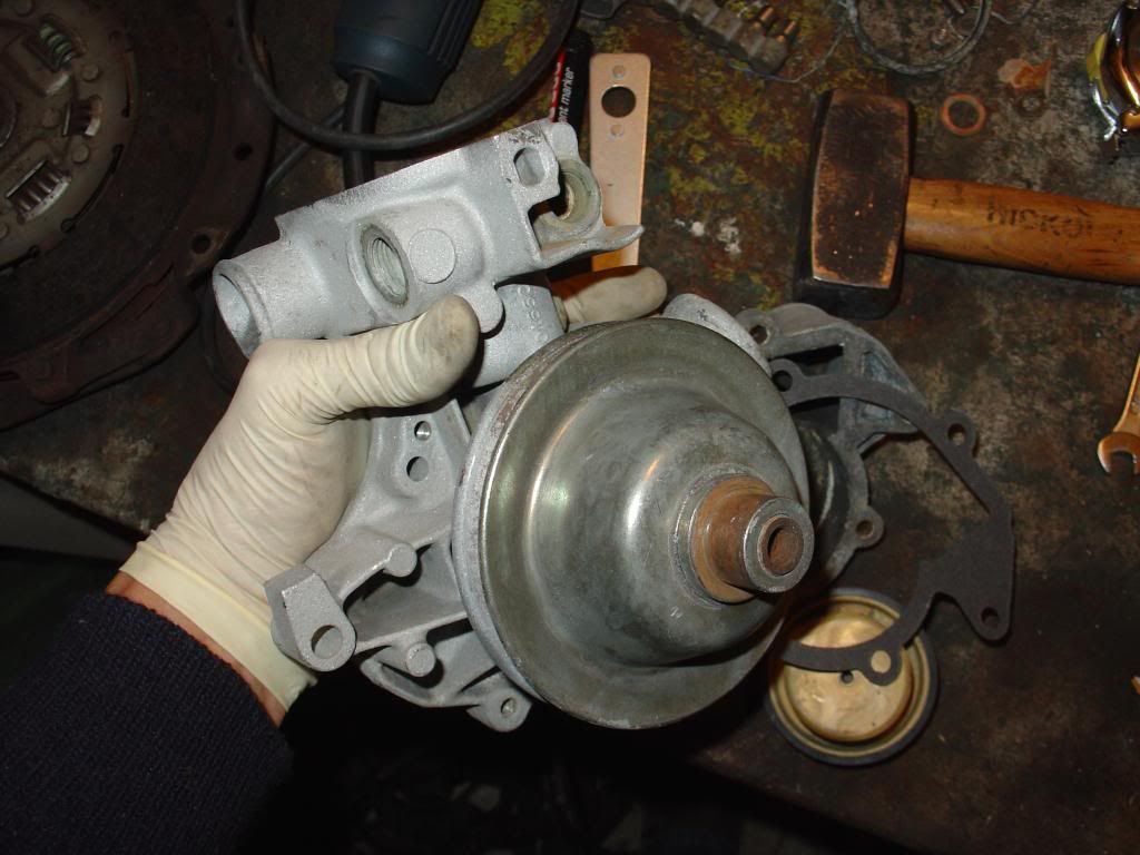

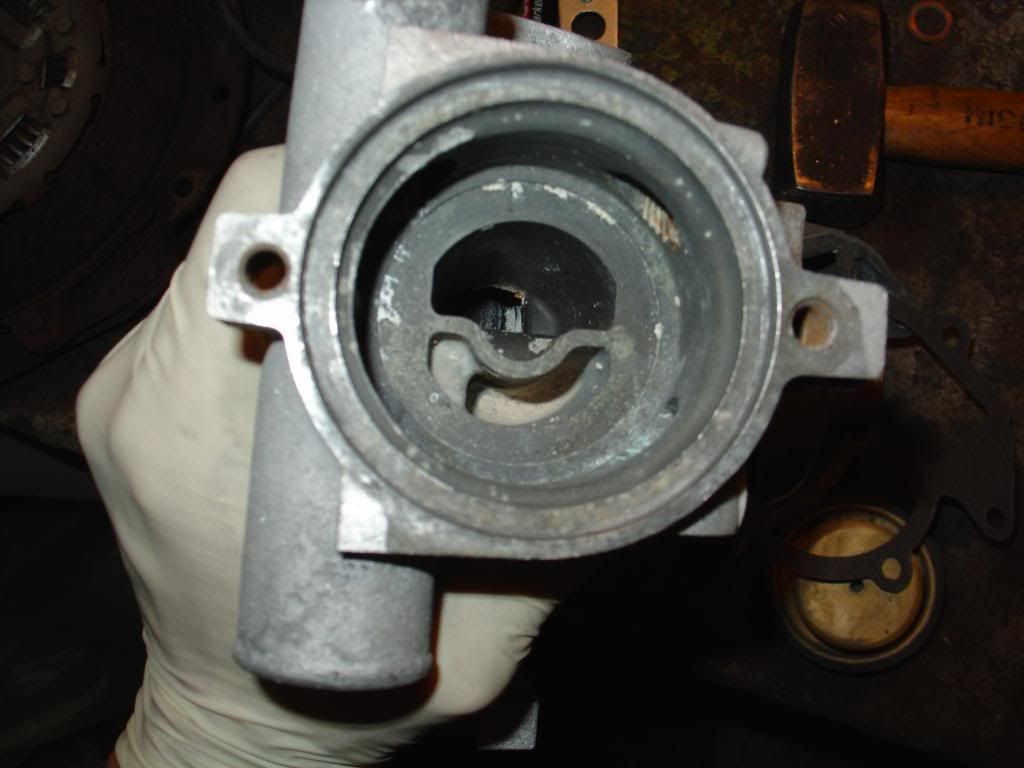

Did then some bench working by cleaning out the water pump adding new seals and gaskets
WANT A BEFORE IMAGE?

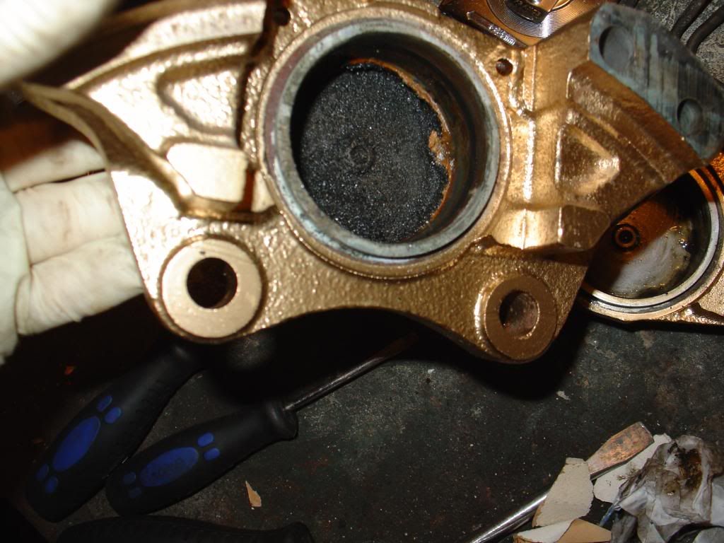

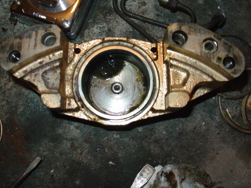

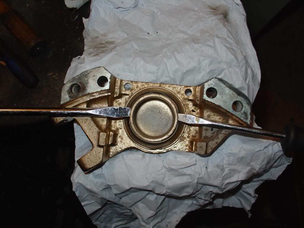

Finally, got down to removing the brake caliper cylinders. Nothing pretty in there either....
And the process of HOW TO remove that cylinder;)
Easy peasy! Just take two screwdrivers and leverage them out slowly. (An article I read mention it was a big issue. Not really)
