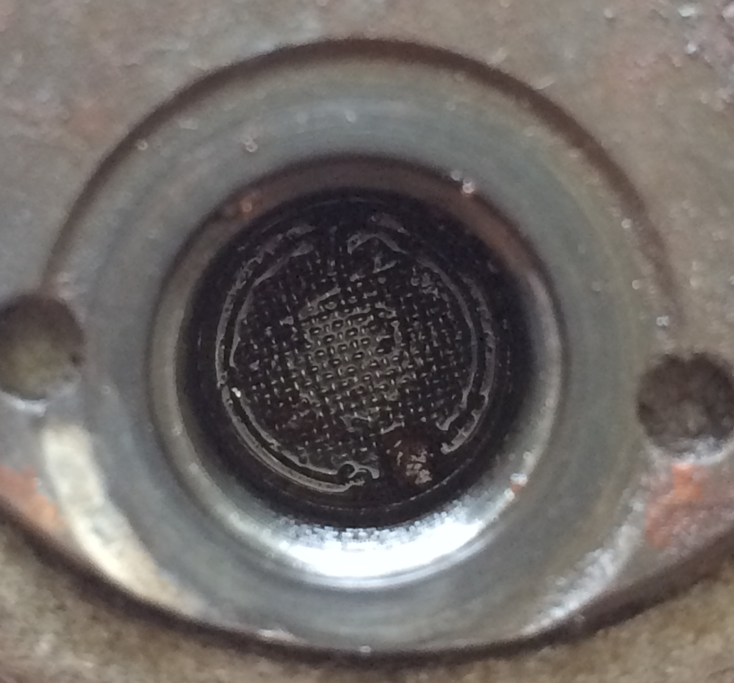

Postby Horsebox » Fri Aug 22, 2014 12:00 pm
I just pulled it off the car and this is what it looks like....

Horsebox wrote:I just pulled it off the car and this is what it looks like....
that looks clogged to me, have you got an air line and clean it out???? there not that hard to strip down and clean

That looks like it wants a clean, I thought I had a spare I could lend you to at least try but no I have some fuelling stuff but it's all old an needs refurb

Postby Horsebox » Sat Aug 23, 2014 7:03 pm
Thanks for the kind offer. I've put the regulator in the post to for Ken Mills to work some magic on it...
I'll have to get at the fuel tank in the interim to make sure it's not going to get recontaminated when it's plugged back in.

Take a look at your fuel filter as well, maybe worth changing
