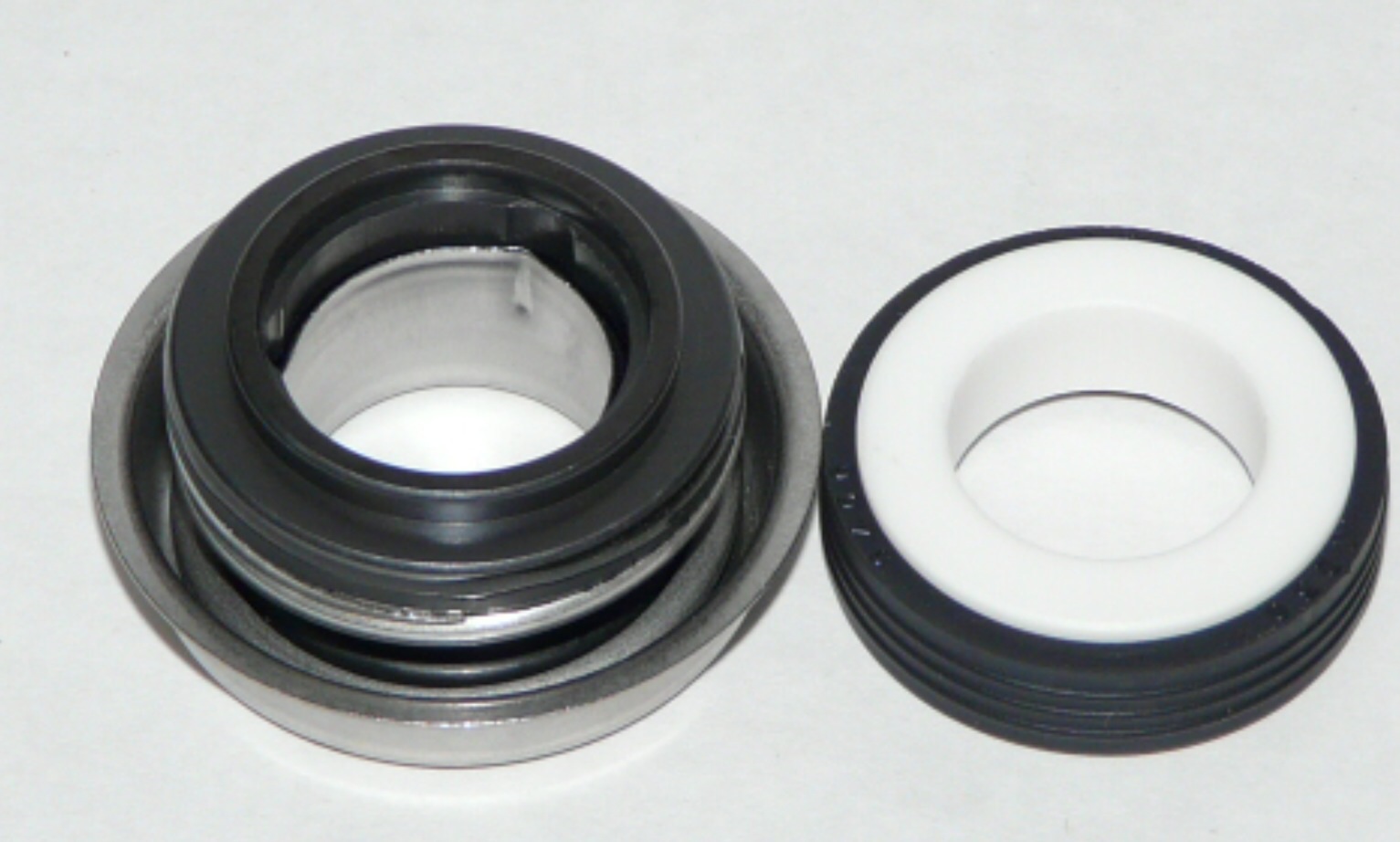

No, that type of seal is not the one you want.
The problem here is that different manufacturers have different references for the different seal types, unfortunately I am not at work this week but when I am back in the office I will ask my store man for some cross references.
In the meantime, here is a photo of what it looks like, as I say, you will not need the ceramic seating (the part on the right)
Did you speak to a local bearing supplier as I suggested?
With all of this information I am sure that they will be able to help
Oh, one other thing, if you are going to attempt this repair, pay a little extra for reputable brand bearings ie FAG, SKF etc and don't be tempted by the cheap Chinese products on the market.

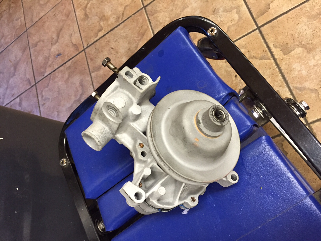

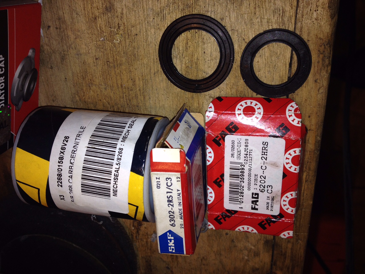

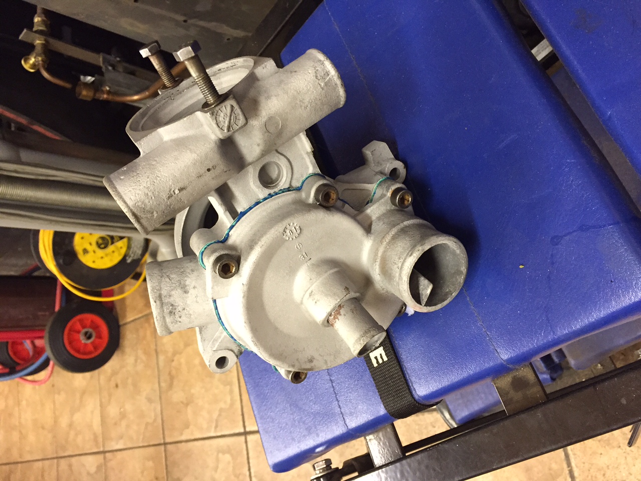

Postby btk65 » Thu Sep 17, 2015 6:55 pm
Hi DBro 2 Signing in
Here's a couple of photos of the pump we refurbished and one of the parts in their boxes if it helps. As Mike says we hope to post a "how to" on the forum and we have the feelers out for a donor pump so the club can benefit having a spare to send out as a part ex perhaps.

Cheers Barry. I'll have a snoop around with those numbers too (black and yellow container)
