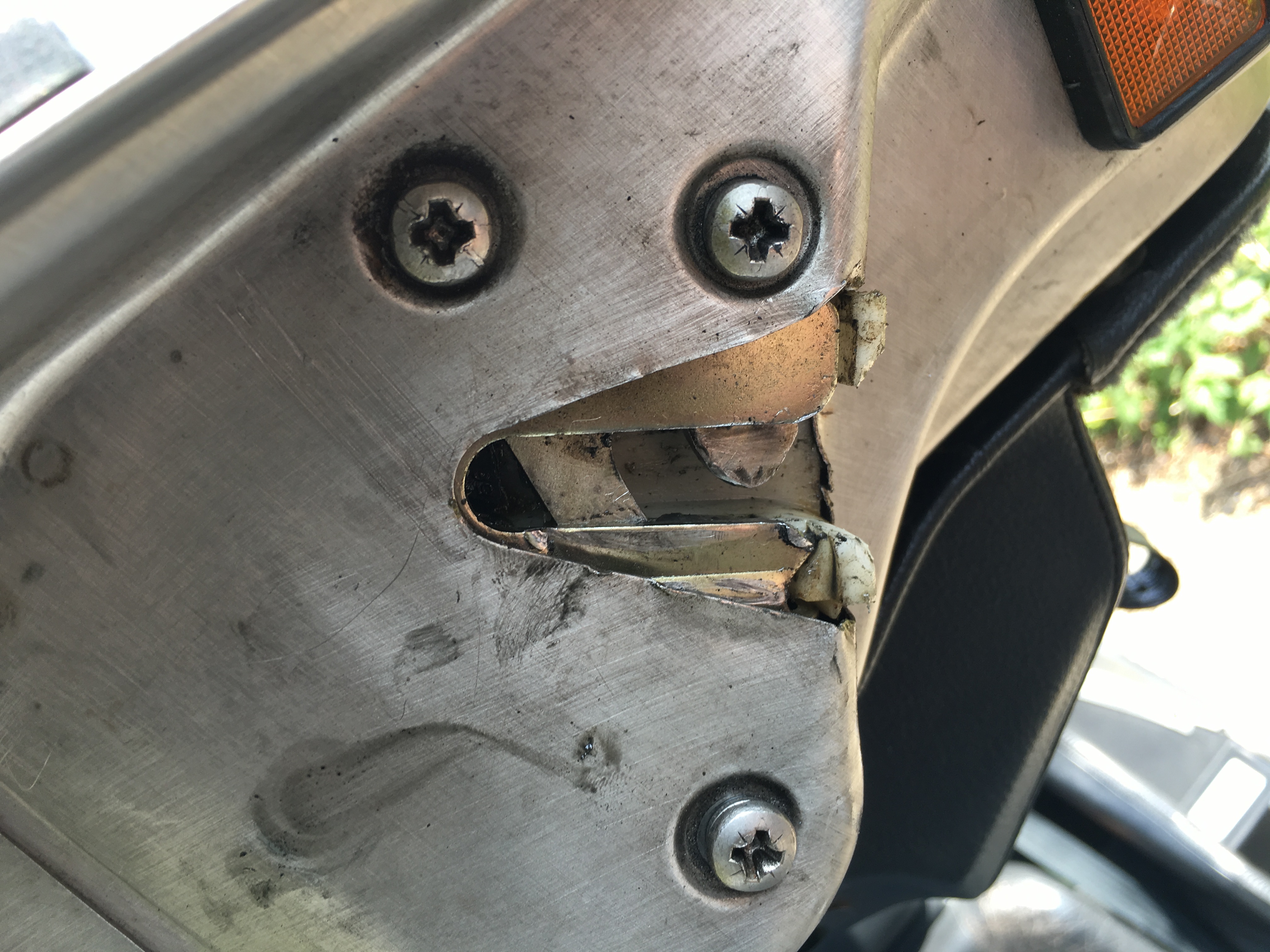

I need a door latch, drivers side, front latch.
Ed only seems to be selling them in packs of four, maybe someone has the one I need?
See pic

whats wrong with it ?
Re: Door Latch Needed
Postby asifmalik » Wed Jun 22, 2016 2:23 pm
It jammed, and when i try and move it open with a screwdriver it's not smooth at opening and catches.

Postby mec » Wed Jun 22, 2016 2:40 pm
Thats what i was going to suggest, adjusting the rods, I had to do my pass door for the opposite reason, it wouldn't latch, as soon as i adjusted the rods it works fine, might be worth trying this 1st as even if the latch isn't smooth it should still release when you push the door open as long as the rods are adjusted ok

Postby mknowlton » Wed Jun 22, 2016 3:15 pm
I think it will probably be adjustment Asif as Mec has said.
If you are coming to Norfolk next month we can have a look at it then if you like.
If Mike W can get hold of a spare latch then better still, FYI I believe that the drivers front latch is the same part as the passenger rear and vice versa.

Postby Daniel Shane » Wed Jun 22, 2016 10:20 pm
Lotus Elise S1 and S2, Vauxhall VX220 are the same latches. Allegro I believe is the original source
