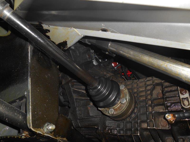

When I was driving, at around 5000 rpm, I was unable to change gear.
I locked the second gear to reach home, then no more first gear or reverse.
I think my clutch is dead, it smell burn...

Postby andyd » Wed Apr 18, 2018 9:29 pm
Ugh! Quel domage Domi!
Make sure your clutch has free play at the pedal at rest, and your gear linkage and cross gate cable have not simply worked loose? Even without a clutch, you should still probably be able to change gears (badly!) once you are rolling??
And if you have to, you can remove the gearbox to change the clutch with the car on axle stands. I did- you can too, for sure. Its not so hard! A busy weekend would see it done if you have all the parts??
