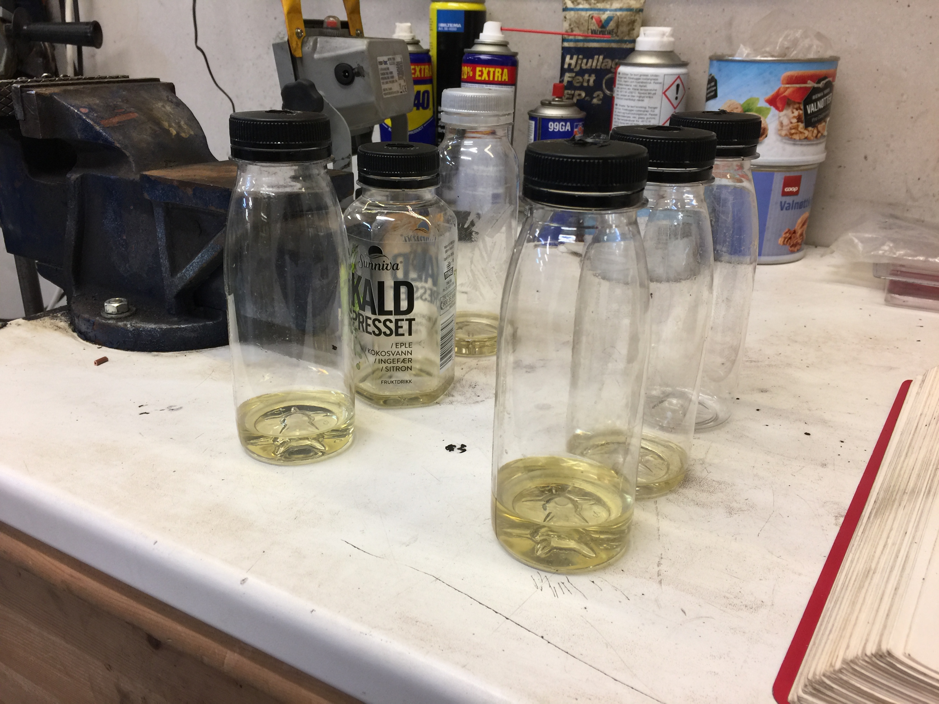

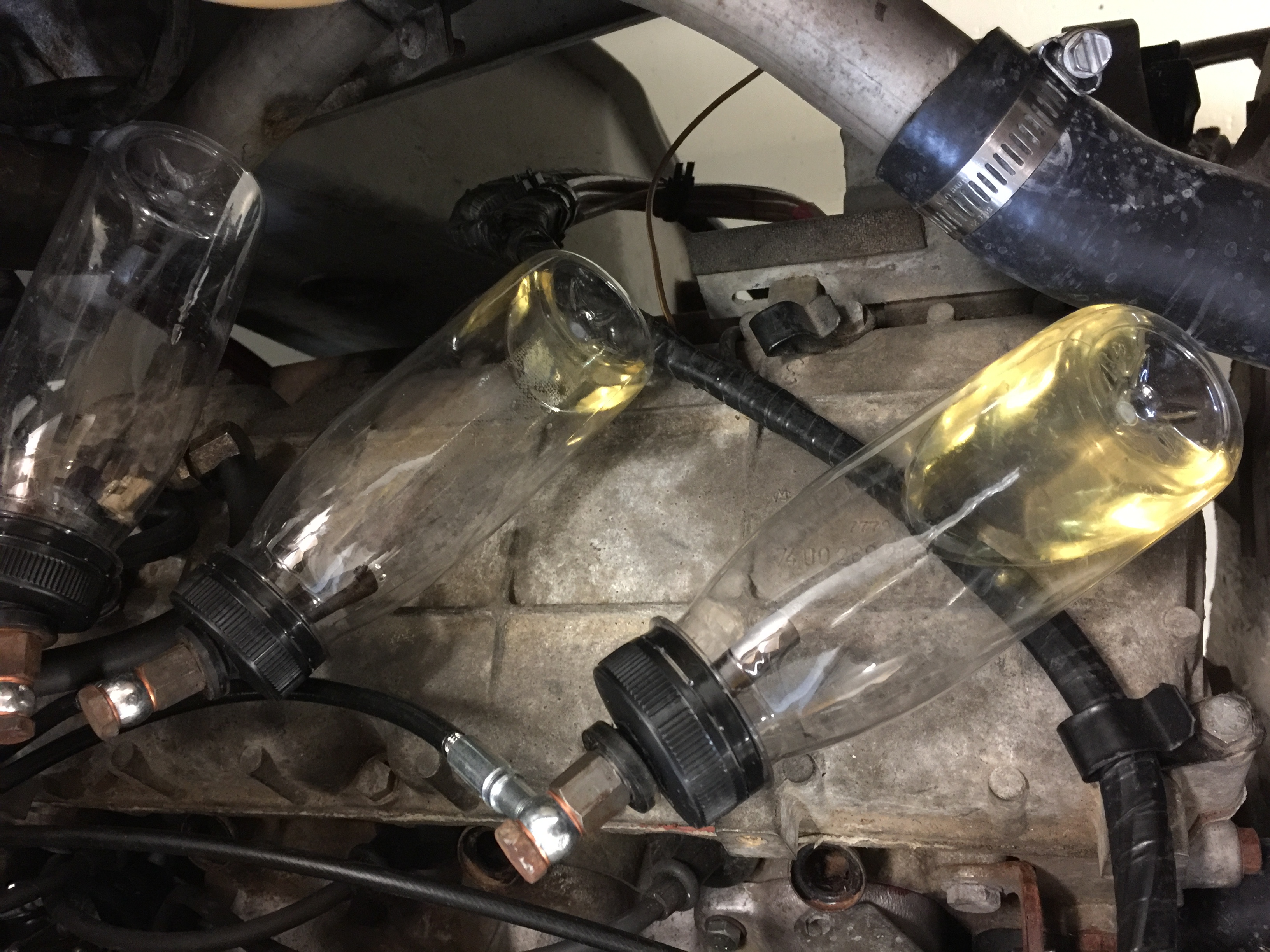

Postby gruffalo » Thu Jan 11, 2018 10:57 pm
More testing tonight. I had 2.5v voltage drop at the fuel pump. That needs to be fixed later, I hardwired the pump directly to the battery for now.
After some cleaning and fiddling, 5/6 injectors now spray properly. The last one sprays normally at low load, but when I press the plate all the way down, it cannot keep up with the others. I’ll look into that later.
The fuel distributor makes a strange hissing noise, like it is leaking or sucking air. Maybe it has air trapped in it?

Postby gruffalo » Sat Jan 13, 2018 3:59 pm
After some fiddling around I now have a fully flowing distributor and 5 perfectly even flowing injectors.
I also have 5 spare injectors, and hope to bring at least one of them back to its singing glory.
