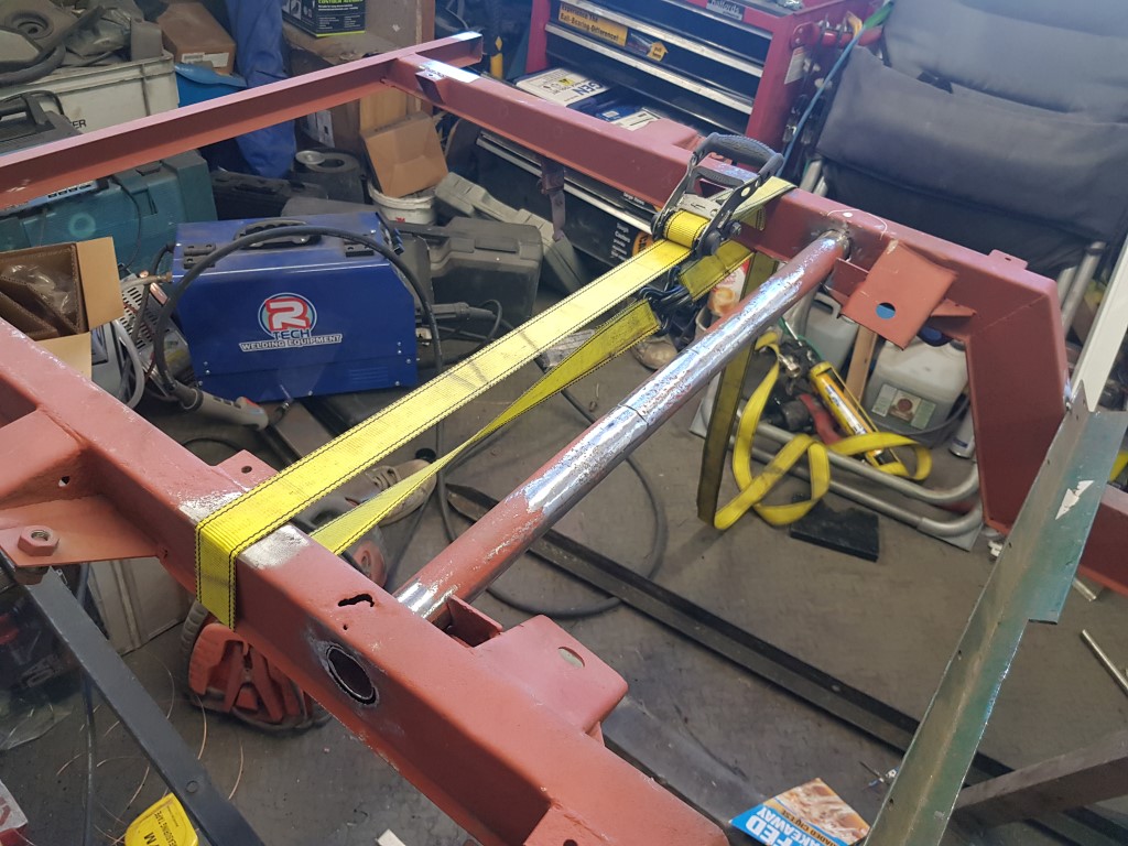

To say i got fed up with filling and sanding is an understatement so for a change i have left the body alone for a while and have been working on the chassis, now although the chassis looked "solid" it had been repaired a lot and not to the best standard so a lot of what i have done is making right whats been done badly before along with other repairs it needed along the way
I started off by bracing the chassis to keep the width correct...

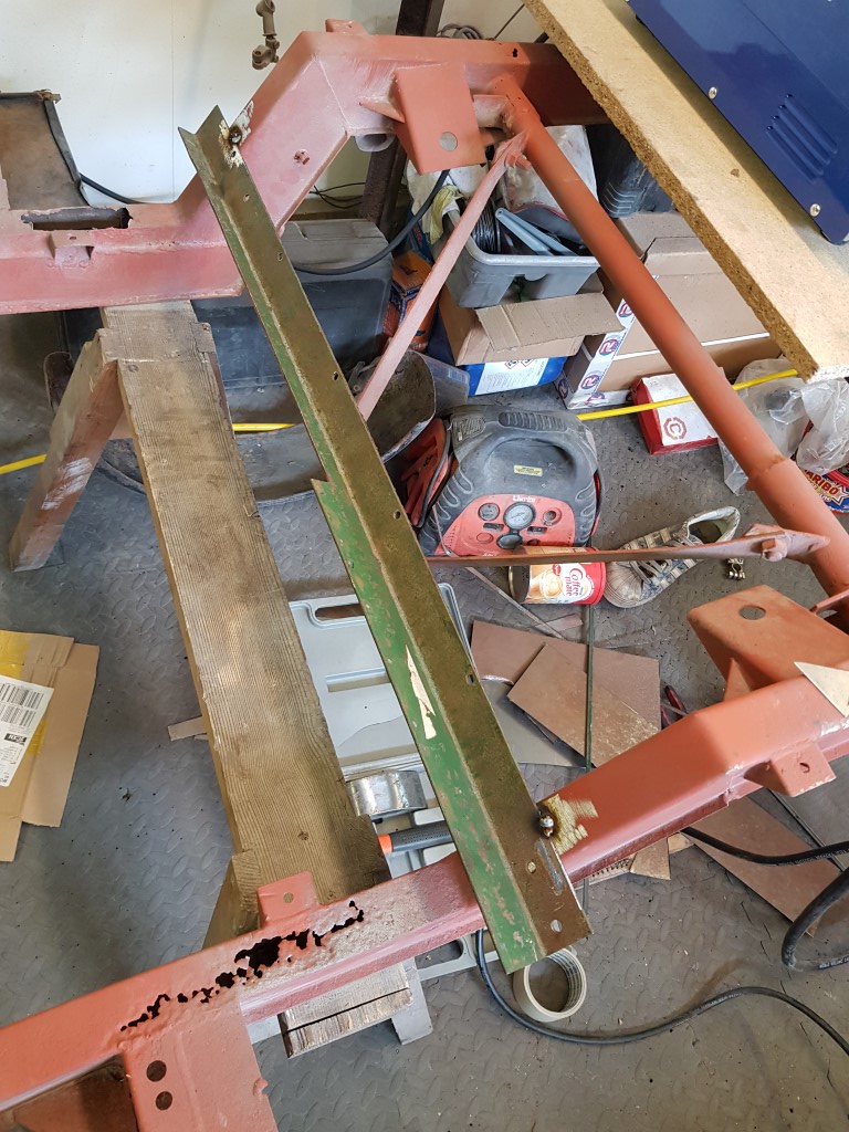

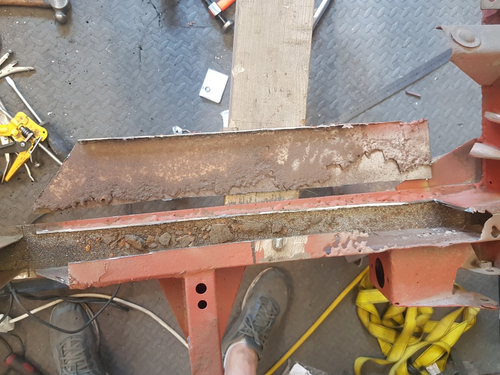

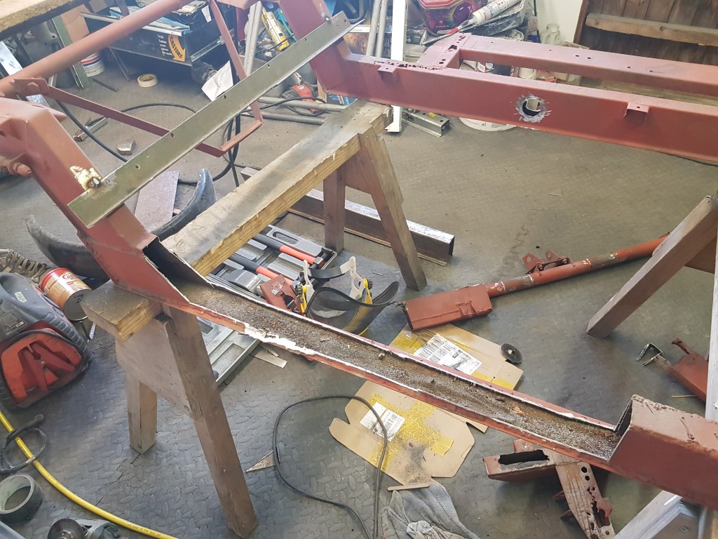

After these were in, the 1st repair i started with was the biggest as you do lol, this started but cutting out the centre bar which holds the rear gearbox mount...
20200618_151356 (Medium).jpg (233.4 KiB) Viewed 9752 times
you can see in this picture some of the holes and previous repairs that had been done on the drivers side chassis rail
20200618_151359 (Medium).jpg (216.67 KiB) Viewed 9752 times

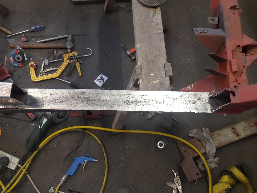

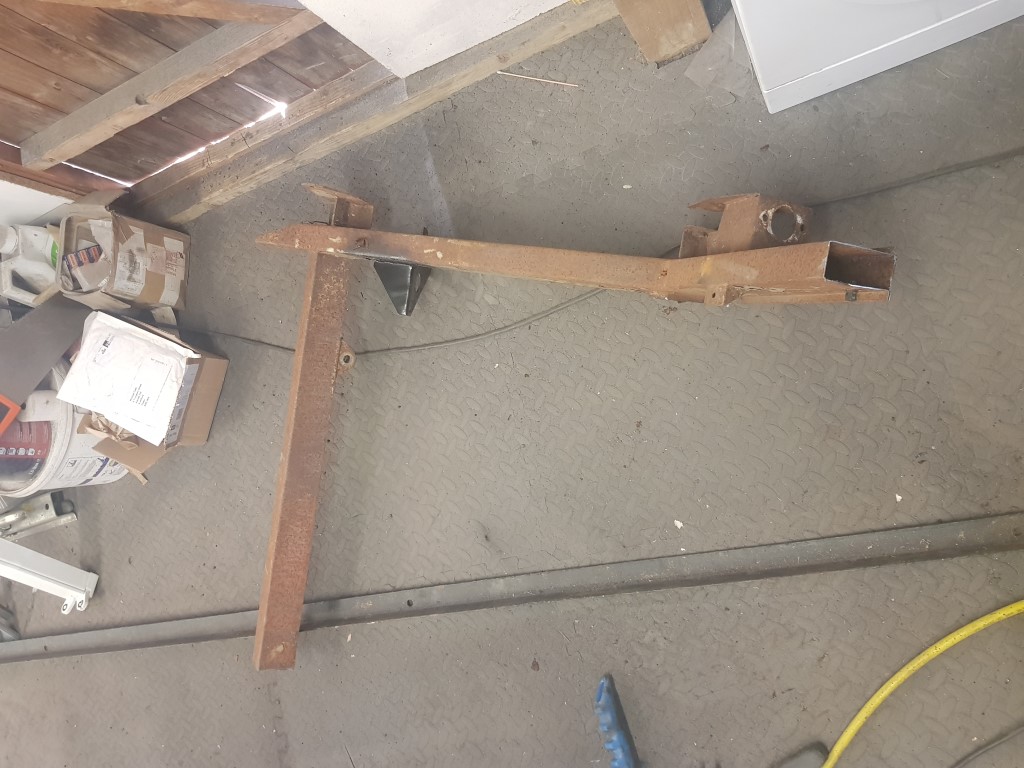

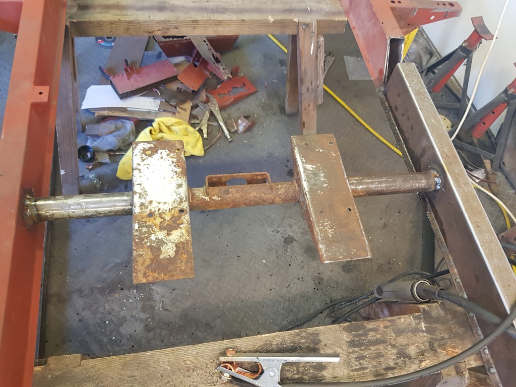

this is the bar that was removed, i have another one of these in better condtion with the flat plates and gearbox mount already on so this bar is going to be re used further in the post

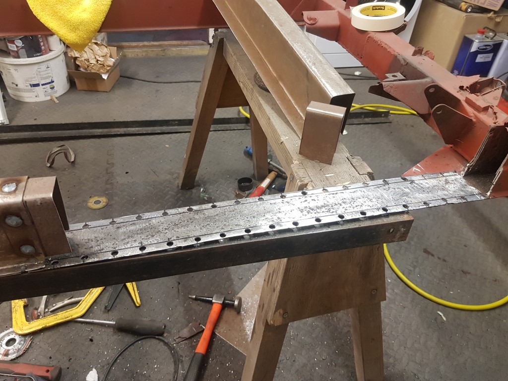

this section of the chassis rail was then cut out and all that was left was the bottom plate which had already been replaced and is in good condition so I left this in place to re use ...
20200618_154701 (Medium).jpg (288.51 KiB) Viewed 9752 times
this was then all cleaned up...
20200618_172944 (Medium).jpg (236.43 KiB) Viewed 9752 times

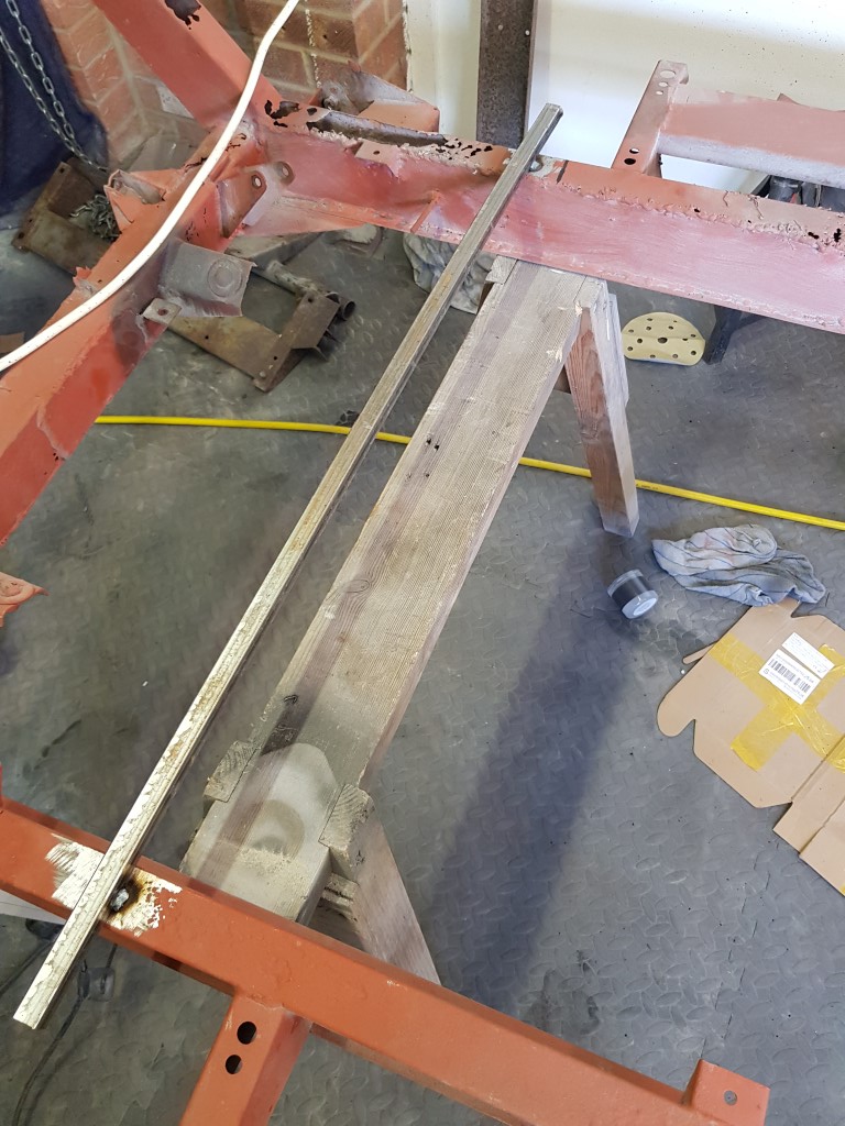

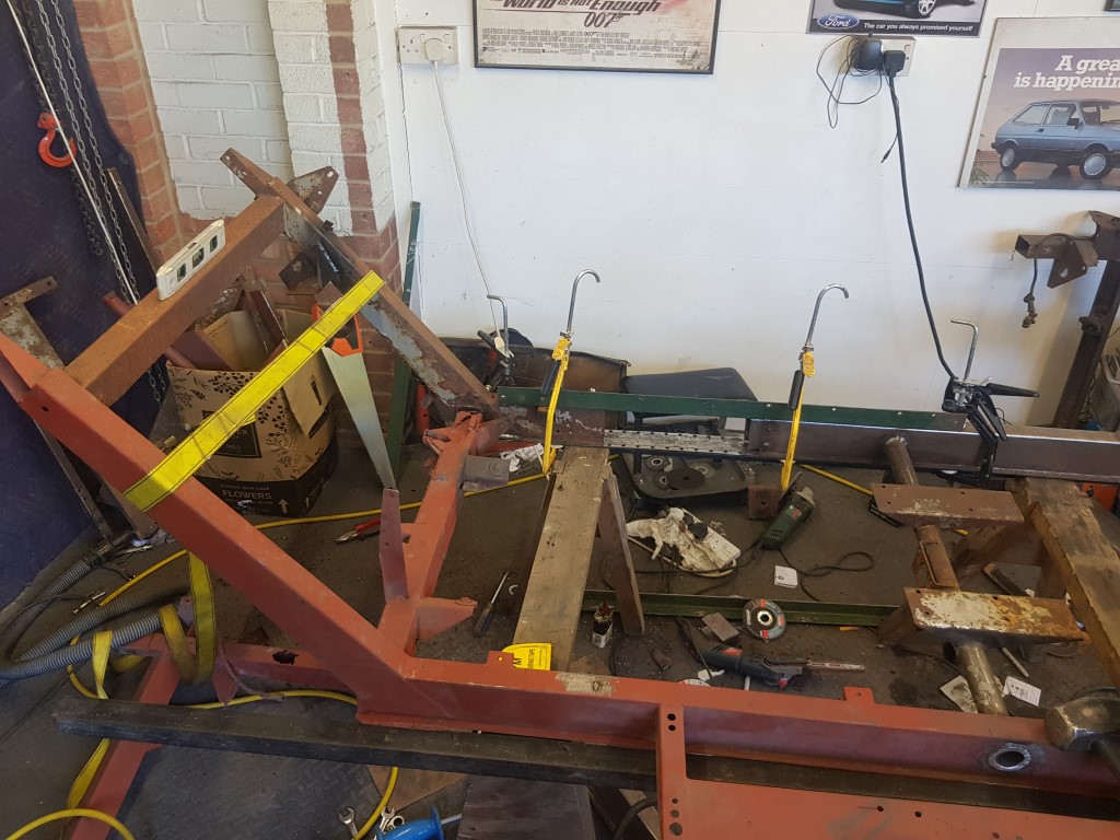

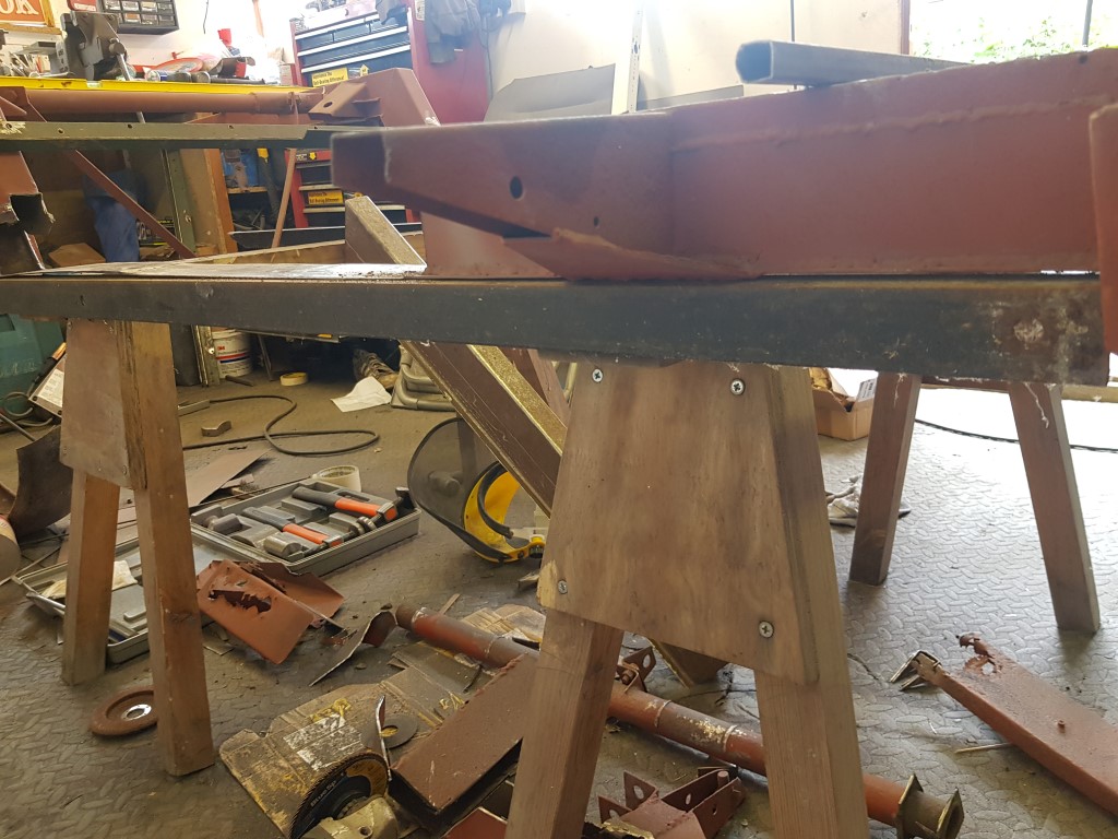

I then place the chassis on angle iron both sides to level it up and also to keep the strength whiilst sections were cut out...
20200619_133256 (Medium).jpg (238.54 KiB) Viewed 9752 times

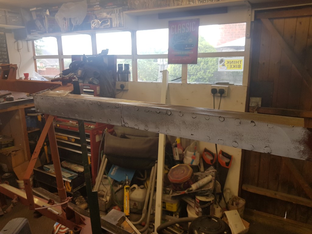

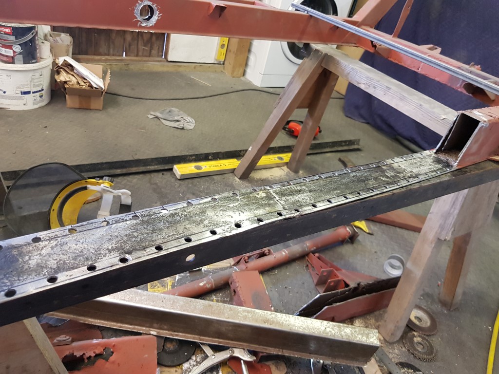

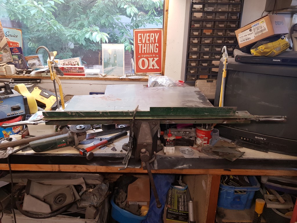

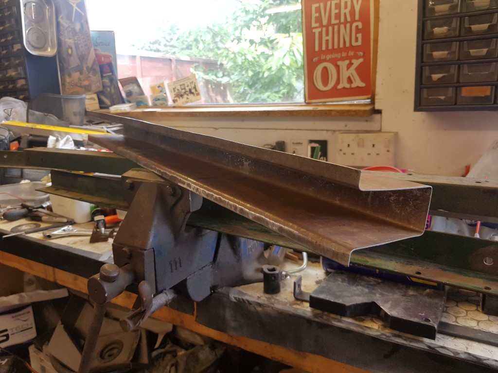

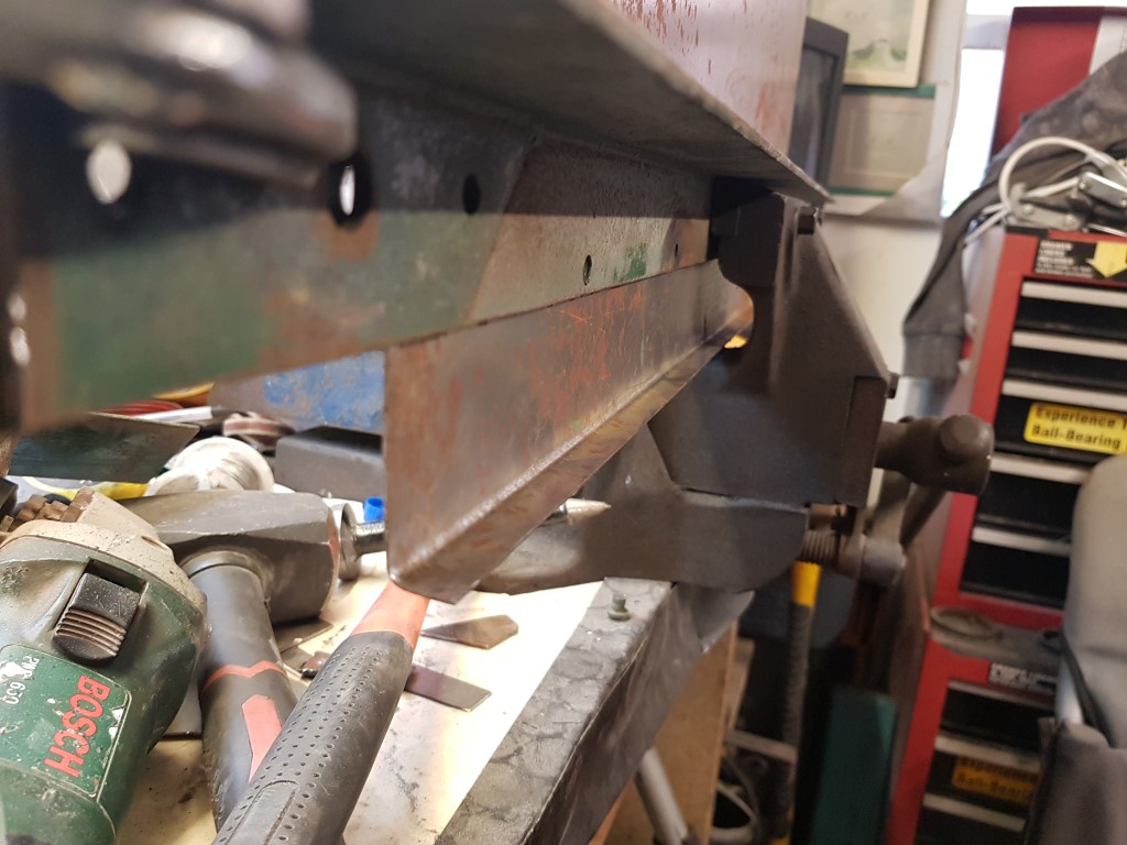

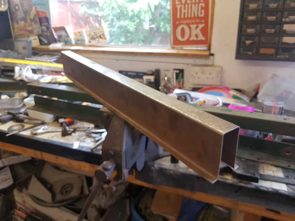

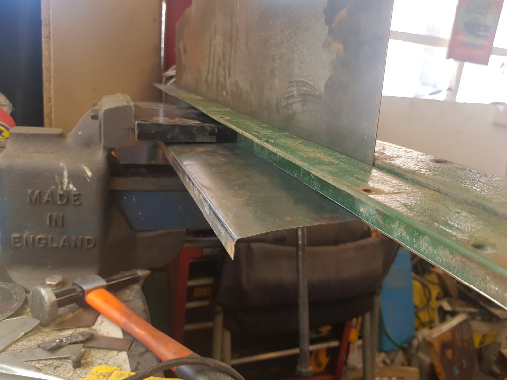

So then what do I do about getting a new chassis rail for a 50 year old reliant, well i did ask my old mate Alex D if the company he uses for the delorean chassis metalwork could make me a section, he helped me out loads as usual and did some drawings and sent them over to the company, however they seemed to have a problem with making the small lip on the bottom of the panel so then it started me thinking, do i have the skill to make it ??
Well I thought sod it il have a go, i have a sheet of the 1.2mm steel sheet from ages ago so its not going to cost me anything to try just my time, I must also stress I DONT have a sheet metal break for folding metal, this is what i came up with ...
20200612_185040 (Medium).jpg (291.01 KiB) Viewed 9752 times
20200612_190030 (Medium).jpg (191.85 KiB) Viewed 9752 times
20200614_105820 (Medium).jpg (165.94 KiB) Viewed 9752 times

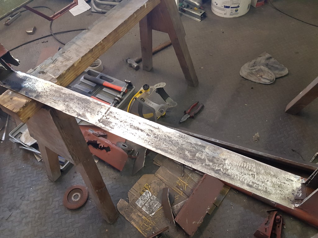

In case your wondering, that's a vice, 3 pieces of angle iron, 4 C clamps, 2 pairs of mole grips, a lump of metal (my hydraulic press base) and a club hammer and this is what i ended up with ...
20200617_155753 (Medium).jpg (174.08 KiB) Viewed 9752 times
20200617_155810 (Medium).jpg (207.25 KiB) Viewed 9752 times
Not absolute perfect but I'm pretty chuffed with the result

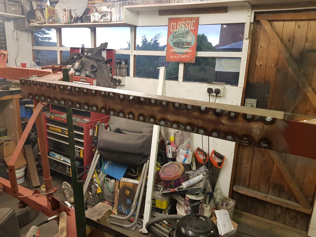

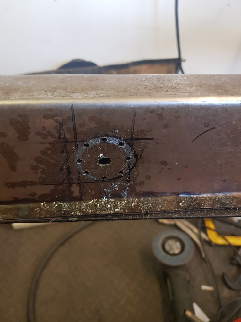

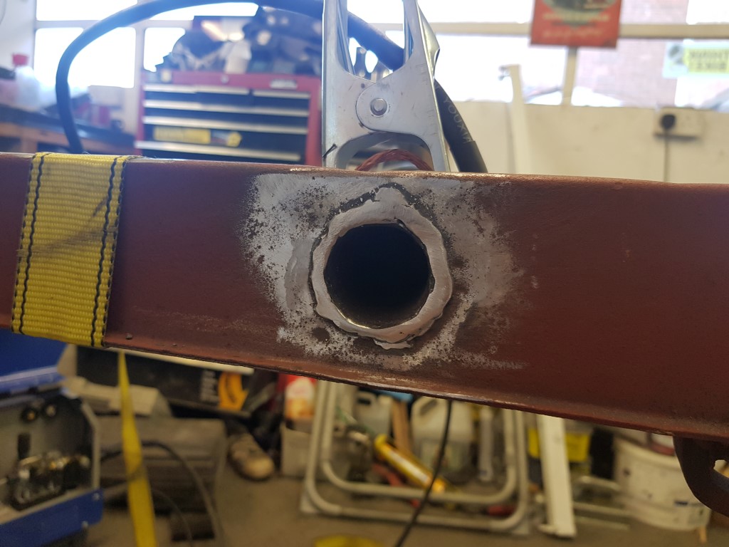

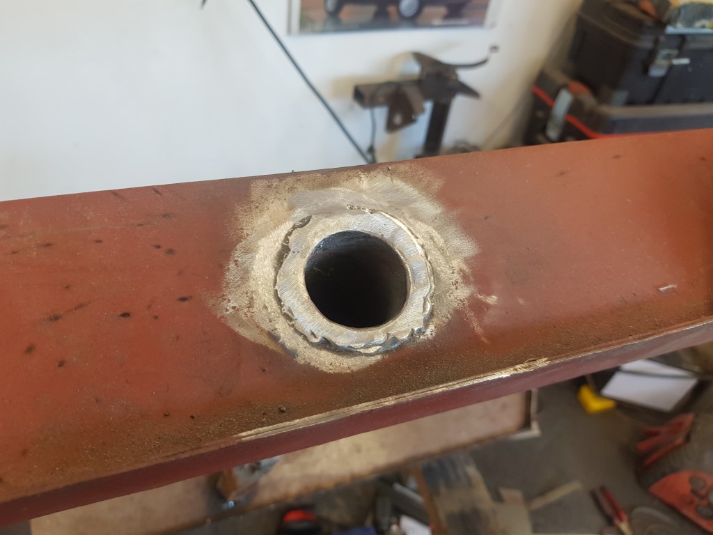

All seemed fine, so i then proceeded to drill the base plate so i could plug weld the new home made panel on, this is effectively the same was the original would have been made only when Reliant did it, it was spot welded
20200619_172056 (Medium).jpg (261.05 KiB) Viewed 9752 times
20200619_204603 (Medium).jpg (269.27 KiB) Viewed 9752 times
20200620_145950 (Medium).jpg (190.89 KiB) Viewed 9752 times

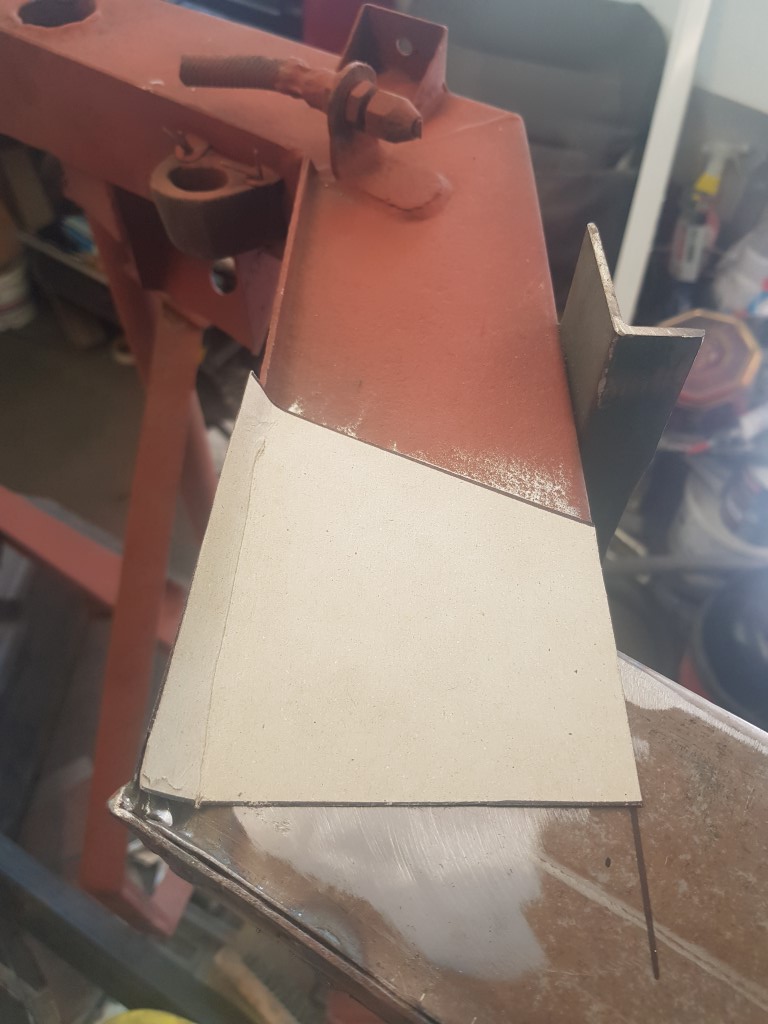

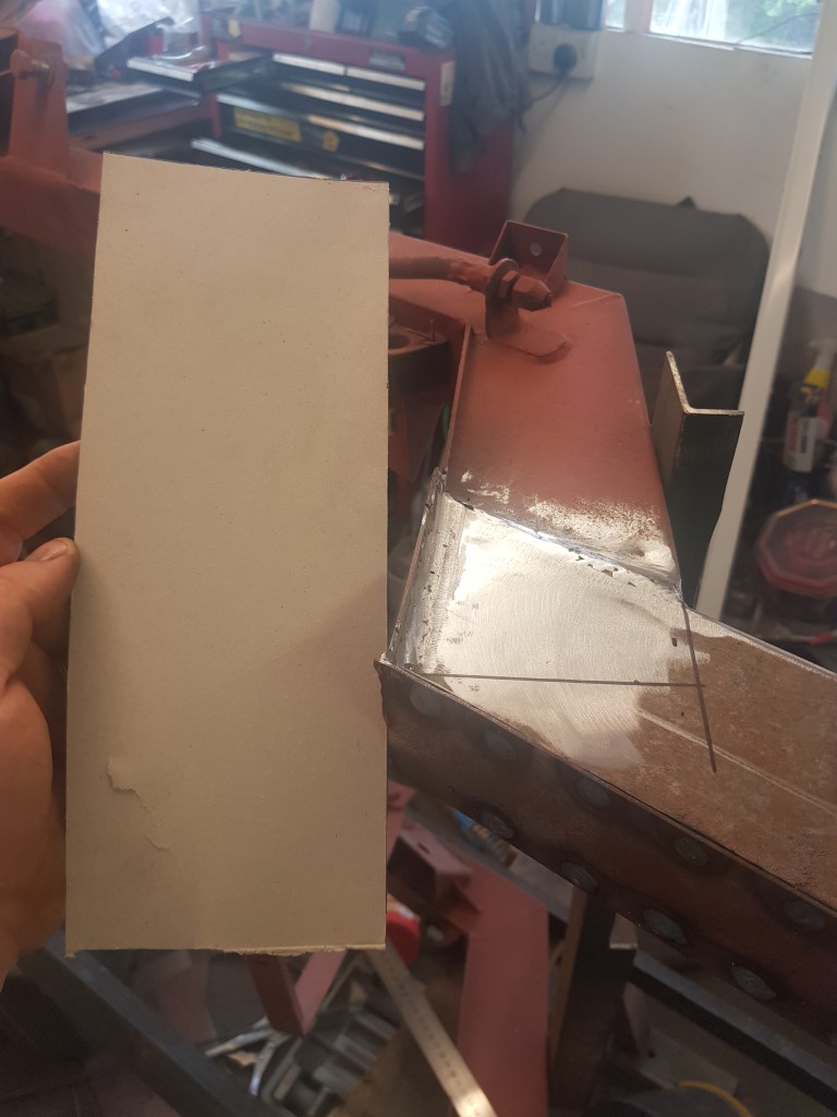

Then at the rear after welded the seams on, i did some CAD (cardboard added design) and made an over plate to overlap the join as per the original, this was also made with the lip on so it could be plug welded along the edge ...
20200620_115038 (Medium).jpg (162.29 KiB) Viewed 9752 times
20200620_115331 (Medium).jpg (166.15 KiB) Viewed 9752 times
20200620_144620 (Medium).jpg (185.42 KiB) Viewed 9752 times

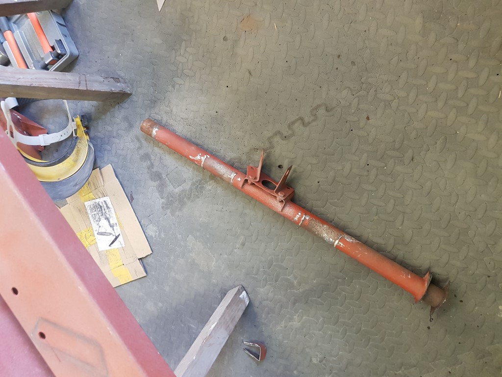

And you remember the original centre bar that i took out, that has now been cleaned up with the brackets removed and relocated to the rear of the chassis to replace a previous very badly repaired bodge...
20200622_172129 (Medium).jpg (252.82 KiB) Viewed 9752 times
20200623_123647 (Medium).jpg (155.12 KiB) Viewed 9752 times
20200622_175848 (Medium).jpg (186.6 KiB) Viewed 9752 times

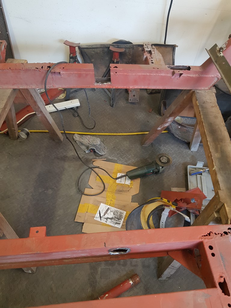

Right with that in i went back to the chassis rail to carry on cutting out more previous bodgery...
20200623_145703 (Medium).jpg (270.36 KiB) Viewed 9752 times
20200623_161910 (Medium).jpg (224.76 KiB) Viewed 9752 times
20200624_213956 (Medium).jpg (259.79 KiB) Viewed 9752 times

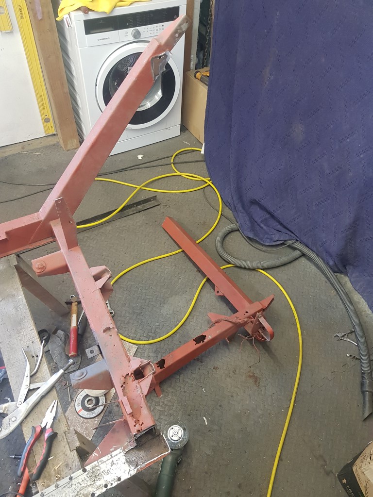

Before i could go any further with this section of the chassis rail I had to sort out the front end of the chassis, luckily from the donor yellow regal i managed to salvage a good section of chassis which happened to be the exact bit i needed...
20200624_130216 (Medium).jpg (179.72 KiB) Viewed 9752 times
I then cut out the rotton but on mine ...

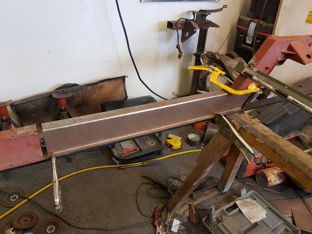

I then made another piece of chassis rail in the same way and cut this to fit in the gap over the sleeves, this was then plug and seam welded into place ...
20200625_172513 (Medium).jpg (237.87 KiB) Viewed 9751 times
20200626_110401 (Medium).jpg (160.42 KiB) Viewed 9751 times
20200626_111316 (Medium).jpg (187.65 KiB) Viewed 9751 times
20200626_122151 (Medium).jpg (191.32 KiB) Viewed 9751 times

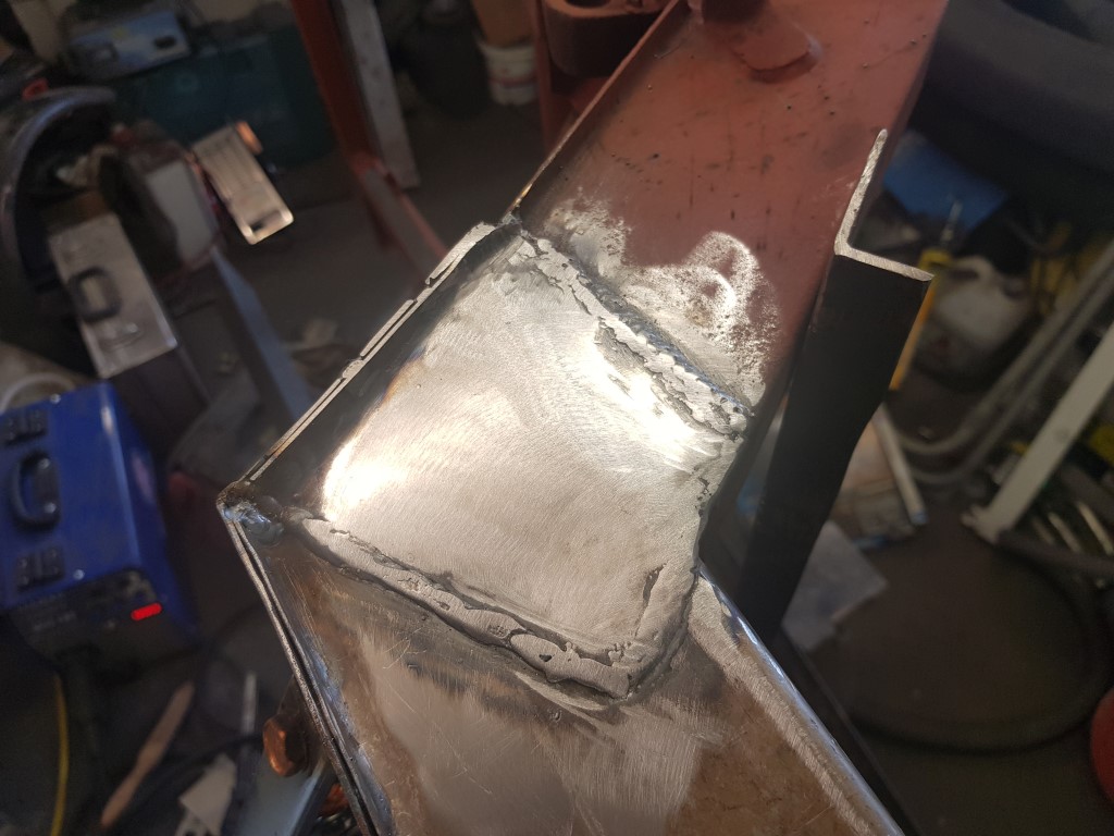

I then seam welded the top back on both side to give a very strong join...

So this is where im up to now...
20200629_185802 (Medium).jpg (255.5 KiB) Viewed 9751 times
Not finished yet but a hell of a lot more solid now, next job is to re attach this little lot ! ...
20200630_001321 (Medium).jpg (211.39 KiB) Viewed 9751 times
That where im up to, Stay well everyone !! :dance: :dance: :dance: :dance: :dance: :mrgreen: :mrgreen: :mrgreen:
