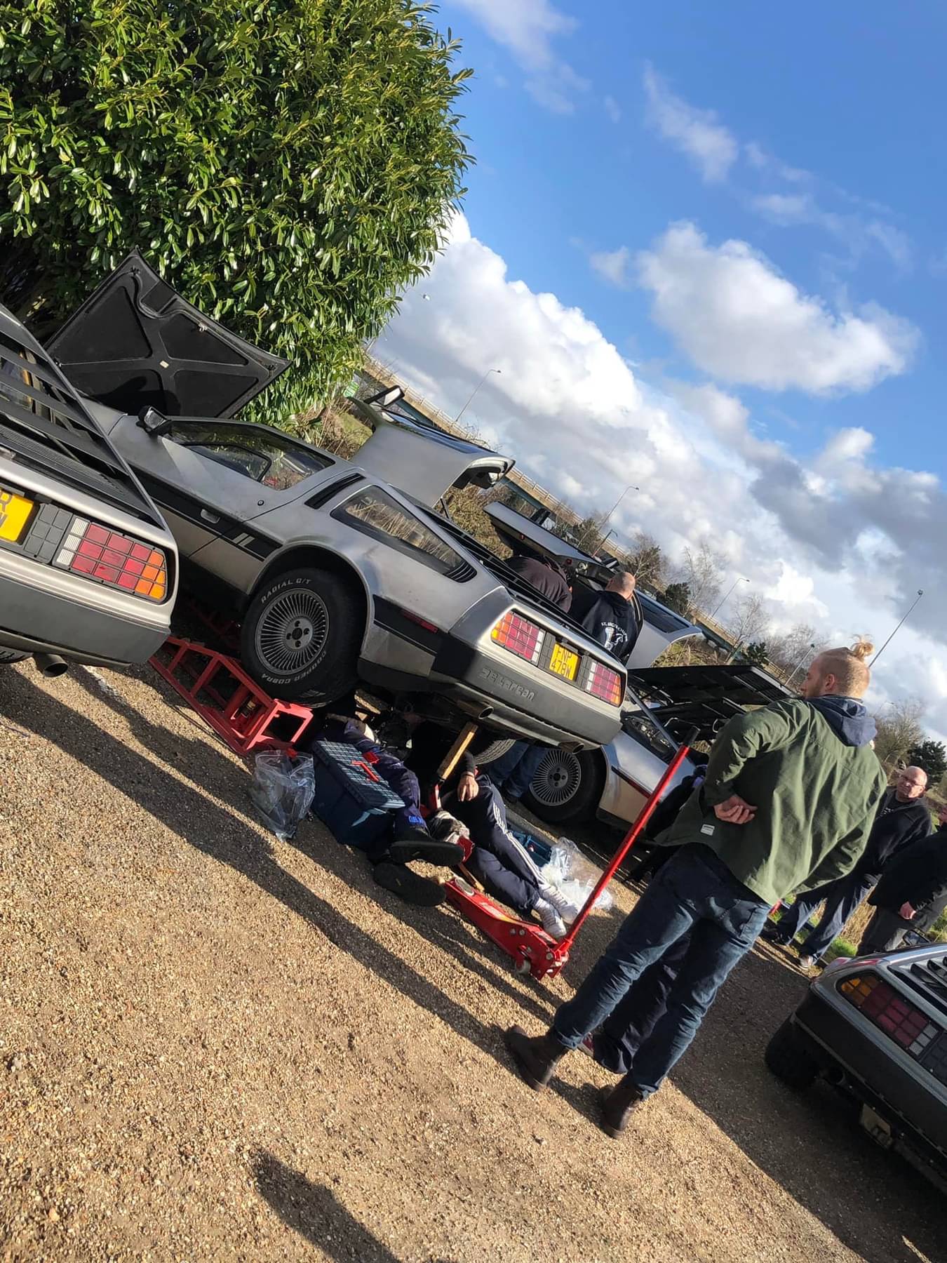

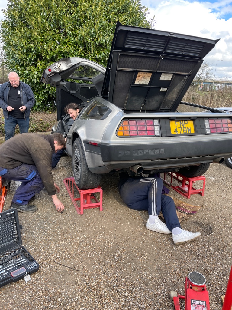

Money well spent if you ask me. Ill make a start on the other side tomorrow.
Cant say i would enjoy doing that in a car park which i assume was a eurotech meet
Re: VIN 5219
Postby bandit » Mon Mar 08, 2021 7:31 pm
DMC1983 wrote:Money well spent if you ask me. Ill make a start on the other side tomorrow.
Yeh, good old days :D
Re: VIN 5219
Postby A Van » Mon Mar 08, 2021 7:48 pm
Yes it was on gravel... but we did have a marquee thing over us so wasn’t too bad...

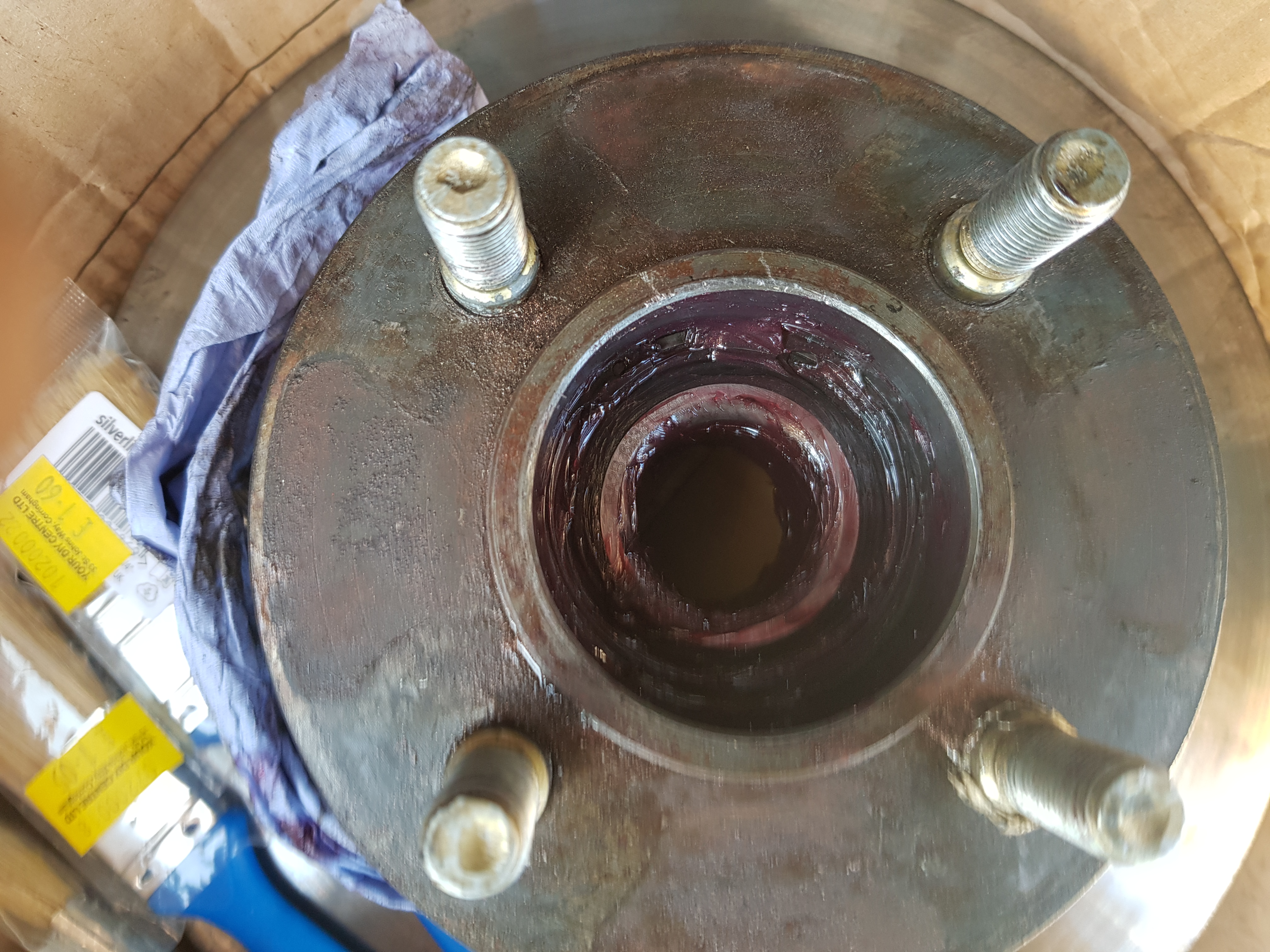

Today I got the drivers side dismantled.

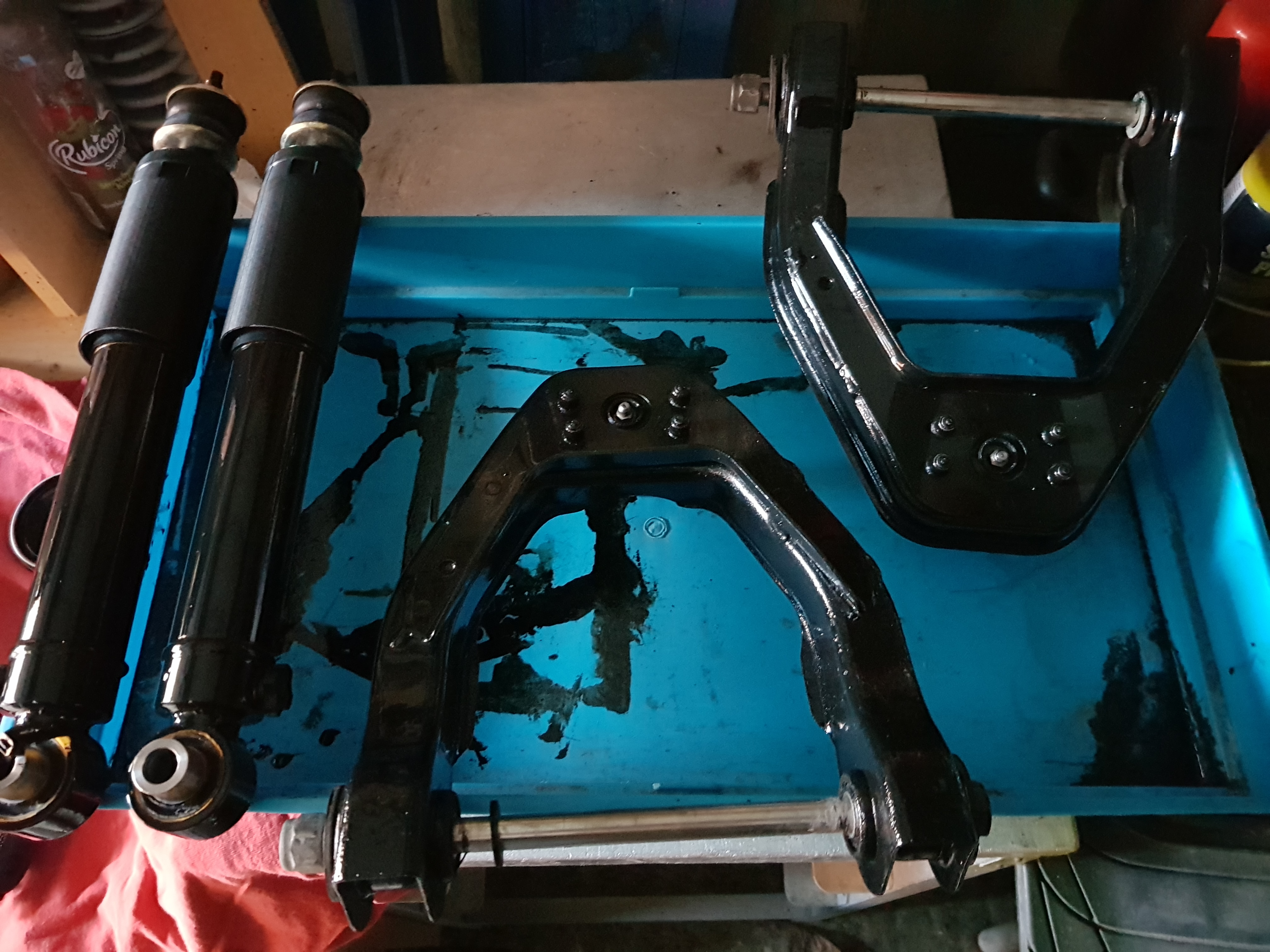

Both hub bearings have now been changed, anti roll bar has been dropped off for sand blasting and powder coating and the 1st coat of paint has been applied to the spax shocks and upper control arms. A few little spots of the chassis has had the por15 treatment too.
No seized or corroded bolts again. So the dismantling phase has been pretty straight forward. Yay!

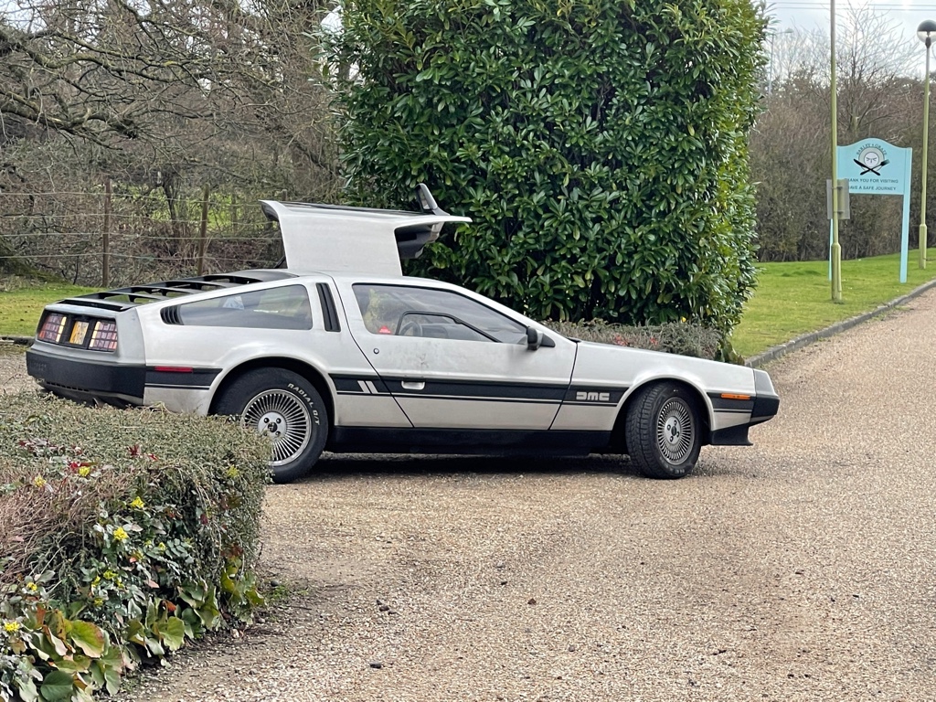

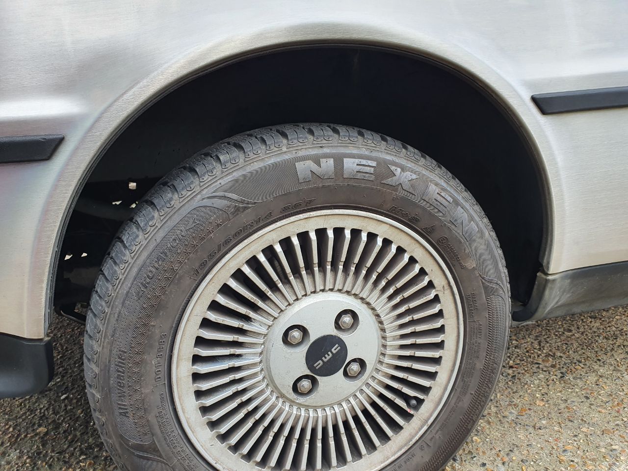

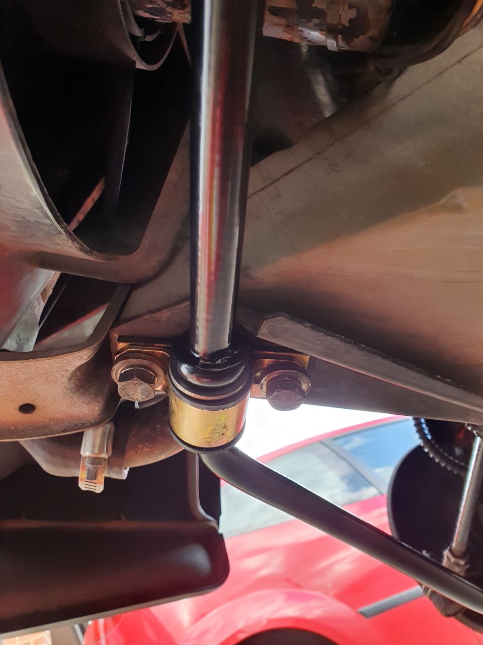

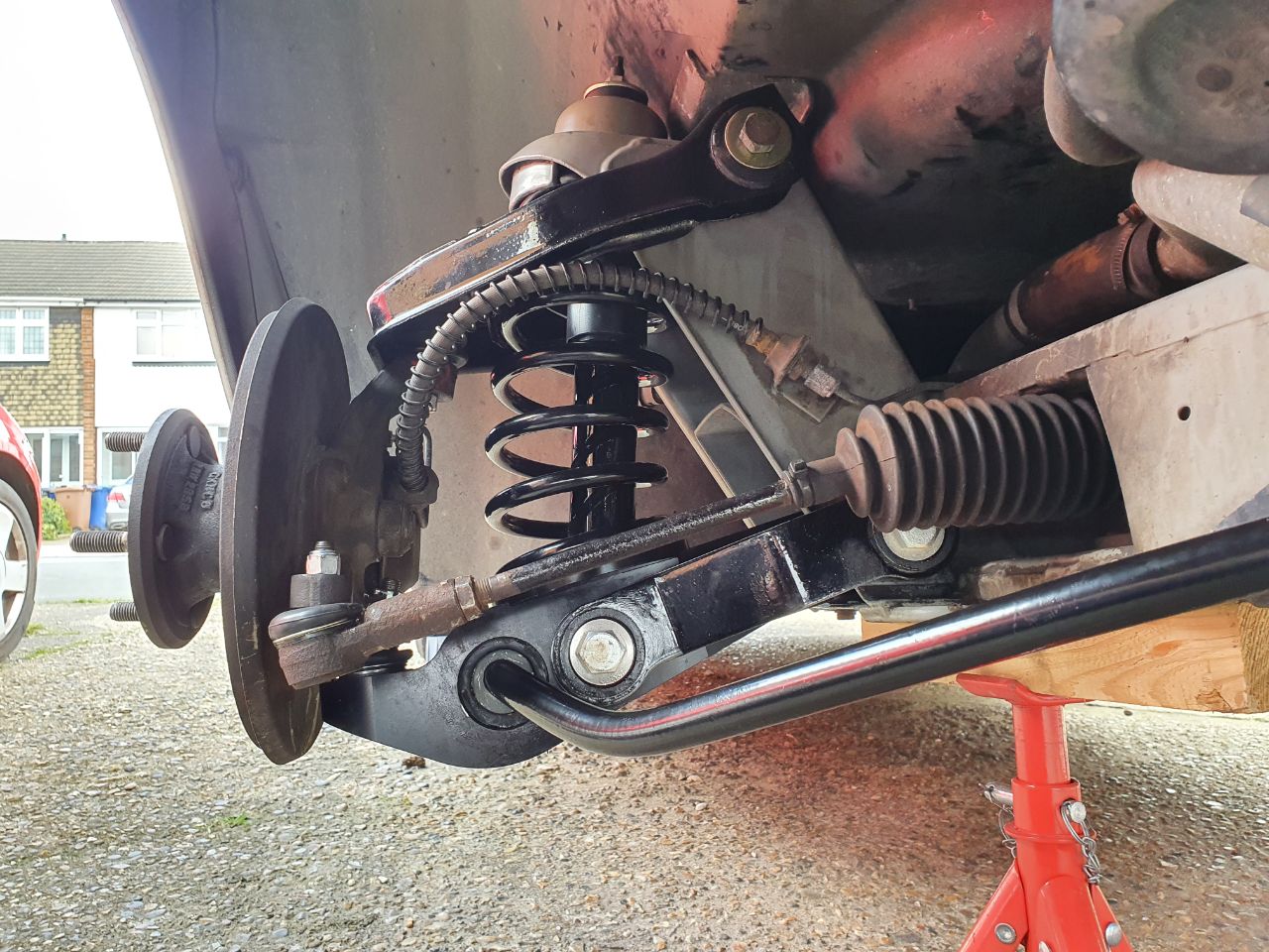

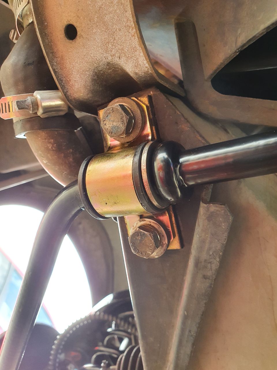

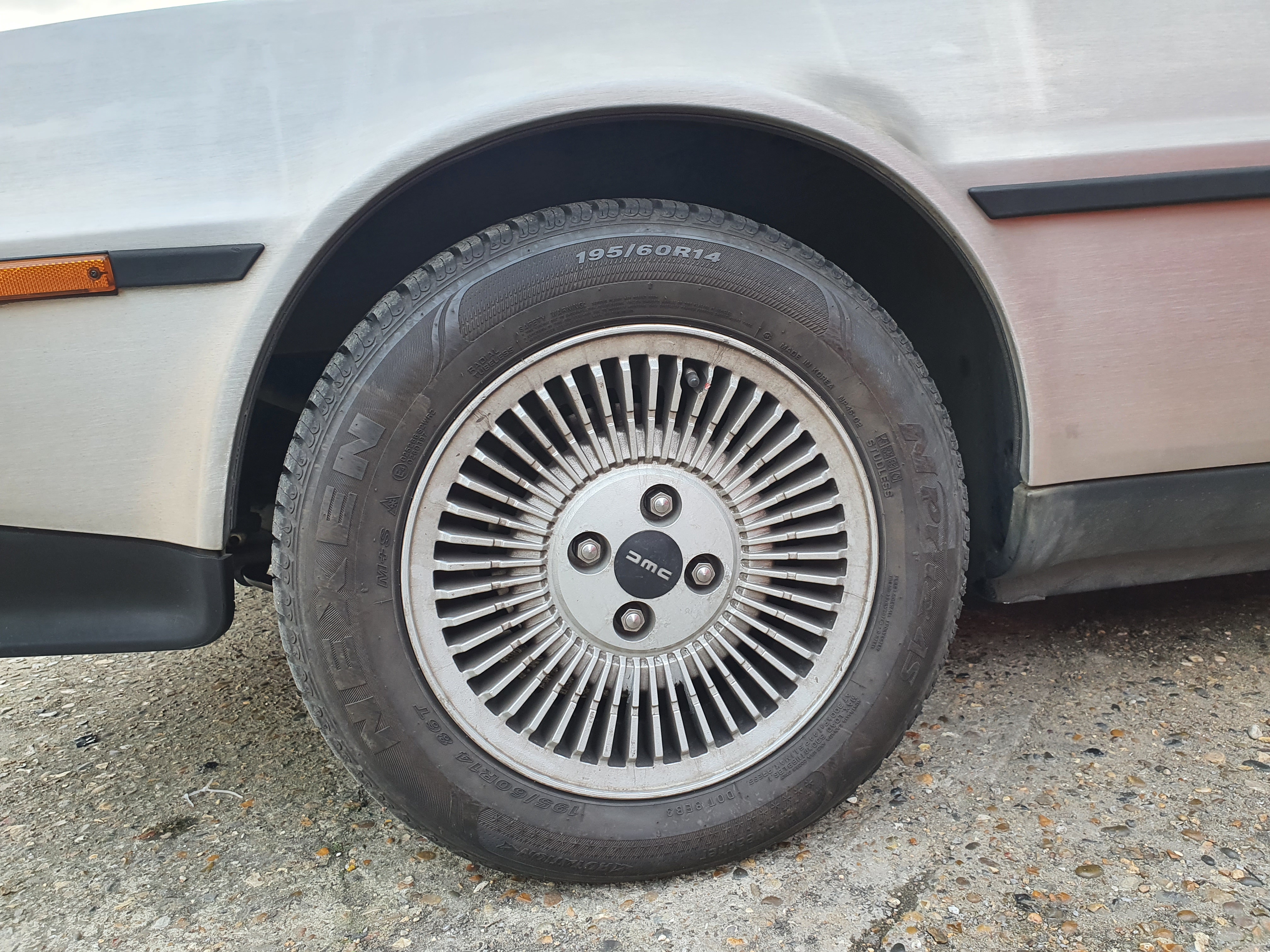

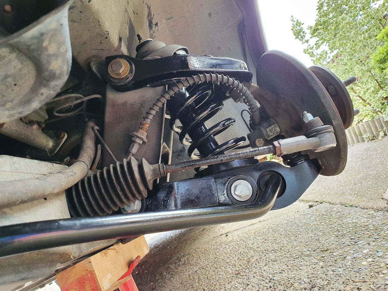

And so the front suspension area has now been completed. Front end has been lowered and has also been upgraded. New bushes, new ali control arm with reinforcement brackets, lowered springs and sway bar powder coated with new poly bushes too. The car is spoilt.
As jobs go on a delorean, this actually wasnt too bad. Ive done what would appear to be simpler jobs before that are far worse. So a very welcome change. I did have an issue with one of the hub bearings but I won in the end (the car will fight back where it can). No clunks or pings either andbthe steering wheel has stopped vibrating. Yay!
Last pics show the ride height before and after. Everything still needs to settle but am full of victory grins currently. On to the next job...

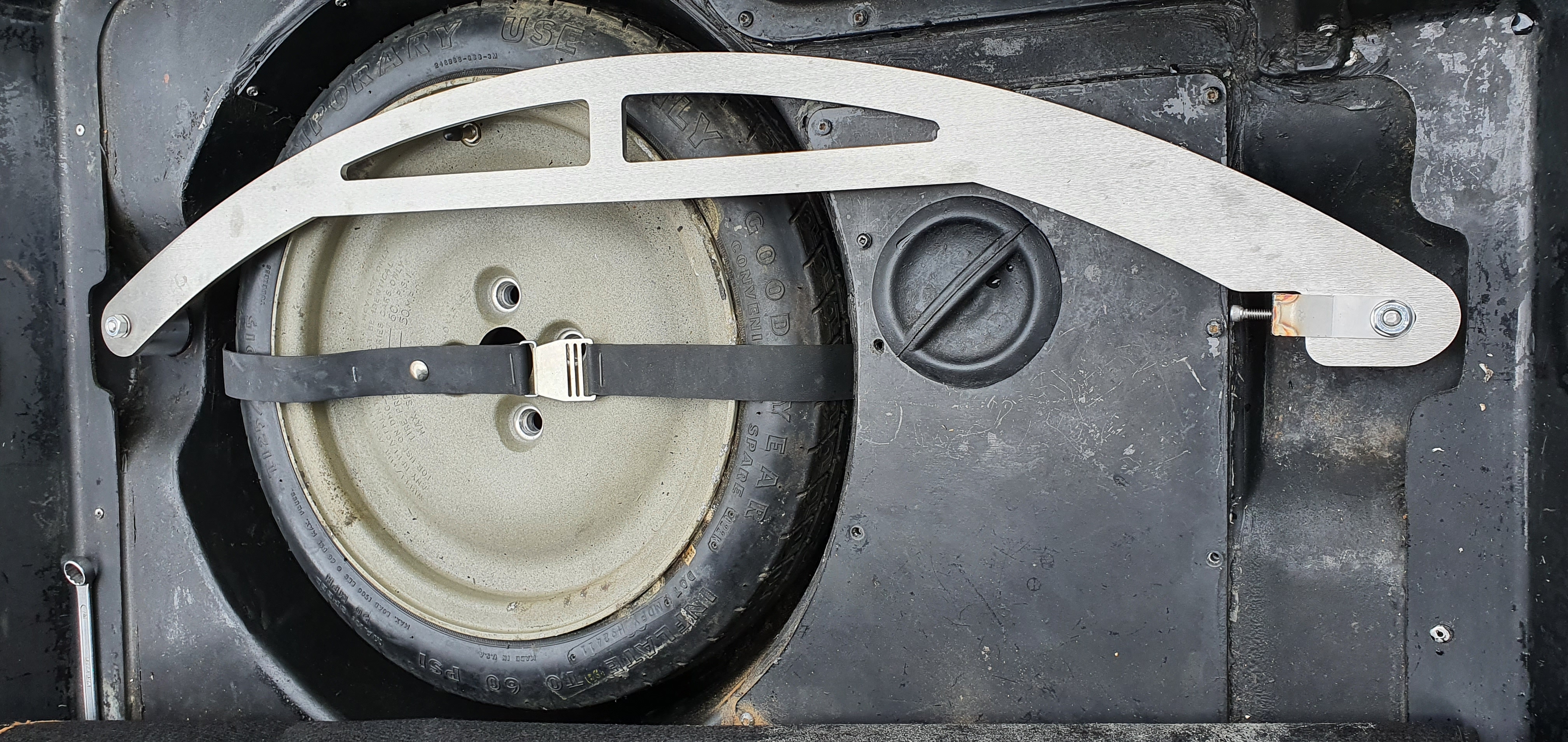

A simple job done adding the shock tower brace. Some people claim its a placebo effect but I do believe its made some difference to the handling. The car sticks to the road more in heavier cornering and reduces some understeer. It feels like some of the bodyroll has been reduced too but i cant be sure of that.

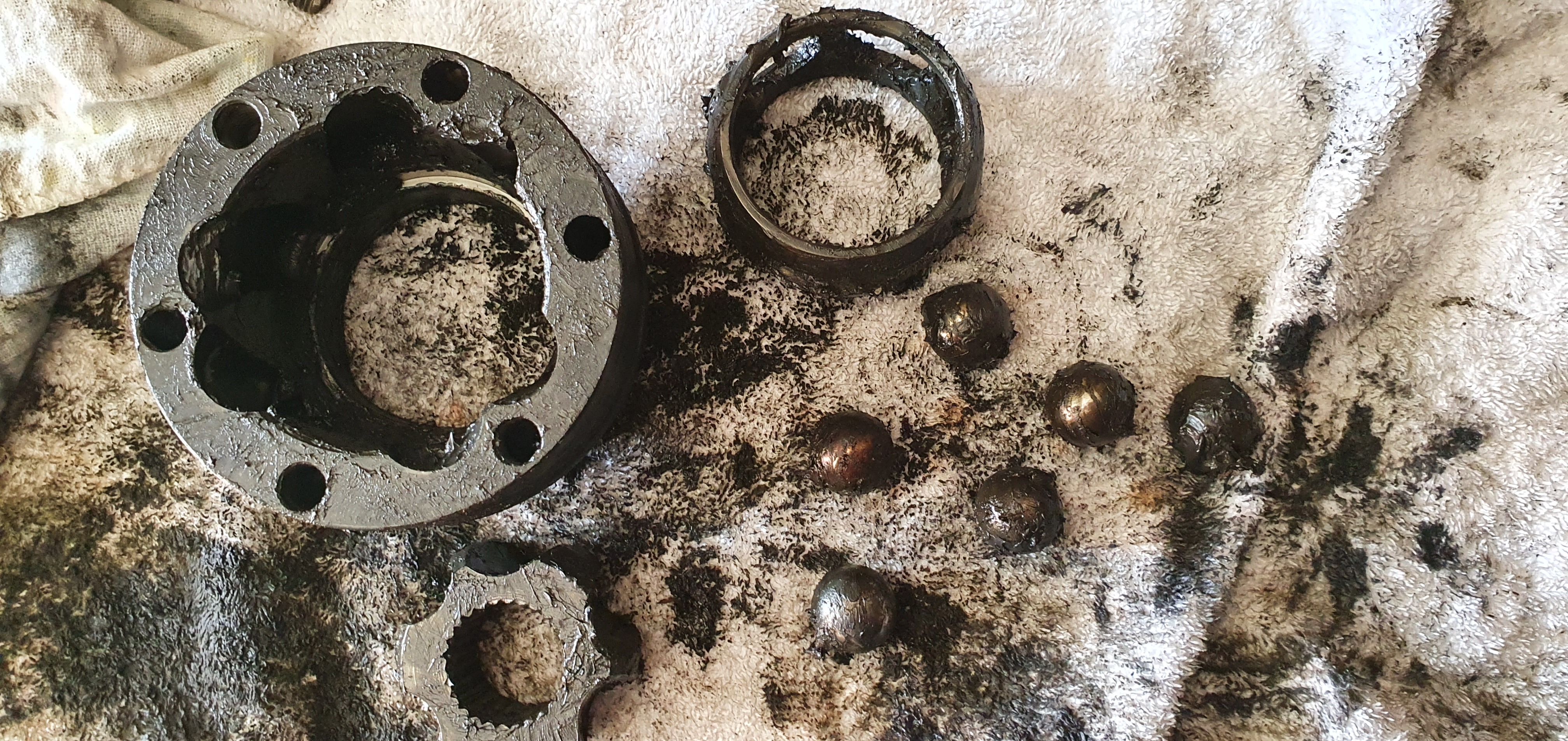

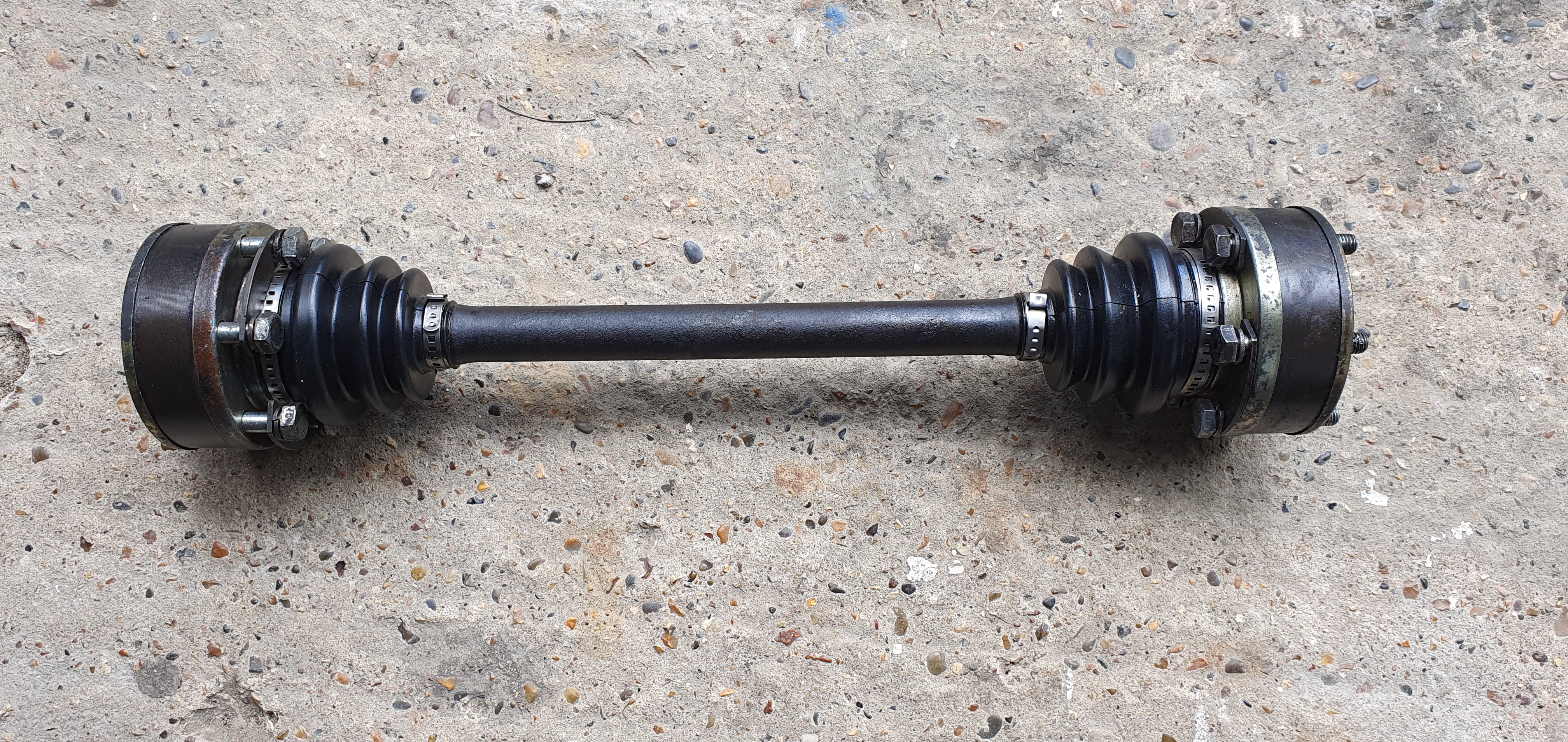

CV joints have been rebuilt. I started developing a ticking noise so ordered a kit from Dgo. Took a few hours and was a messy job but a satisfying one none the less.

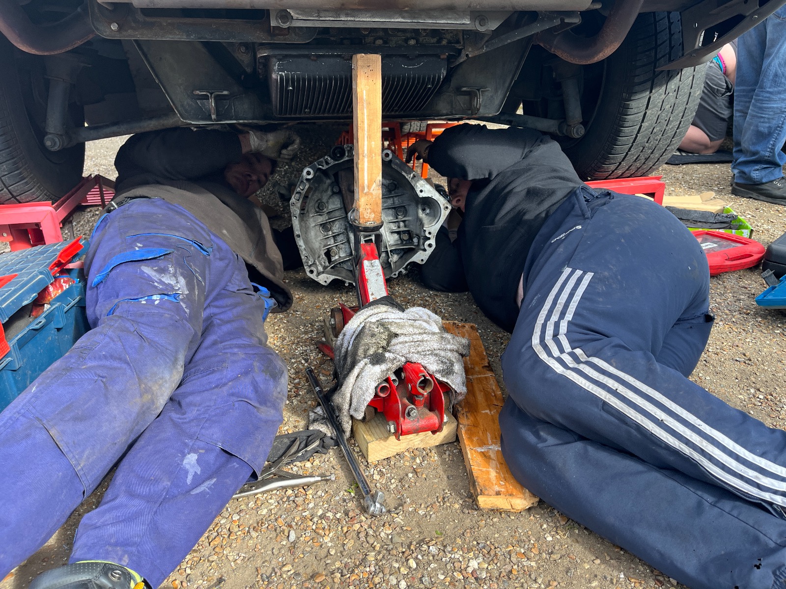

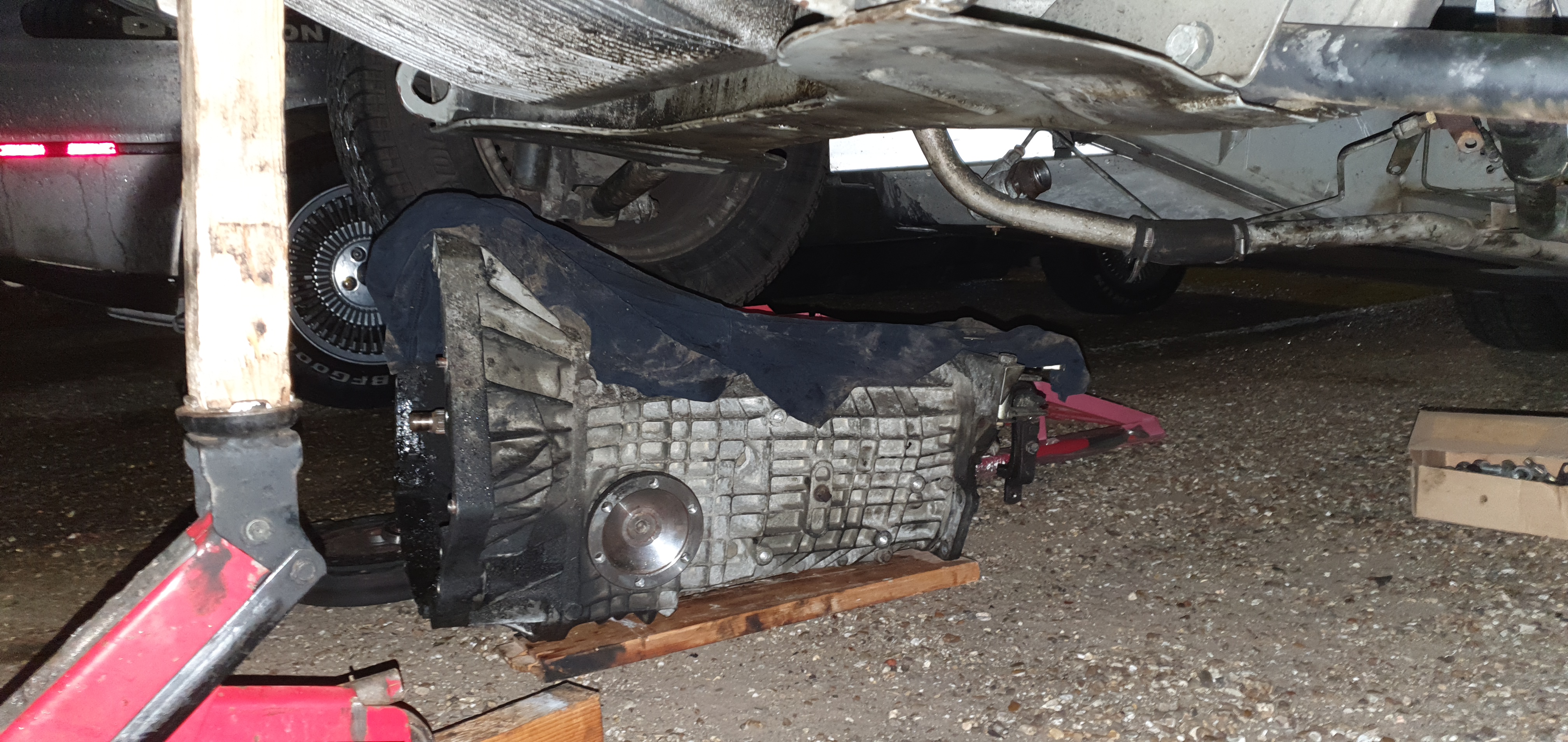

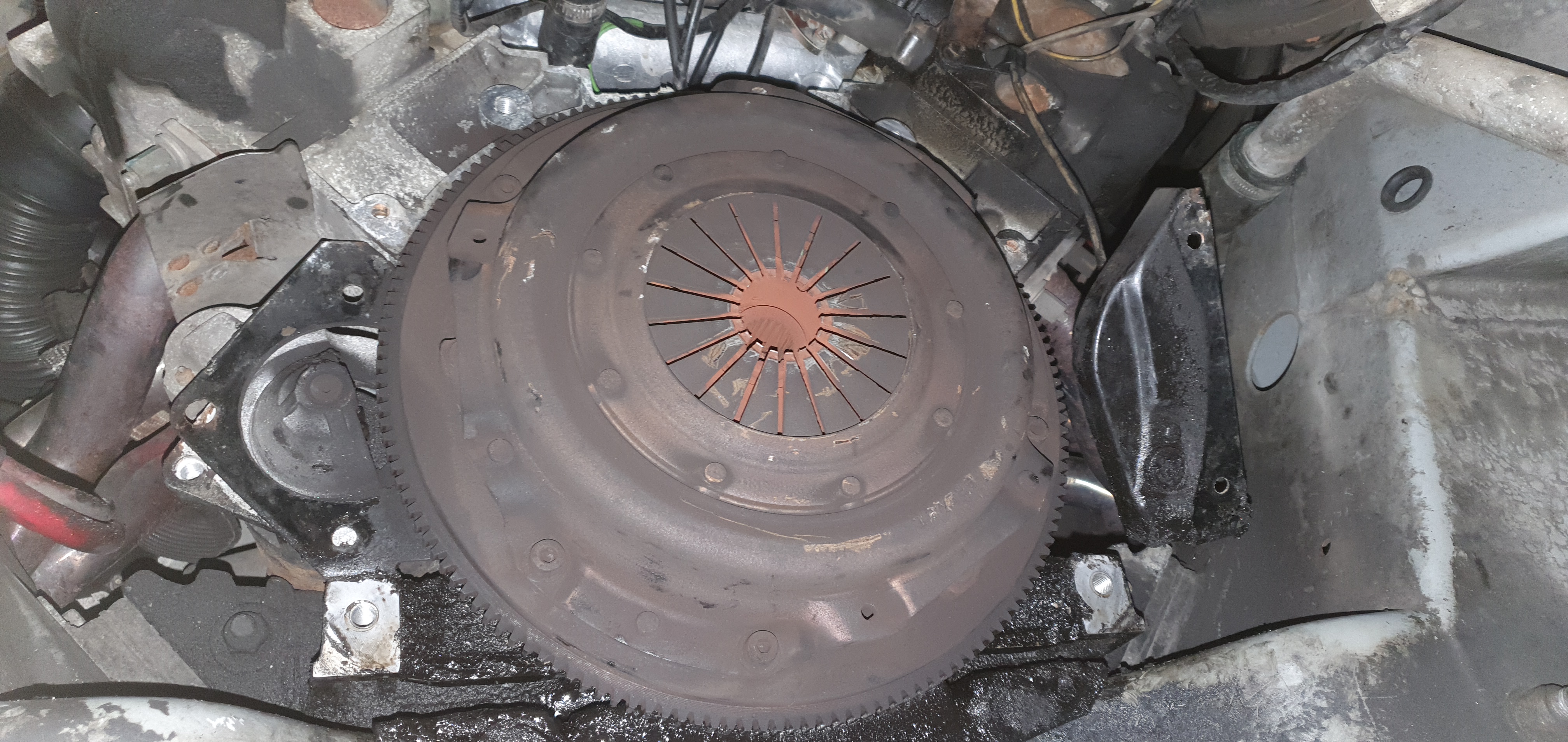

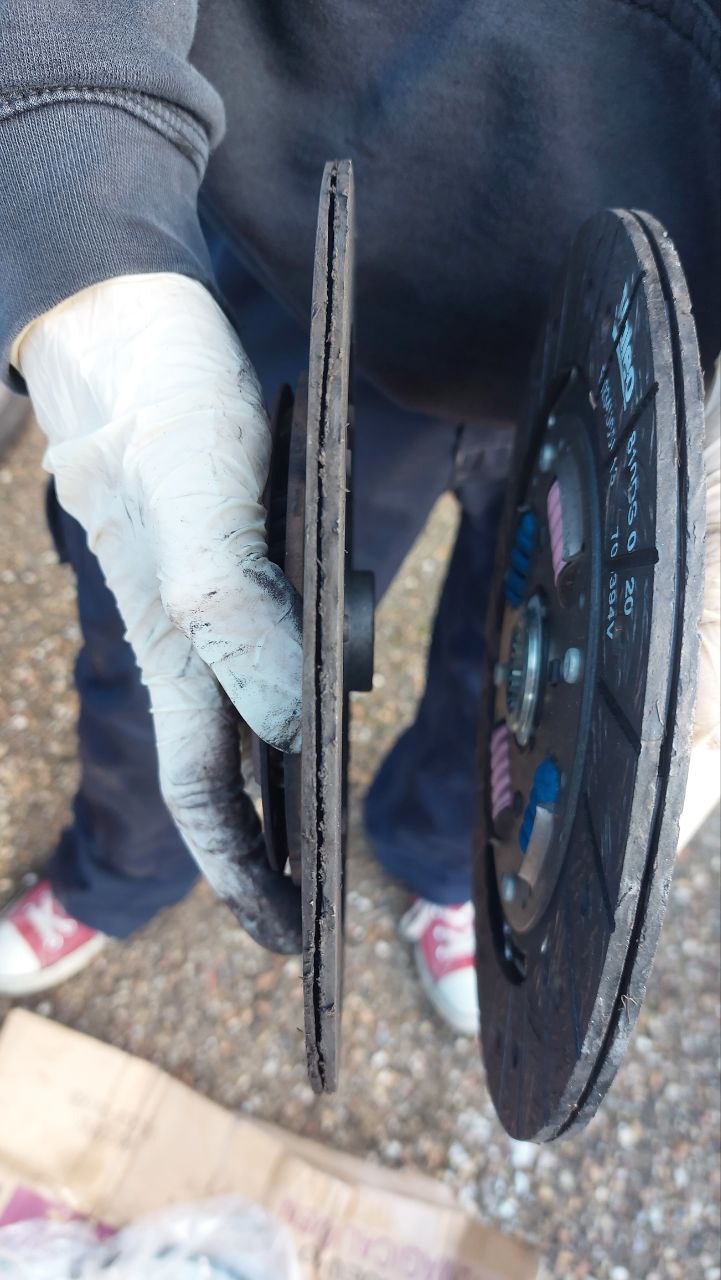

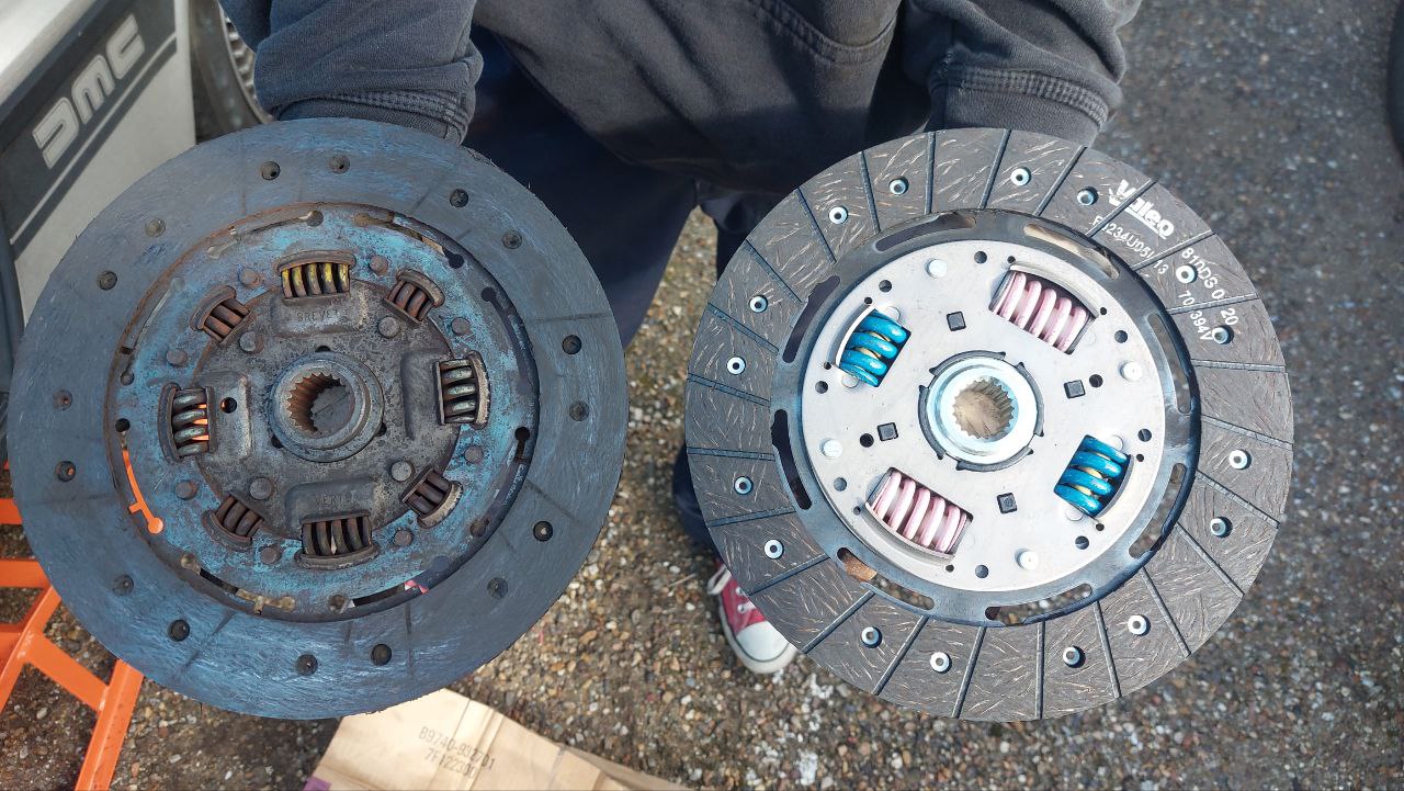

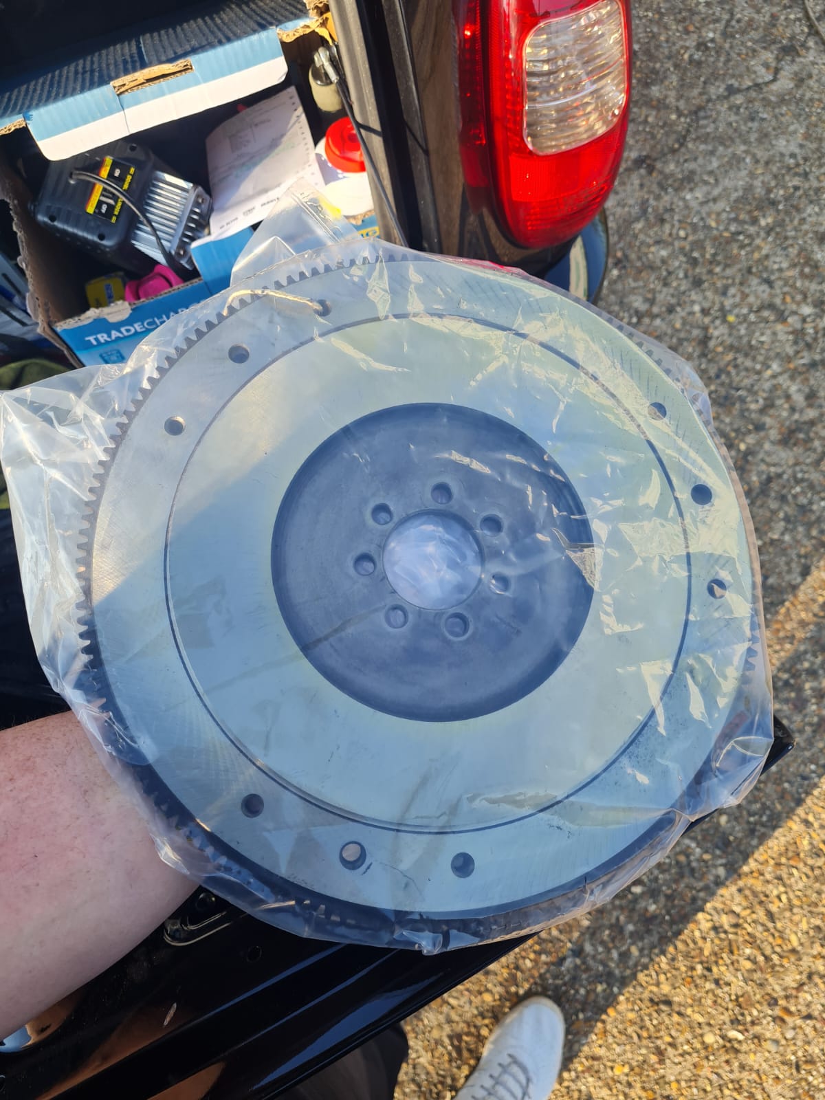

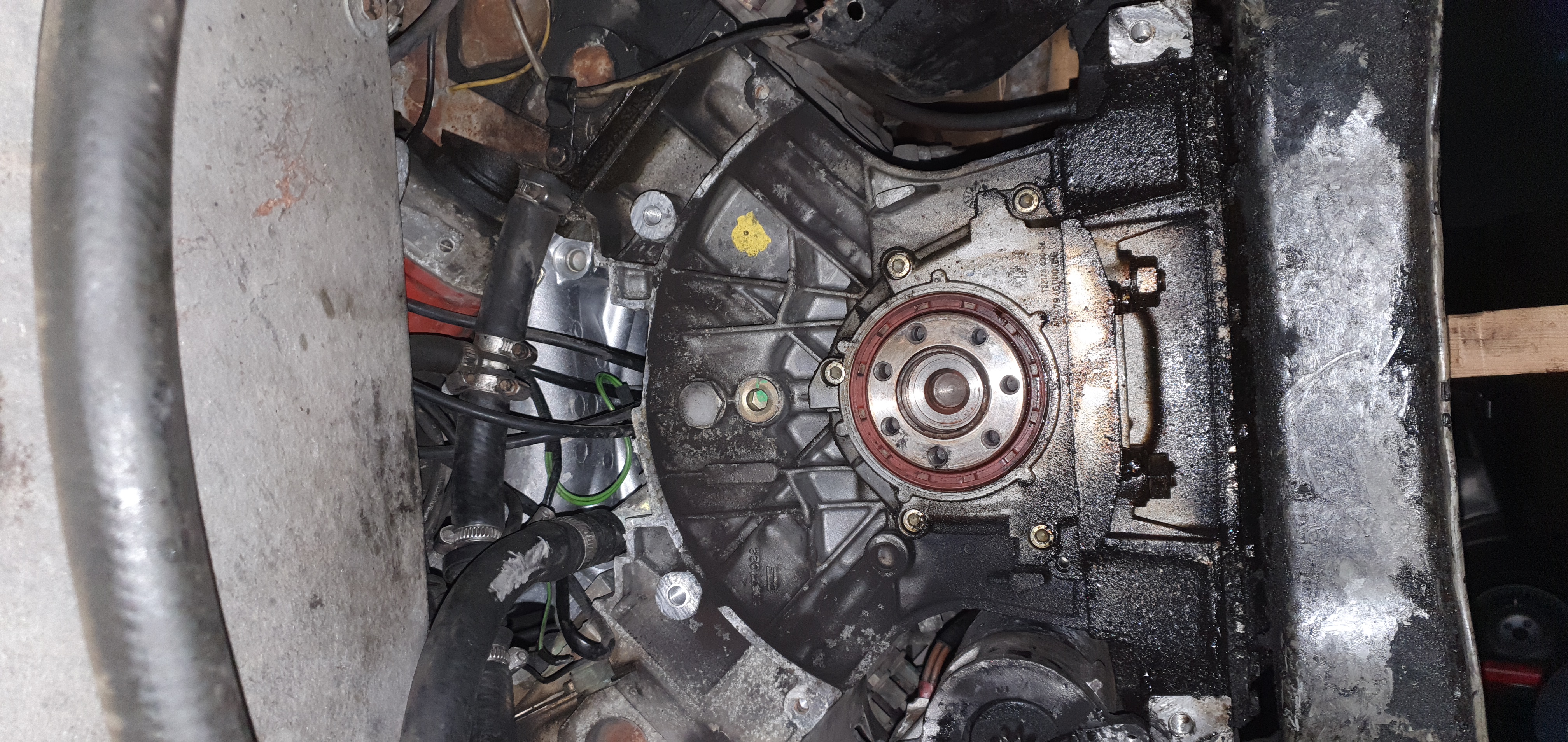

The biggest job done was at the last tec meet in march. The car was fitted with a new clutch.... in a hotel car park!
Massive thanks to both Dan S and Mec for all the help with this. I couldnt have done it without them. I turn up on the Friday about 4pm and by 6:30pm, the transmission box, flywheel and clutch was all out. The following day saw it all go back in with a new clutch, machined flywheel and alot of cleaning. The slave needed bleeding and the car made it to arbuckles. The whole job took around 6hrs to complete. Absolutely amazing and goes to show what a fantastic club this is. Car drives wonderfully and feels like new.
Here is Mecs video of the job undertaken:
So there we have it. Ive been driving it often and loving every minute of it. The next job I plan to tackle is the interior. New seat covers, dash, glovebox lid, binnacle and knee pads along with new trim on the steering wheel.
